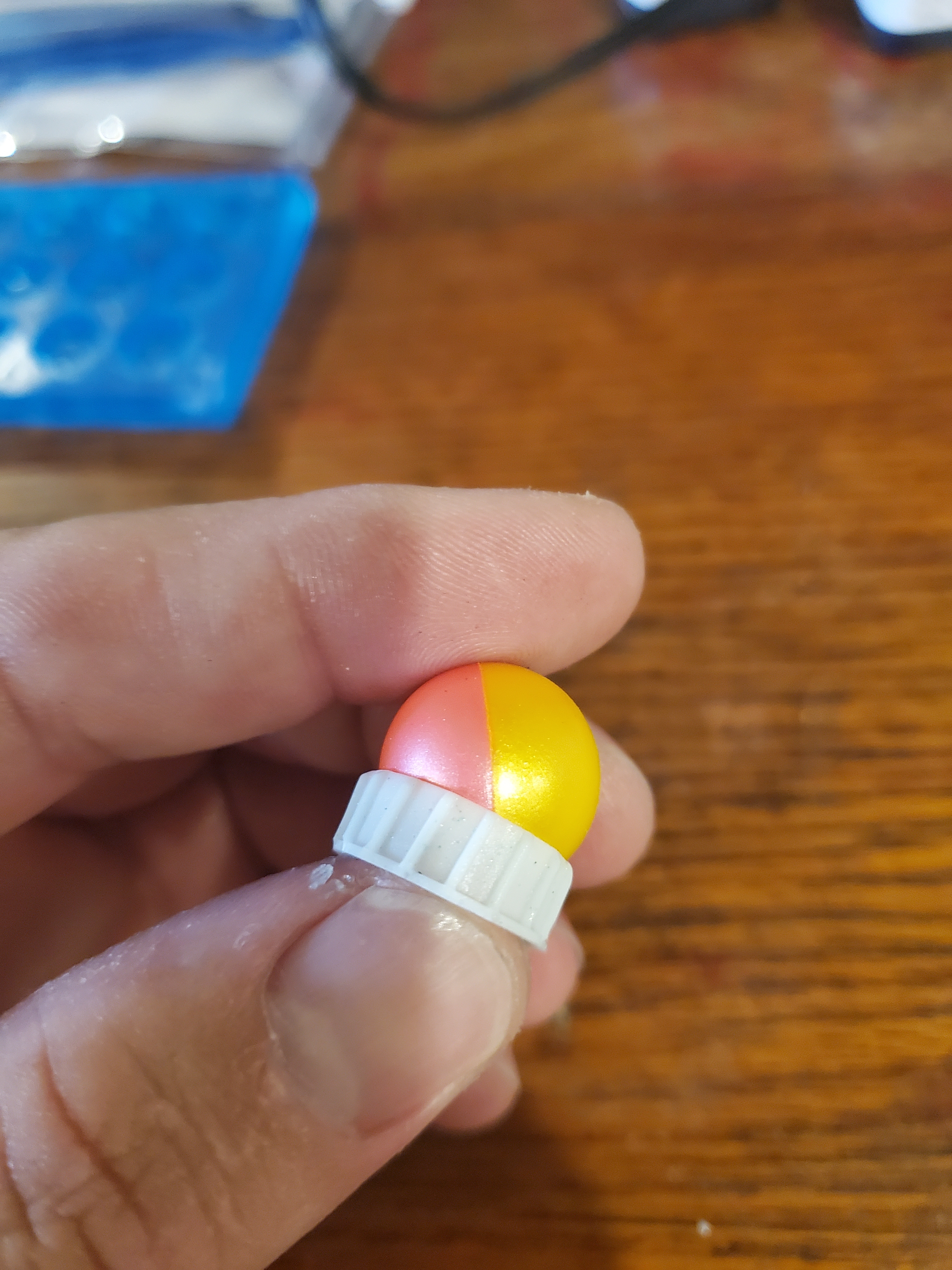

    I'm attempting to make some fins to attach to a paintball to perform similar to FSRs. This project arose for 2 main reasons. Firstly first strikes are expensive and secondly I don't want to litter our property with little pieces of plastic. I plan to make them from gelatin so they can be easily attached to paintballs and will biodegrade. I'm still prototyping but will keep yall updated if there's any interest. If they work well I will make files available along with a tutorial video.

        They are slightly heavier, don't think it's going to effect much but I will let you know when I do some testing with them

          The fins are slightly ductile so im hoping the the air pressure will expand them to the inside of the barrel. I want them to lock into rifling for more spin stabilizing

                    A couple people have tried something similar, the fins have a tendency to blow off the second air hits them... are you planning on molding the gelatin into the paintball? or molding fins and adhering it to a paintball?

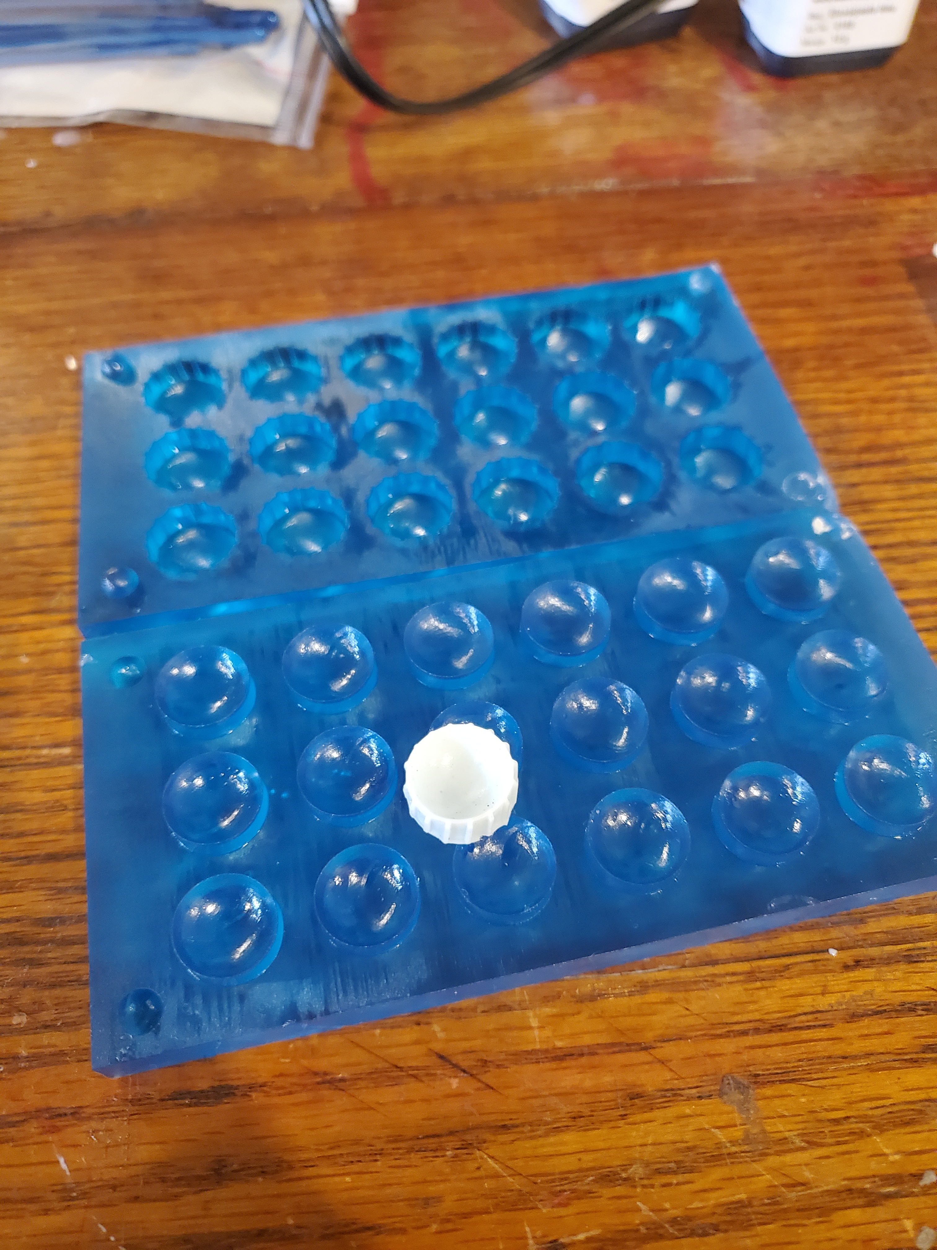

                    I've been doing some testing, I've cast a bunch from gelatin and shot them and they seem to work great. The fins stay on and preform similar to first strikes but I have yet to do a side by side test. The biggest problem I'm having is the shrinkage of gelatin. I have about an hour before the fins start shrinking from water evaporation. Best I've tried is about a 1 to 1 gelatin to water ratio. The less water I use the less the shrink but the more viscous the gelatin making it hard to cast. I've been reading that there are different additives to use such as glycerin so I'll have to experiment with that...

                    Other than additives you can account for shrinkage in casting by embracing it and finding a stable mix. Then you adjust your mold size to account for the shrinkage.

                      Yes that's an option too but the seem to kinda deform as they shrink
