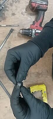

                This size spring wire is good for moving paintballs horizontally. If you want to lift paintballs vertically, youll need to beef it up a bit. Maybe double the thickness? Ive never tried...
                Adjust the size of the mandrel to make slimmer/fatter springs accordingly
                https://youtube.com/shorts/MGqjTCgXj...iJAtXIxNvvAzk6
