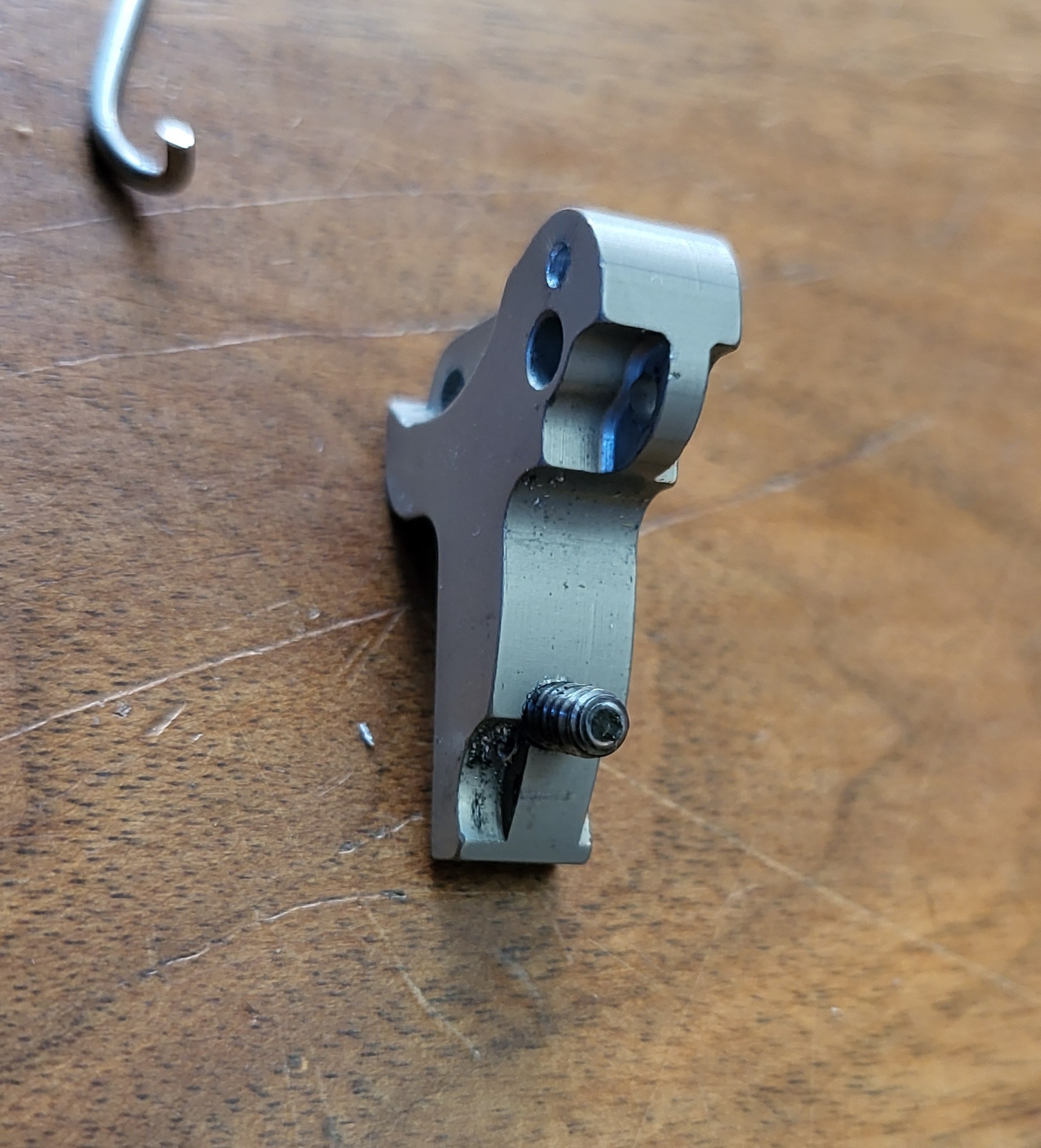

    The frame's sear went - no need for it, the Blazer mounts it's sear to the body - and, after some mockups and measuring, a setscrew was installed in the bellcrank to trip the sear.
    Click image for larger version  Name:	20241103_101928.jpg Views:	5 Size:	789.3 KB ID:	614039

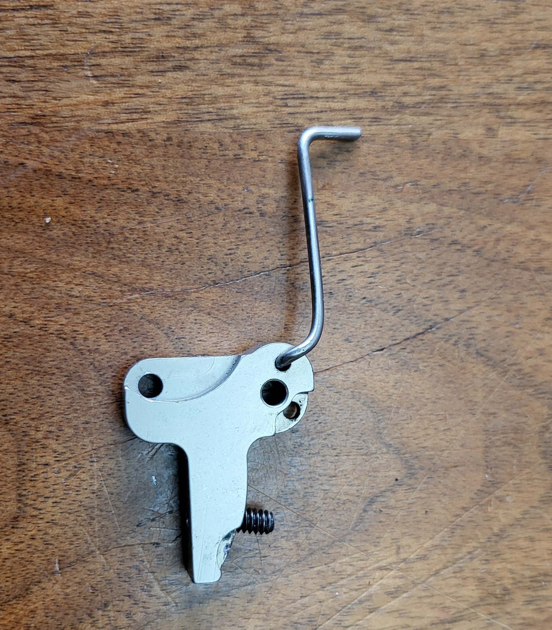

    The other tricky bit is moving the 3way. Again, no permanent mods to the Blazer, so I had to come up with an alternative to the rod/bellcrank setup PPS uses to connect the 3way to the trigger. So, I improvised. 🙂
    The SF bellcrank was marked and drilled to allow a linkage to connect to it, and then I bent up a linkage out of an old Stroker trigger rod I found in a box of misc stuff. This was mocked up and the length finalized before trimming and final bending happened.
    Click image for larger version  Name:	20241103_101917.jpg Views:	0 Size:	1.13 MB ID:	614042

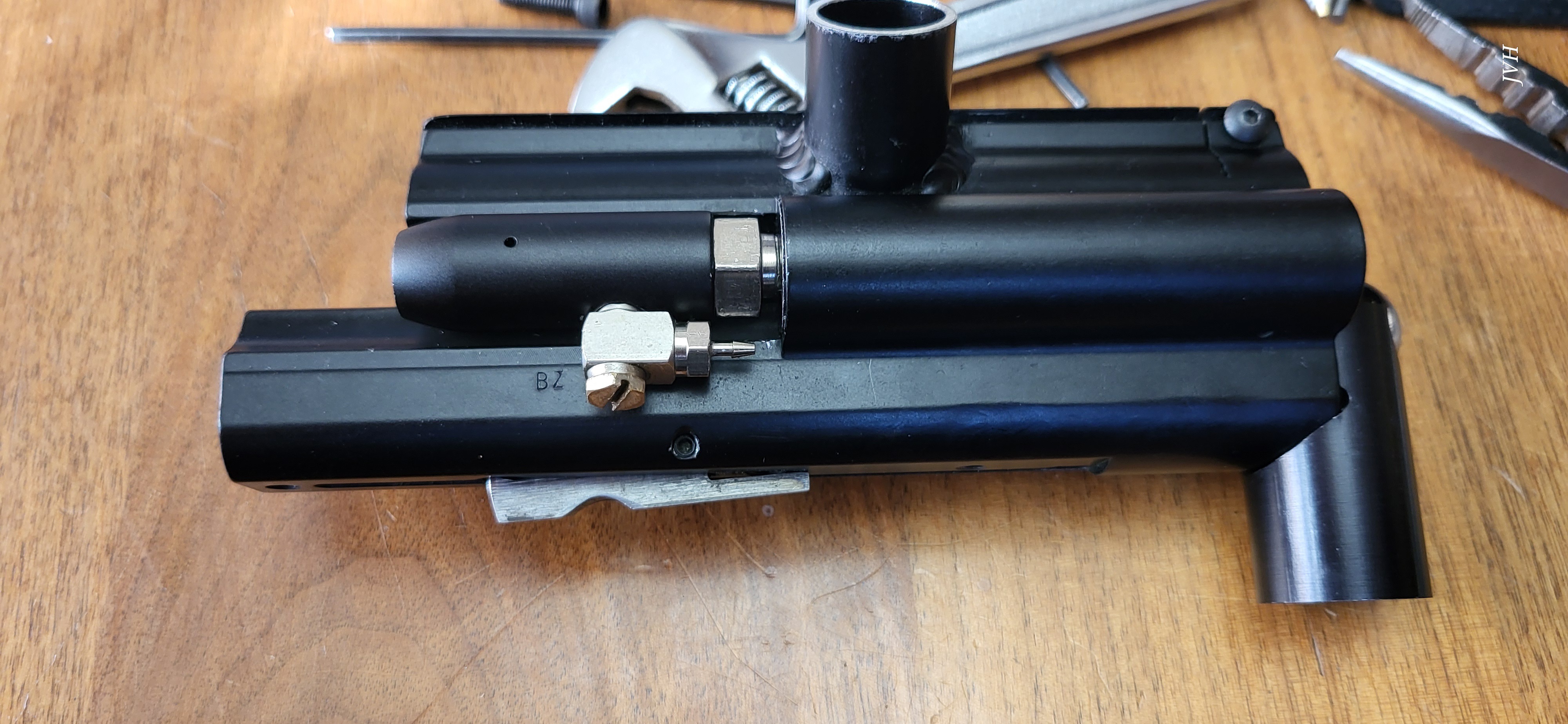

    That left finding a source of LP regulated air to feed the frame... and Blazers have a 1/8"npt port on the back of the Rock housing that works perfectly for mounting a WGP bullet LPR.
    Click image for larger version  Name:	20241103_102354.jpg Views:	0 Size:	1.72 MB ID:	614040

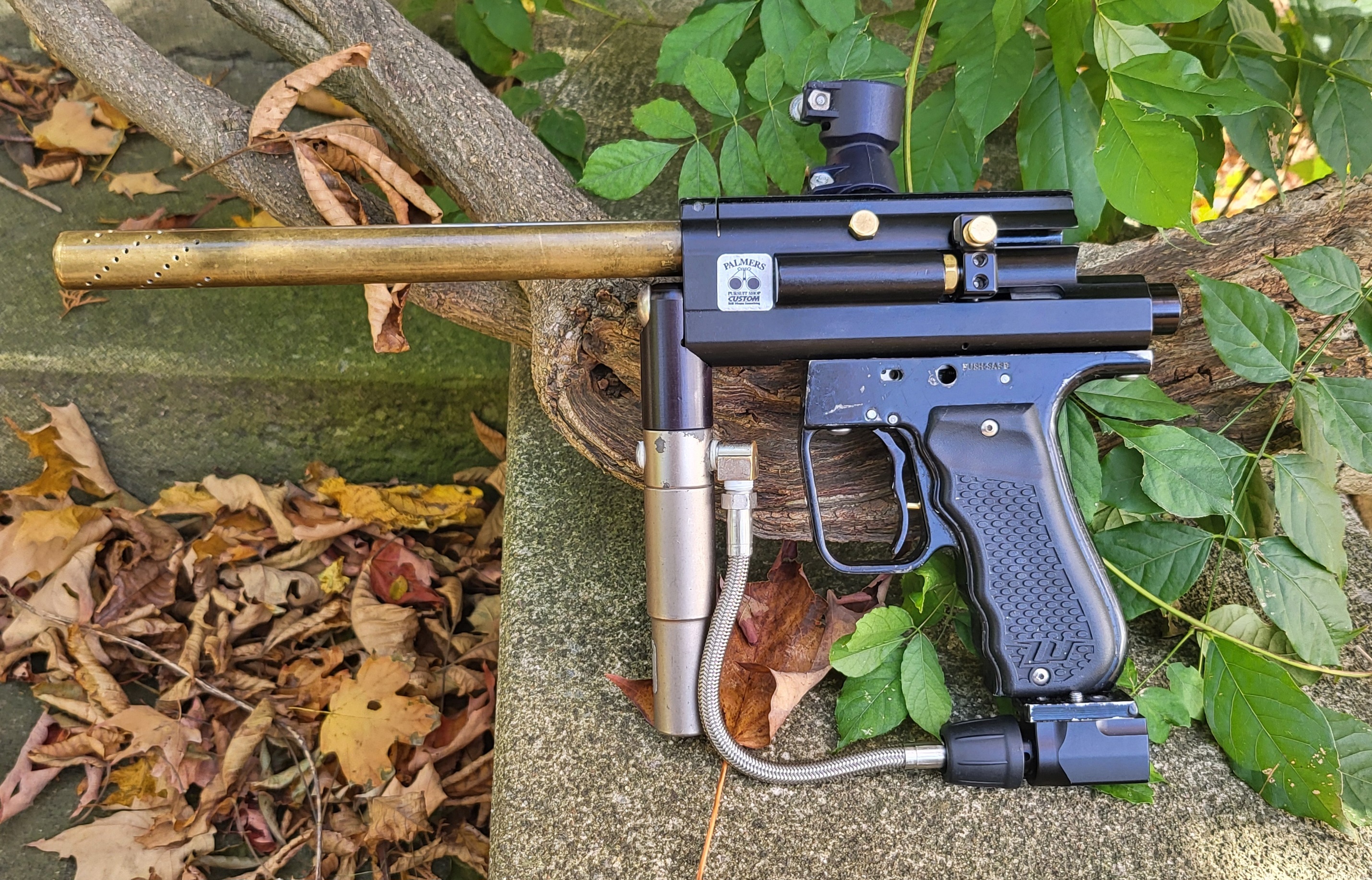

    I've done a bit of work to the frame since this picture to pretty it up a bit - I filled all the leftover holes with epoxy and sanded/painted the frame - and there's still some other work to be done to it, like building a Freak-compatible barrel and deciding on what reg to use once I'm finished dialing it in.
    Click image for larger version  Name:	20241103_125353.jpg Views:	0 Size:	1.85 MB ID:	614043

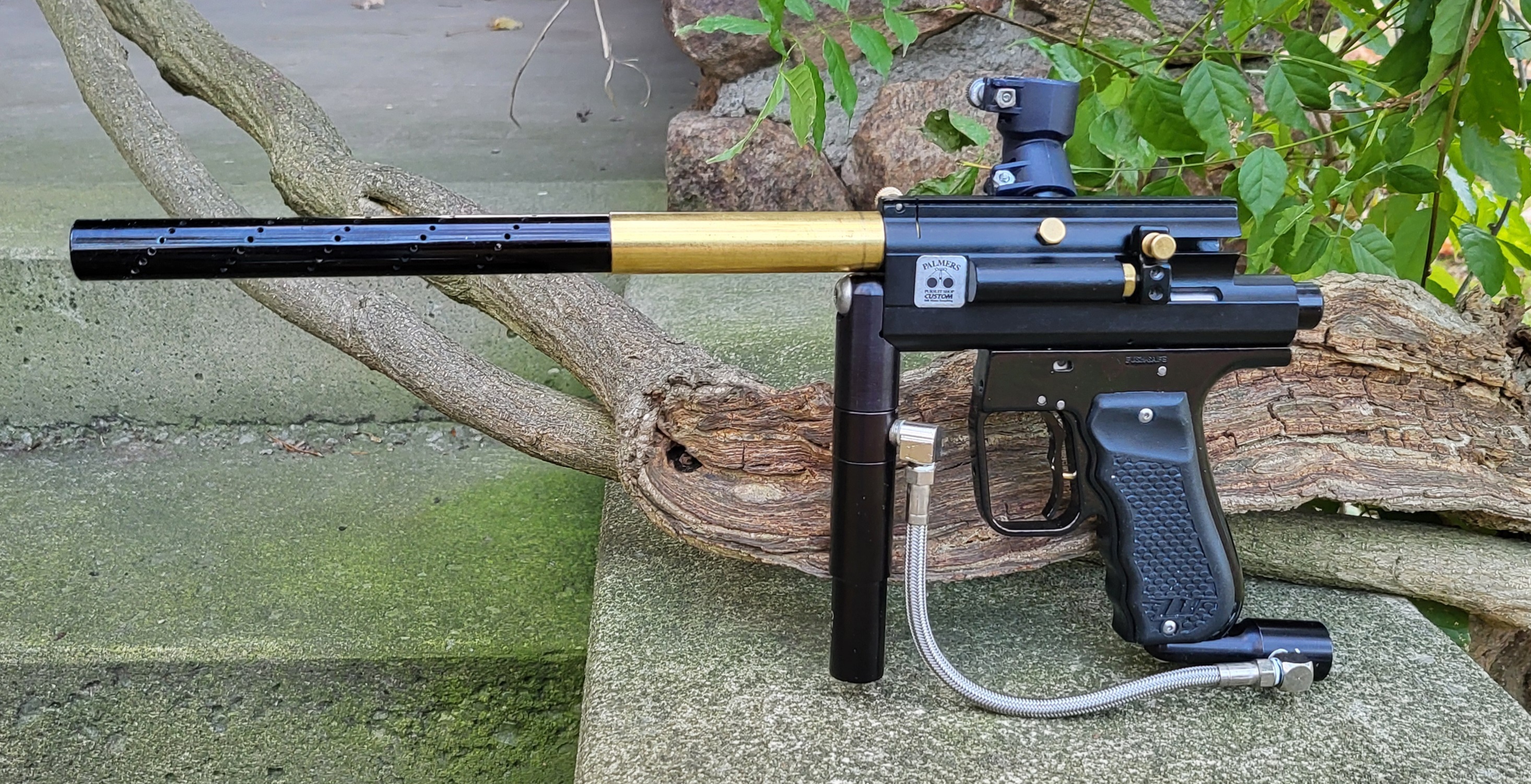

                      Not quite finished but almost there... Freak-compatible barrel mostly done - needs polish and final assembly - and then some fine tuning with the frame setup, but that part will wait til next season, I think.
                      • Cal440
                        Cal440 commented
                        Impressive build as always, really like the color combo.
                        Jordan commented
                        Thanks Cal440! I was going to go plain brass on the barrel and then found the AA tip in one of my boxes. Turned out better than I thought.
