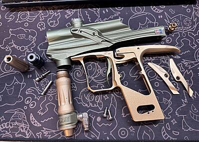

    Reviving a parted out SL74

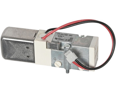

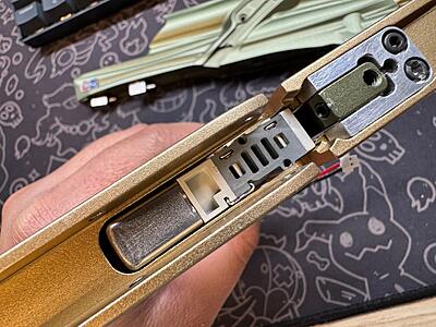

    I purchased a parted out SL74 a few months ago in hopes of bringing it back to life. The hardest part was tracking down a solenoid for it and I didn't want to buy a used gun just to part it out.

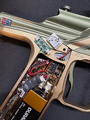

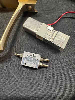

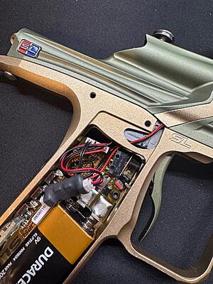

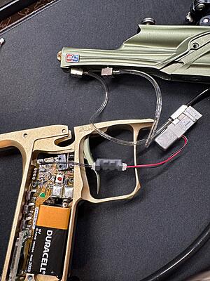

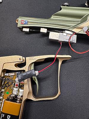

    Instead, I designed a manifold for it to use a LV1.6/LV2 solenoid and gasket. The only tweaks I made to the solenoid was sanding down the screw retainer slots and screw heads for it to fit the frame, as I didn't want to modify the frame in any way. Also, I designed a voltage regulator circuit to drop the output voltage of the ego board from 5V to 3.3V and added JST connectors to make it plug and play.
    I don't have shooting videos of it yet, but I've had it ramping at 15bps with no issues. Currently, it's set to 10.2bps for local play.

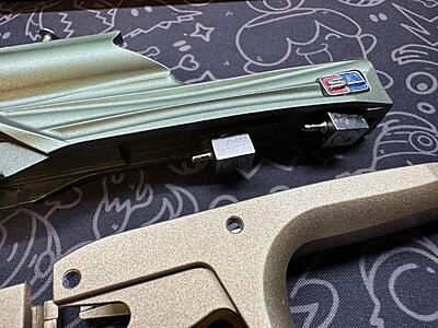

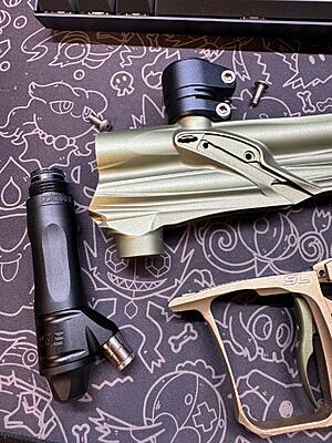

    I've added a black SL3 reg, feedneck, and pops asa. I couldn't track down any reasonably priced QEV's, so instead I added some banjo barb fittings from McMaster-Carr. Next, it'll be off the anno.
    Let me know what you guys think of it. I have two manifolds and a few voltage regulator boards left, but I can get some more made if there are any interest.

      I didn’t realize the new LV solenoid used a 3v pilot.. good to know

                  So, the new solenoid, does it have metered flow valves on it? I'm just wondering if you ant make the ego 7 smoother with this change.
                  • Nugepb
                    Nugepb commented
                    It does have the valves on it but I feel like it acts more like a QEV.
