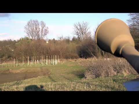

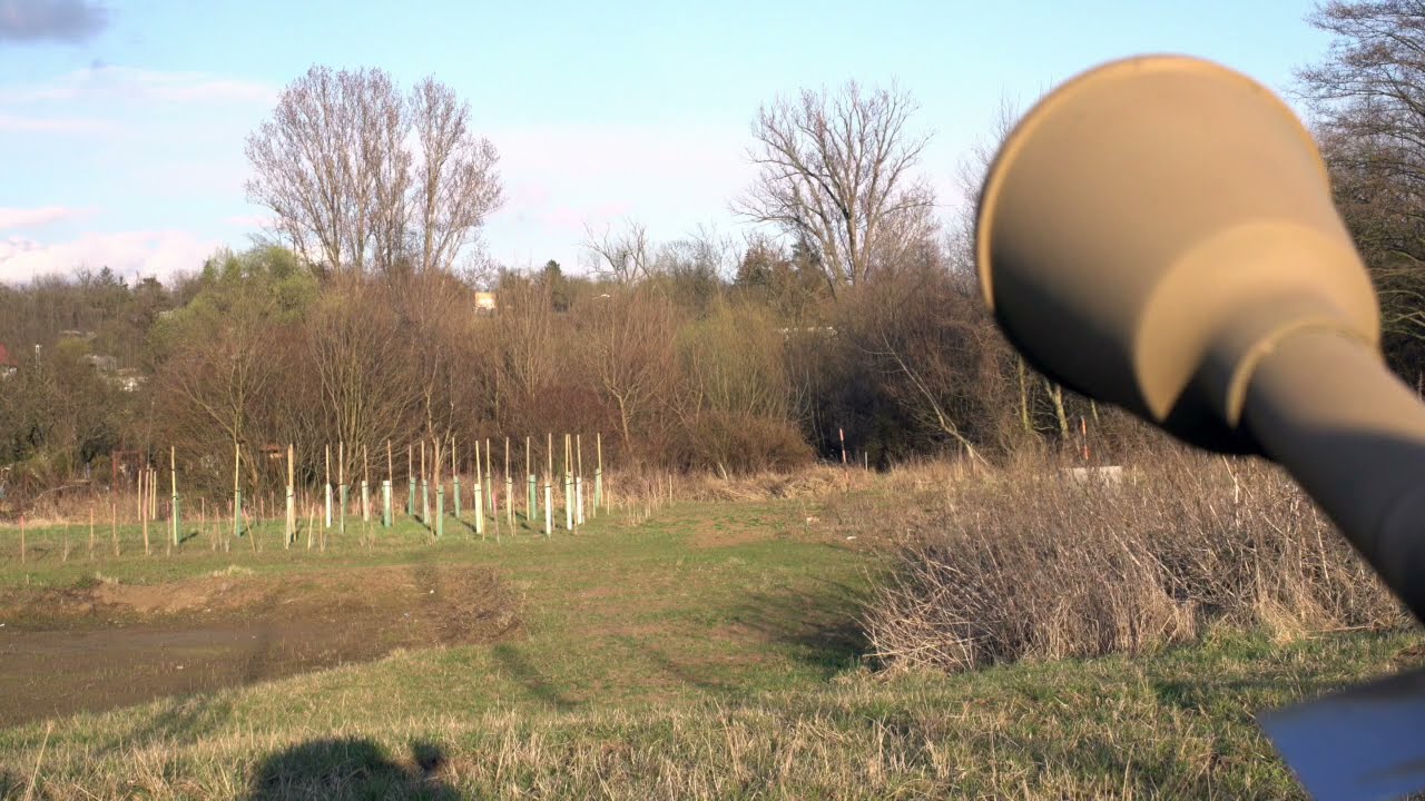

          Hey, I'm back with some updates. I hadn't done anything in the first two months of this year. But it starts to get better. Not only I have at least some progress with my Faustpatrone, but I realized a potentially simple principle how to make our AT guns go optionally boom using 9 mm blanks.
          Now back to my current project, die Faustpatrone.
          Projectile
          After several experiments I can make it as light as if it was milled from the XPS, but with a better shape options and its surface alike. Most of the body is final.
          What is not are final are two things:
          • Stabilizers (they are plastic and bendable; not from the spring steel), yet they can scratch. Unless I manage to find bendable material that is soft as well (I doubt that), I would need to cover their edges with some soft material.
          • Warhead - which is in my case the most frontal part out there. Currently it is hard, but once I make the mold, it will be soft and fragile and filled with a cyan marking powder. This is what cracks, the rest of the projectile remains intact and will be reusable
          The "unbreakable" part of the body without the marker fill weights 50 grams, which is so-so. My aim is to get it towards 40 grams. It has 12 mm of XPS foam (100 mm in diameter) in the front, that will absorb this energy. I need to shoot it at 30 meters only. The rest of the weight will be in the powder-filled and fragile warhead front.
          HPA system
          I'm in the beginning here. The trick is that I need to fit everything within a 30 mm diameter tube! My very first attempt with very slow and tiny diameter valve did no go well, I only got 13 meters of distance.
          The projectile's flight was stabilized enough. The small wiggling was caused by the extra mass in the front of the warhead which was not centered (I glued a bunch of stuff there)
          The progress will be quick now; I'm switching to more powerful valves to see what it takes to get it to the desired distance and then I will try to solve how to put it into such limited space.
          My ultimate aim is to not only make shoot the "faust", but ideally partially simulate the "backblast" as well with a white powder. This will require quite complex air system and I have to see whether I eventually get there.
