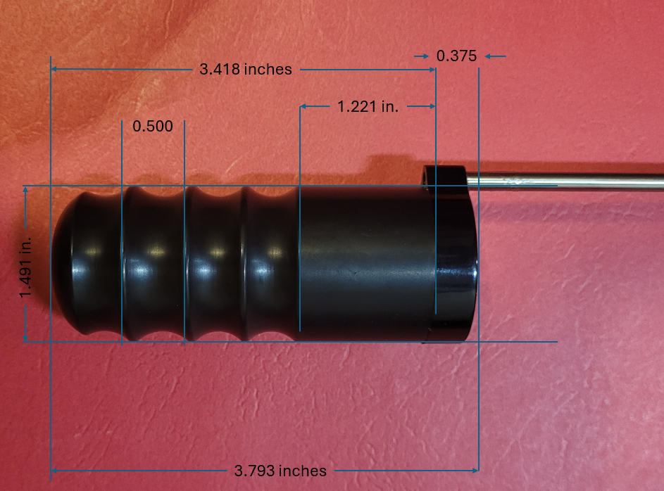

        I’ll get those later today .. if memory serves me correct it was something like 1.125” or so.. I’m guessing you will also want/need the hole positions as well for mounting the plate?
          Here you go just pulled this off a pump handle I got in trade and received today. (Ignore the parallax best my phone and I could do):
          Click image for larger version  Name:	CCM Pump Dimensions.png Views:	0 Size:	839.5 KB ID:	673491

            Woah! You the best. Thanks so much for taking the time to do that

            One more little question, what are the ‘plugged’ holes for? Are they necessary?

            They are how the aluminum plate attaches to the Delrin handle. The aluminum plate has the threaded bumped out portion for the pump arm so pretty necessary.
