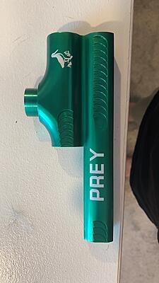

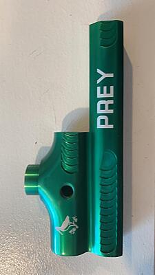

              So I just finished the ano job and took a lot of photos along the way. I will write then post the tutorial in a few days, but I thought I would show the end result. This is before the "PREY" laser job which I should have done by early next week. Anyway, here she is (The picture doesn't do it justice, she is really pretty in real life):

                        That looks cool ... just printed and bound the Caswel manual ... ill have to guive it a try ...
                        What voltage/current are you using?
                        Also, are you agitating/bubbling teh acid tank?
                          I am using a constant current power supply and varying the current pending part size. For something like this cocker body, I was around 7ish amps which the power supply set at 9ish volts. The voltage varies as the coating builds up and I also found it varies with the ratio of acid to water.
                          As for bubbling, I am not currently but I think I am going to start playing with that. The bottoms of the parts always seem to have some blemishes which I think is due to bubbles forming. I do shake the pieces every so often but I think a bubbler would be better.

                            Thanks, I've had all the supplies for about a year, but never seam to find the time to do it ...
                            What concentration are you using?

                            `The voltage varies as the coating builds up and I also found it varies with the ratio of acid to water.`
                            The surface area of the part plays a factor in this as well right?
                          • Memornix
                            Memornix commented
                            Correct. I am no expert by any means but more surface area requires more amps to get the job done
