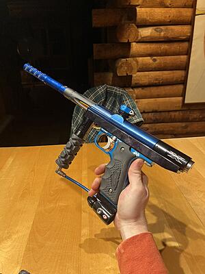

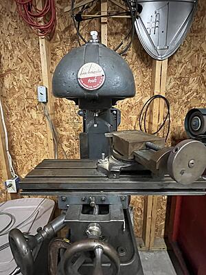

    A couple months ago I had gotten a bunch of rt classic benchmark frames, but only having one rt classic, these frames have been sitting idle. Finally got around to assembling my milling machine thats been in pieces for a year when I moved. Remembered hearing that you can use lvl7 automag spacers as a spacer for rt classic frames with the larger field strip screw hole to work on regular mag builds.

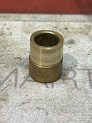

    I don't have a lathe, but this was my work around, a threaded piece of steel that was a slightly larger diameter than the lvl7 spacer that was a very snug fit. and used the table slide with a lathe cutter I had around in the vise and slowly cut away material till it was a perfect fit.
    Really happy I have the means to do something like this even if it was a rather simple job.
