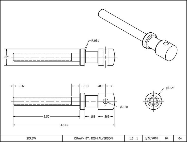

                      Your designs appear to be poppet valves which will work without a regulator.
                      Your first hurdle is coming up with a schematic. Doesnt need to be fancy, but it must be clear and well thought out
                      Again, i suggest buying a manual lathe because you can make adjustments on the fly. Plus, you dont need to learn fancy CAD software. Attached picture of what a clear, well designed schematic should look like

                        Correct me if I am wrong, I am new to the terminology, but 2 is a spool valve? it looks like a 3-way. 1 is a black box. I haven't decided how the valves are yet.

                          Now that i zoom in to the image, you are correct. #2 is a spool valve
                          If you have the skills to design 3d cad stuff, do so. Please keep us updated. Would love to see more!
