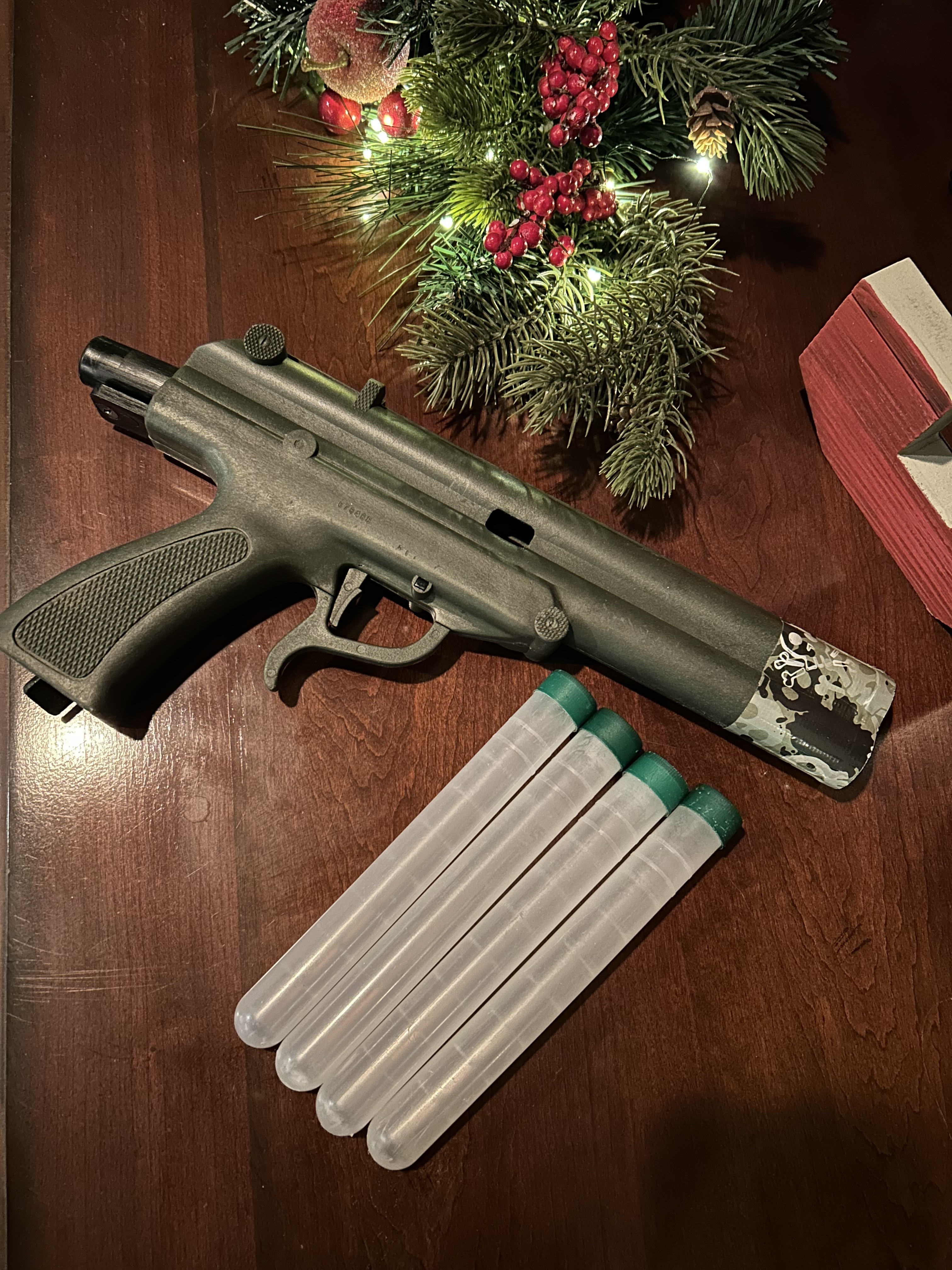

    So to start, i will be using my Walmaz price, generously provided by NONOBLITUS :

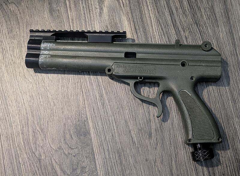

    Got the rail figured out and mounted as well as the speed whell:
    Click image for larger version  Name:	PXL_20250123_203106236.jpg Views:	56 Size:	1.96 MB ID:	647310

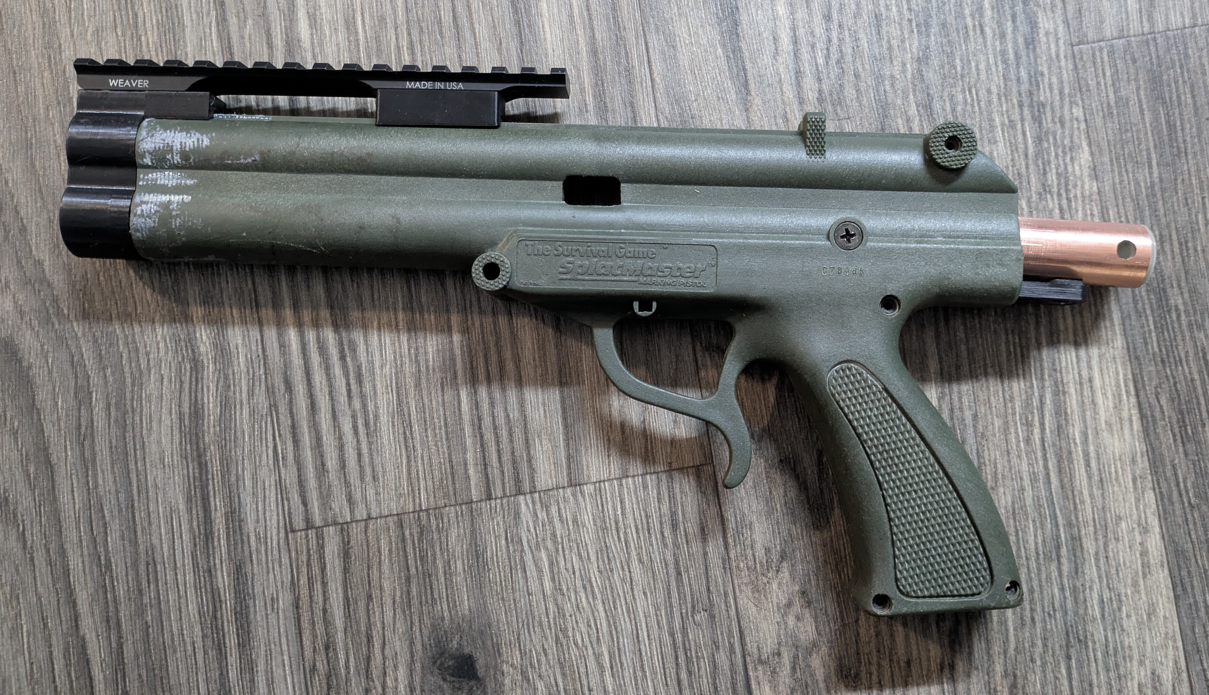

    Hammer done, so I can verify the final dimensions for the lever:

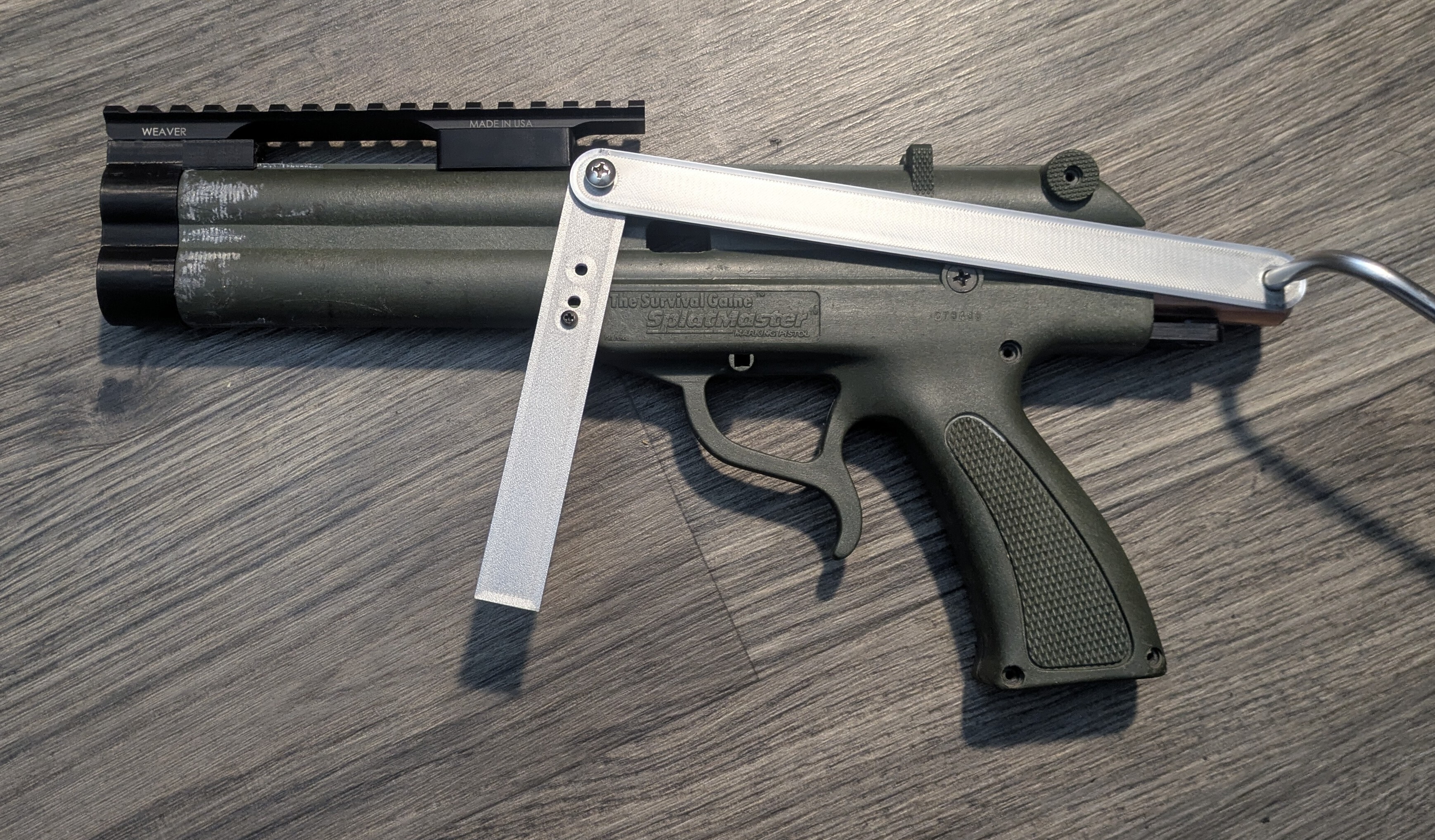

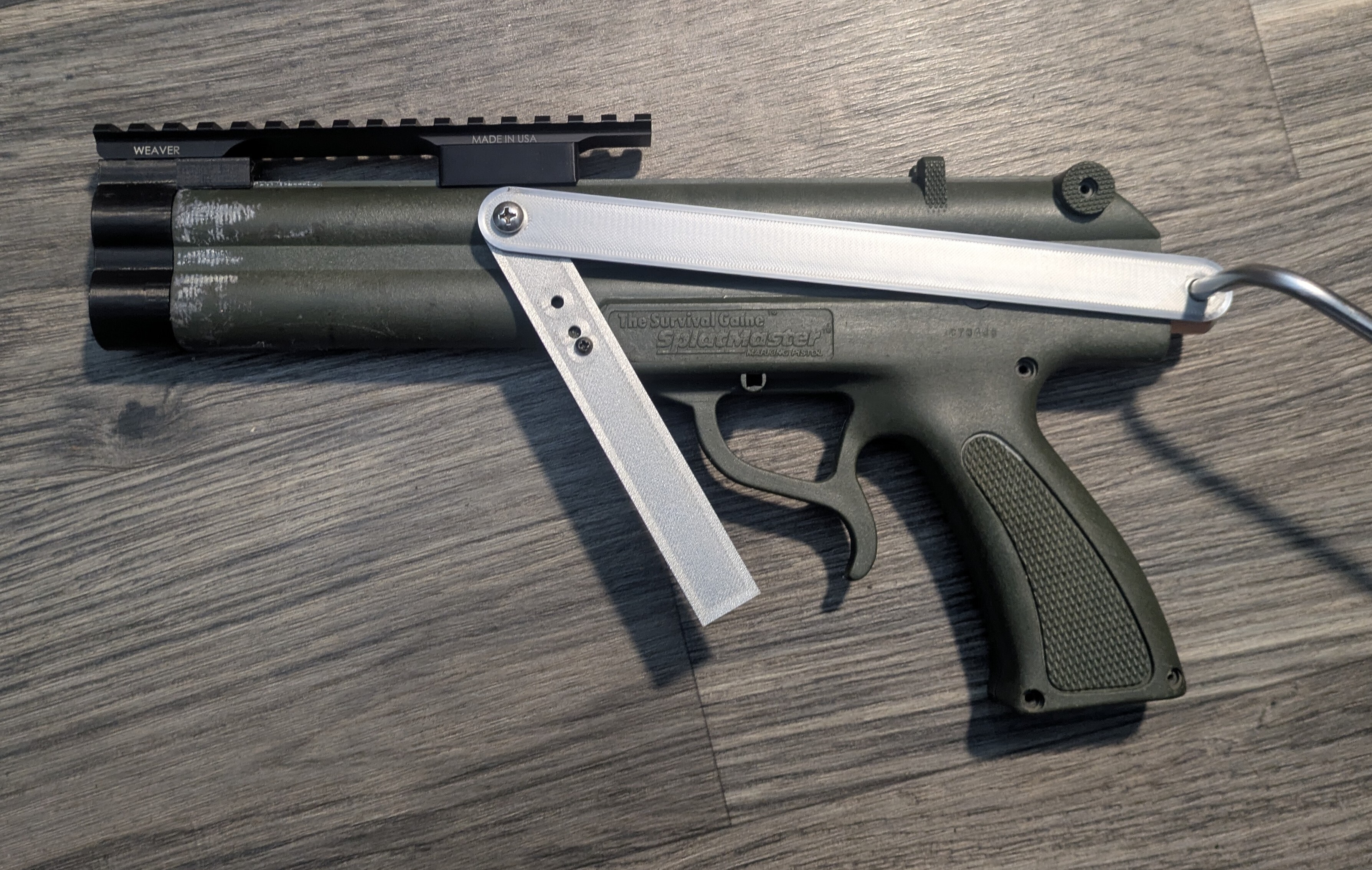

    Click image for larger version  Name:	PXL_20250129_235107878.jpg Views:	0 Size:	2.60 MB ID:	650095

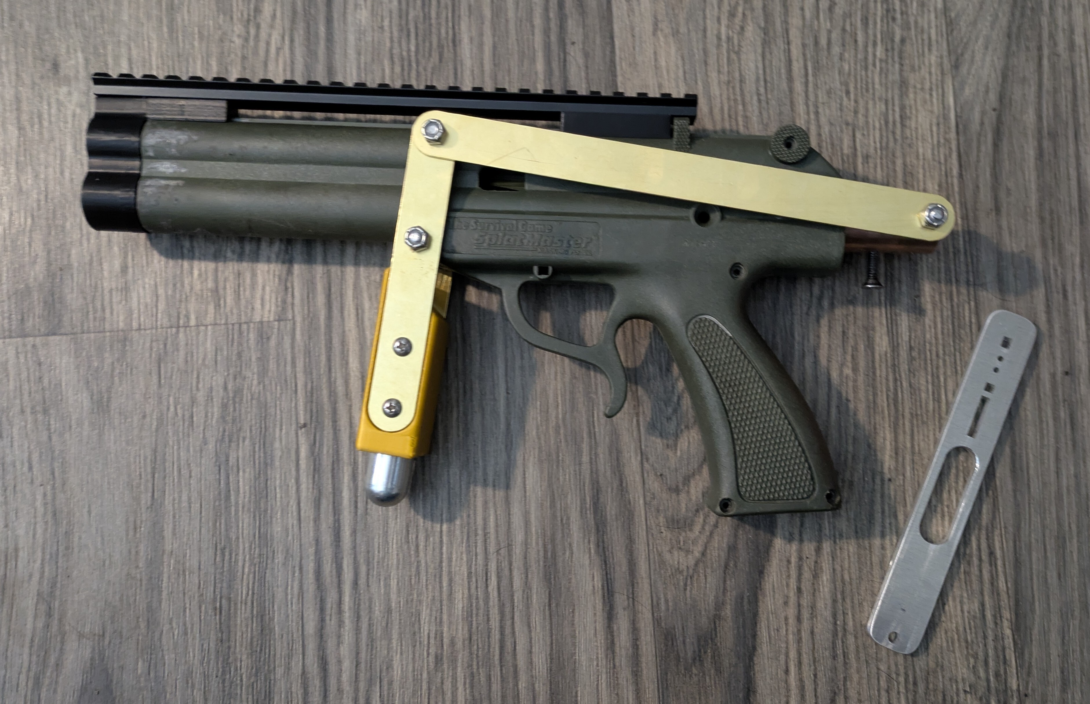

    Here is the final mock up of the lever, size fits nice 👍
    Click image for larger version  Name:	PXL_20250130_192540360.jpg Views:	49 Size:	2.09 MB ID:	650747
    Click image for larger version  Name:	PXL_20250130_192544668.jpg Views:	50 Size:	1.86 MB ID:	650746

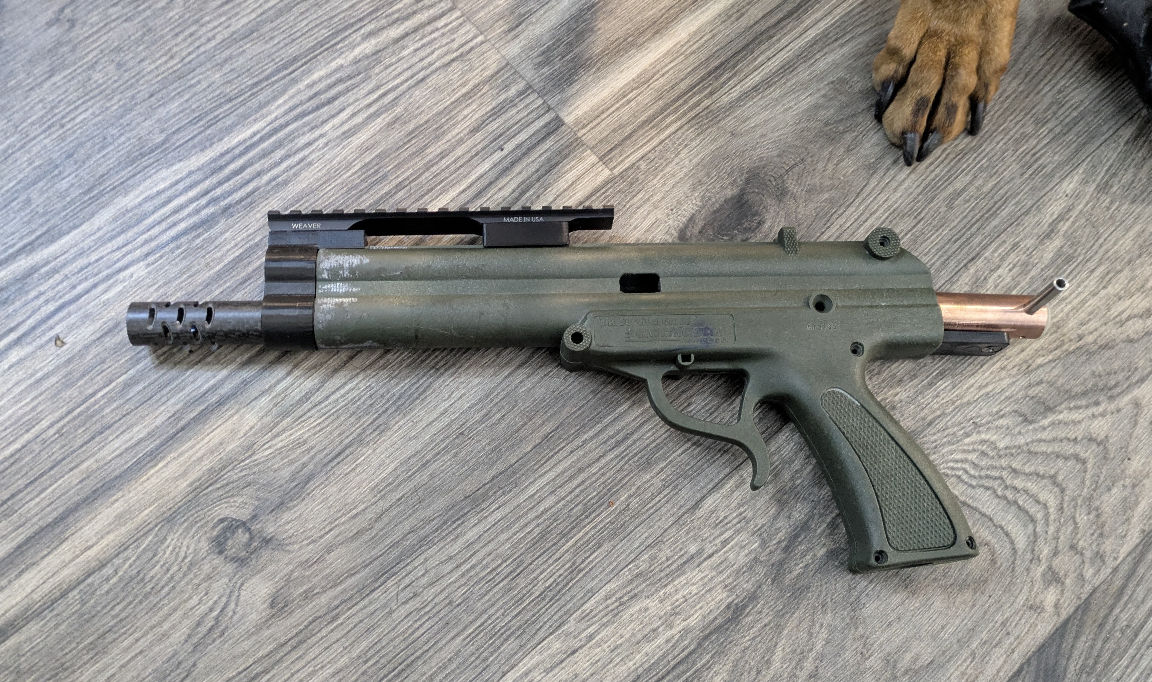

    Stiffy barrel cut and installed with a custom breach:
    Waiting on the side plates to finish the mechanical stuff.

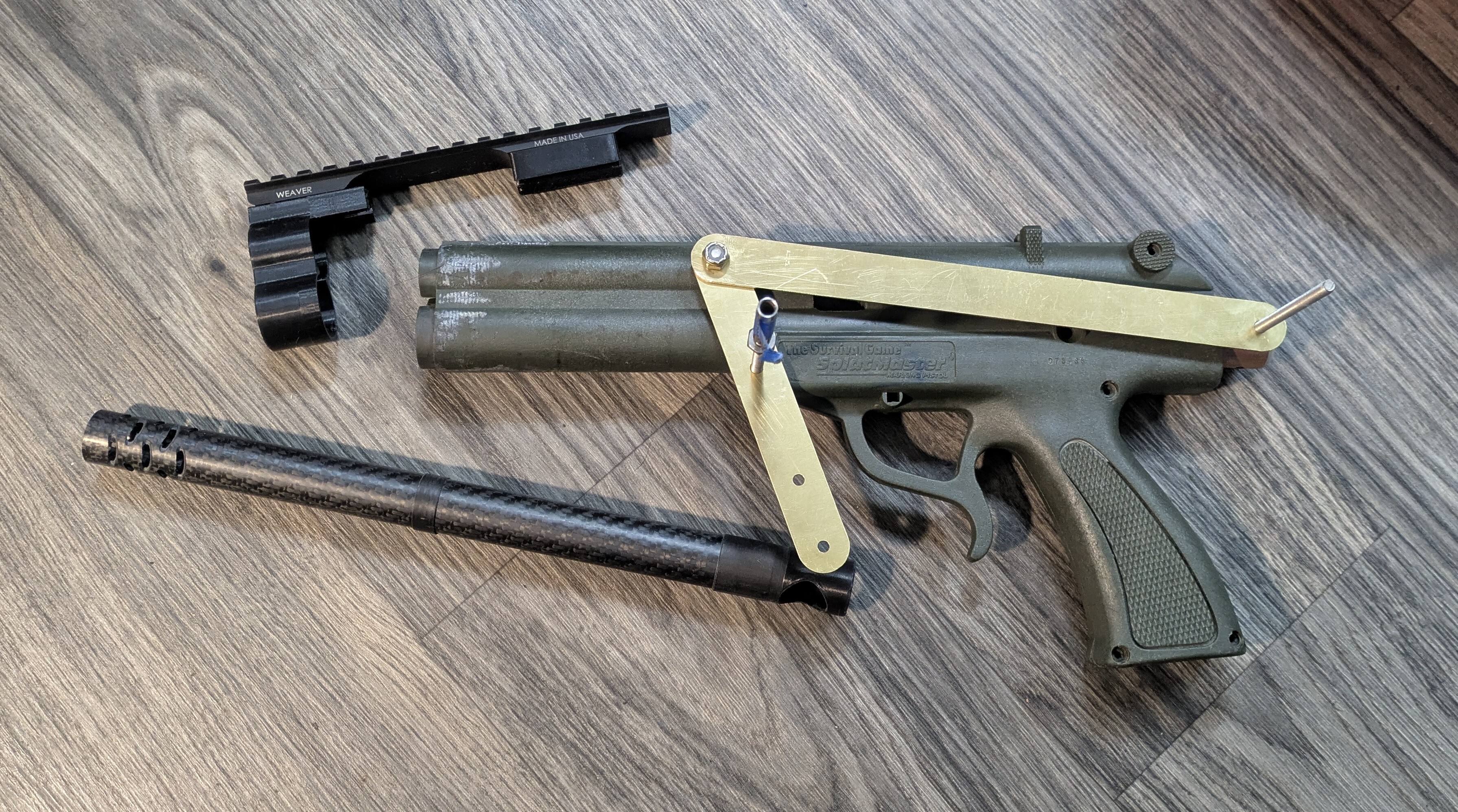

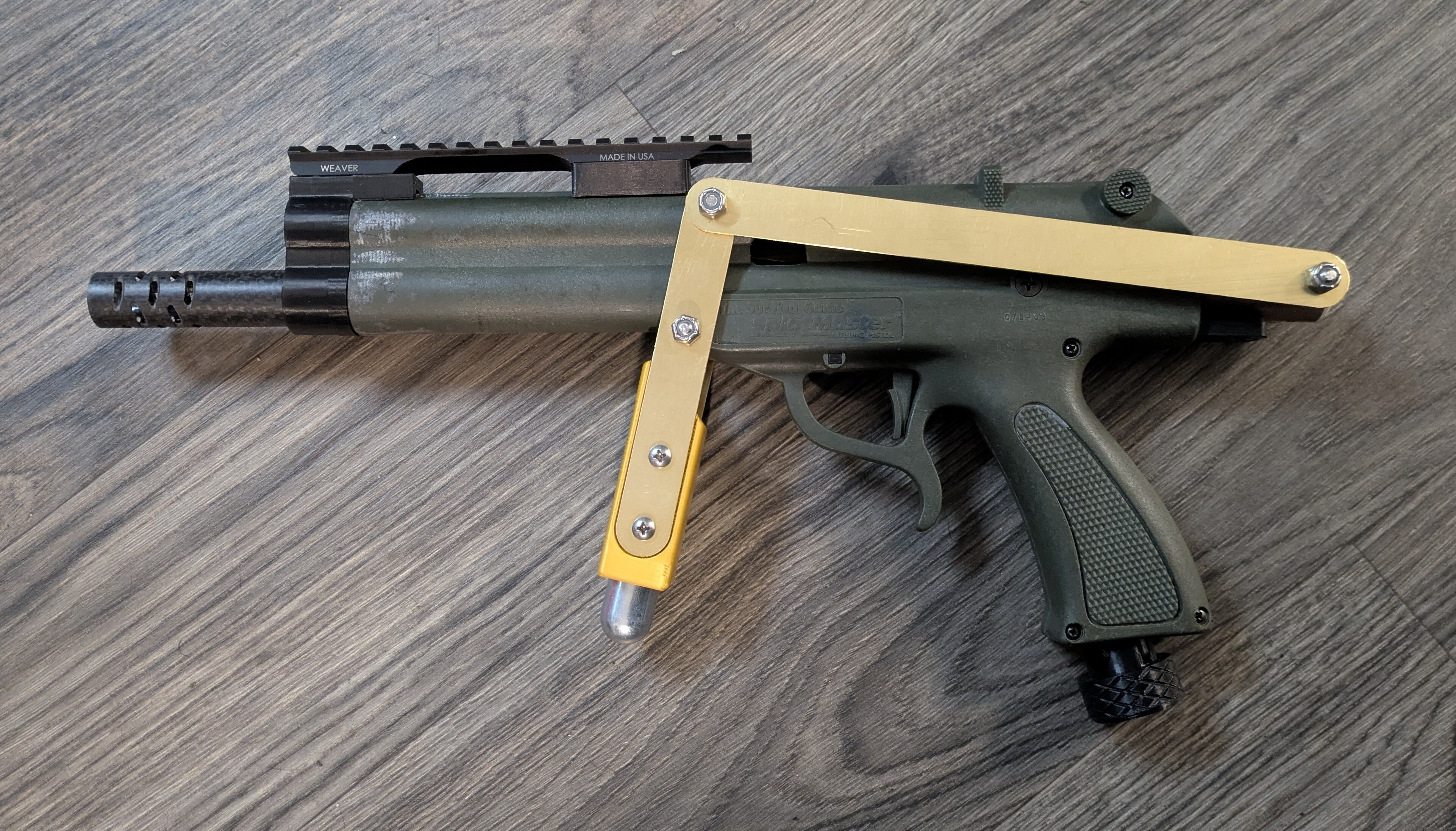

      Got the bearing surfaces done (brass tubing that fit into each other) and a quick moch up with the brass plates:
      Click image for larger version  Name:	PXL_20250206_162150239.jpg Views:	61 Size:	2.42 MB ID:	653759
      Put together for first round of testing:
      Click image for larger version  Name:	PXL_20250212_033706096.jpg Views:	40 Size:	2.22 MB ID:	655749

            Hammer done 🥳
            I'll definitely get the lever plate out of metal, need to see how much copper would be to match the hammer 😅
              lever plates mocked up and sizes verified.
              Everything fit and have clearance, so were good to go forward 👍

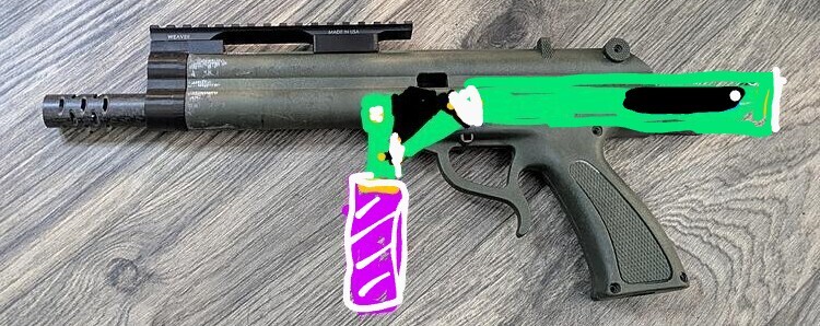

                Carp
                commented
                I guess that's one way to do it. the way mine was, the geometry was a little different.😉
                XEMON
                commented
                How was yours setup? Was it pulling the hammer when the lever pushed forward?
                Carp
                commented
                Move the fulcrum point lower to that bolt hole just before or after the trigger the main one at the forward position almost underneath the detent area that's where you need to have your pivot point to Pump it Forward cut a slot at the rear for that PIN to be able to slide forward and backwards put the commas wherever you need 'em... 😂
              Stiffy barrel is in 🥳
              The first splatmaster with a carbon fiber barrel?

                  Also, make sure that, you return the pump back, to the start position before, pulling the trigger. Otherwise, you know the problem....🤦🏼‍♂️. Once you get that rhythm down.. I was able, to shoot it better than, any Splat Rapide... that's for sure!...😁
                  XEMON
                  commented
                  im leaving the lver connected on mine, so when ou pull the trigger, it will flick the lever forward.
                  I thought about having un-linked, but where is the fun in that? 😋
                  Carp
                  commented
                  I re-edited the picture and tried to make it a little clearer....🤷🏼‍♂️

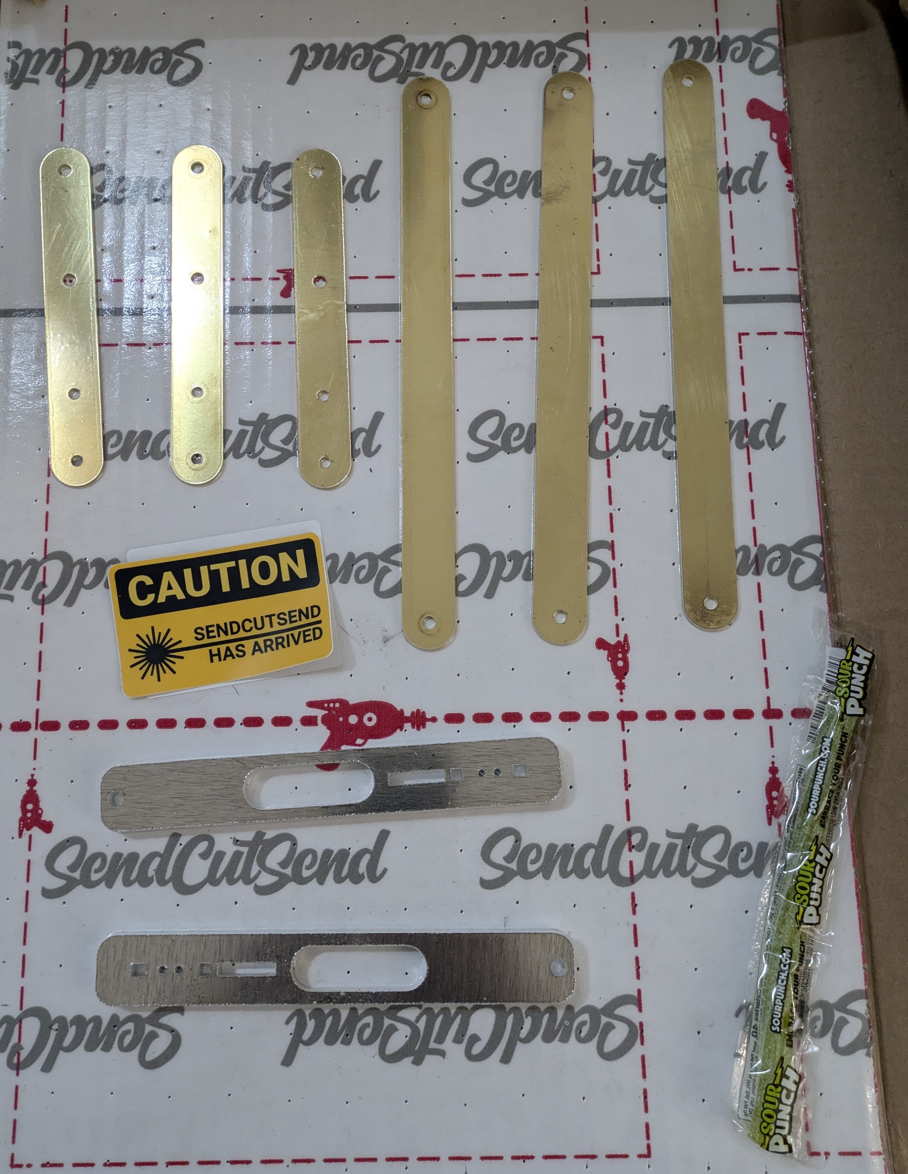

                Plates are here 😁
                #not_sponsored
                Click image for larger version  Name:	PXL_20250205_211839731.jpg Views:	0 Size:	2.22 MB ID:	653460
                  Brass plates fit nicely 😁
