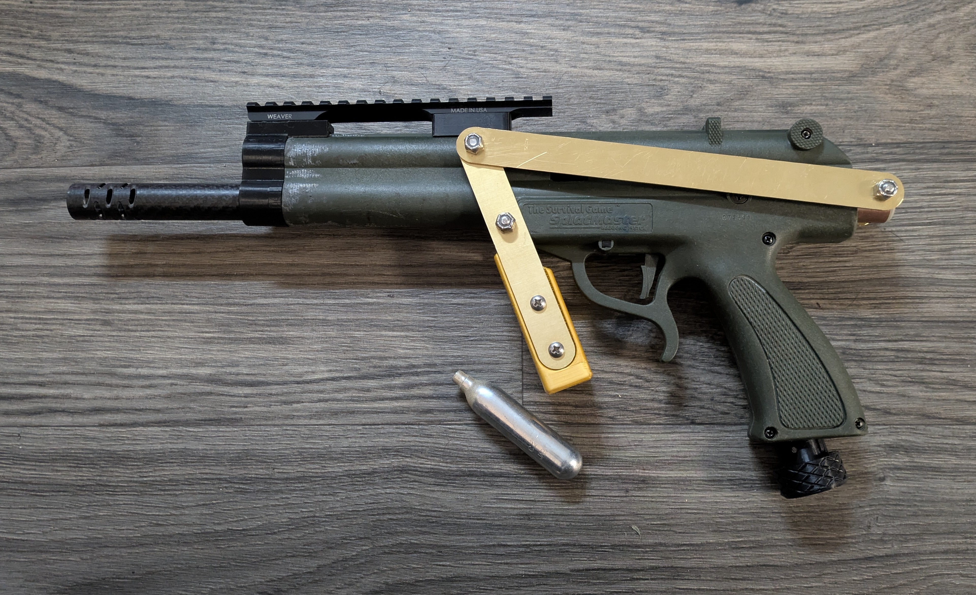

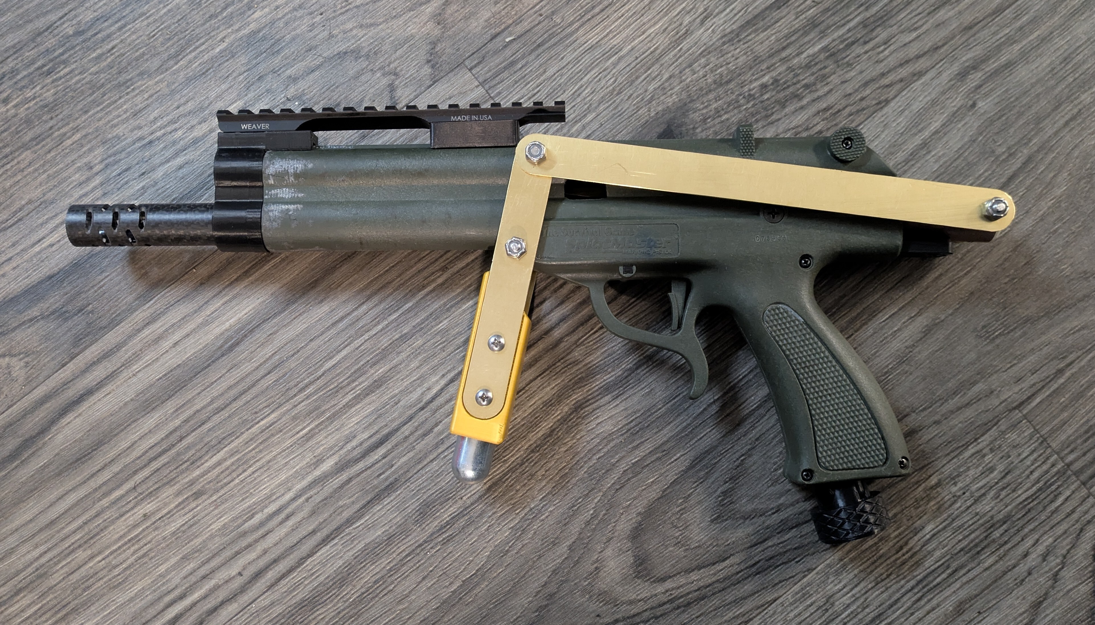

    Put together for the first time and pumped it a few times.
    It can shoot surprisingly fast and is super natural to use.
    The top rail started to come off from the vibration, so I'll need to figure something out.
    I'm also thinking about cutting a window in the bottom tube to expose a bit more of that carbon fiber.
    But first, I need to make a better detent, that tiny little bb flew out and I can't find it (and it's not that good anyway). Not sure how to implement it. Maybe some spider detent finger thingy?
    Click image for larger version  Name:	PXL_20250212_033706096.jpg Views:	0 Size:	2.22 MB ID:	655745
    Yes, it's a 12g sticking out of the lever handle, storage of 1 😁

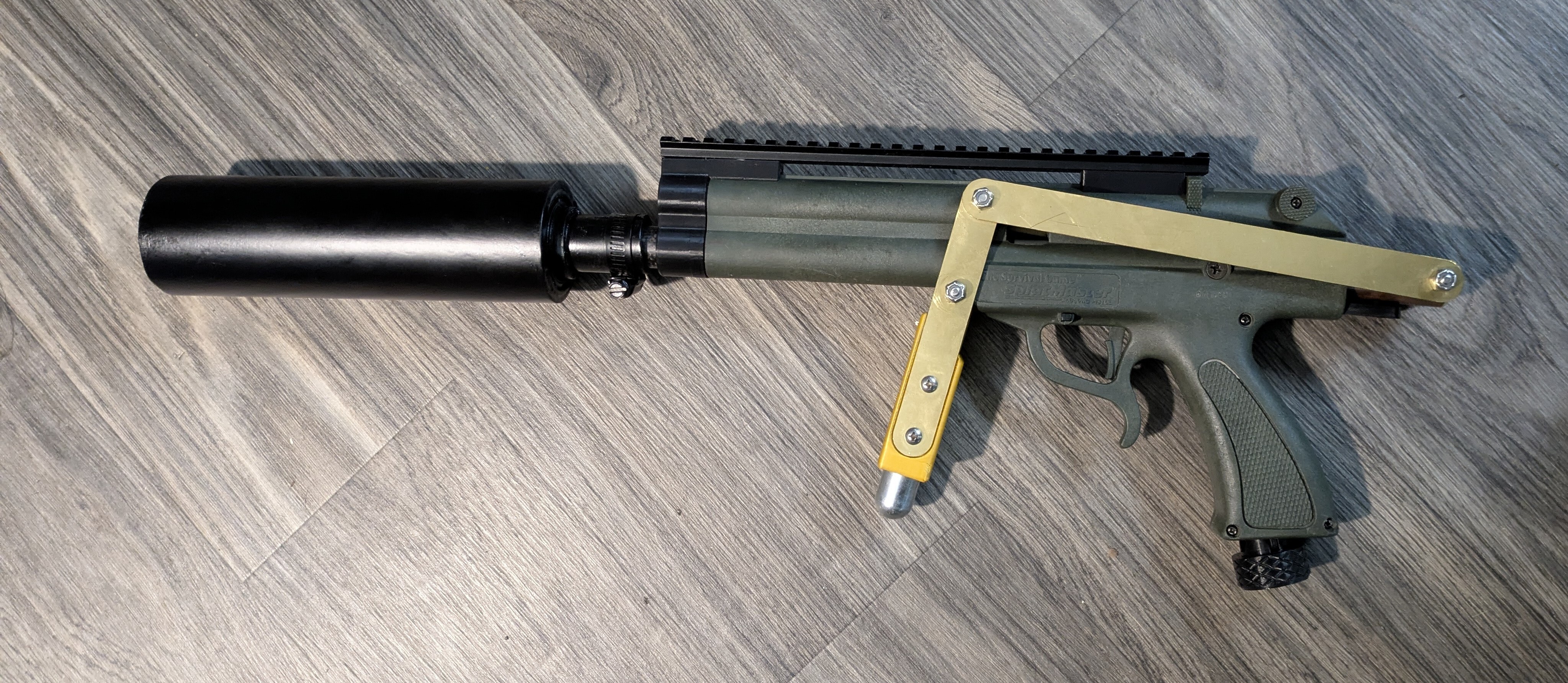

      Notice any difference in velocity with and without the 12g in the lever?
        XEMON
        commented
        I haven't tested that yet, but i definitely will 👍

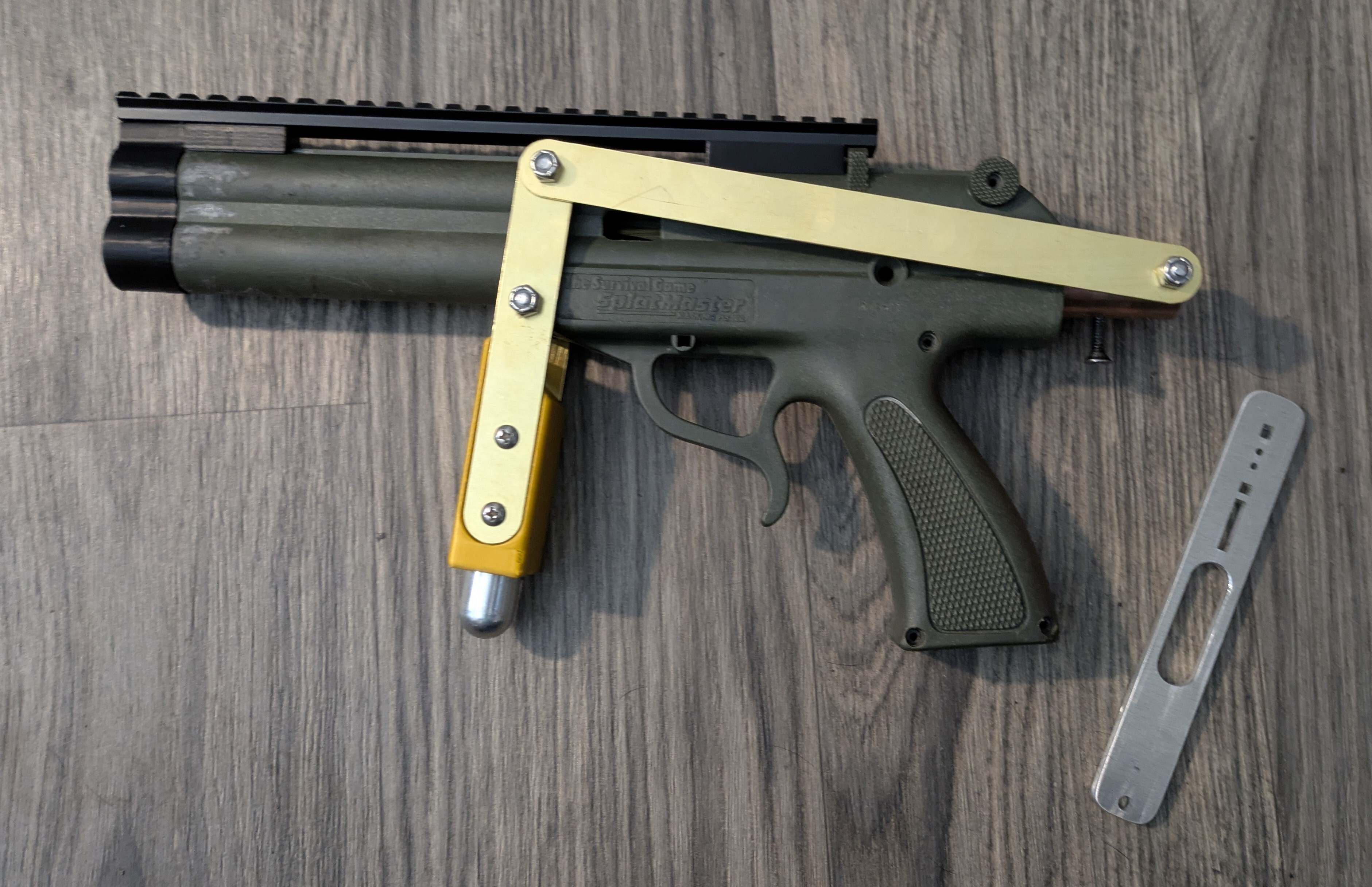

      New, longer top rail that actually bolt down into a spacer on the rear empty compartment so it's not going anywhere 😁
      Also got the metal slider plate mostly done (actually got 2 mostly done 😁) but I'm not sure I'll have time to finish and fit it before the due date, so I'll put it aside for now.
