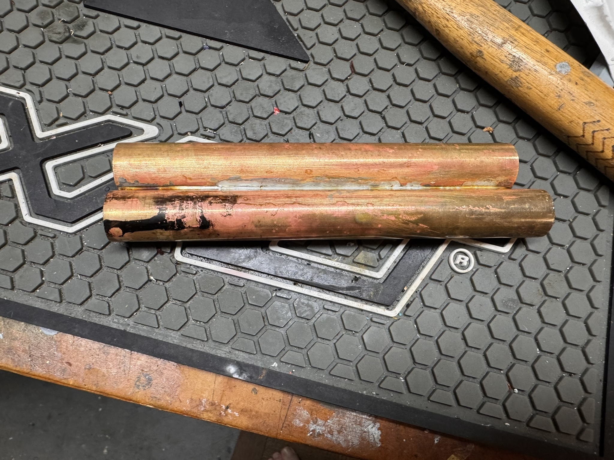

    Well, it looks like Im going to be changing plans. I mocked up some levers but couldn't wrap my head around the engineering aspects. So imma build some brass, not quite sure what yet. But I'll update y'all when I figure that out.
    For now here's a photo of the results from learning how to braze

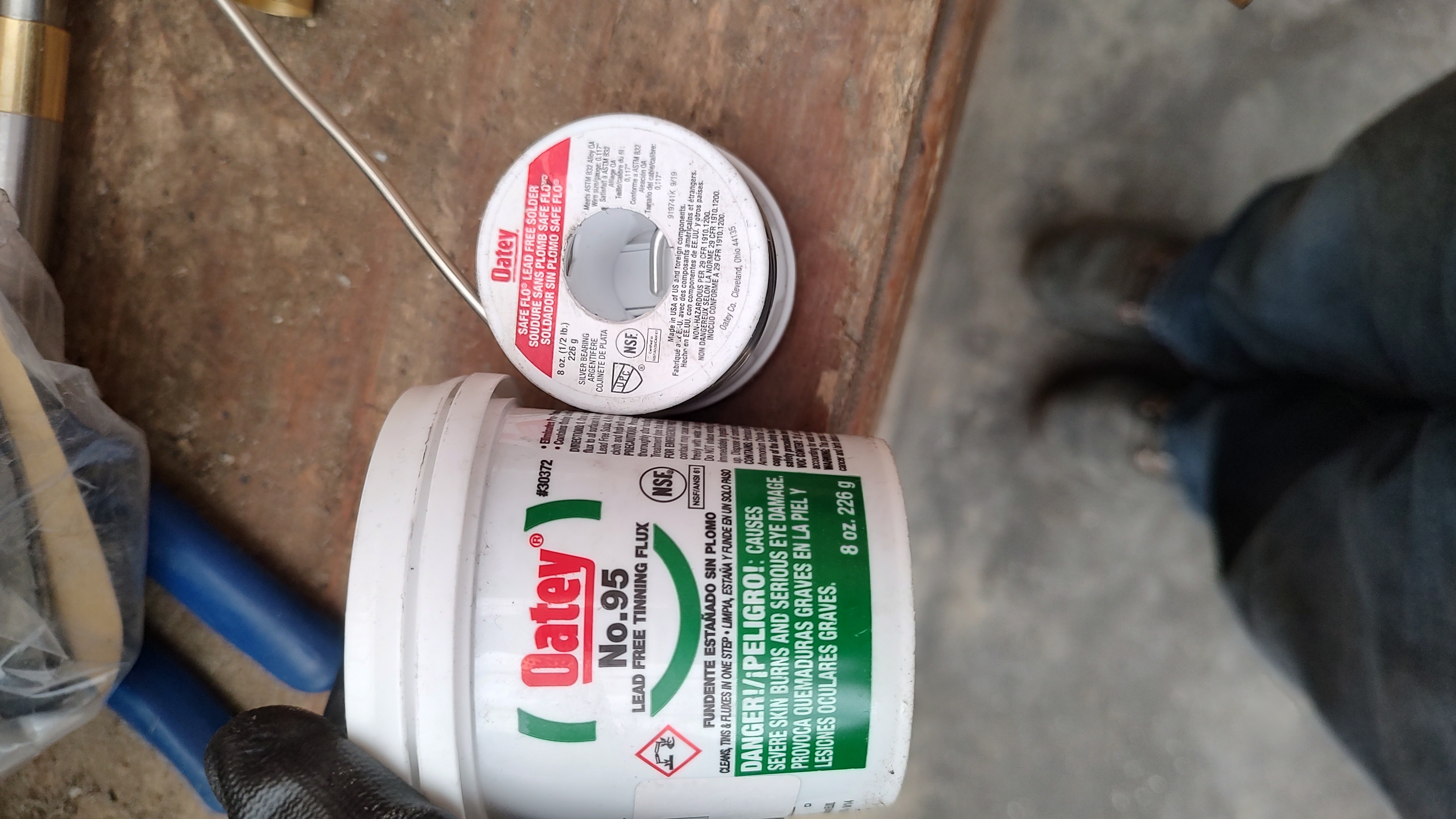

    Well you got a start,what kind of solder are you using?
    • Impactfour
      • 888
      • Coventry RI
      This stuff

            Yeah I agree with the rest, those look like cold joins. Basically you melted the solder but the brass wasn't up to a temperature that would allow it to bond

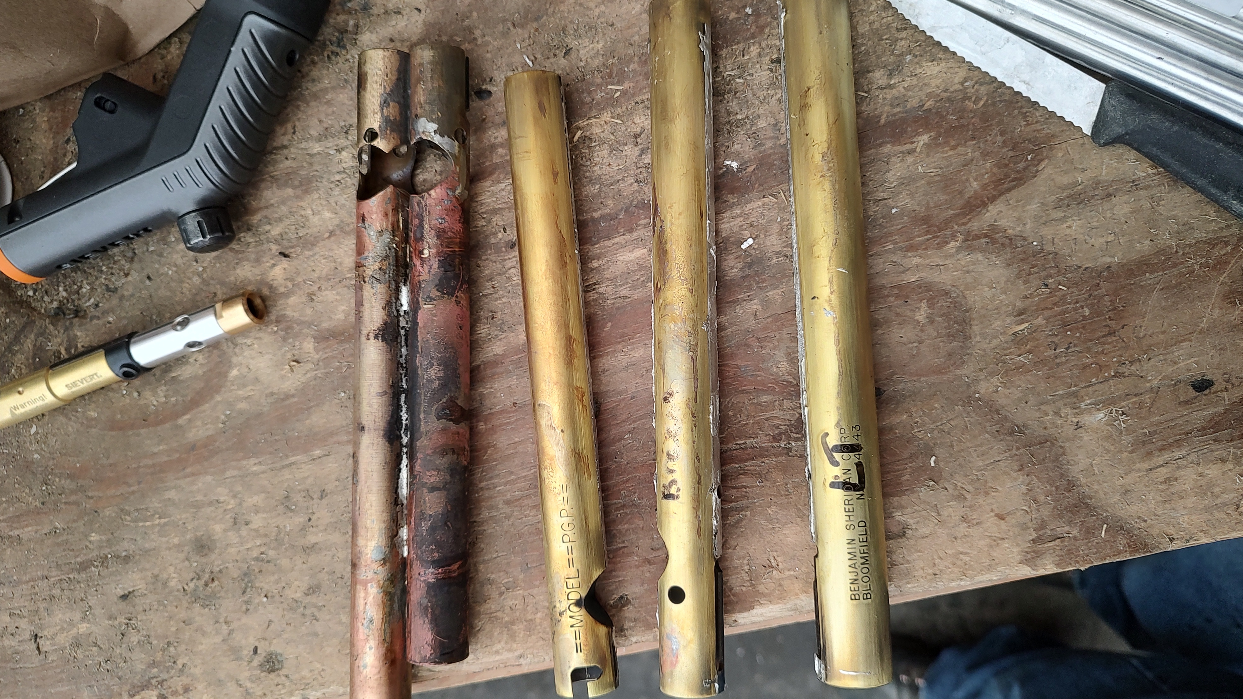

                So I got some practice brazing today, and I think it went worse than my initial attempts. Which leads me to a few questions:
                1) is the flux supposed to be liquid or paste at the begining? I've been keeping it in our work tent and it starts off pretty solid, then bubbles and melts when I apply the heat.
                2) how long do you guys apply heat with a map torch beforehand? I'd guess my best attempt came after a little more than a minute of heat being applied to one spot, the brass was a pretty bright red by then.
                3) will the overall ambient temperature screw with things? It was somewhere around 30* in the tent I was working in.
                Collection
                GITM based out of Warzone RI
                  I. Am. Canadian. 🇨🇦
                  • 3514
                  1- the flux is a paste at room temperature. It melts and flows into the seam when heat is applied. I find once it starts to bubble, it's almost ready for solder to be applied.
                  2- heat evenly - just holding it one one spot will overheat that spot and underheat everything else. You want to "paint" the tubes with the torch along a couple of inches, back and forth. Once the solder starts to flow you can start moving the torch along the seam.
                  3- ambient temp definitely makes a difference. Soldering in the summer is much easier than in freezing temperatures, in my experience.
                  You're also likely fighting the solder you're using. Silver solder melts at a much higher temperature than conventional solder, and unless you plan on powdercoating it, not really necessary.

                    Welp - I jumped in head first this evening.... I'm soooo hooked - I've done my share of copper sweating around the house but never a long butt joint like this with brass. I cannot wait to get that last of my brass order from online metals and dig in. what fun.
                    key take away? less is more - just like sweating plumbing. less heat than you think, less flux than you think and less solder that you think. pre goop the joint like jordan said. pre- heat the tube not the joint and watch the flux... as soon as it bubbles get the solder in. MAP gas is soooo much better and quicker than propane. Need to find a thinner solder so you can get it down in the crack and not all over the place. also thinking about cutting small chunks and putting them along the joint and melting them in so you have more control...
                    here's my second go around. time to take it apart and try again!
