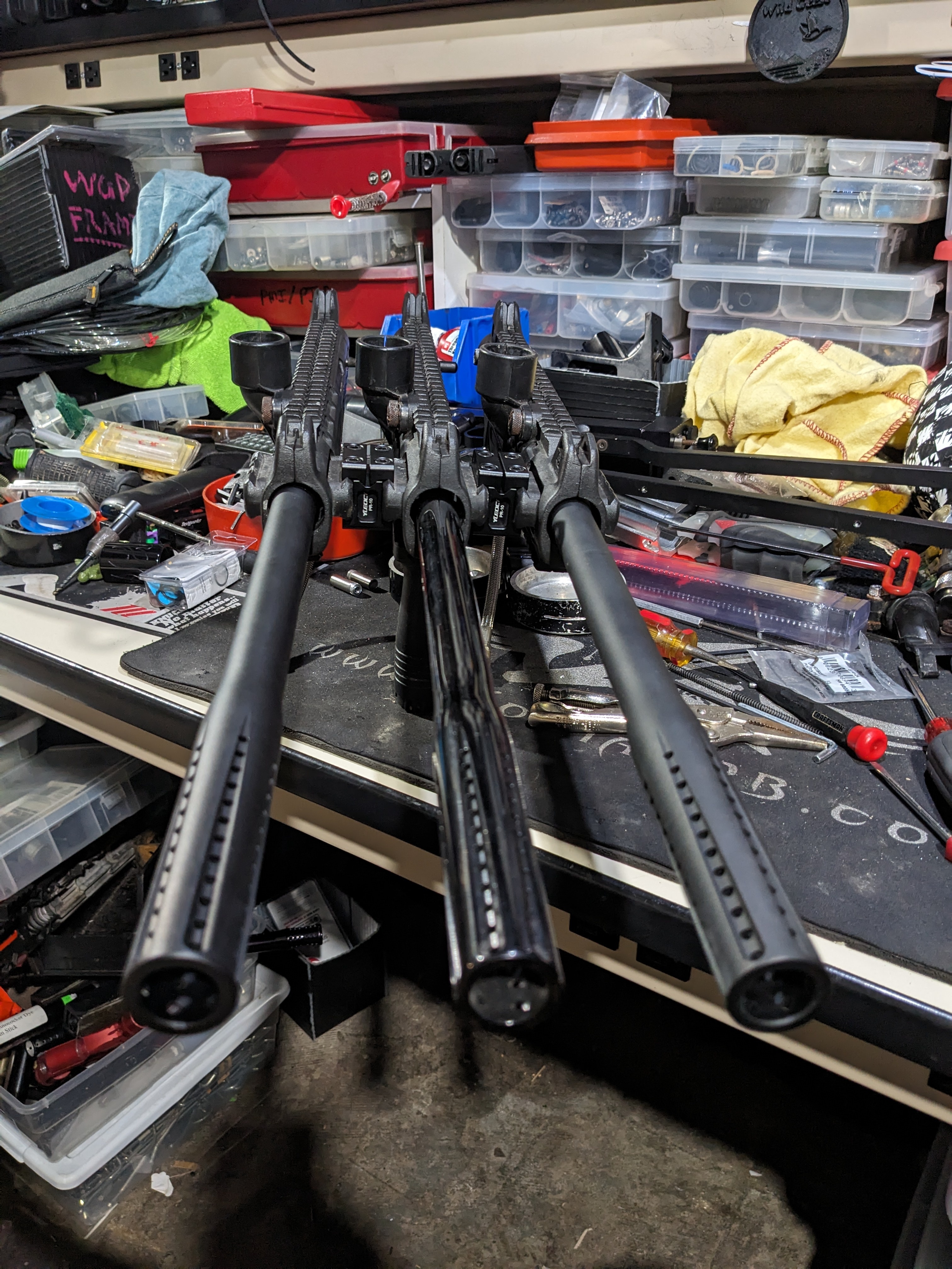

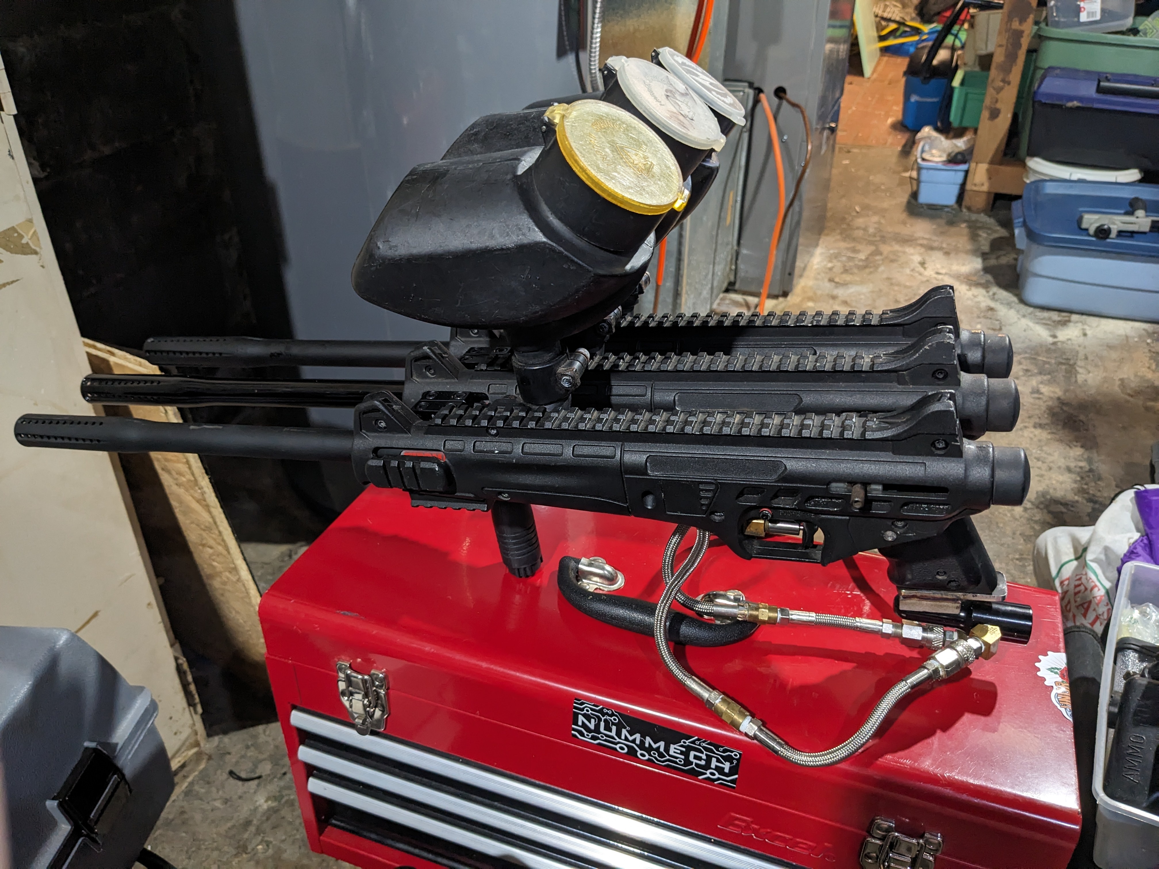

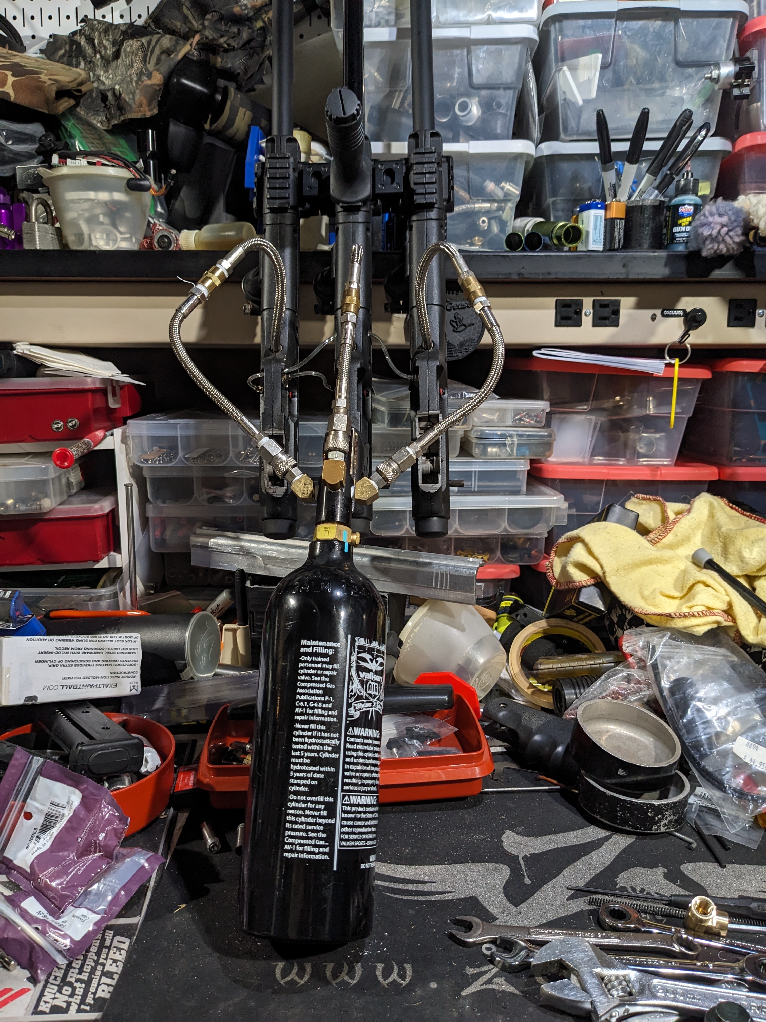

    So a bunch of years ago I experimented with with over under Tippmanns where the rt/blowback excess gas port goes into a ram to fire the upper gun.
    It was quite successful... I built two versions one still exists in my arsenal today. Which lead to the question.
    How far can this go? Technically infinitely so long as the guns all have enough gas to fire the next.
    Right now it's a triple but I might work it into a quad.
    There's still lots to do though

    So. In its current state. You fire the center one, and a split second later the outer two fire together? Or are you plumbing it that the first fires the second fires the third?
      Ecapnation commented
      It will be set up center fires the right, right fires the left. There's a slight delay between shots.

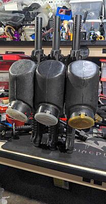

    • 4421

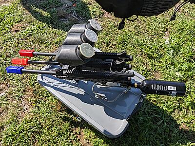

    Well.... They all work and best yet hoppers fit no mods!

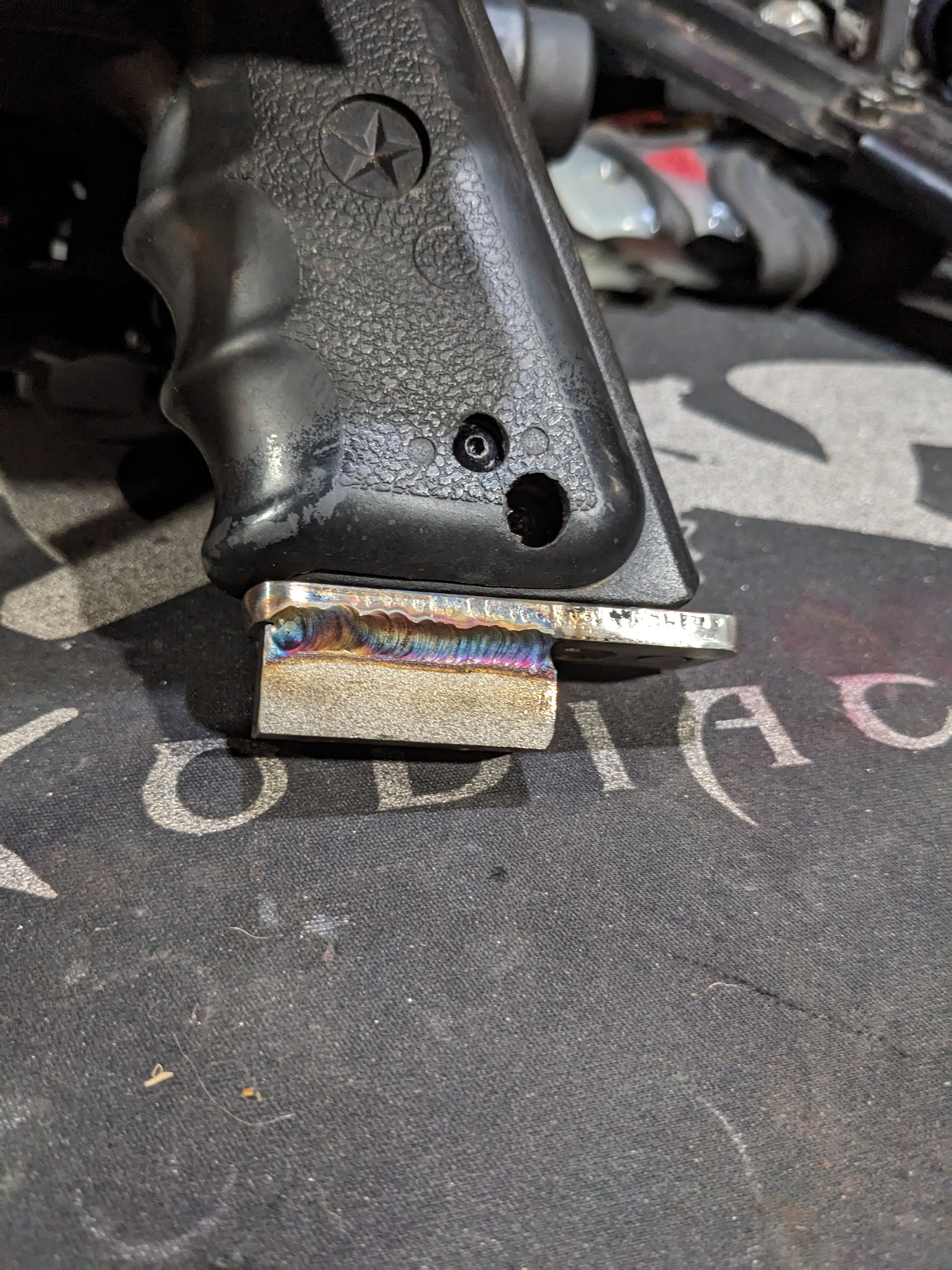

      Fun little rework piece.... The clunky steel bench mount has some stainless on it so I sanded off the paint and welded on a block to mount and clear an asa.
      It's the little things... And this was scrap bin free!

      A better weld on your poo ASA than Ive been seeing on my stainless cabinets as if late.
        If it's worth doing it's worth doing good.

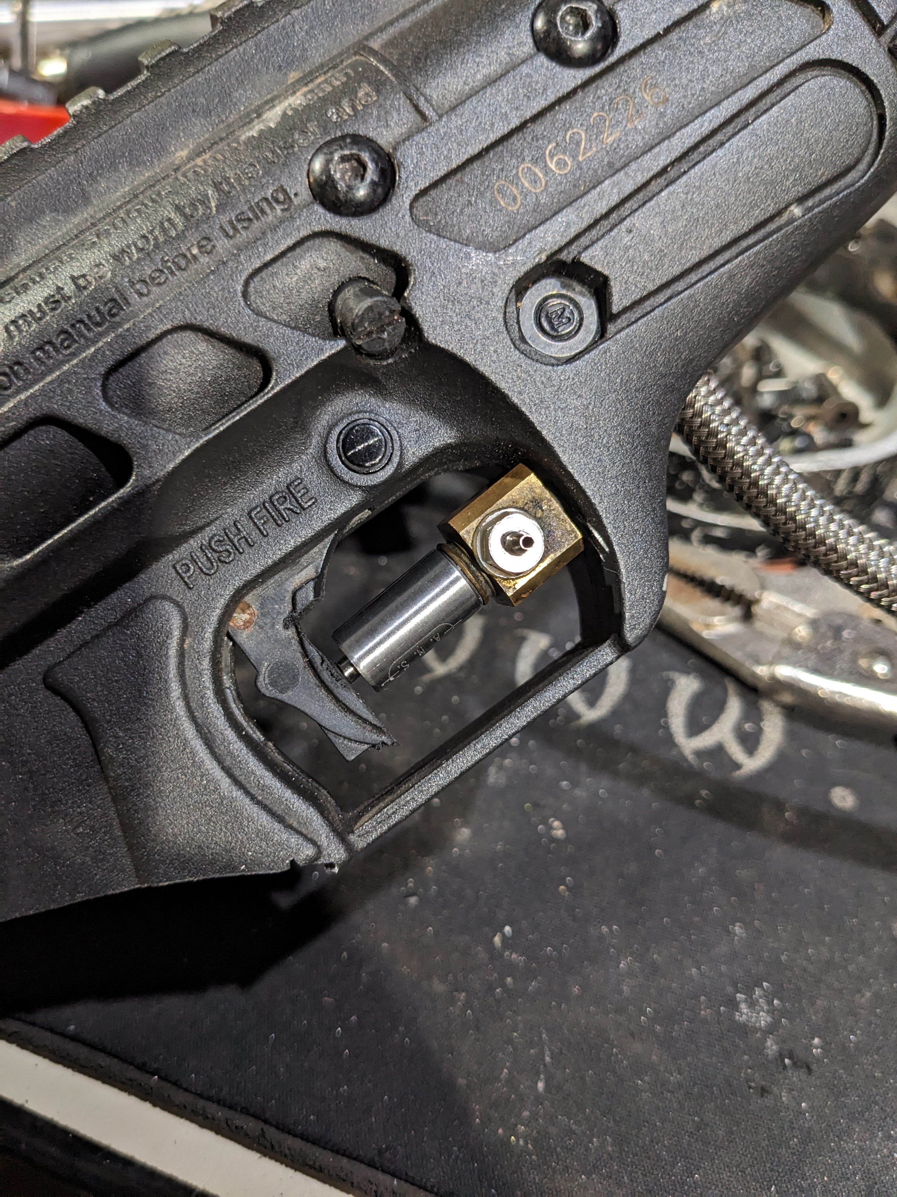

      • 4421

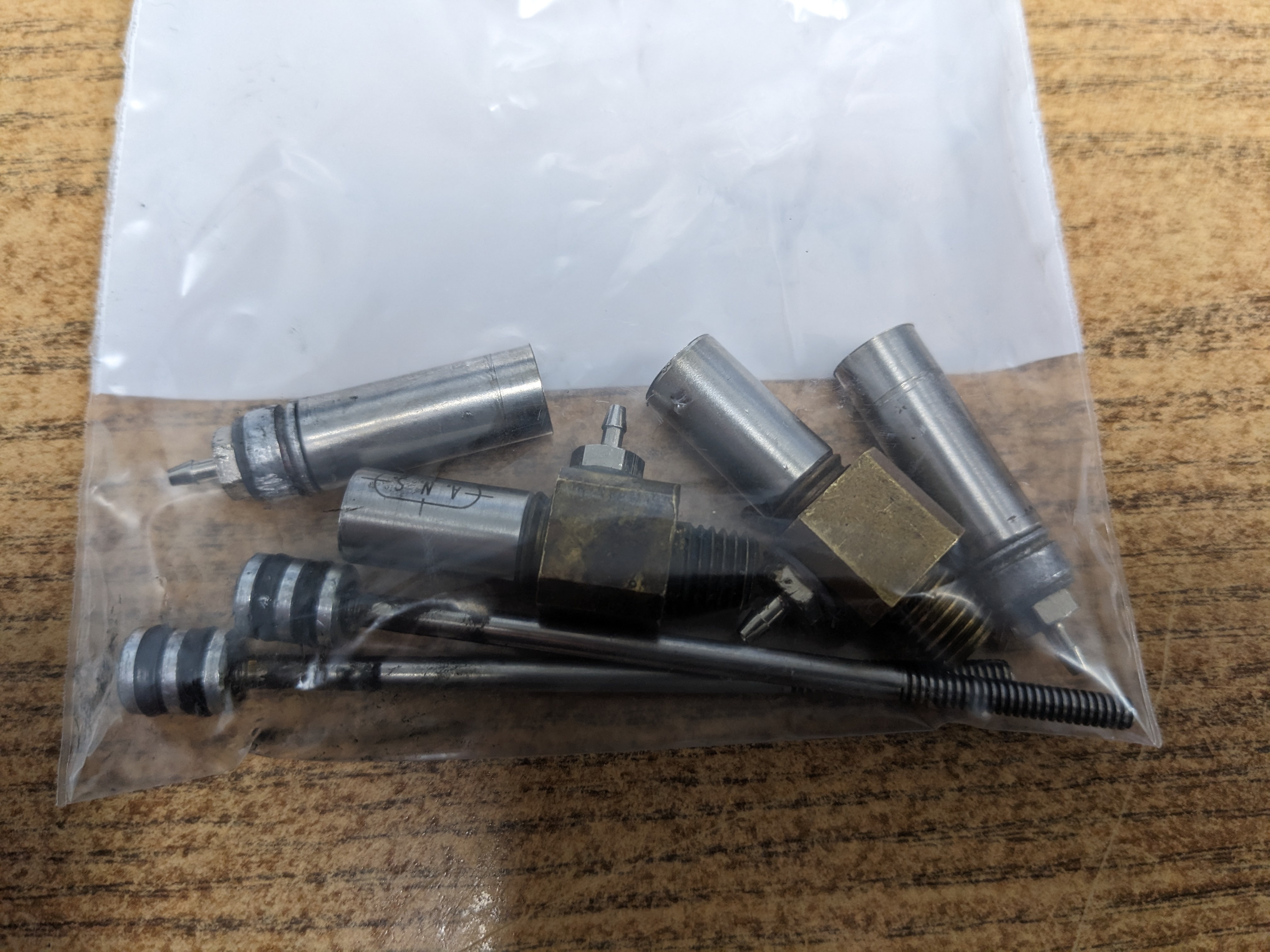

      Cutting, crowning and rehoning crap ans rams into single action trigger pistons with nose mount threads!

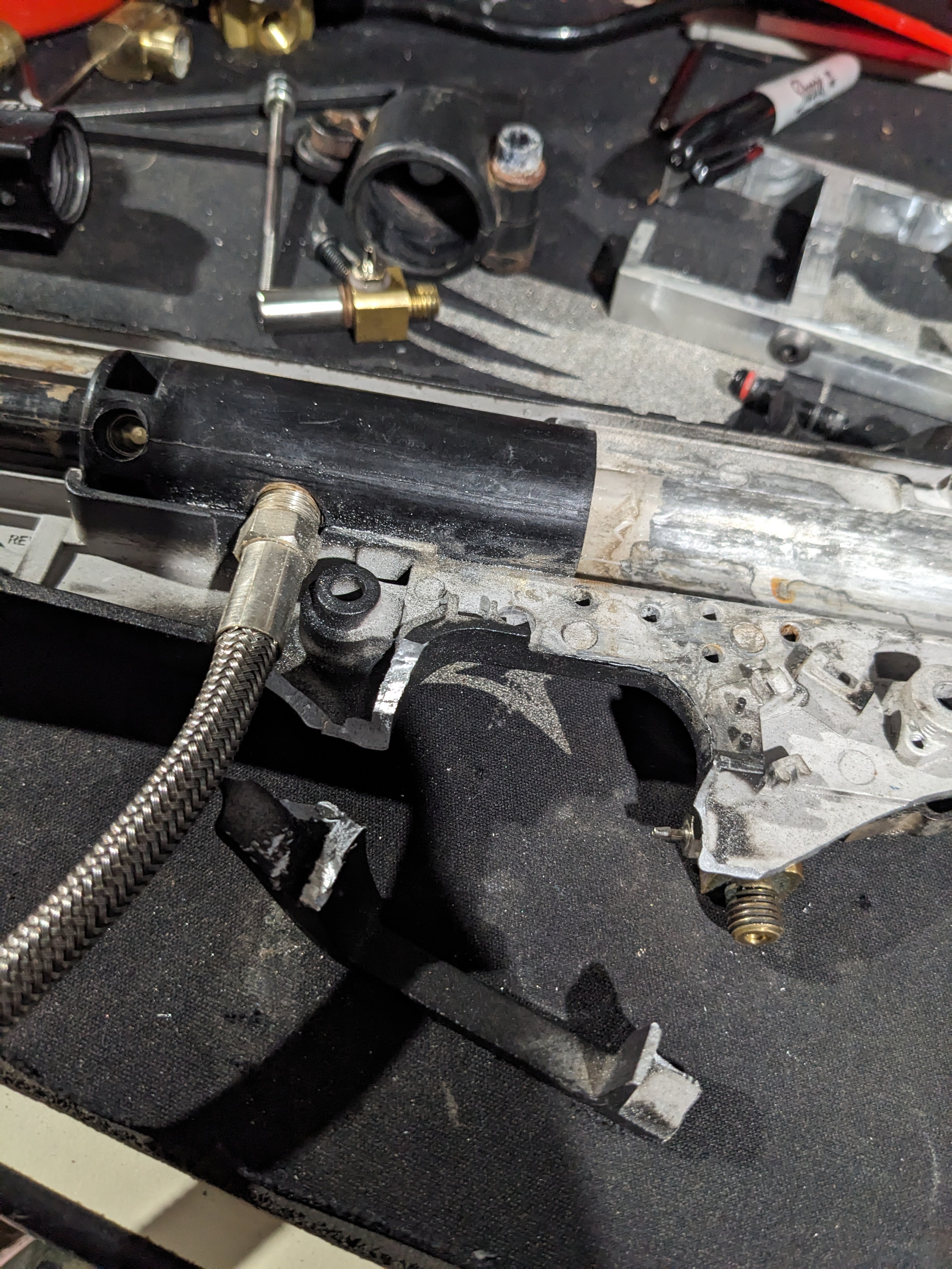

        • 4421
        Welp.... I broke one. Badly.
        Tried to cut a bit aggressively and broke a body

        • 4421
        Recovered from last week with and extra free body half.
        One third is all fixed up shooting and has the piston mounted!

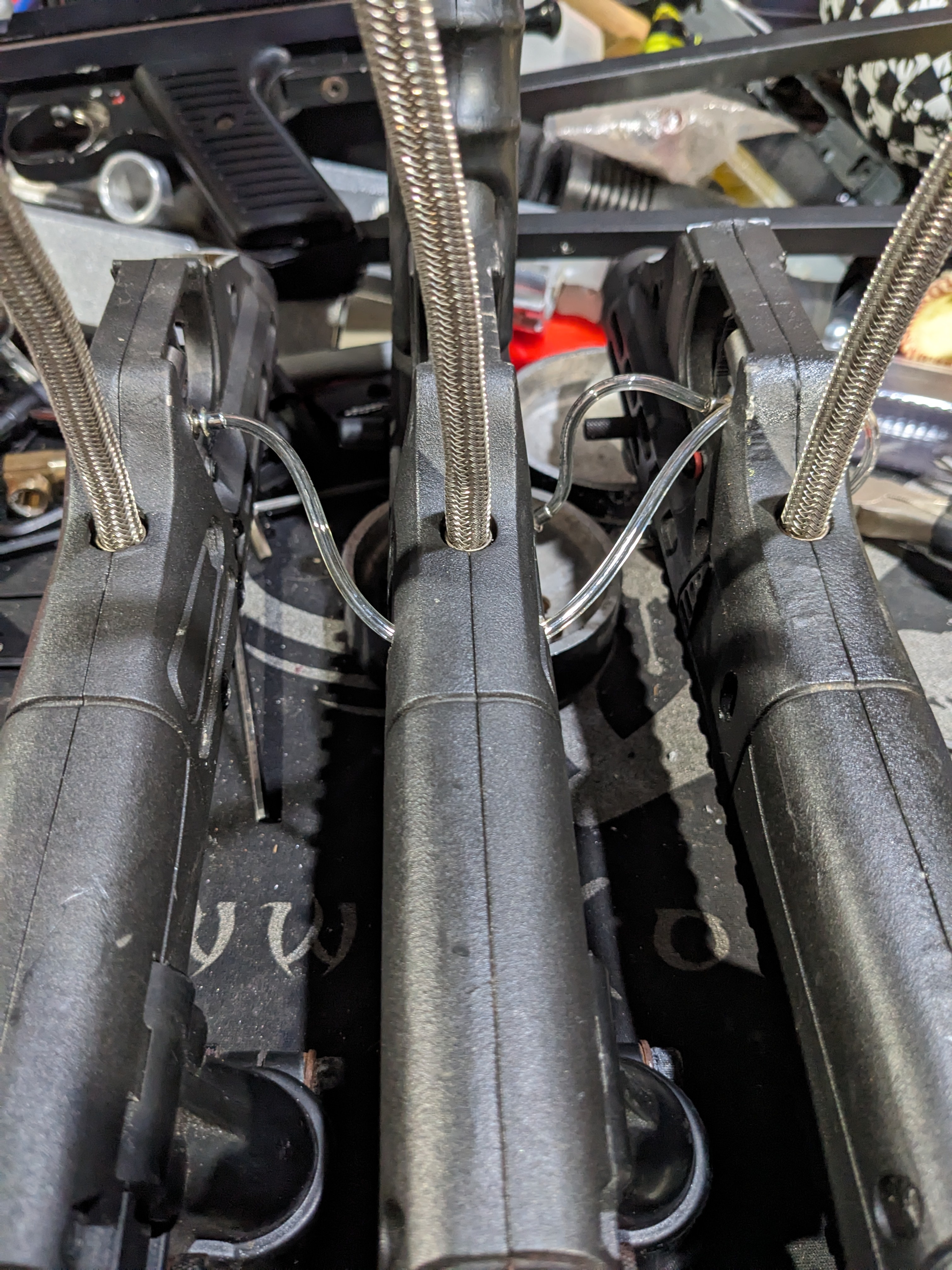

          • 4421

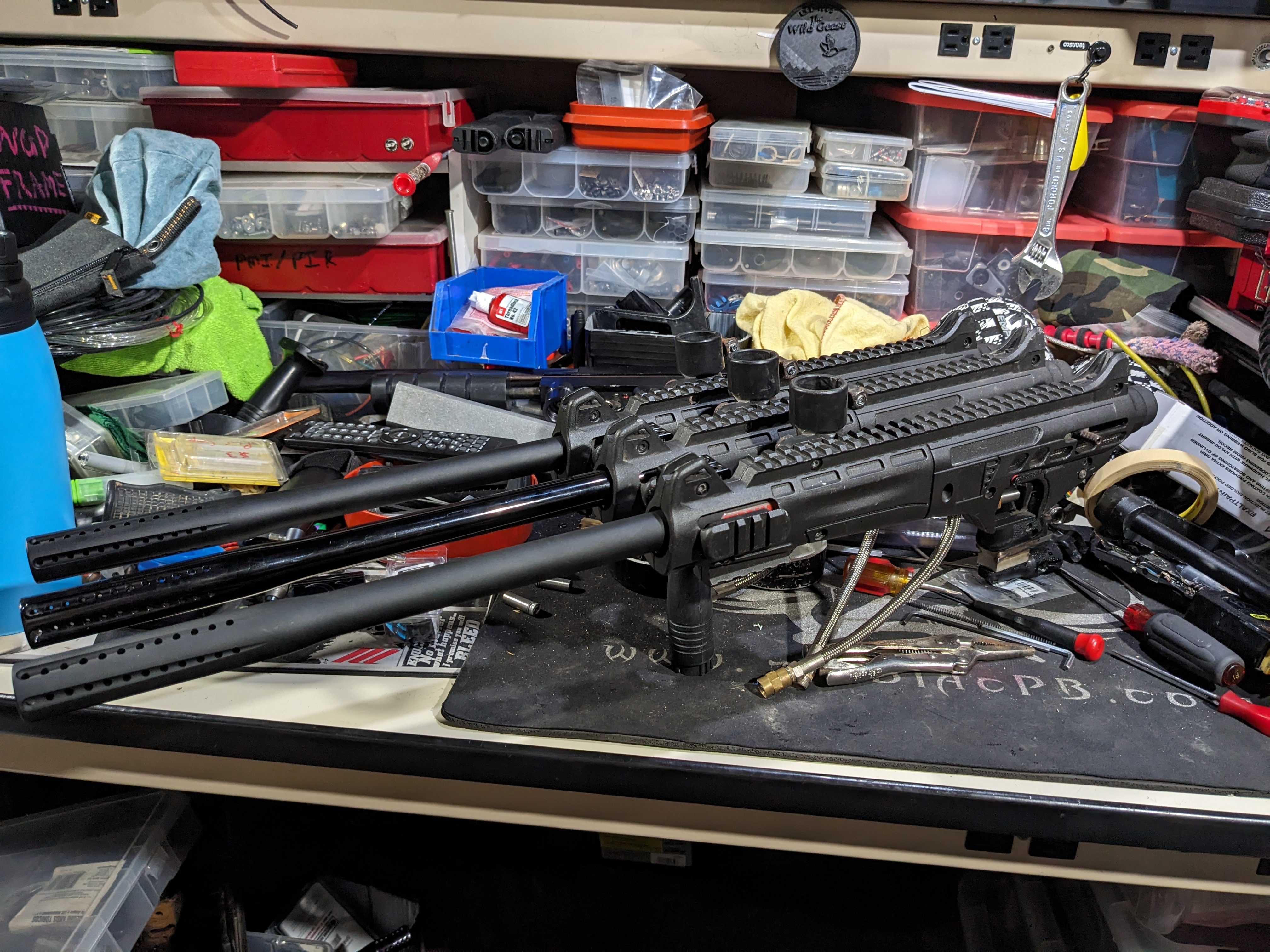

          Oh she's coming together nicely...
          Only thing left is sorting out plumbing this thing. I left the stock braided line on because I'm not resealing the valve for the third time on one of them.
          You can see the pneumatic routing of center shoots right rights shoots left. I decided to keep it clean by drilling through the center guns body

              In my previous over unders there was a slight delay that was more audible than visual. It was very barky.
              This is slightly uncharted waters for me as I never did a linked triple. The idea with the firing order was if the center gun clears the bunker than the rights already out.... I guess if I reversed it with the right firing last it would be like a fading sneaky shot.
              there will be video once I get it totally together and running.

              Yes.... Yessss good.
              It works and the delay is such that the thing sounds like it's running out of air.
              It's somehow both heavy and comfortable to shoot.

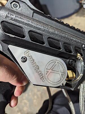

              • 4421

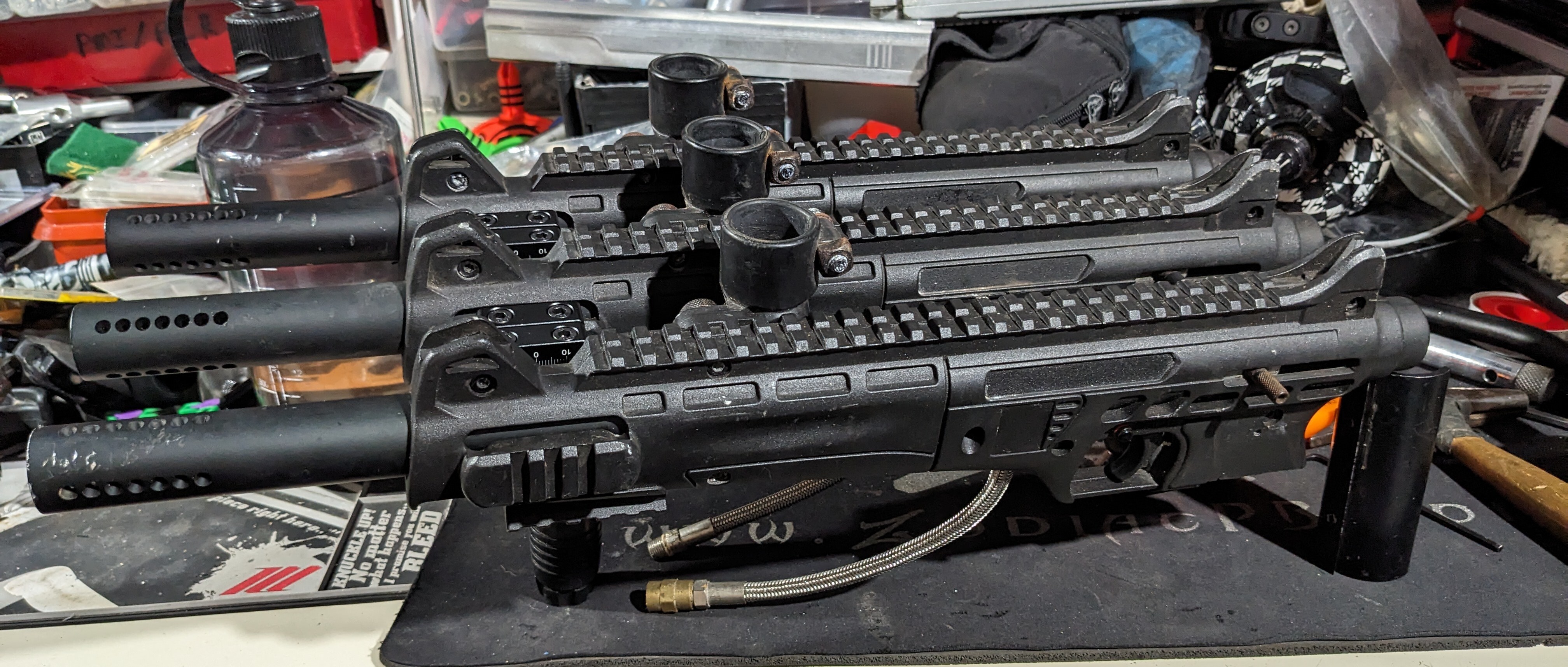

              Ok... Now we're done.
              Bribed my night shift laser guy with dinner with the last $20 I had and had him cut and engrave some side plates
