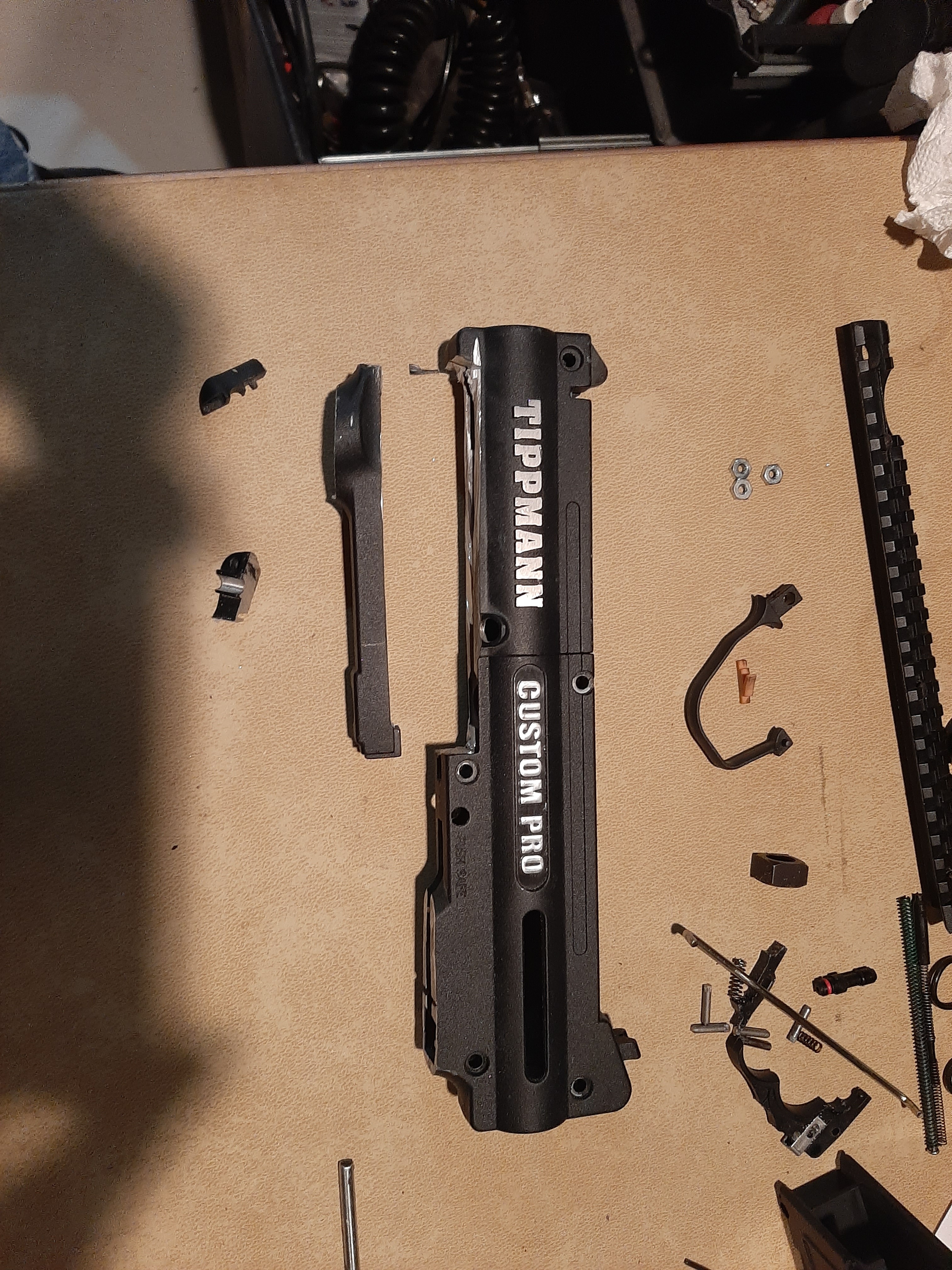

          Item arrived and here is the first assessment. The rubber bands were holding the top foregrip. That piece was cut and the flange that went under the band is gone. Therefore, a new internal clamp system will need to be created and added. The marker body needs extensive trimming. The old feed port will be filled in. I may add a detent. The mag well location must be cut out, and a mag well installed. The inside of the stock needs to be milled for the marker body. The front pipe band has been removed and replaced with a real rifle barrel band. The air supply will need to be custom made and routed inside of the stock. Because this is semi, a remote line connection will be routed though the stock with the quick connection visible on the underside of the buttstock. Pictures and progress to follow.

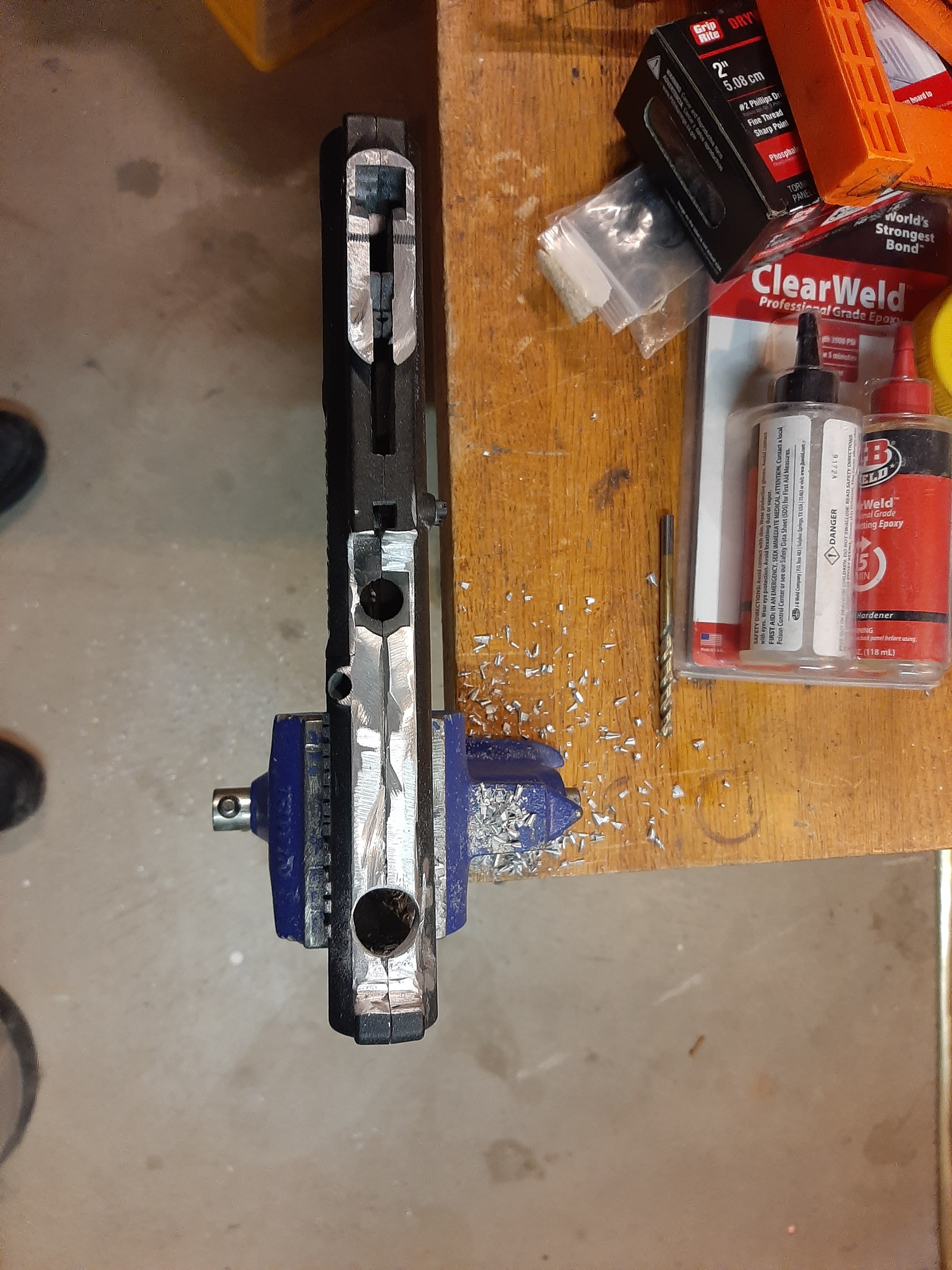

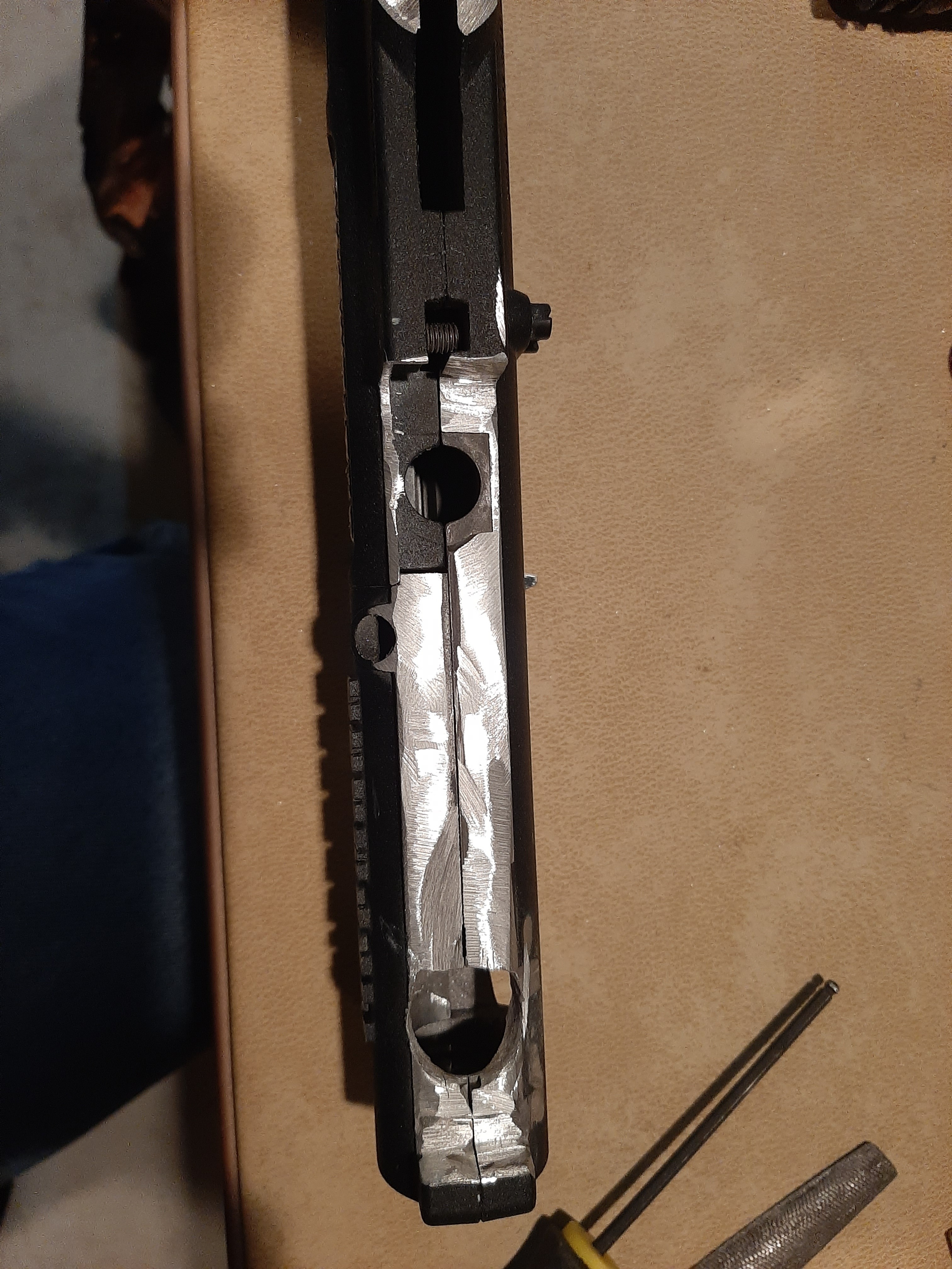

                  So here is an update on the WW2 Custom Pro. I cut the marker for mag well and better fit in the stock. I drilled the bottom for bottom feed and D shaped for FS. Decided to use the Dmags. Not sure if I'm going to build a mag well from sheet metal or fit a premade one. See the progress below. Next to custom fit air line through the stock. resolve the mag well. secure marker in stock, without tape or rubber bands. secure top fore stock.

                  The scratch path is due to a tight fit in the stock. I don't want to remove too much wood. It may cause failures in the stock
