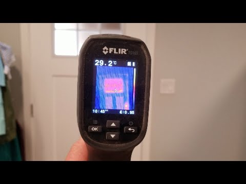

                is this vid from kindred spirit aVe about evaporative cooling of any value here?
