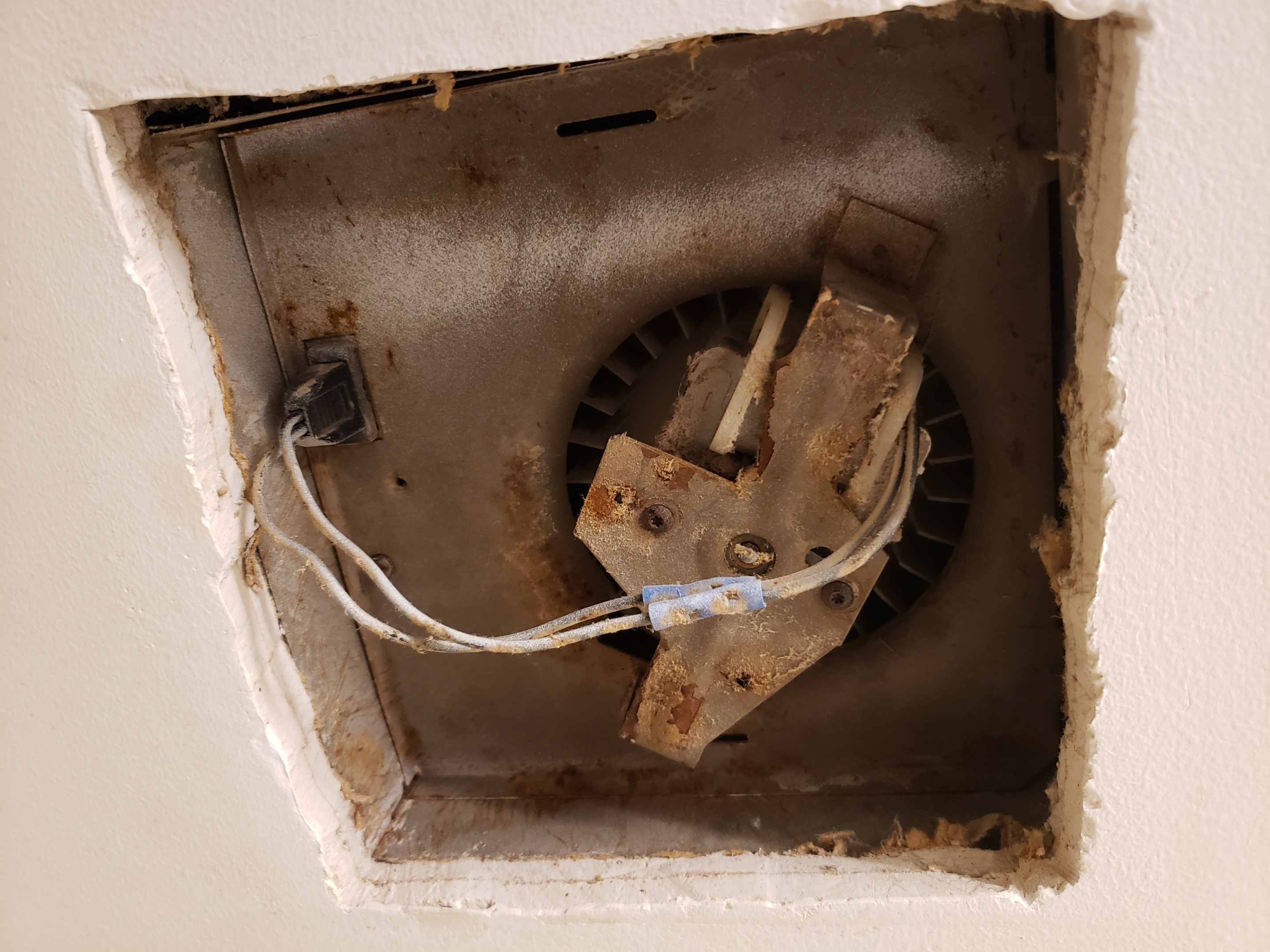

      Okay, got the fan fixed for the most part, but I still want to replace it anyways. The fan is on the noisy side, and doesn't even have bearings in the motor, has bronze bushings. It was temperamental, but a good cleaning got it running again.
      Fan looks to be blowing into the attic, which is one reason I want to change it.
      House was built in the early 60s, single story ranch.. have attic access, which i think im going to need based on what I see.

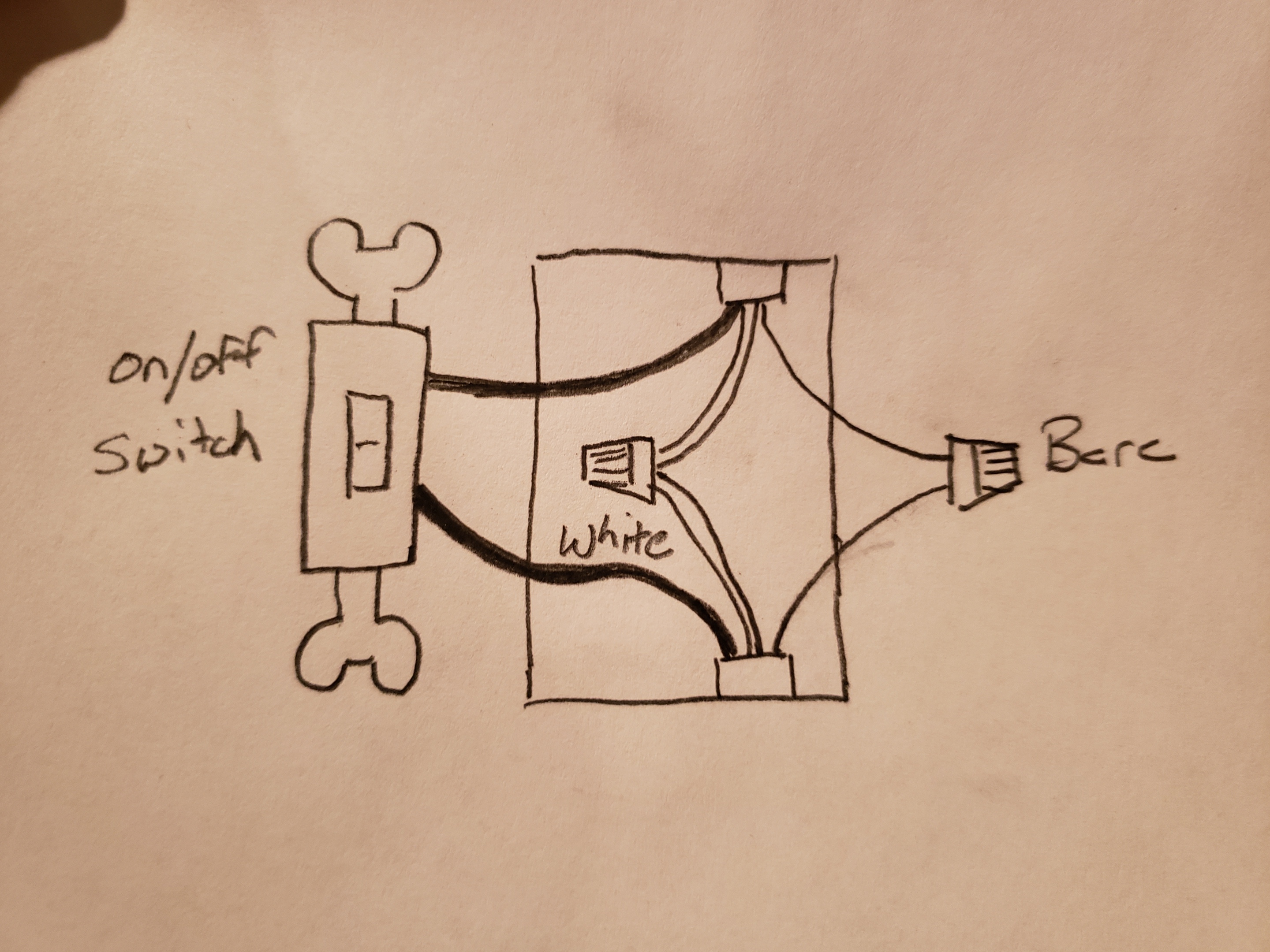

      Fan currently is just a fan, no light. It is controlled by a simple switch in the bathroom, which I have drawn what the wiring looks like.

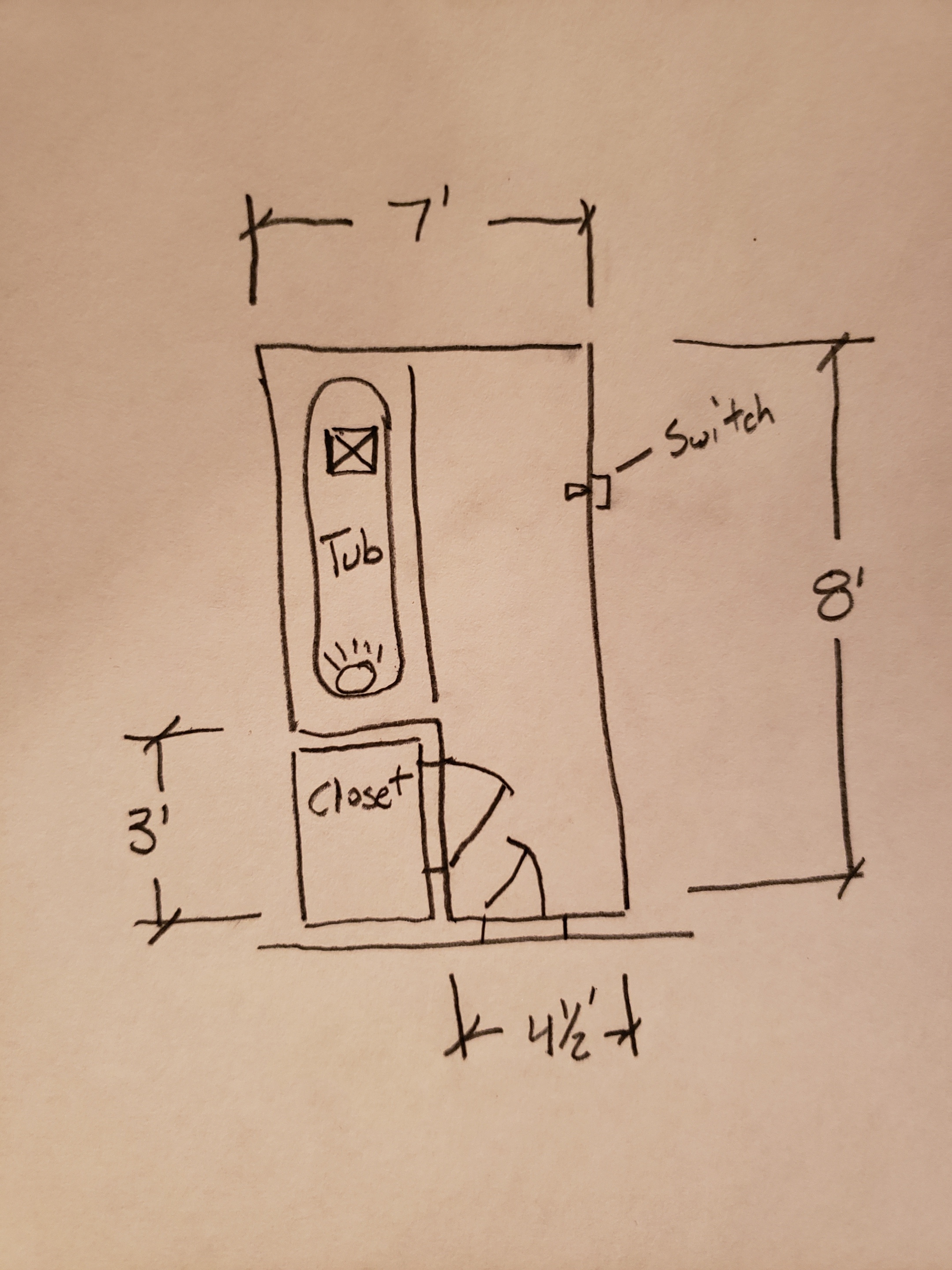

      Hole in the ceiling is 8" x 8-1/4" currently, and is placed over the back of the tub (not the shower-head end).
      Room is approximately 7' x 8', so about 56 sq ft. There is a closet in the room taking up about 7-1/2 sq ft of that.

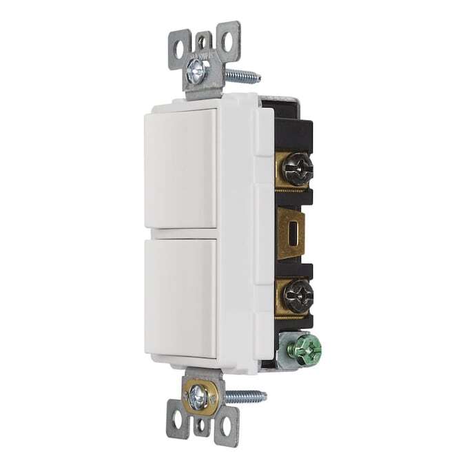

            They make switches that have multiple switches in a single "bay" to avoid having to cut in a larger box.

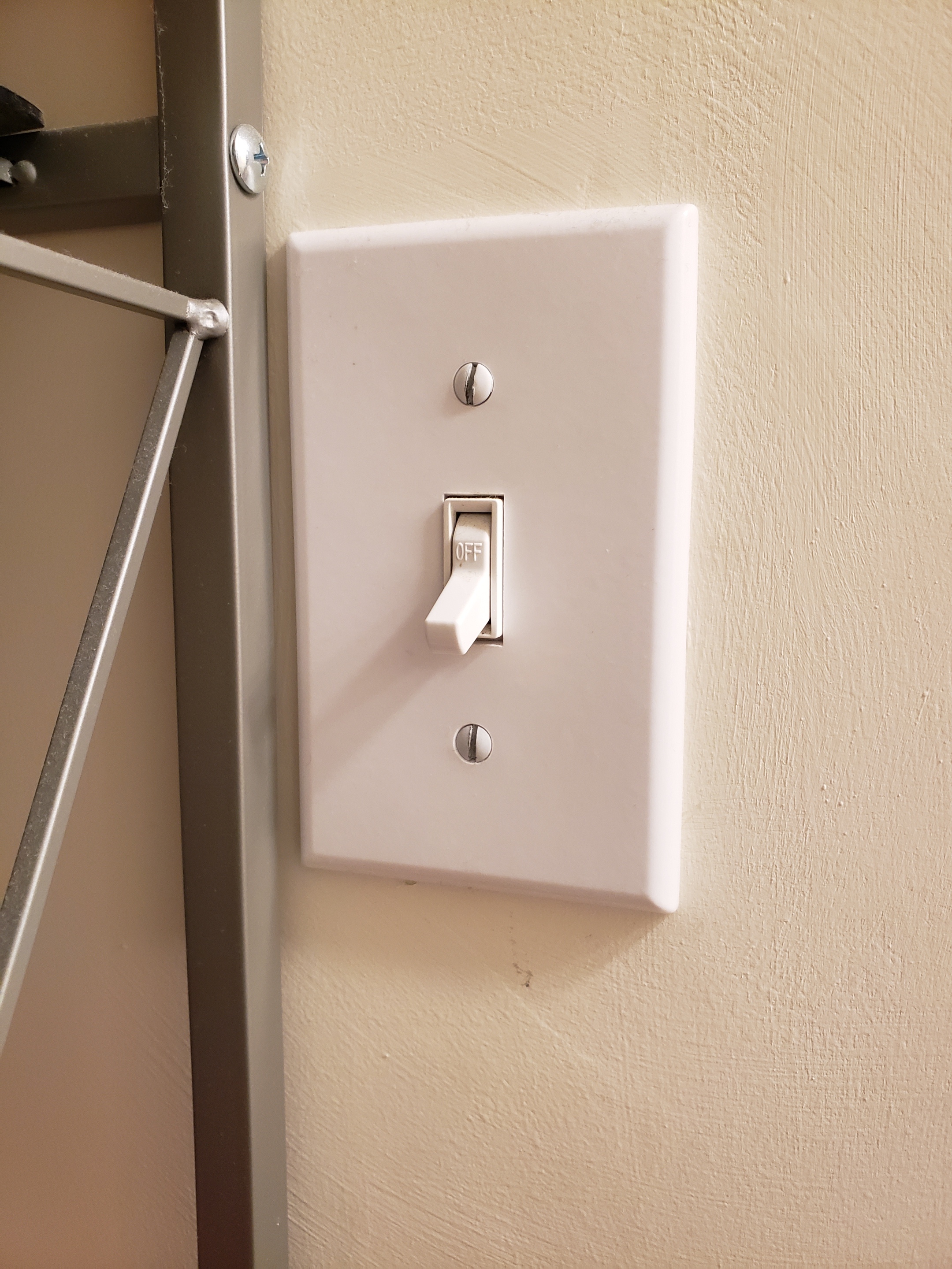

                          The switch is aboit 36" down from the ceiling. No crown moulding, so should be pretty simple.
                          The horizontal run of wire (running in the attic) is stapled to the roof trusses every 2 feet or so.
                          Once it gets to the right spot, there is a hole in the top 2x4 of the bathroom wall, and it drops the ~36" down to the switch box.
                          The vertical run does NOT feels like it is stapled inside the wall to anything. This would be a home run for me, as I could use the old 3-wire to pull through a new 4-wire, and use the dual switch like I had posted above to run the fan and light separately.
