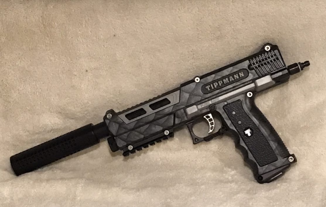

        I hydrodipped my TiPX (sold now)
        it’s not terrible to do, just take your time. It was pretty durable too

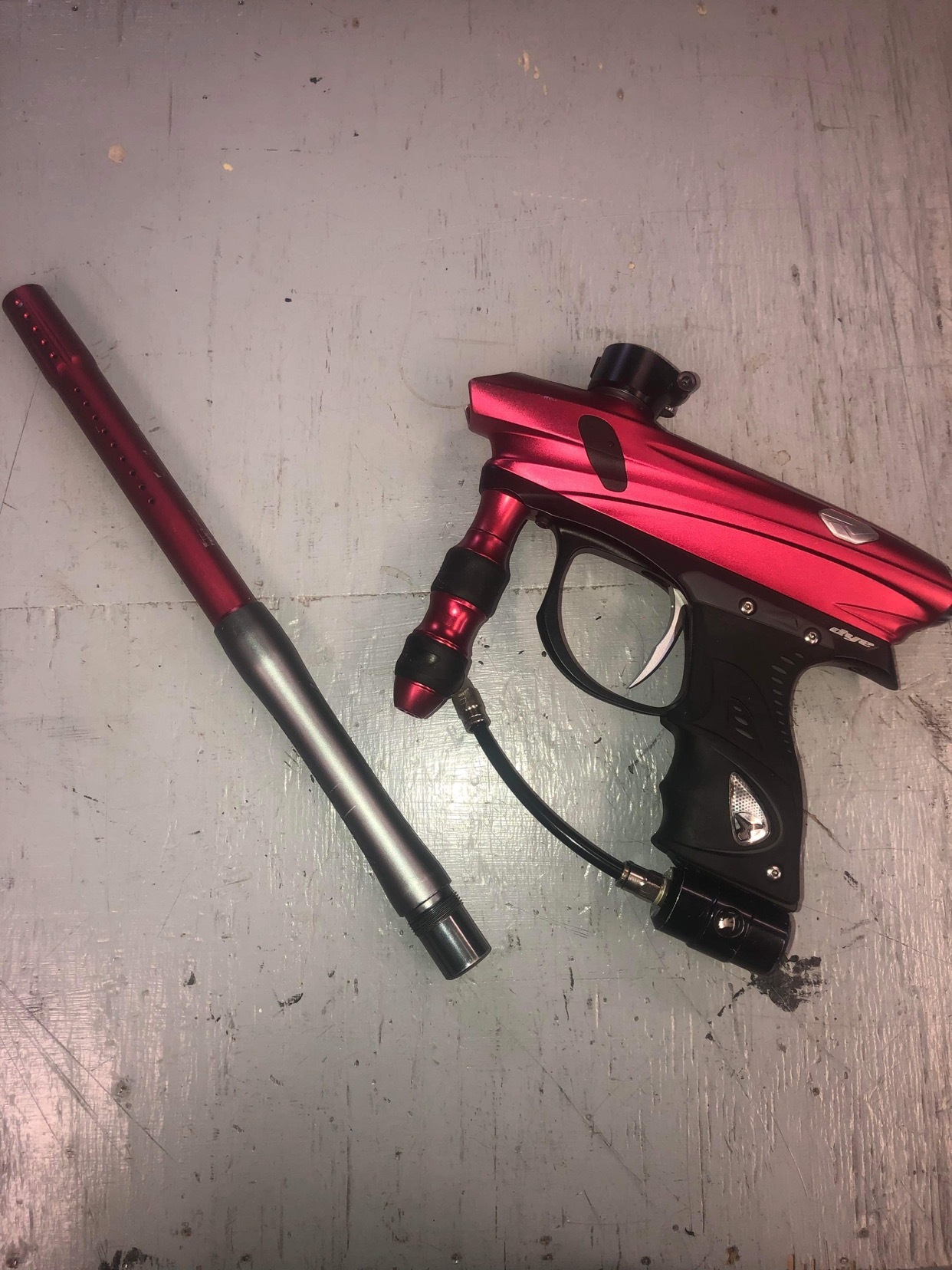

              This is what I’m wanting to wrap.

                  I dipped mine myself. Just do your due diligence and prep and tape it off well. I did my TiPX one shell at a time. I also had a razor blade handy so I could trim the tape and scrape back overspray (I had painted mine with undercoat)
                  I had a lot of extra film so I practiced a couple time before taking the plunge (pun intended)
                  I think doing the barrel would be really tough though, maybe go on barrel top first at an angle with the bottom facing up? You may has to roll it as you dip it. I’m sure there is a youtube video showing you how.
