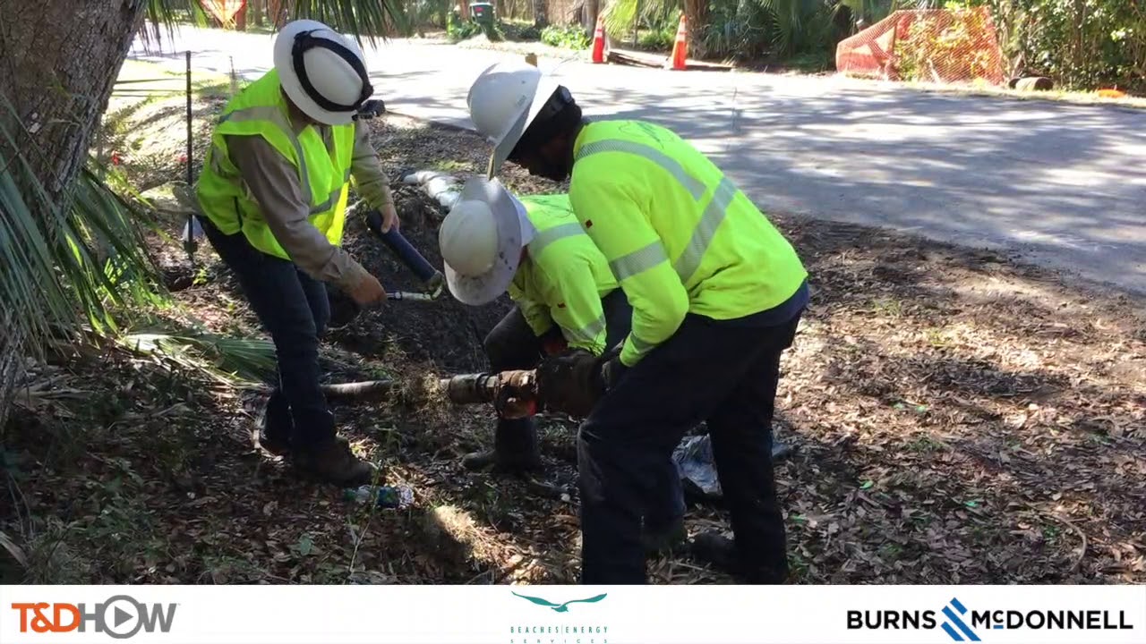

        So i am not sure what gear you are using but with Utility boring, they have a specialized machine for regular dirt boring, and another one altogether for rock boring the main difference is a sharper bit and more aggressive head. The dirt boring machine will go through rocks, pipes, concrete and other items so it is best that you call 811 before you start, to allow for the utility companies time to come mark it. The machine also has a locator built into the bit that allows for a person with a receiver to be above ground and monitor the location of the bit. I have attached a video of another crew working.

          Check @superman's videos they are more informative and kind of show what is happening.
