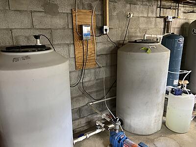

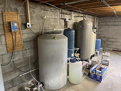

    So as you may have guessed from the title I have a question about water softeners and being as we are a community of individuals from all walks of life I thought I'd throw it out here.
    I have a house that is suppled water from a 400ft deep drilled well, it has that has a slow recharge time. In side the house I have two 200gal bulk tanks that fill from the well after passing through a chlorine injection system, that go to a pressure tank and another holding tank that feed a whole house filter that then goes into a Water Softener and a Carbon filter.
    The softener is set to flush and recharge every 8 days and the carbon filter is like every 800gallons. The problem is when the Softener recharges and flushes my well cant keep up with the demand and runs "Dry" (pumptech box tips to keep well pump from burning out )prompting me to interrupt the cycle on the softener and turning the system off for 8-10 hours to refill the well and replenish the water lost from the bulk tanks. The well pump is set to replenish after about 40 gallons of use and the softener uses so much water that it will call on the pump 2 times to fill the tank and leave it one toilet flush away from refilling for a 3rd time.
    Are there any well or water guys here that know of an alternative to a salt softener tank ? my well water is hard and has a lot of sulfur.

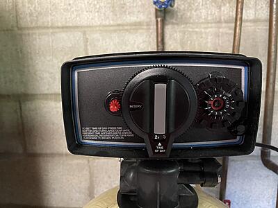

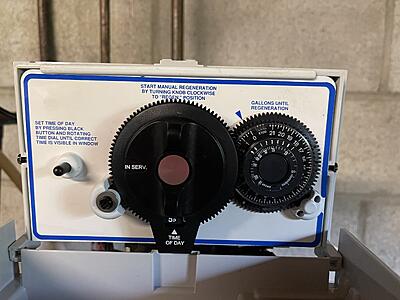

        Here’s the set up
          XEMON commented
          You're gonna be super limited in what you can actually do with this stup ... They are super reliable but you don't have much control ...

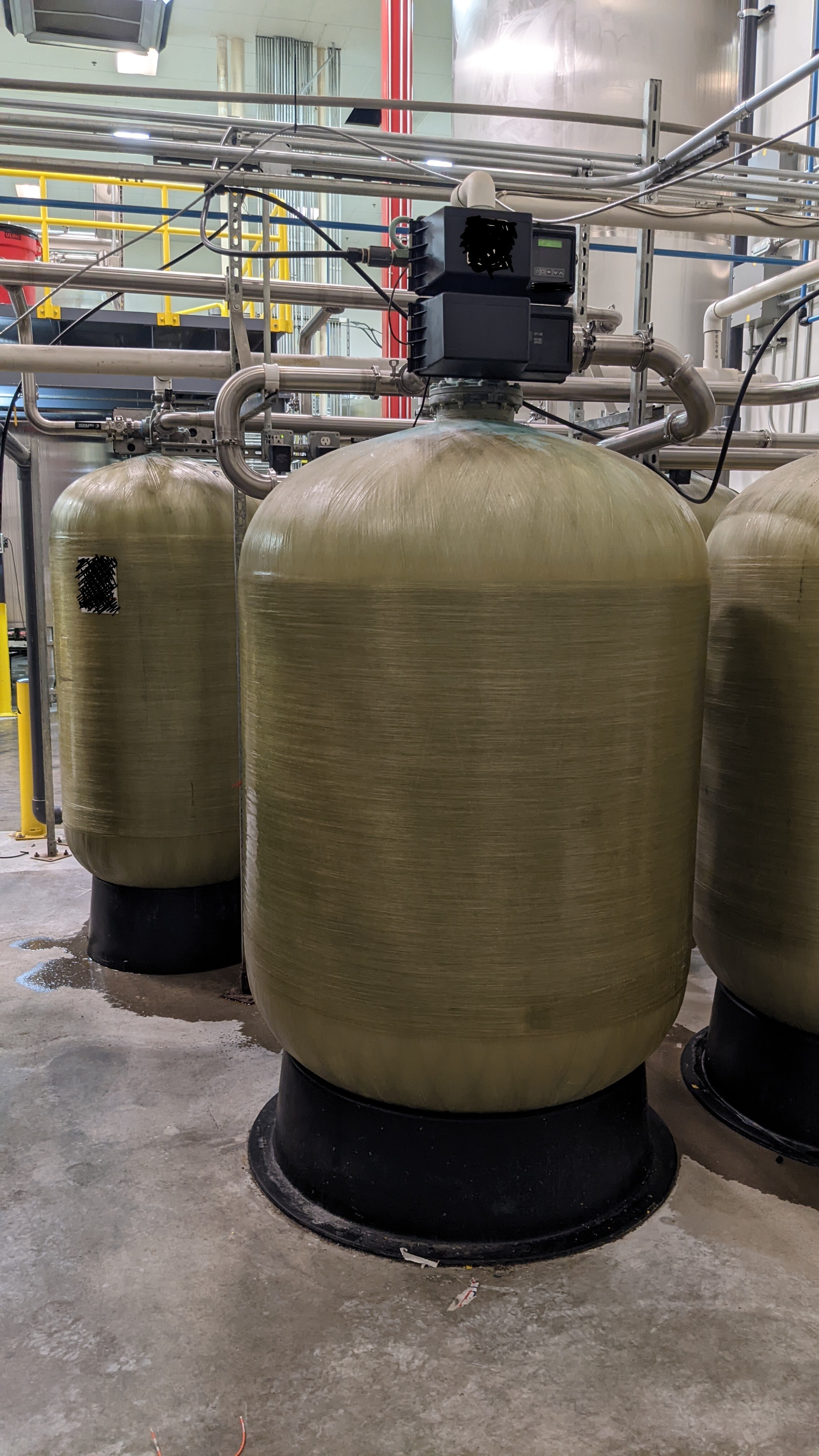

            Originally posted by XEMON
            I'm not a well water guy, but I'm the ozone and UV guy (industrial, mostly food and bio lab).
            here are the ones I'm use to see/work with; for reference, the fiber vessel is 7'6" tall and the system is designed to spit out 100gpm after the DI, so the softener needs to handle a minimum of 250gpm and backflush at the same time, so each vessel can handle about 250gpm when working properly ...
