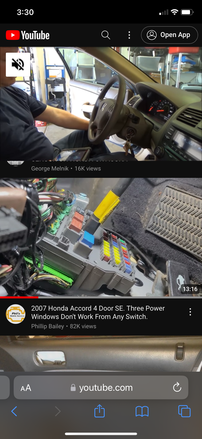

                      IMG_3281.pngSounds like your problem
                      • autococker04
                        autococker04 commented
                        That’s the most specific and relevant video I’ve ever seen.
                      • the_matrix_guy
                        the_matrix_guy commented
                        That’s basically it. Thank you. That video tought me so much. The only thing is, that he looks for the OEM Honda master switch (which costs $500+ CAD) but you can get aftermarket master switches for $25. Im thinking of just ordering one. I dont have the electrical know-how to do the ghetto-rig he did with the relay
