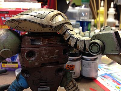

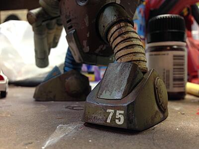

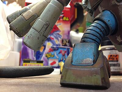

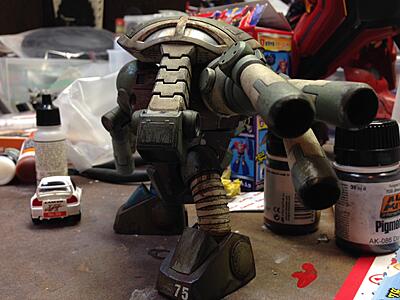

          #19
          Some pictures attached of 1/144 Bandai Juaggu built using AK/Mig/Valejo methods.
          • the_matrix_guy
            the_matrix_guy commented
            thats amazing, amazing weathering
          • the_matrix_guy
            it looks metal *insert head banging emoji* (figuratively and literally)
            Im checking out mig jimenez on YT now

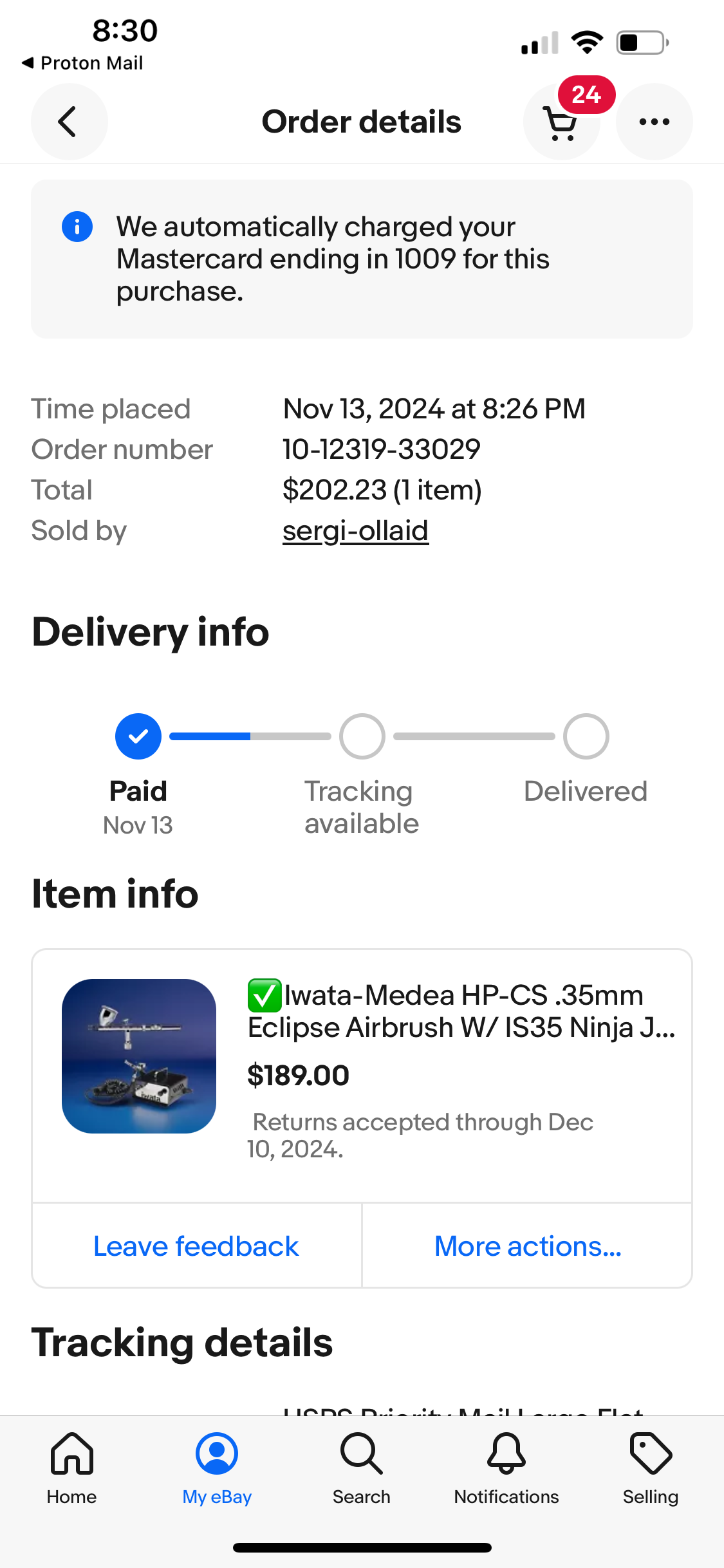

              Thank you. I already purchased the Iwata. I think it's a good starting point for me, even with that little compressor. I did notice many of the professional air-brushers on Yt running the Makita Quiet Series Electric Air Compressor 1 Gallon. Maybe down the line, I'll upgrade the compressor.
              I still have to figure out which paints, and thinner, and accessories I need. I'll look into Vallejo, multiple people recommended those.

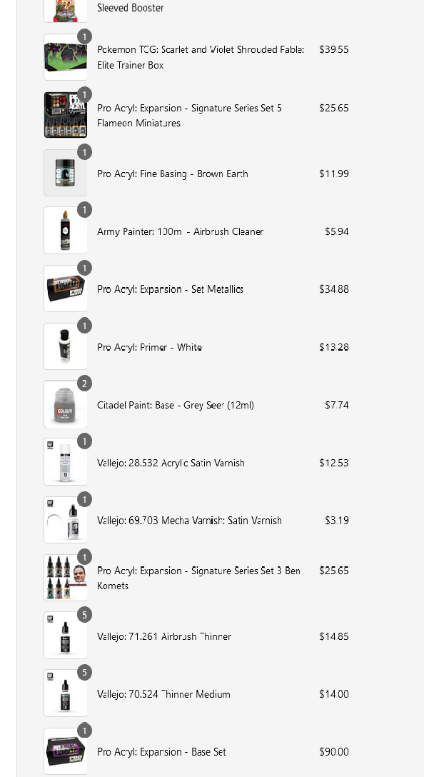

                              I watched a few YT videos, I feel a little more educated. I arrived at these: Monumental Hobbies Acryl 26 Pro kit: Amazon link
                              . Amazon has a better description, that's why I'm linking it, but I got everything for less at gamersguildaz.com they have a lot of cool stuff, check them out. I got this: I still need brushes, glue, sandpaper, markers…
