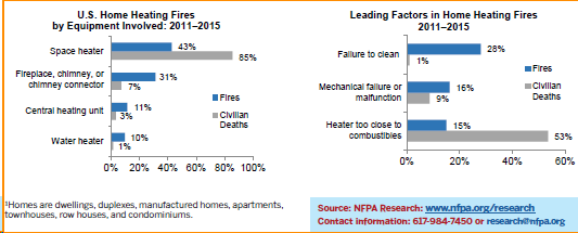

                Grendel nailed it regarding the heat sink effect of the walls. I'm not sure, but I think exposed (i.e. above ground) walls are worse, as the exterior convection has a higher heat flux than the relatively warmer and lower heat flux earth. Regardless, insulation is the first step in heating. As I recall, building codes stipulate that the R value of basement insulation must be equal to or lesser than the insulation used on the floor above. I've heard various recommendations for basements. The person I know with the most experience recommended fiberglass because it can dry out faster than other materials and thus mitigate against mold.
                Anyway - this all depends. What you save on initial investment could easily be consumed in a few months of relatively elevated operational expenses or poor reliability of the equipment. Moving hot air from your upper floor to the non-insulated basement is one such example that I think will both mess up your currently heated areas and cost you a significant amount in operational expenses. Depending on your current heating system, it might even lead to very premature failure of the equipment.
                • What's the square footage of the basement? Ceiling height? Which walls are exposed to earth and which are above ground? Any other openings (windows, doors)? Any dividing walls in place already?
                • Are you planning to finish the basement at any point in the foreseeable future?
                • What's your fire hazard risk tolerance?
