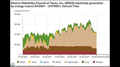

        The crazy thing is the energy consumption. Demand spiked early last week, but wind and solar started going offline, so natural gas and coal became hot commodities. Now, natural gas is seeing low line pressures after 4-5 days at peak capacity, and a lot of those generation sources iced over this week.
        It's like the state forgot to buy life insurance. "We're young, we're wealthy, and it would be a shame to waste all these good people's money on such a freak risk..." Well, whoops.

            Yup, the wind turbines froze up. Because they weren't winterized. I'm hearing attacks against clean energy because of the turbines' failure, but if Antarctica can have wind and solar farms, Texas can too.

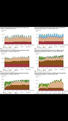

              Heck wind and solar is working just fine up here in the midwest and we've been having lows of -25 for the past few weeks. But we expect that kind of crazy low temps and plan ahead.

                  Everything's in the same boat - the renewable vs hydrocarbon debate is pretty silly, at least WRT this event. The turbines weren't winterized, and neither were the instruments on the nuclear, gas, and coal plants. Solar... well, hard to get much sun when there's an inch of ice on top. Fact is, gas is over half the generation, so when it got hit, so did the grid. By then, the solar was at 0% and the wind had dropped from 35% to 22%.
                  What's most interesting is that there simply wasn't enough capacity, period. 50MW is the best we've done all week, and that's not keeping up in a state where most people have (old) heat pumps, not furnaces.

                      You can see where stuff froze Sunday night. Everything that was still working just took a nosedive.
