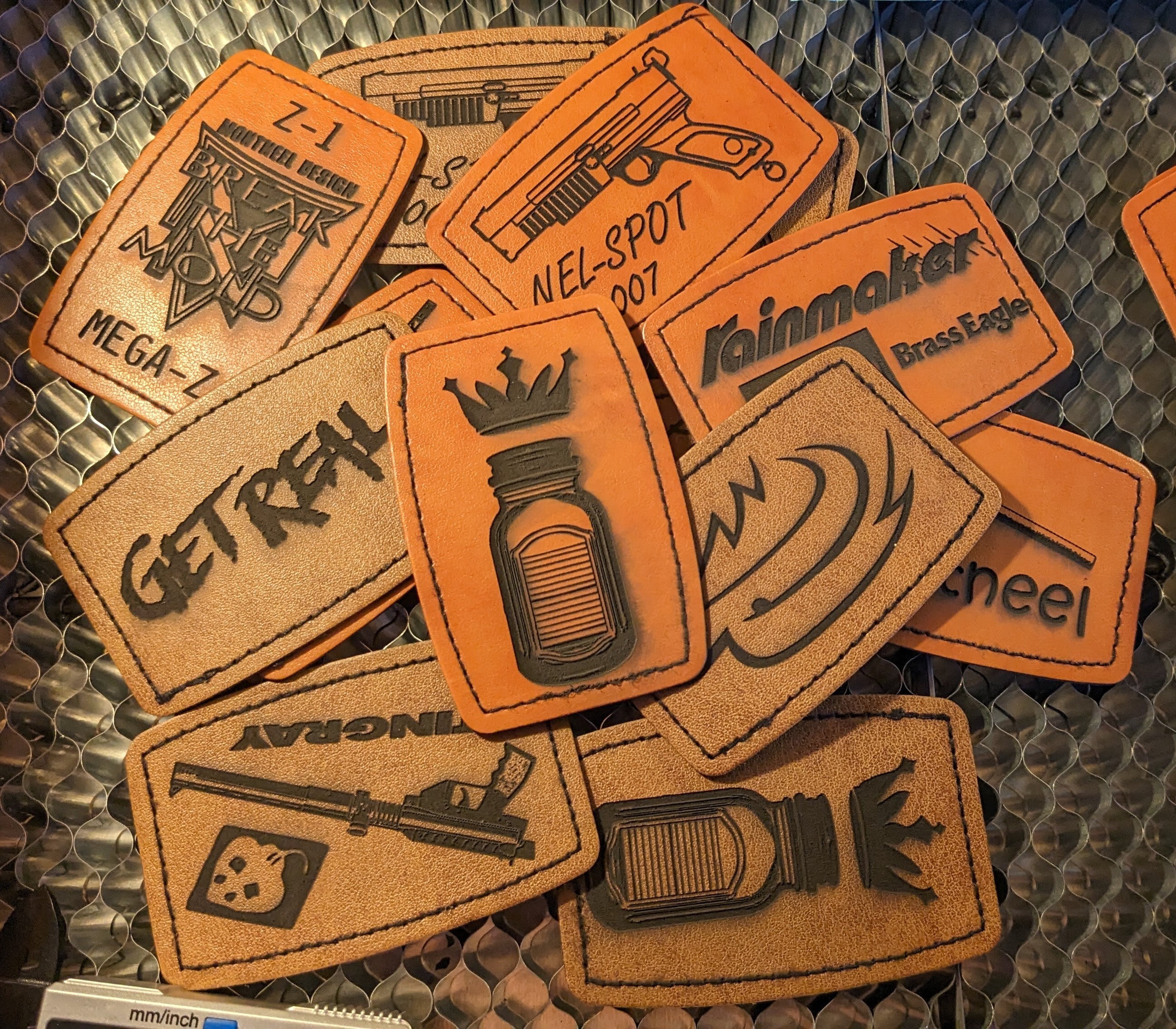

    Here are some samples:
    Click image for larger version  Name:	PXL_20231122_200912267.jpg Views:	0 Size:	1.94 MB ID:	476462
    Ps: straight out of the laser they're a bit dirty, once clean the lines are sharp.
    Open to all with a good trick on this one πŸ‘

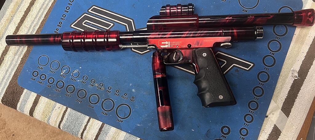

        Bargaining Tips: If you make an offer that gets declined, and the item hasn’t sold for a bit, email and politely say your offer still stands if they change their mind. They may accept your offer.
        And if you’re lucky enough, the seller contacts you and asks if you’re still interested in said item, knock a bit off your last offer and see if they will take it.
        Also, alway be polite and respectful. I’ve had people sell me gear packages because I was nicer to deal with than other people.
        Got this nice Phantom, among other things, after the seller contacted me to see if I was still interested in their gear.

          XEMON commented
          Its nice to be nice, shoot me your address, got the perfect patch for your phantom πŸ‘
          Cdn_Cuda commented
          Thank you, sir! Message sent.

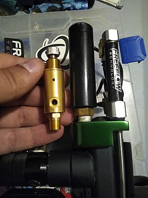

            Clippard makes an lpr and sells it for only $25 the part number is MAR-1P. T​​​​​he only catch is that the max input pressure is 300 psi
              XEMON commented
              I love alternatives like that, shoot me your address πŸ‘
