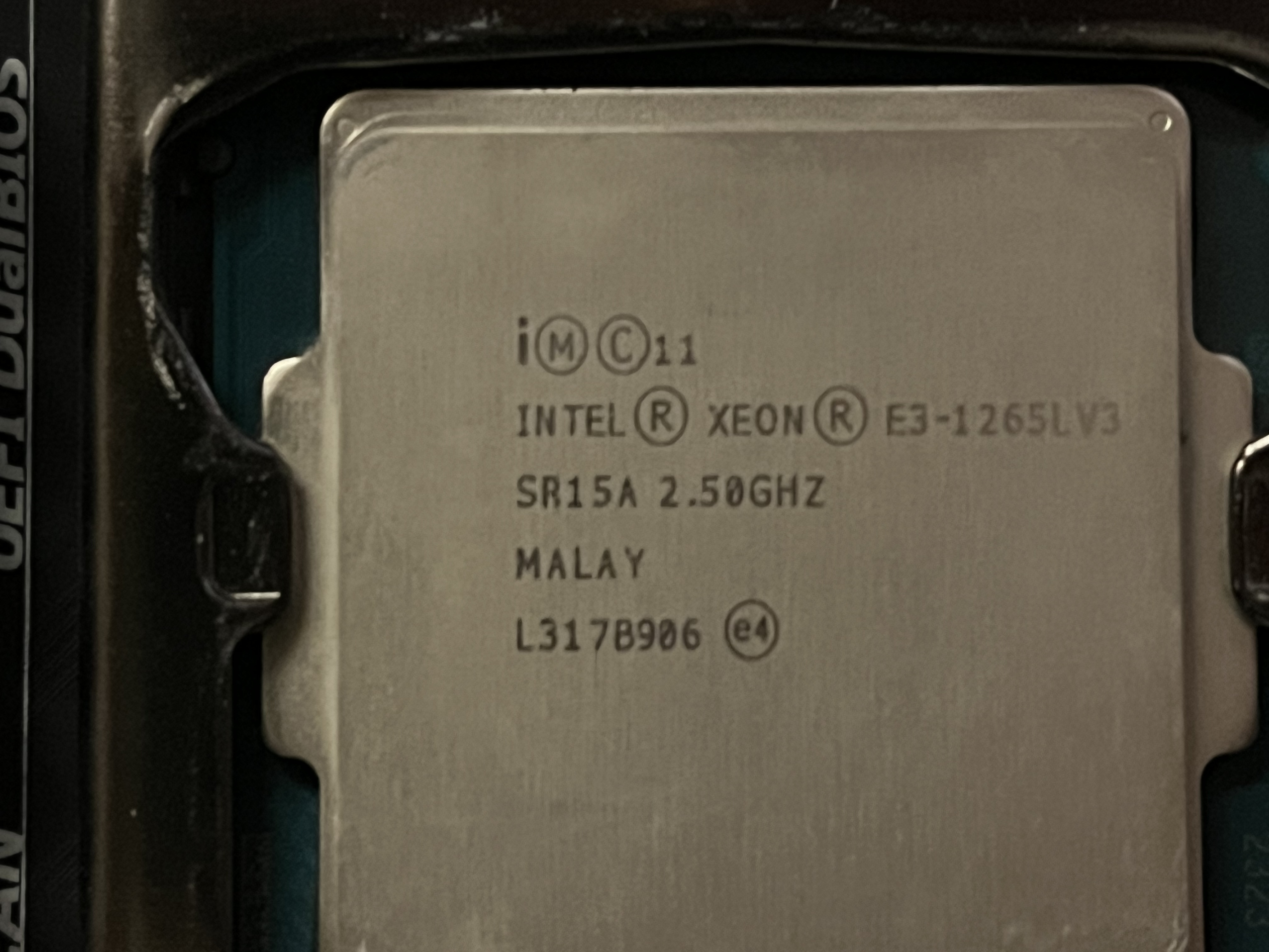

    CPU Intel Xeon E3-1265Lv3 1 $35, eBay

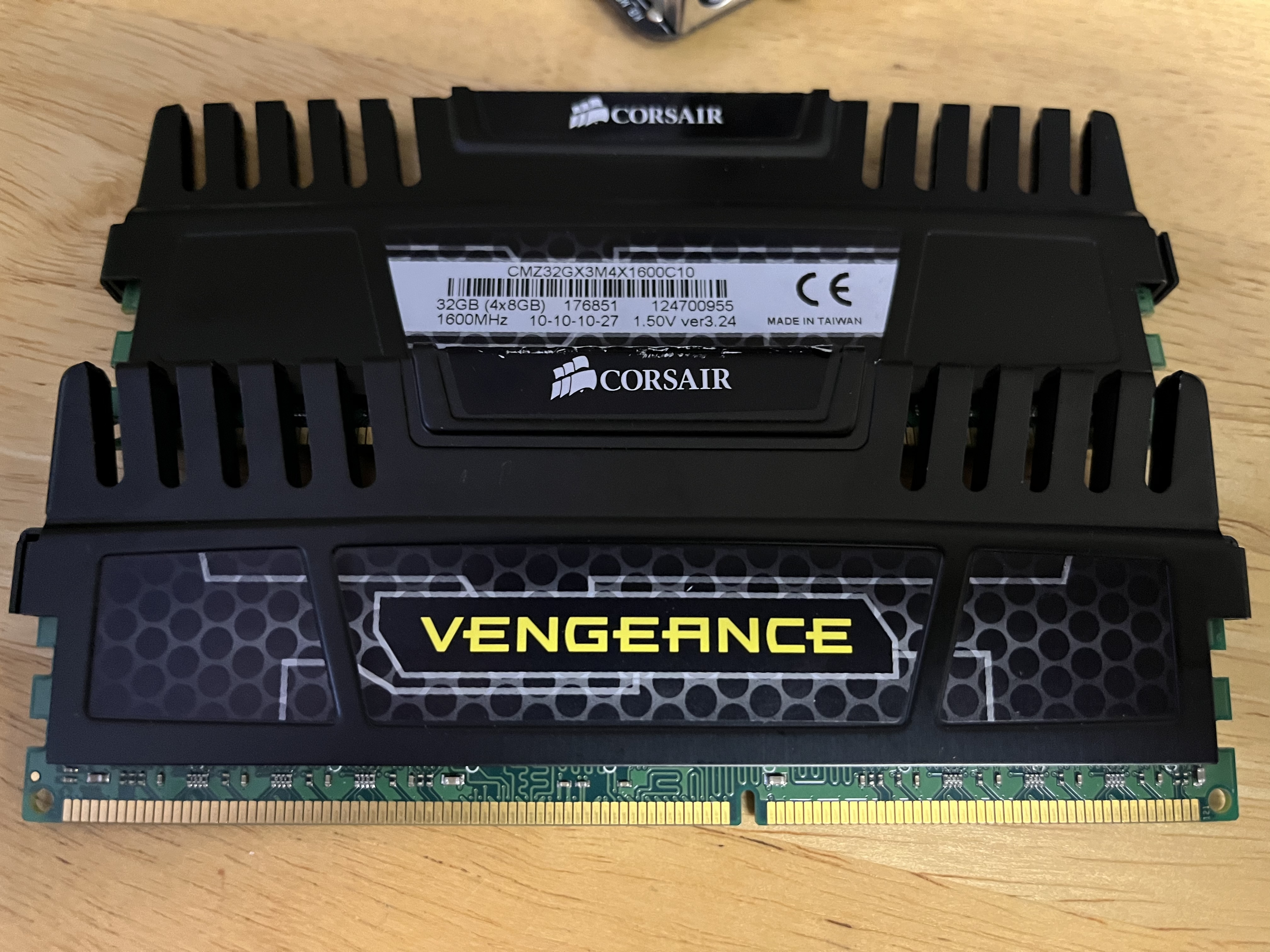

    RAM Corsair Vengeance DDR3 1600MHz, 8GB sticks 2 $0

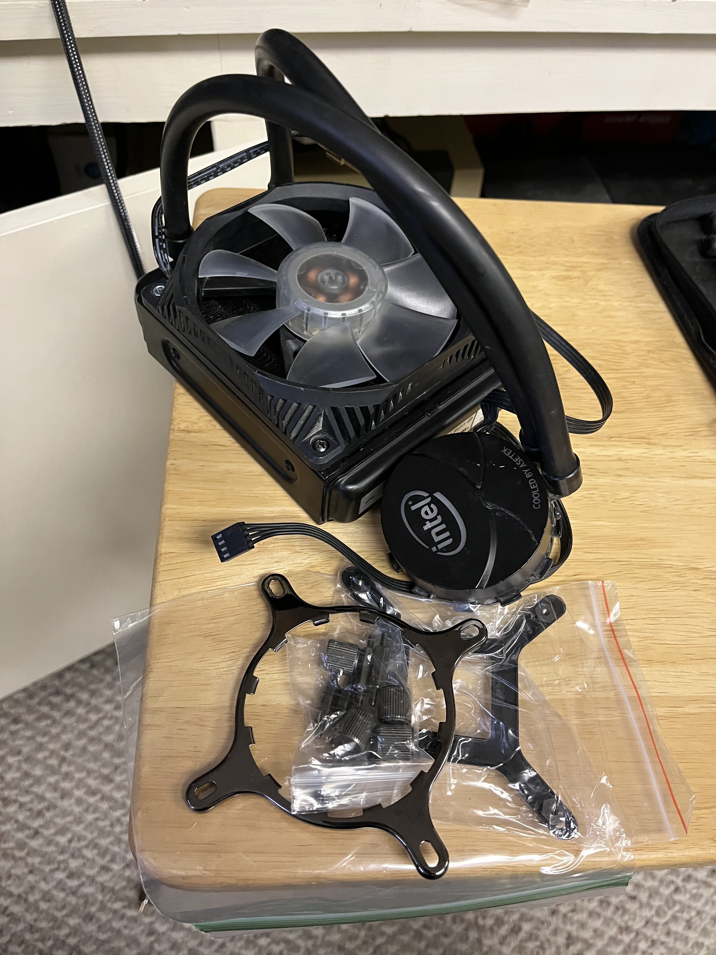

    Cooler Intel 120mm liquid cooler, made by Asetek 1 $0

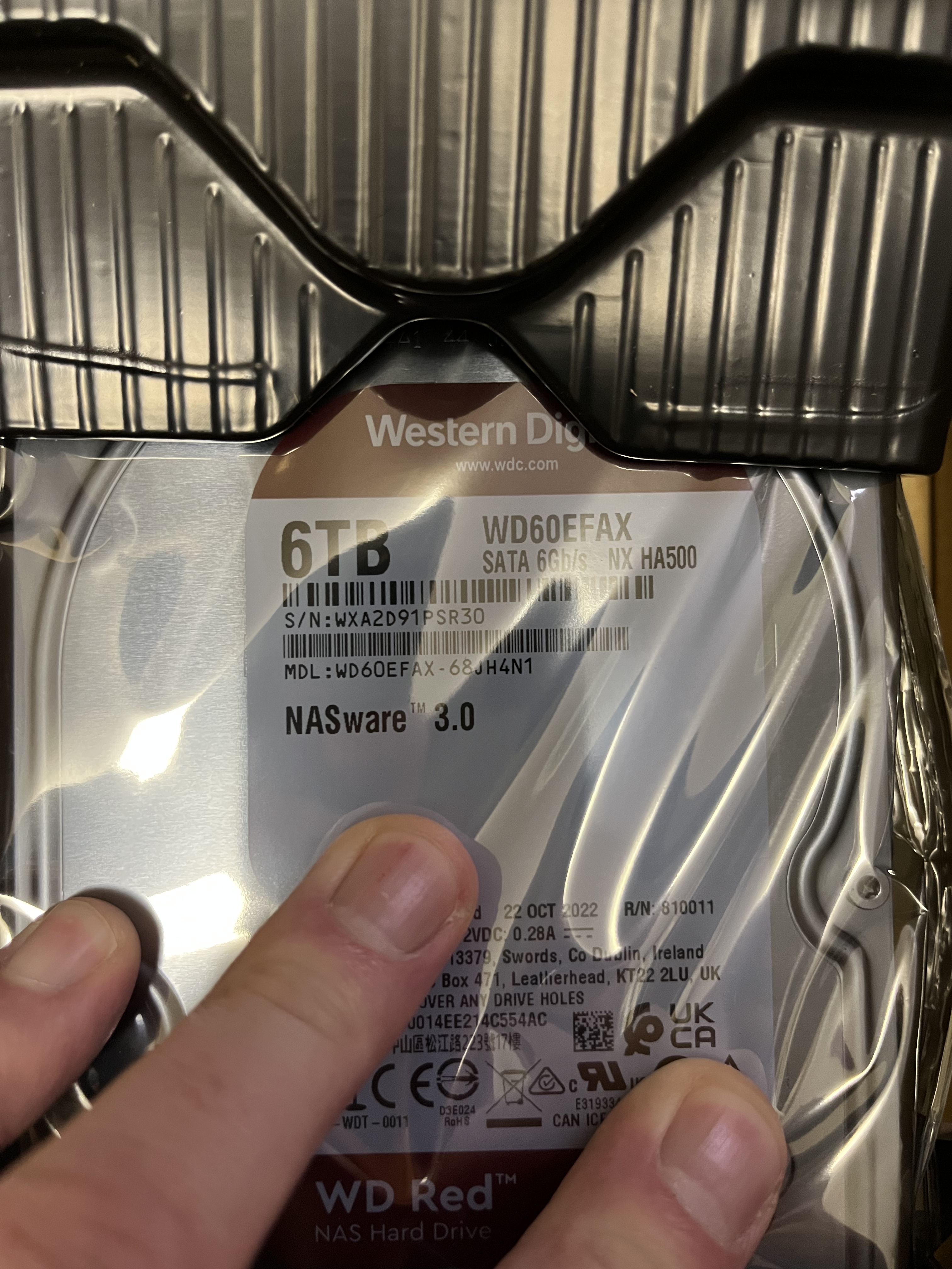

    Array Drives Western Digital 6TB Red NAS drives 3 $300, Amazon

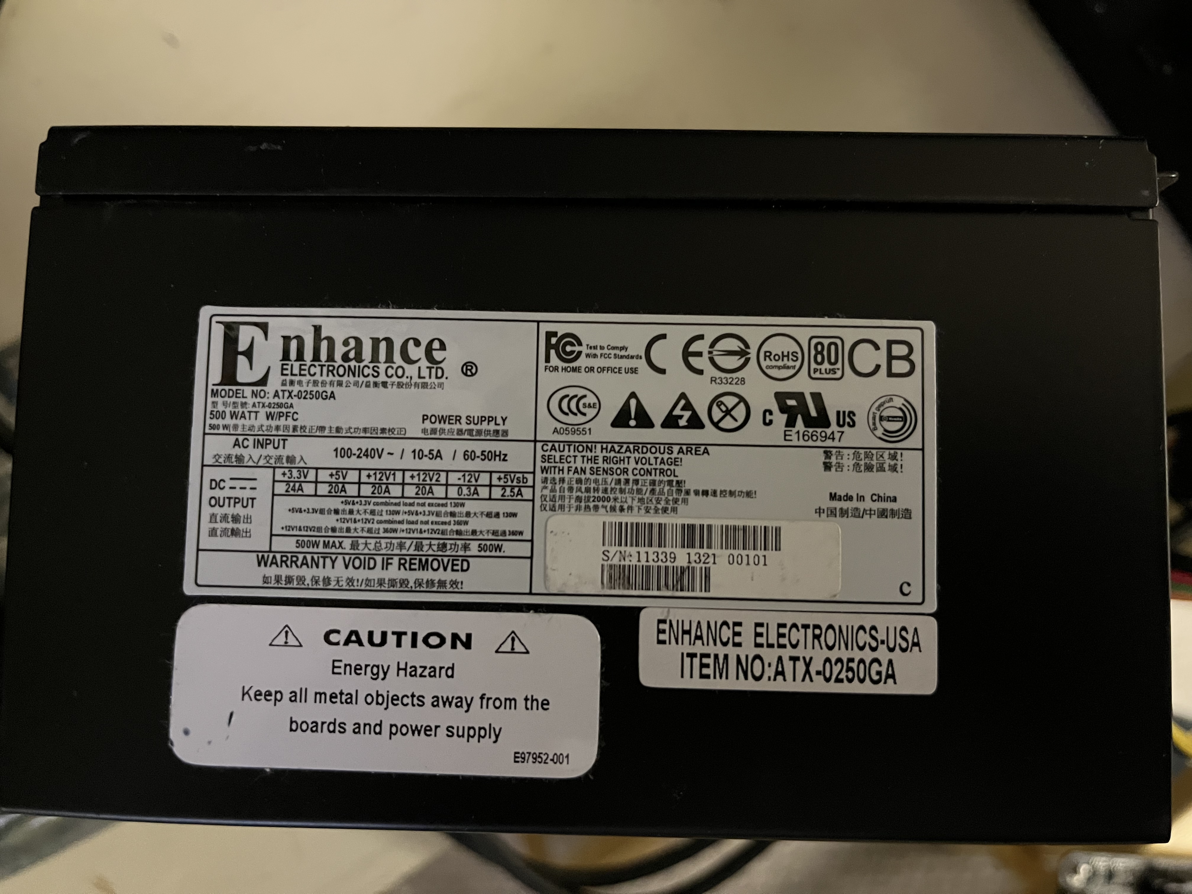

    Power supply Enhance ATX-0250GA 500W 1 $0

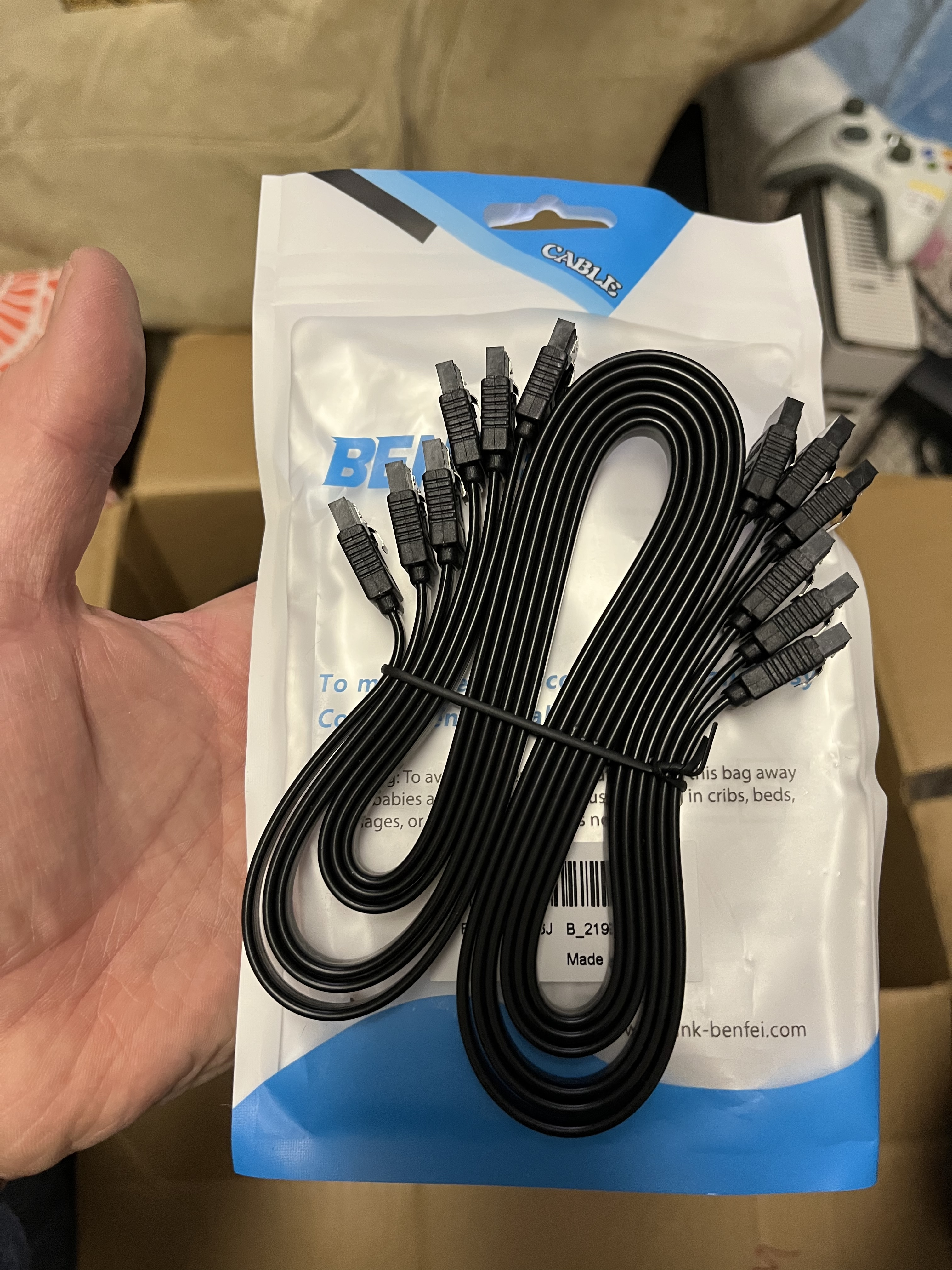

    SATA cables pack of 6, 18” long 1 $7.50, Amazon
    Cooler bracket Corsair H80i bracket for Intel 115X sockets 1 $11.50, Amazon

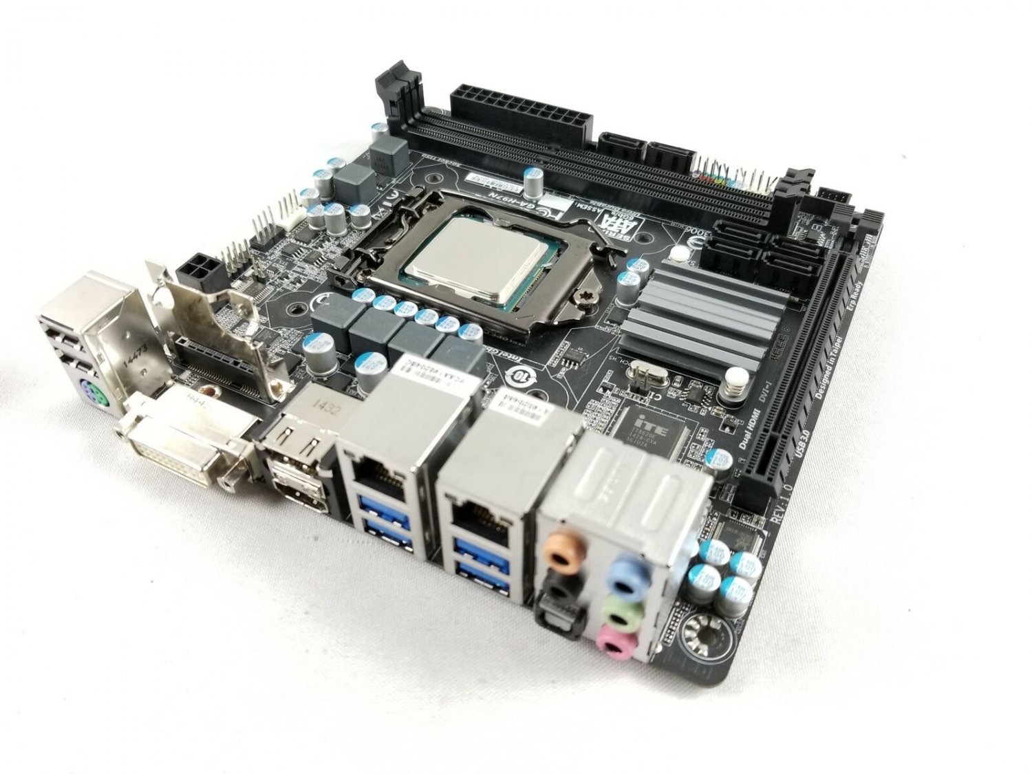

    I chose this motherboard because (1) it has 6 SATA III ports, the max # of drives the case will hold and (2) it has dual 1G NICs. I may bind them together for a 2G uplink. There’s a mSATA port that is used for wireless cards on other motherboards. Might be a good place to use my old 256GB SSD if I can get it to be recognized.
    Pro tip: if your motherboard supports Xeon processors, they’re often cheaper than their PC counterparts. An Intel i7-4770T has the same specs but was $120 or more on eBay.

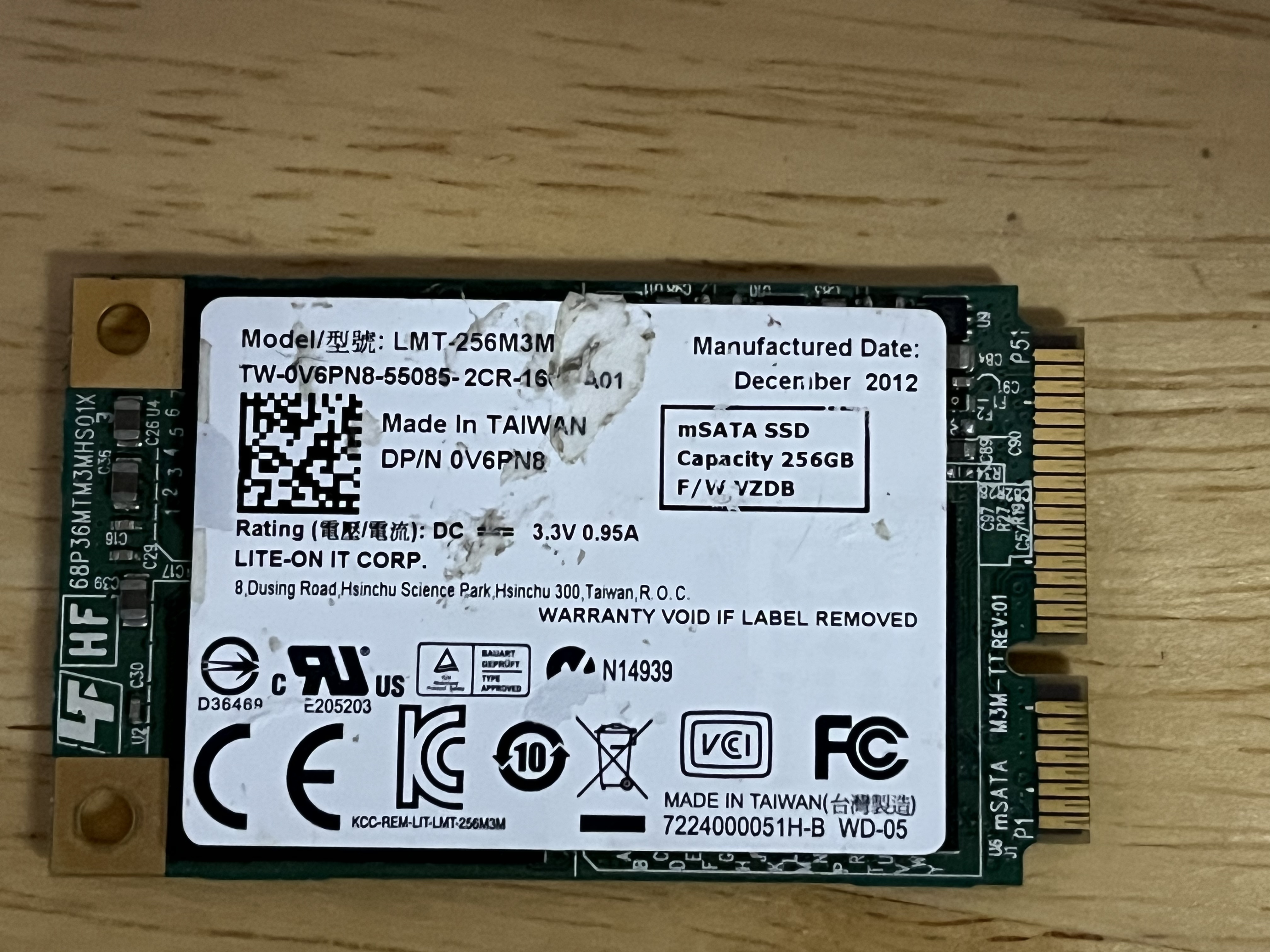

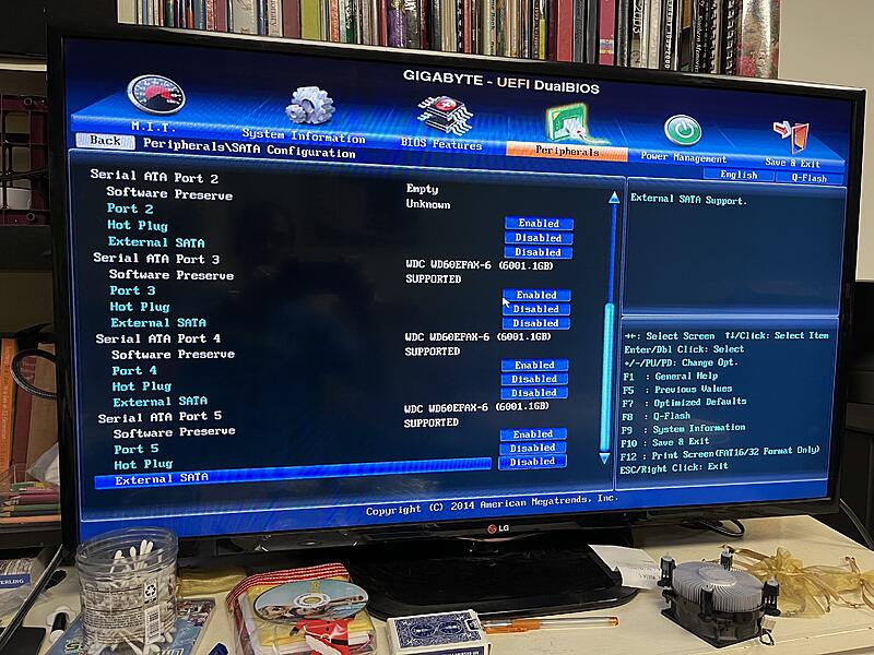

    I will use this mSATA drive for cache if it is recognized by the system.
    Edit 1/7/2023: No dice. I think the mSATA port is present but disabled on this motherboard. Used the MX500 I was given instead.

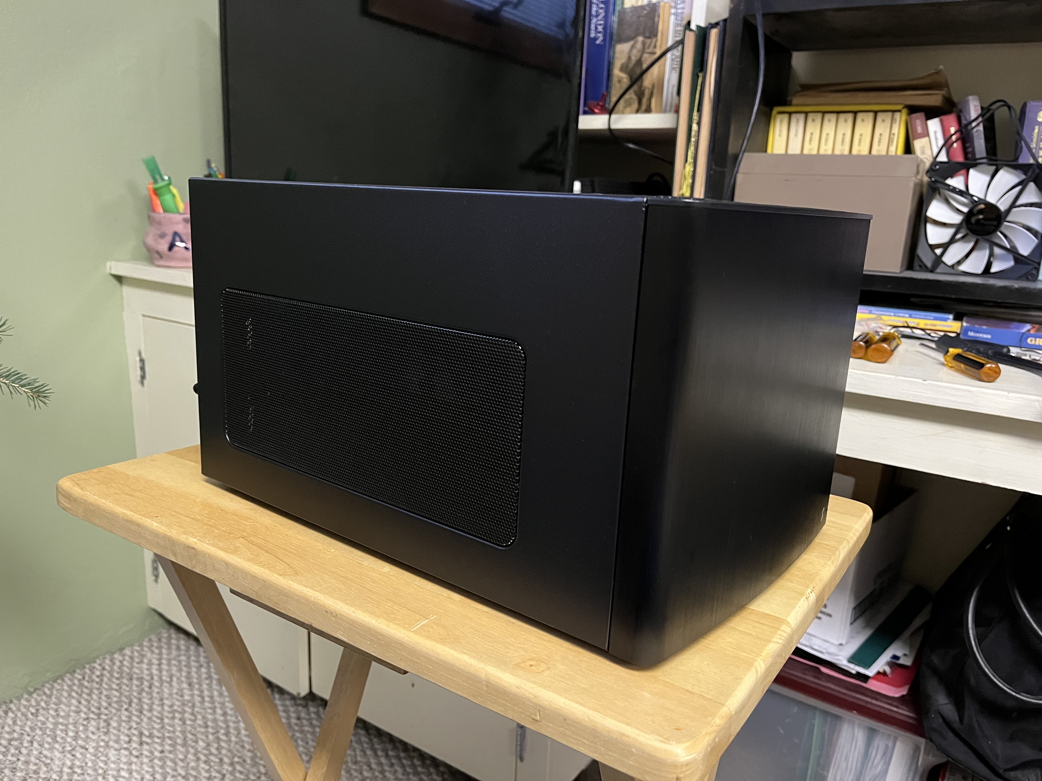

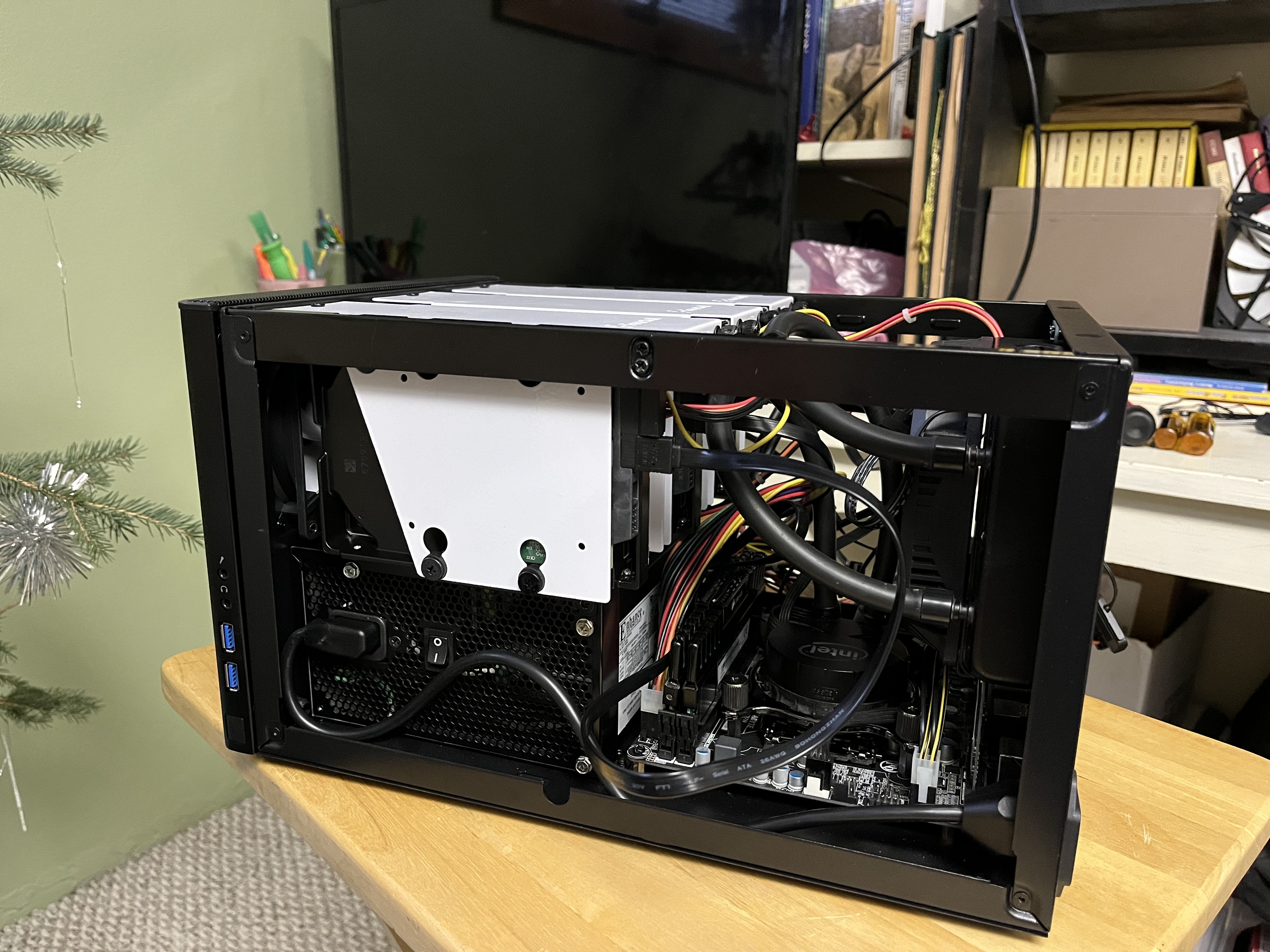

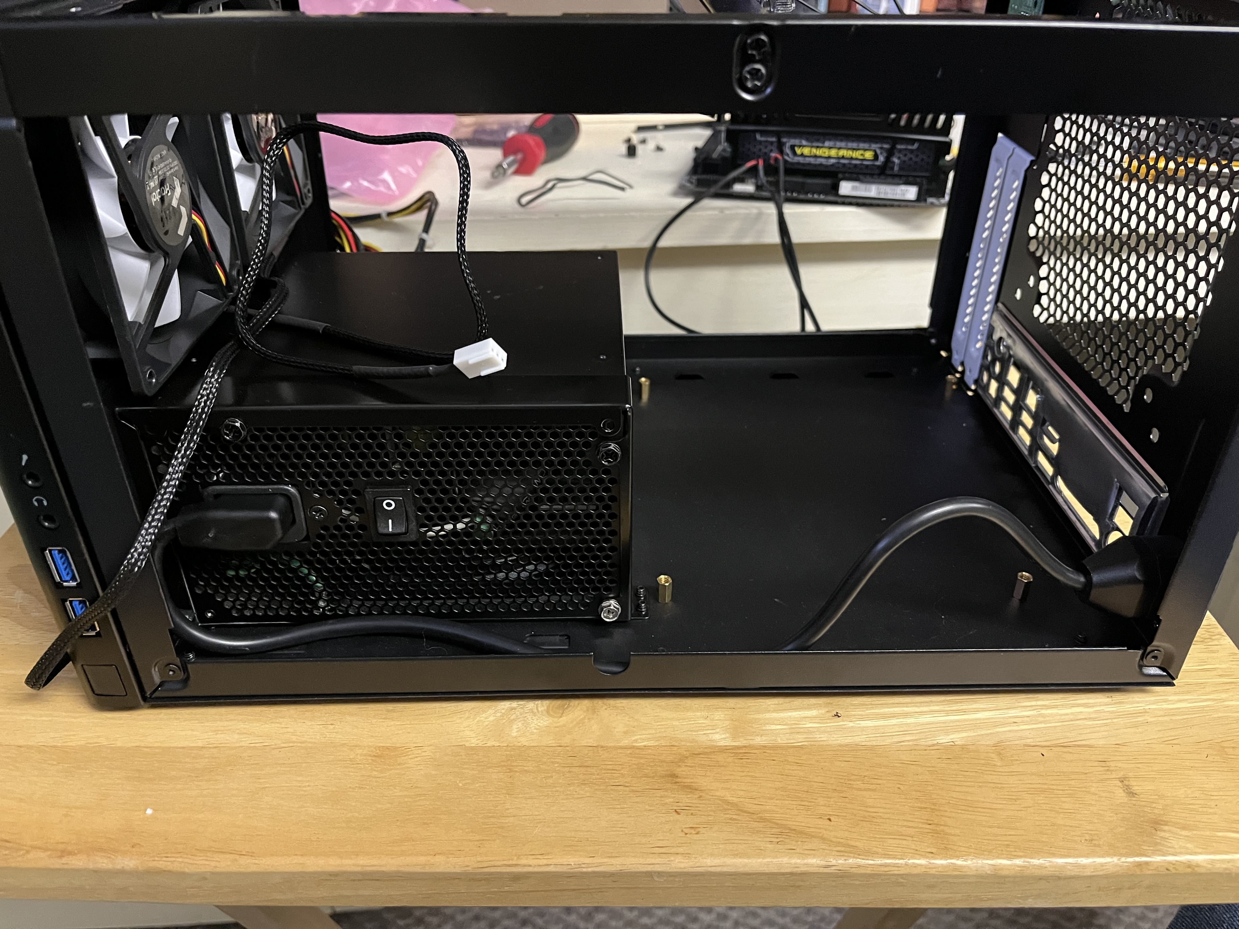

    You can look for PC build videos if you want to learn how to do this. I’ll just give you my notes and some pics.

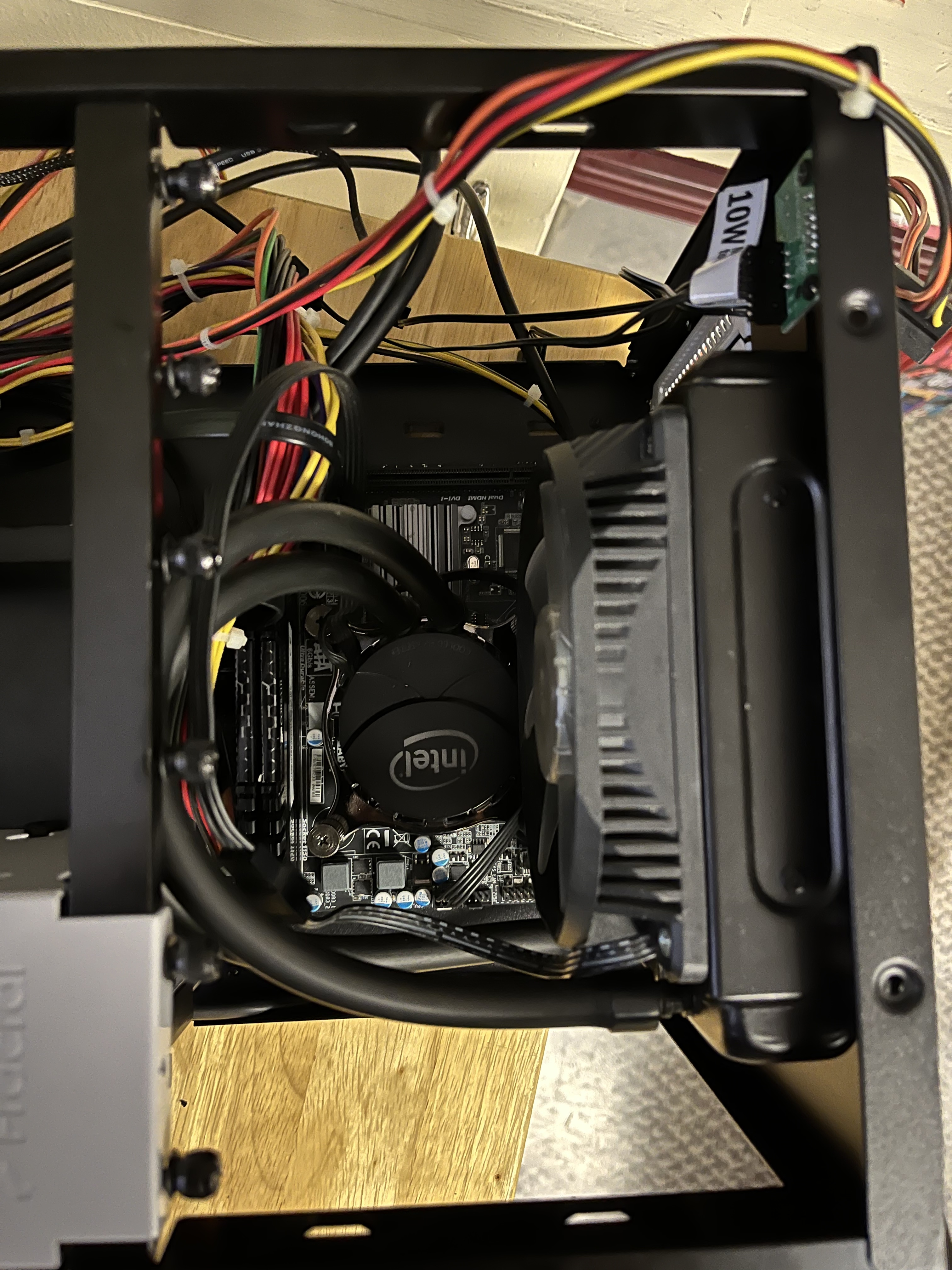

    The big challenge here is space. This case is pretty tight, so I had to be OK with a slightly cramped, messy interior. As long as there’s decent airflow, I’ll be happy. There’s no window, so it’ll never be looked at.

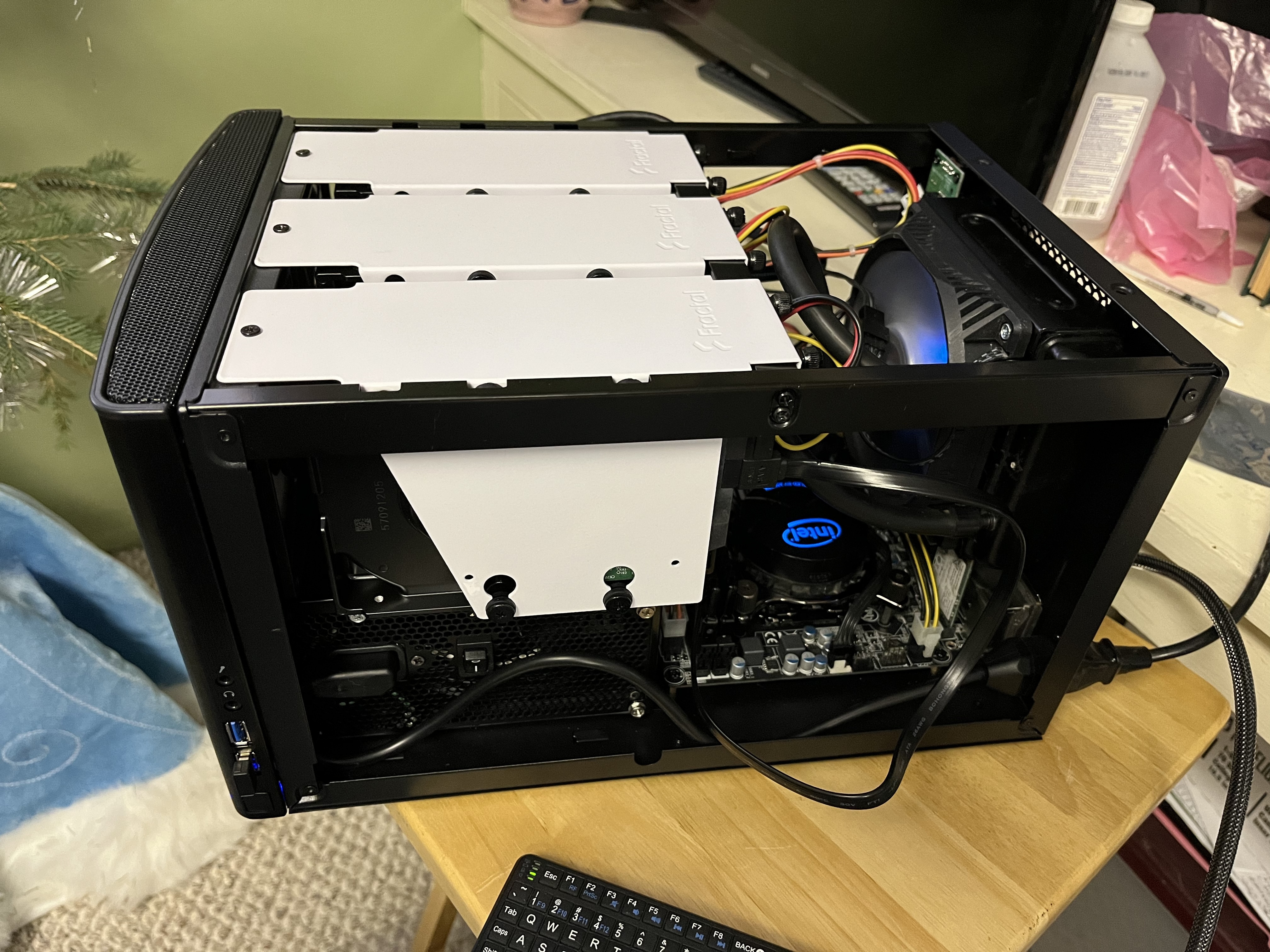

    Power supply installed. The air intake is on the bottom of the case. All intakes - front panel, power supply, and long GPU intake - have removable dust filters. The case also comes with three fans - two 92mm intake fans on front and a 140mm exhaust in back. I replaced the 140mm fan with the 120mm water cooler radiator and fan.

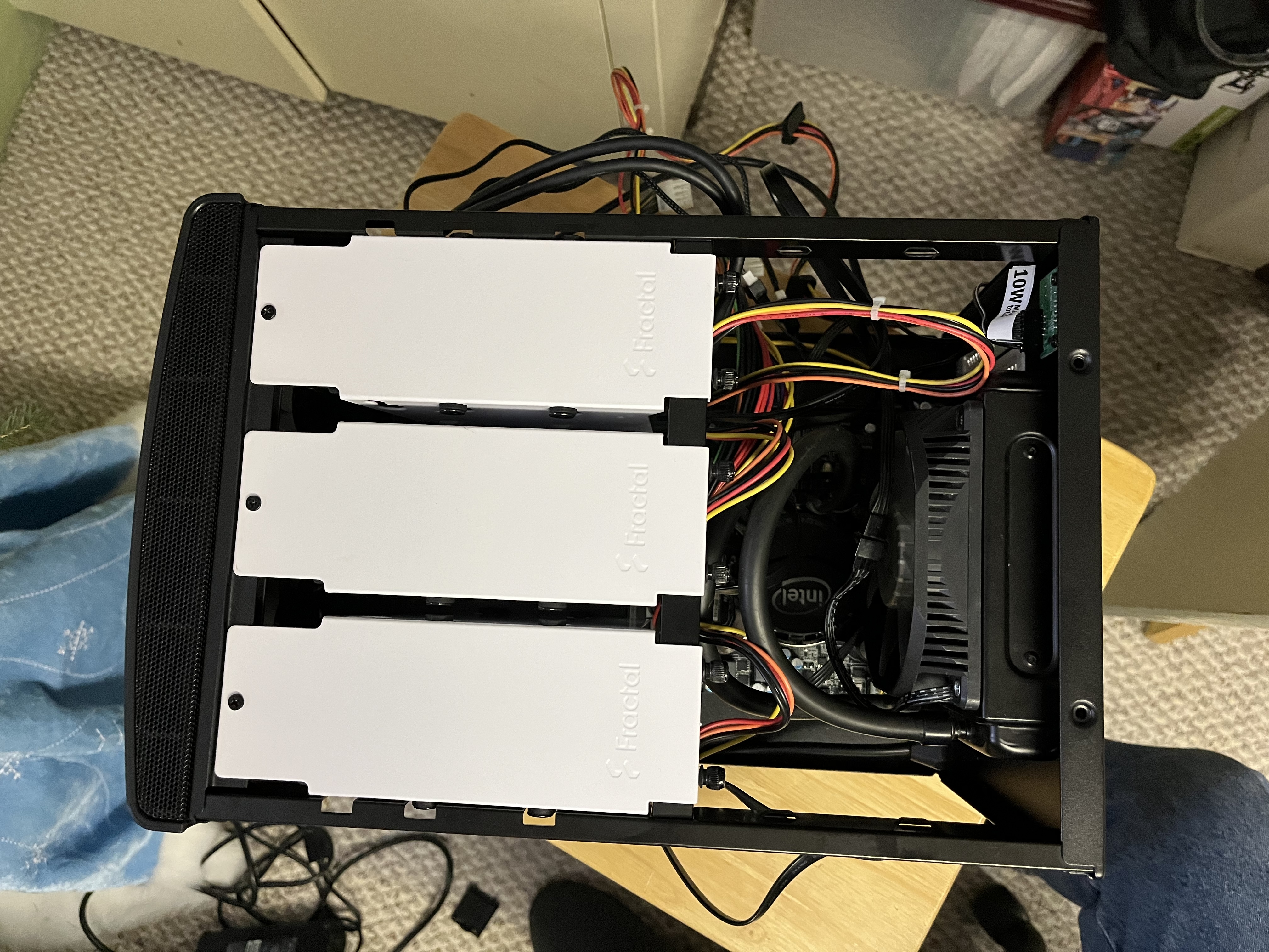

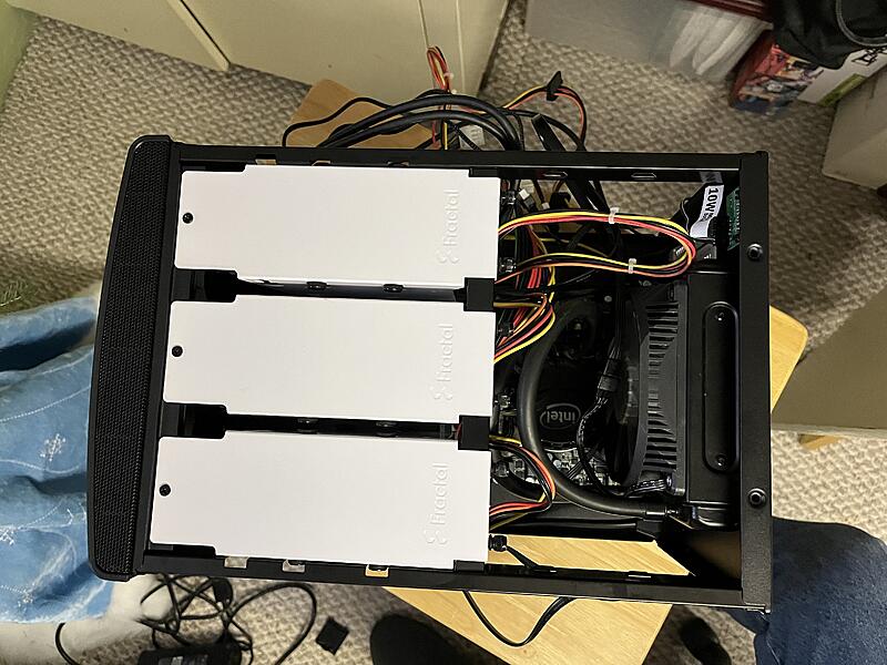

    Top view of the motherboard. The water cooler was a challenge because the hoses were made for a bigger case. Got them to fit just fine.

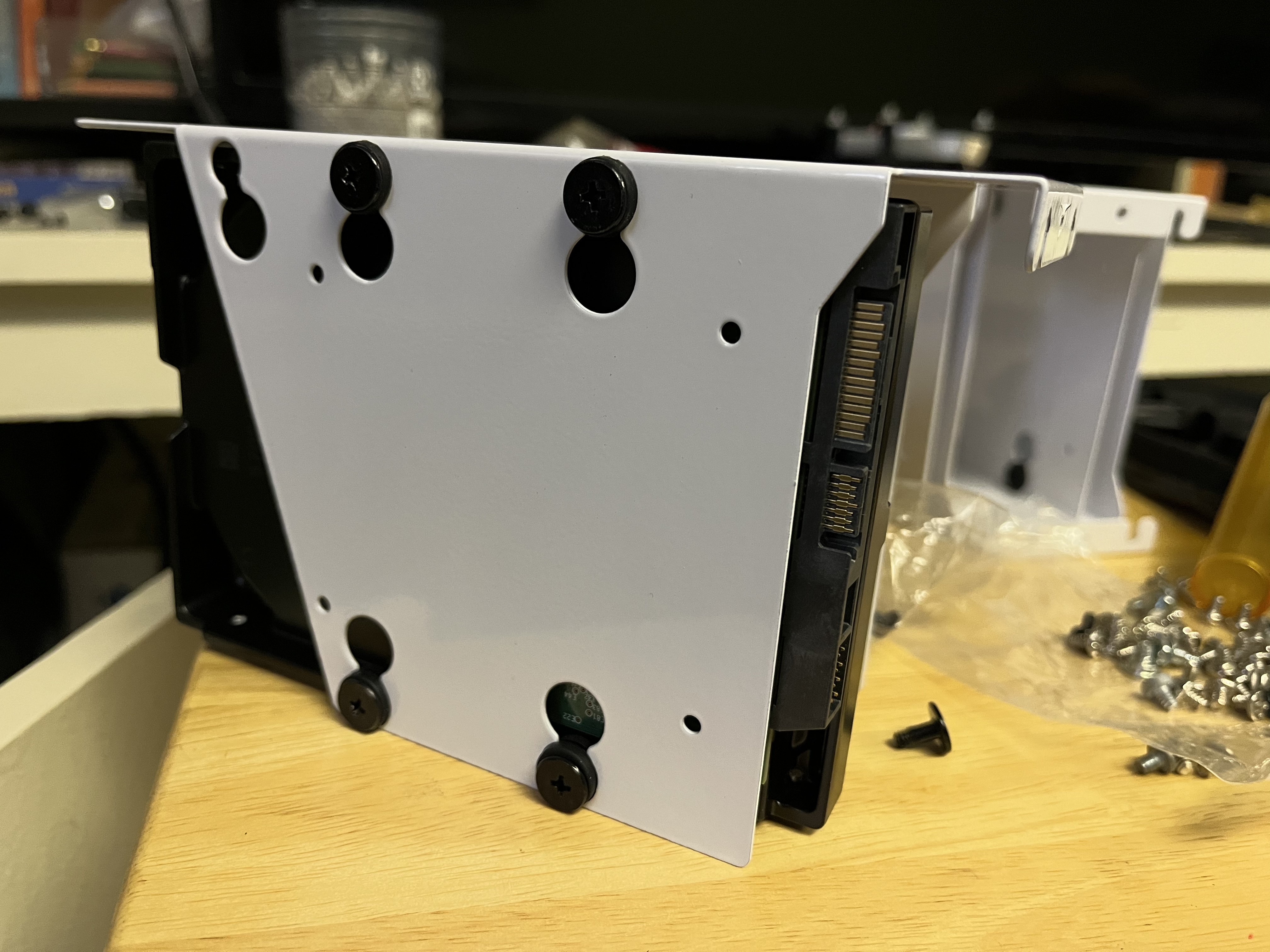

    The disk brackets are kinda cool. They have rubber grommets to reduce vibrations and support both 3.5” and 2.5” drives. 2 drives per bracket max, but I’m installing 1 drive per bracket for now, leaving space between for air flow.

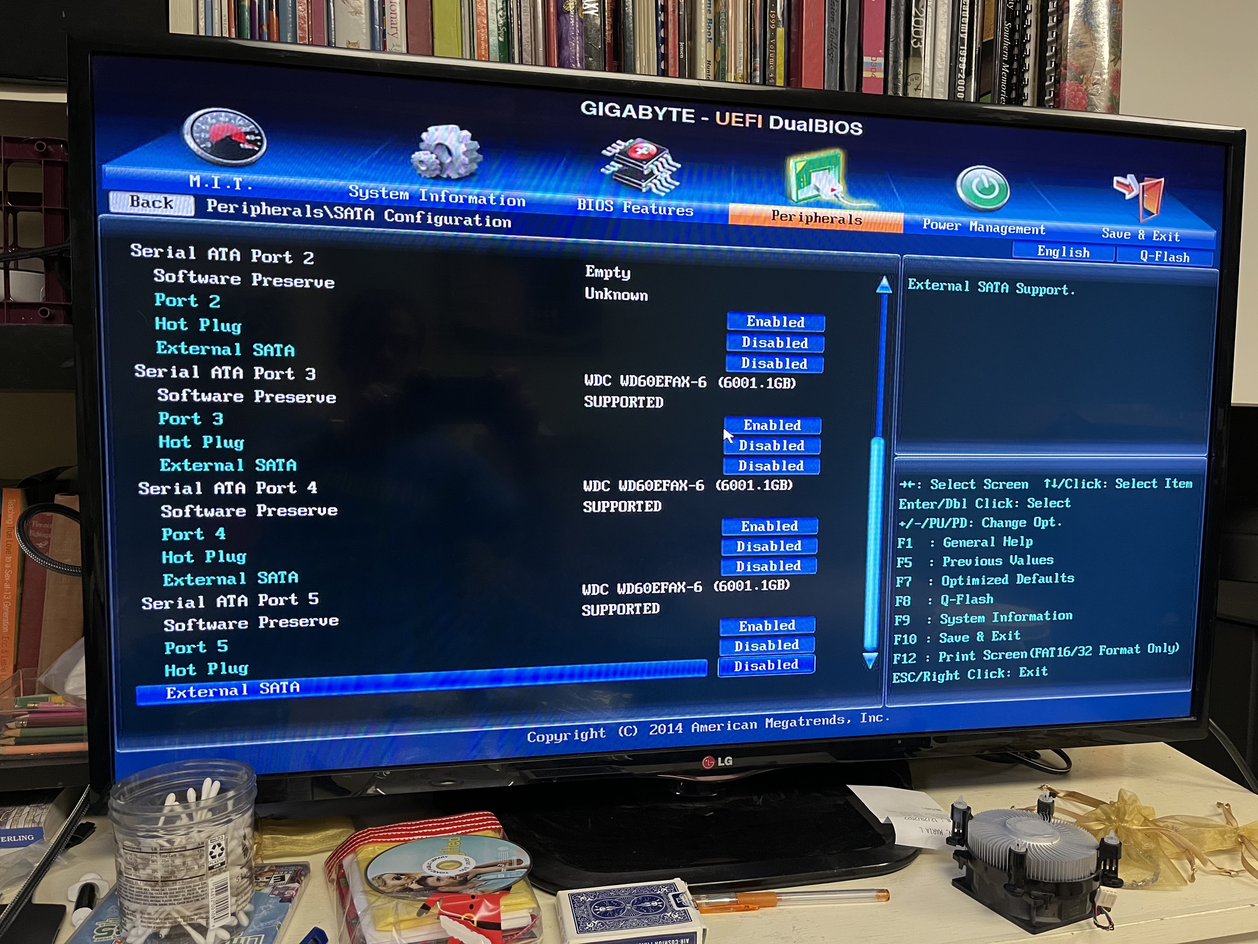

    Its alive! 6TB drives are all recognized. Will have to wait for the OS to be installed to see if the mSATA drive is available.

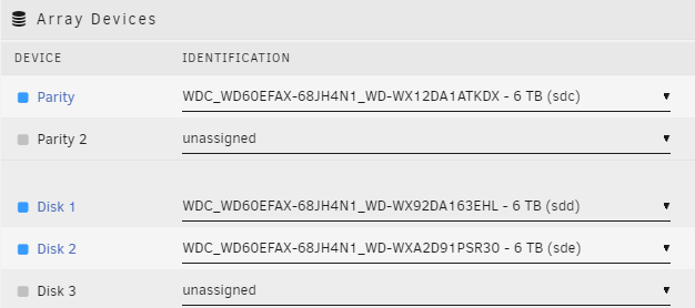

      Drive time! I made one of the 6TB drives a parity drive, and the other two were assigned to the array.

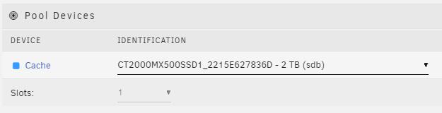

      The SSD was added to the cache pool.
      By default, XFS is the file system for arrays and BTRFS is used for pools. I kept the defaults.
      I started the array, then checked the box to format unmountable drives and hit the FORMAT button. All three storage drives were formatted, then the parity drive did a parity copy of the new drives. It essentially backed up nothing, since they're new drives, but it's part of the process. It'll take a long time (after 3hrs, mine was ~33% done), so in the meantime I decided to get a docker container running: PiHole for ad blocking.

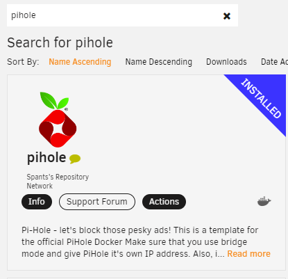

      Switch to the App tab and search for "pihole" and select the official build. It'll have "Official" in a burgundy triangle in the corner instead of "Installed" as below
      apps-pihole.png ​

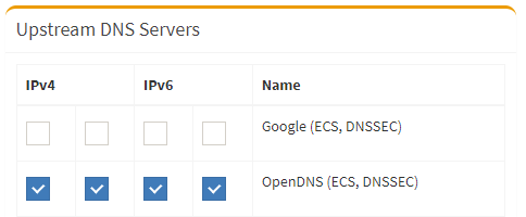

      In the Pihole app WebUI, go to Settings > DNS
      1. Ensure all four boxes in the OpenDNS row are checked (if you're using OpenDNS)

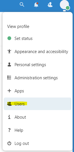

      NextCloud is set up with an admin account, but users for my family members (and myself - best not to use the admin account for daily use) need to be made.
      1. Click on the administrator's avatar in the top right and select Users
      2. Click the New user button on the top left of the next screen

          Nice! I need to convert my OMV server to Unraid at some point. What are you using for the parity drive? Using any cache drive?
          Feedback 🔫🔫
          Regular at Matt's.
          Dumpster Fire PB
          • lhamilton1807
            lhamilton1807 commented
            Parity will be one of the three 6TB drives, so 12TB of storage for now. Should be plenty for the time being, and I can always expand later. Once our 2TB drives from the old 2-bay NAS is decommissioned, I will move them here for a smaller 4TB storage pool. If I can get the 256GB mSATA drive to show up in the OS, I’ll use that for cache. Otherwise I may need to purchase an adapter for either the PCI-E slot or mSATA-to-SATA or just bite the bullet and get a 2.5” SATA drive.
          • goofyman23
            goofyman23 commented
            Unless you have a specific need for the perceived write speeds to cache, I wouldn't go out of your way to buy additional hardware.
          • lhamilton1807
            I’m looking at the use cases and figuring out what my wife wants to use it for. I may just use the cache drive as an off-box gaming hard drive as I have a Skull Canyon NUC that only has a few small M2 drives currently. I use a Thunderbolt enclosure for my gfx card.

          Are you also running this as a router, PFSense box?
          I'm not sure how unraid works, but is it requiring the motherboard Raid to run. I've got a 3770k and Asus motherboard I was thinking of doing this too, but if it requires "Software" raid off the motherboard I'm not sure how reliable that is as a dedicated NAS.
          • lhamilton1807
            Unraid uses a proprietary software RAID that works on pretty much any hardware. You choose one disk that’s at least as large as your largest storage disk for parity and the rest can be a mix & match set of drive sizes. I have separate hardware for my network- I don’t want to use the same hardware for my network edge and storage because the firewall is exposed directly to the outside world. Having my files on the same machine just isn’t good security practice. But I do have a few virtual machines running on another box that can consolidate to this machine. The Xeon processor (4 cores, 8 threads) will handle virtualization on top of storage just fine and won’t be pushed that hard.
          • lhamilton1807
            To clarify, you don’t need to configure any kind of hardware RAID on the motherboard through BIOS. Unraid software takes care of the whole thing. If you need more drives than your motherboard supports, you can buy a pci-e SATA card for super cheap (see eBay or Amazon) to add more capacity. Unraid does require a license, and it’s based on the number of drives you install (not including the USB stick it boots from). I got a case that supports 6drives because I don’t think I’d need more than that in the next 5-10 years and when/if I do larger drives should be easy enough to purchase instead of a larger license & case.

                This is a sweet looking project! I bought a Synology 918+ a couple years ago and it has been great. Next time I do something like this I'll probably roll my own. Being able to expand memory easily is amazing!
                re: HDDs- I've seen it recommended to mix & match your drives, or at least buy from different sources.
                That way if the model of drive ends up having a massive failure. The entire SAN doesn't go down. Just that class of drive.
                https://www.reddit.com/r/DataHoarder...eb2x&context=3
                https://www.reddit.com/r/freenas/com...rom_different/
                re: piHole- I have one set up and love it, other than when I don't. Some of the lists are pretty draconian on what they block and I've had to disable it to get attachments from GMail, Google Maps Street View, and a few websites (bad coding on their end imo), among other things. But overall it is amazing.
