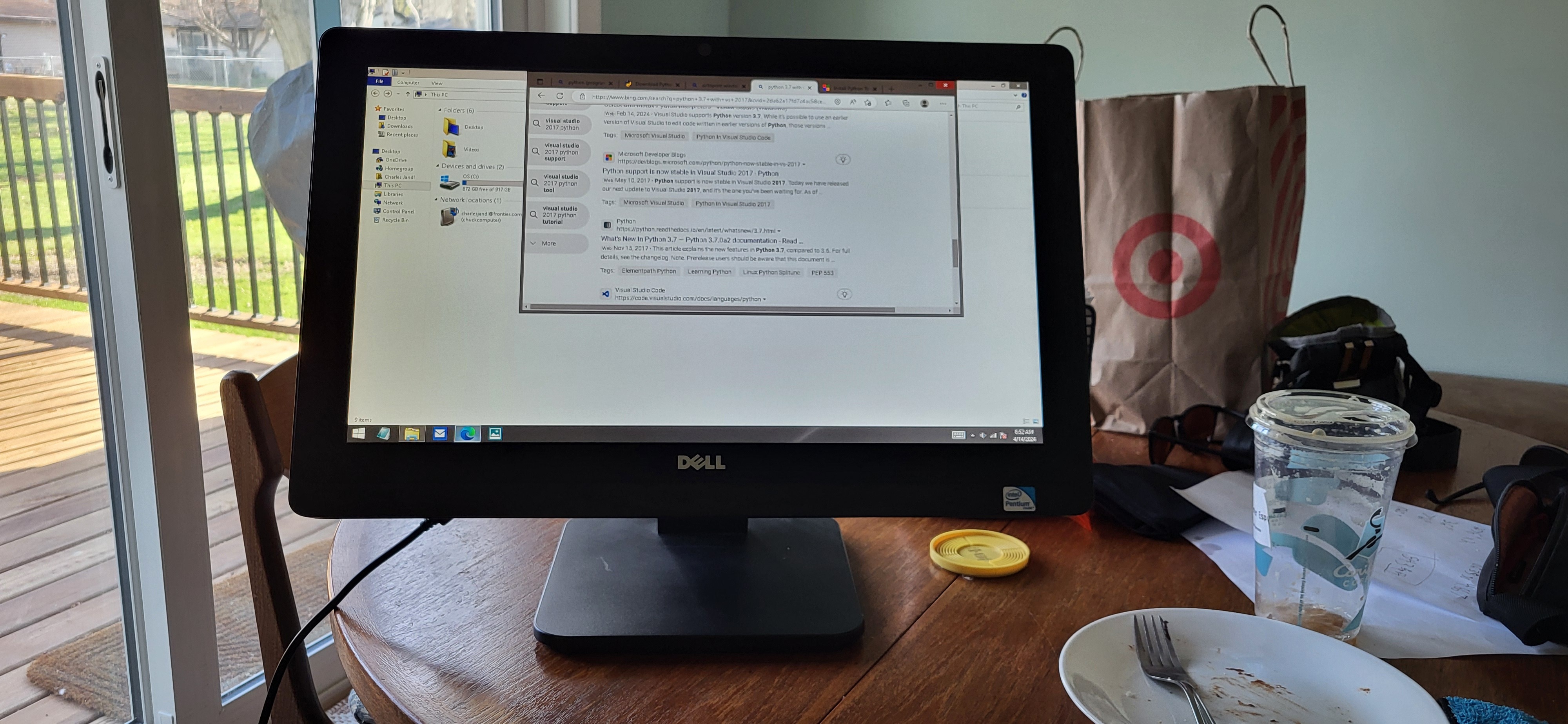

    I found my Grandpa's old All-In-One PC yesterday. my mom must have purchased it from his estate sale. Its a Dell Inspirion one 2020. It's a Windows 8 PC. With a touchscreen at its core. And knowing the original owner. It's barely used. But isn't much of an impressive machine by today's standards.

        I may go Linux. I assume the touch screen won't work in Linux though, so in that case, I may as well buy a couple of pis and do it the traditional way. I was just hoping g to modify some programs to make my current set of hardware work.

            The good news is that Dell actually will ship many of their PC's with Ubuntu installed (or used to its been a moment) and most if not all drivers work out of the box.

              I installed Lubuntu (i.e. lightweight Ubuntu) on an Intel Compute Stick that was manufactured in 2016. It has 2G of RAM and 32GB of flash storage, powered by an anemic dual-core Intel Atom processor. It runs Octoprint just fine.
              Burn Lubuntu or some other Ubuntu variant to a usb stick, install it on your Dell (plug the usb stick into the Dell and boot from the usb stick), and use the octoprint_deploy.sh script. About as easy as it gets. You don’t need to be a master in Linux Fu to do this, and I’ve only needed to log into Linux to fiddle with the network connection since I was in WiFi (Lubuntu has a graphical interface, so it’s not hard to navigate). Then deploy OctoPrint.
