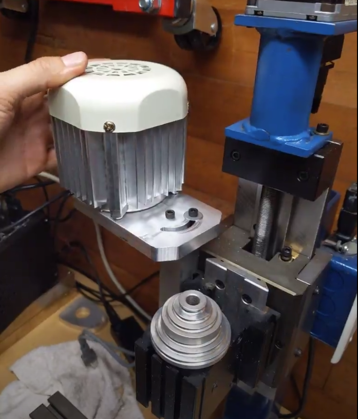

      I just made an adapter plate for my Taig and got the Consew motor running. The pulley sits a little high on the input shaft because I used 1/2" Al plate, so I might have to tweak things, but right now it works like a charm. Big improvement for sure.

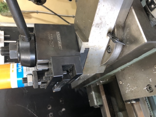

        Thanks doc...
        the previous owner warned me about the gap.... and he had removed it once. Said the bottom of the gap section needed to be resurfaced then shimmed. He strongly recommended not to do it ever again.
        The wedge style tool post was one of my first purchases, with 6 holders, a knurler and blade holder. I came across a company called “accusize”. Definitely not going to see their stuff in a production shop but decent quality for home. Plus they ship from Toronto which is a huge plus for me.
        With that tool post... of course the supplied t nut didn’t fit so one of my first lathe projects was mill a new nut.

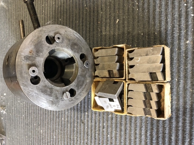

        there’s a picture of the threading tool.... if someone can point me in the direction of some information on this that would be great. And another 8-10 sets of dies not pictured.
          -That's standard. There are so many different sizes of t-slot on various compounds, that nobody supplies a finished nut. That's virtually always a "cut to fit" proposition.
          -That is what's known as a "die head", it works like a threading die, but "pops" open when you're done. Here's a video I did almost a decade ago, when I was running a batch of custom halfblock 'Cocker pump arms. That's a teeny little 5/16" Geometric head, yours is I think a Coventry. Yeah, here's a PDF on Coventry heads that ought to help you out.
          Looks like somebody's got the front cover on backwards, on yours.
          Now, that said, die heads are really not meant for standard engine lathe use. They're intended to use on screw machines and turret lathes. People certainly have used them on conventional lathes, but they can be fiddly, and swapping chasers- if you even have the right thread- is time consuming.
          And I don't just say that because I have a turret lathe (see previous posts of mine ) and want to buy it off of you. Really, for engine lathe use, I strongly recommend learning proper single-point threading. You don't have to worry about having the right chaser on hand, you don't have to keep changing chasers, it's easier to 'fit' a loose thread, etc. etc. (Plus I don't think that head's big enough to, say, thread a 'Cocker barrel. )
          And on the chucks, I've done the same thing. I use 'soft' jaws a LOT, and so I bought a second 3-jaw for my regular lathe. That way, switching from a regular chuck to soft jaws is as easy as swapping the whole thing, rather than pulling bolts. AND... the jaws stay true. You don't have to re-turn them every time you swap, which of course makes them last longer.

            Thanks. I found my die head in the link and you get a like and subscribe.
            to be honest with you it’s been sitting since I brought it home. It does have a straight shank on it so needs maybe an mt3 arbor with a flange to mount it.... 🤔 or something. Mostly curious because it has about a dozen sets of dies for common threads.

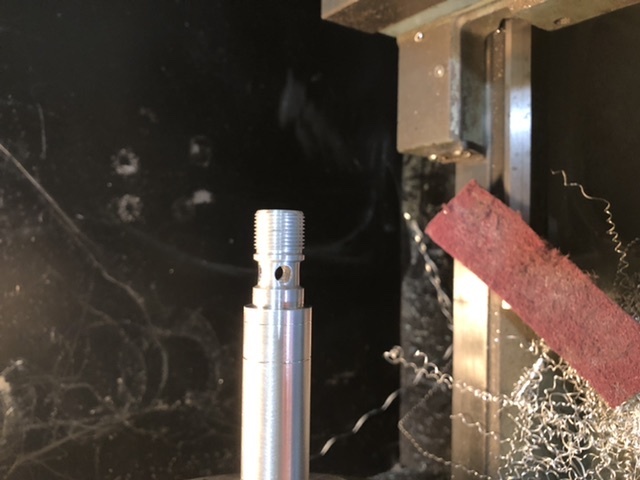

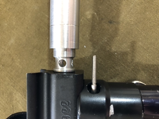

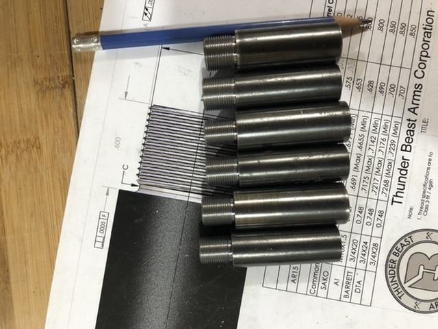

            I cut a banjo bolt the other day which was a good little project with threads. Also needed a longer timing rod and didn’t have a 5-40 die (have set for die head). That was a real pain and had to rig up a follower to get it but did get it.
              -While I have seen people put Morse shanks on them and use them in the tailstock of a conventional lathe, that's really iffy and a good way to potentially break something. The die head works by being manually fed into the work- that is, you keep moderate pressure on it as it "screws" itself forward- until it hits a stop. After which, the head continues 'screwing" itself forward a bit more, and that action pulls the head out a bit, which trips the opening mechanism.
              You can see it in my video- the head "floats" a bit on the mounting, and then pops forward to release. You can set up a carriage stop for the carriage, or a similar stop for the tailstock, but really, compared to single-pointing, it starts getting pretty fiddly.
              The straight shank is designed to fit in a turret lathe or screw machine:
              I wasn't joking, by the way. I'd like to buy it for my new turret, if you're of a mind to sell. The only die heads I have right now are that same little Geometric, and an antique Jones & Lamson that according to the internet, is the only one of this model that exists anywhere. I can't find parts, chasers, documentation or even mentions of it.
              If that thing's got a 3/4", 1", or 1-1/4" shank, it'd be ideal for my machine.
              -Looks great! In your first pic of it, it looks like you left the stock sticking a bit far out. You want to "choke up" on the stock and not leave too much sticking out. That improves rigidity and surface finish, and is less likely to chatter.
              -I hate trying to single-point anything smaller than 10-32, and even that can be a pain. Especially in stainless.
              For the smaller threads, the classic trick is a die holder. Something that fits in the tailstock and holds a conventional threading die, which you usually turn by hand. The lathe just serves to held everything straight.
              Little Machine Shop and a couple other sources have ready-made ones, and there's plenty of plans online for other versions. Clickspring has a video on making one, and I think that vid has a link to plans.

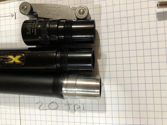

                you mentioned cocker threads.... the other day and just for the sake of doing it. Took an old SP1 barrel cut the threads off and gave it cocker threads. Came out really good.

                  • 284

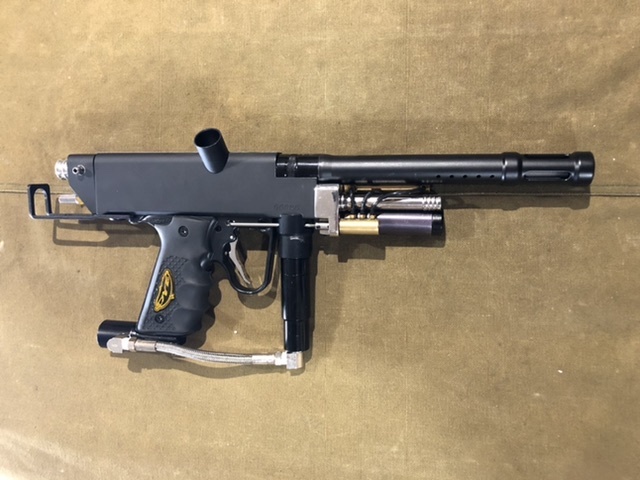

                    -Noice. Feels good to be able to make stuff like that, doesn't it?
                    Now, for your next challenge, turn a thread to fit a Shocker or Ion.

                            This is hands down the best upgrade I ever did for my taig. Another potential route you could go is use an XL timing pulley. They are a lot thinner than the multiple pulley setup of the stock taig and with a Consew, you wont need to change gear ratios. B&B manufacturing can sell you a set with any length belt you require (Mcmastercarr also stocks a limited size).
                            I originally used a 3/8" plate to hold mine. When I changed over to a servo motor, I used 1/4 and it seems to be holding up just fine.
