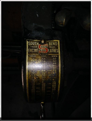

      Latest acquisition:
      -Just under four months later. Almost fully rebuilt and repainted, and as of today, 100% operational.
      Can't wait to start makin' proper chips with it.

        Chips? You know a machine is old when it has a name like No 2.
        • DocsMachine
          • 2773
          #94
          That's actually a size designation. It's not like it's only the second one they built.
          The smallest is a No.1, this one's the next up, a No.3 is only marginally larger but has more features, the No. 4 is considerably larger, and the No.5 is probably twice as large. Then there's the 1A, 2A, etc. up to the 5A, which weighs over 20,000 pounds.

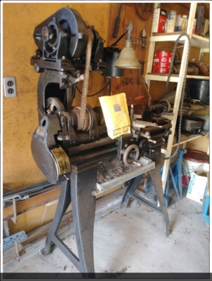

          A South Bend Lathe just came up at a local estate sale. It is on sale tomorrow. I don't know if they realize what they have here (I don't either). How low would this need to go for you to buy it? Am I right in thinking that those things on the wall go with the lathe, and the value is north of $1500?
          • netsurferdude2
            • 879
            • North of Bawlmer
            #96
            I wouldn't go more than $500 on a 9in Southbend like that. What type of tooling does it come with? 3 and 4 jaw chuck?
              -Depends on your local market. On the East Coast, that's a $300 machine if it works. On the West Coast, maybe more like $500-$700, depending on the area. Up here in Alaska, somebody'd give you $1500 for it, but that's only because it's a machine-tool desert. Heavy iron costs a fortune to ship up here, and so even mediocre machines go for more than most of you lower-forty-eighters might pay.
              Am I right in thinking that those things on the wall go with the lathe[?]
              -Probably. One looks like a drill chuck or live center for the tailstock. The rest are hard to ID, but look like wrenches and such.
              The most important thing to look for, if you're interested in buying, is a set of change gears. They'll be iron gears from around 2" up to about 6" in diameter, and might be as many as a dozen. That machine doesn't have a quick-change gearbox, so in order to change threading rates or feed rates, you have to swap physical gears. If there are no gears with the machine, cut the asking price in half.
              [A]nd the value is north of $1500?
              -In my opinion, no. It's an antique plain-bearing machine, limited in spindle speed, and is a change-gear machine. It'd be fine for a hobbyist who just wants to putter, and it'd likely be a very good learning machine.
              IF it's in good condition, with minimal bed wear and minimal spindle slop, and the so-called "Silent Chain" drive (the big overhead assembly) is in good shape, AND you're in kind of a machine-tool desert area, it might be worth $700-$800.
              Keeping in mind there is basically no such thing as a machine-tool collector- an older machine, even in great shape, is not worth any more just 'cause it's old.

                    For those looking for a lathe, first consider what you're going to do with it. I know not many here are planning on going into production, but even still, many of the features that make it better for guys like me, make it more pleasant to use even for beginners or part-time tinkerers.
                    The main issue with that above South Bend is the fact it had no quick-change gearbox. That means switching from 20 thou per rev to 40 thou per rev, requires physically unbolting a gar, and replacing it with another. Ditto going from turning to threading.
                    If there's no other option, or affordable option, available locally, you can certainly make it work. One of my first lathes was that way- a Logan-built 9" Powermatic- and it did the job, but after a while it gets annoying, of not occasionally frustrating.
                    If you're planning on using it for real project work (car, truck, motorcycle, paintball, drone, whatever) it gets annoying when it takes longer to set up the machine than it does to make the cut.
