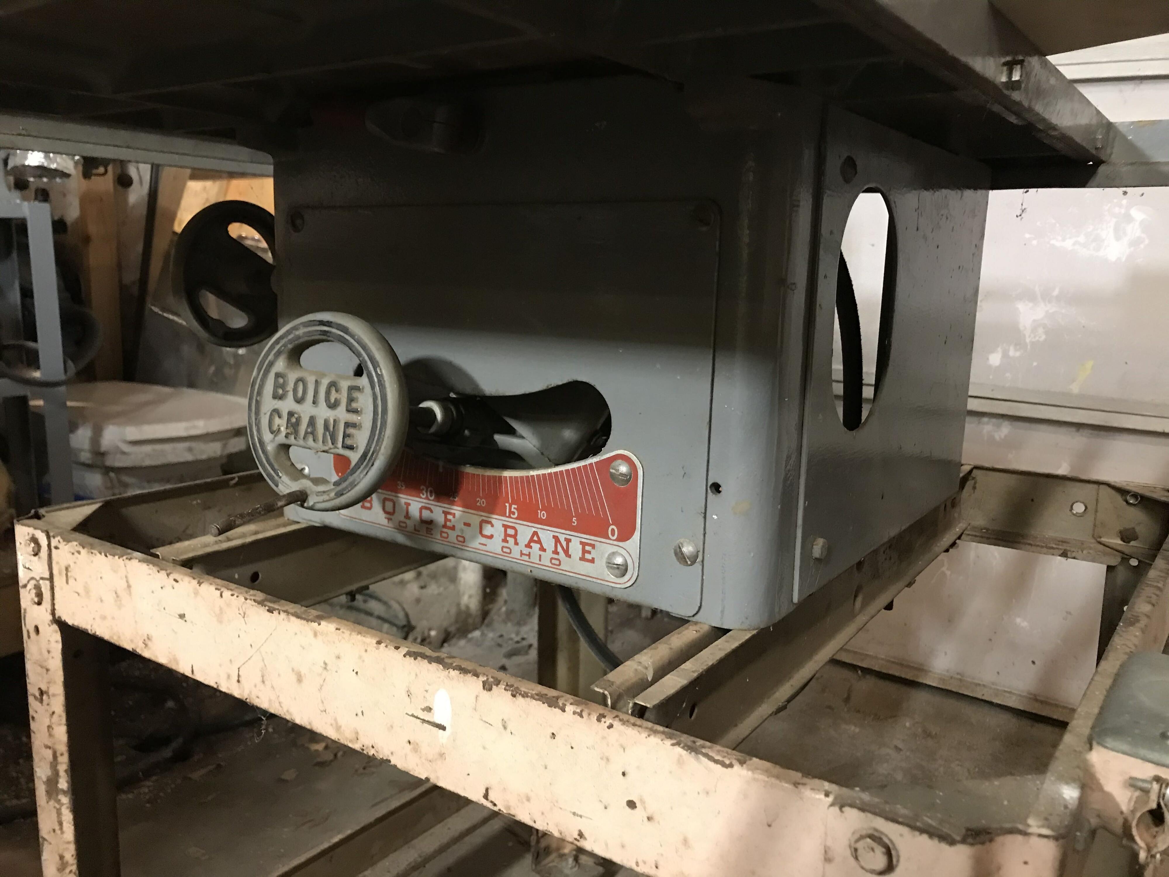

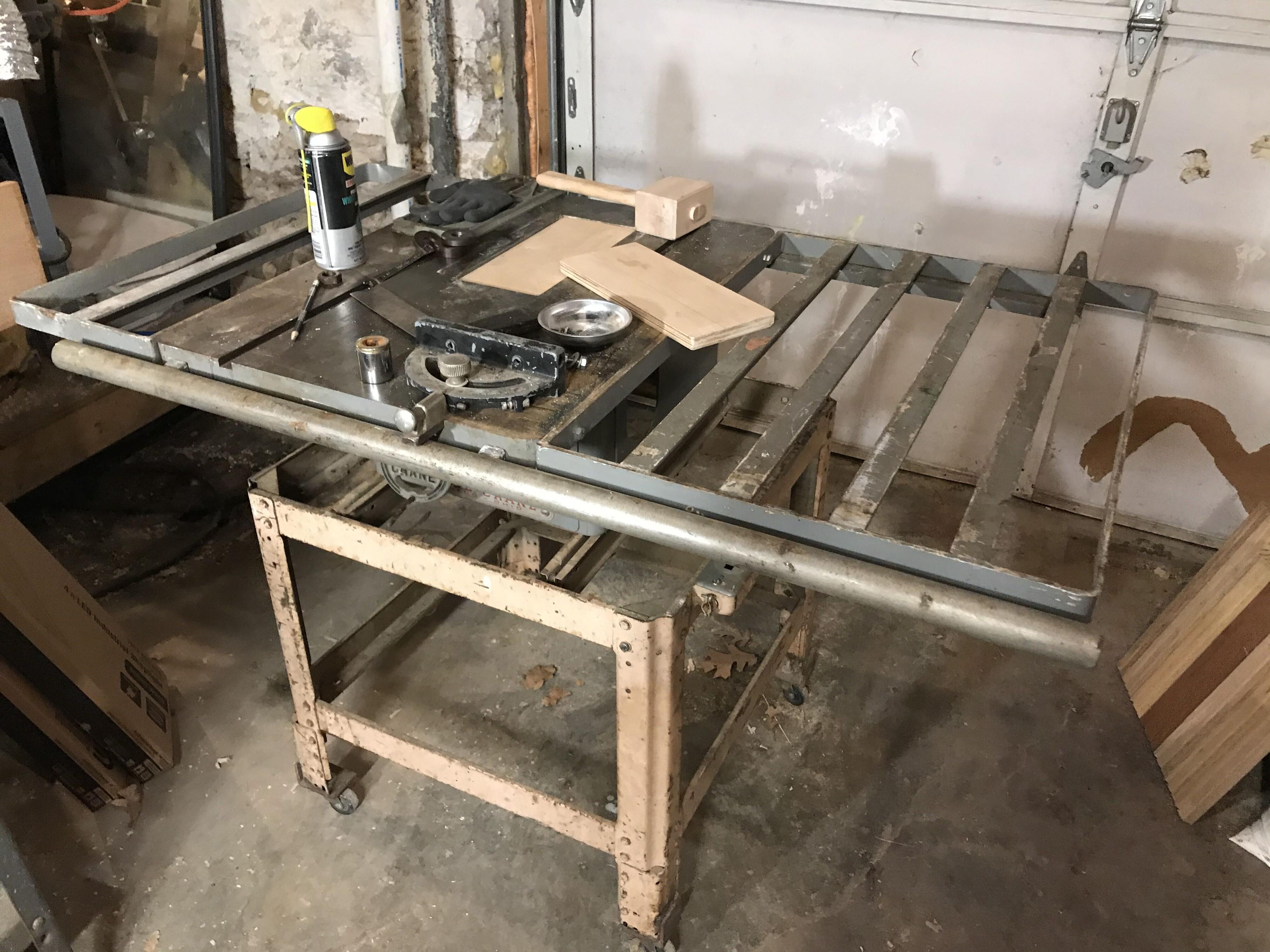

      I was just given a 60+ year old table saw. It appears to be a great saw, but the arbor is no longer a standard width. A standard arbor is about 5/8ths of an inch, and this arbor is 6/8ths of an inch.
      Do you have suggestions for widening the blade hole or turning down the arbor? I have a drill press. I do not have a lathe or a relationship with a local machine shop. Thanks!
      This may become my dedicated Dado saw.

        Some higher end blade manufacturers used to offer to bore blades out to a larger hole. You might find a sharpening shop that can offer the service as well. A quick Google search shows a few different 3/4 arbor blades on eBay and Amazon as well
      • Jellyghost
        Jellyghost commented
        Thanks Flounder. I am not sure (but I have cheap blades to practice upon), but I think I can bore it out using my drill press. I think I can line it up with a bit that matches the current hole, and then clamp everything down before switching to a larger bit. Lets see how it goes. It should save quite a bit because I have this big cache of blades looking for a saw.

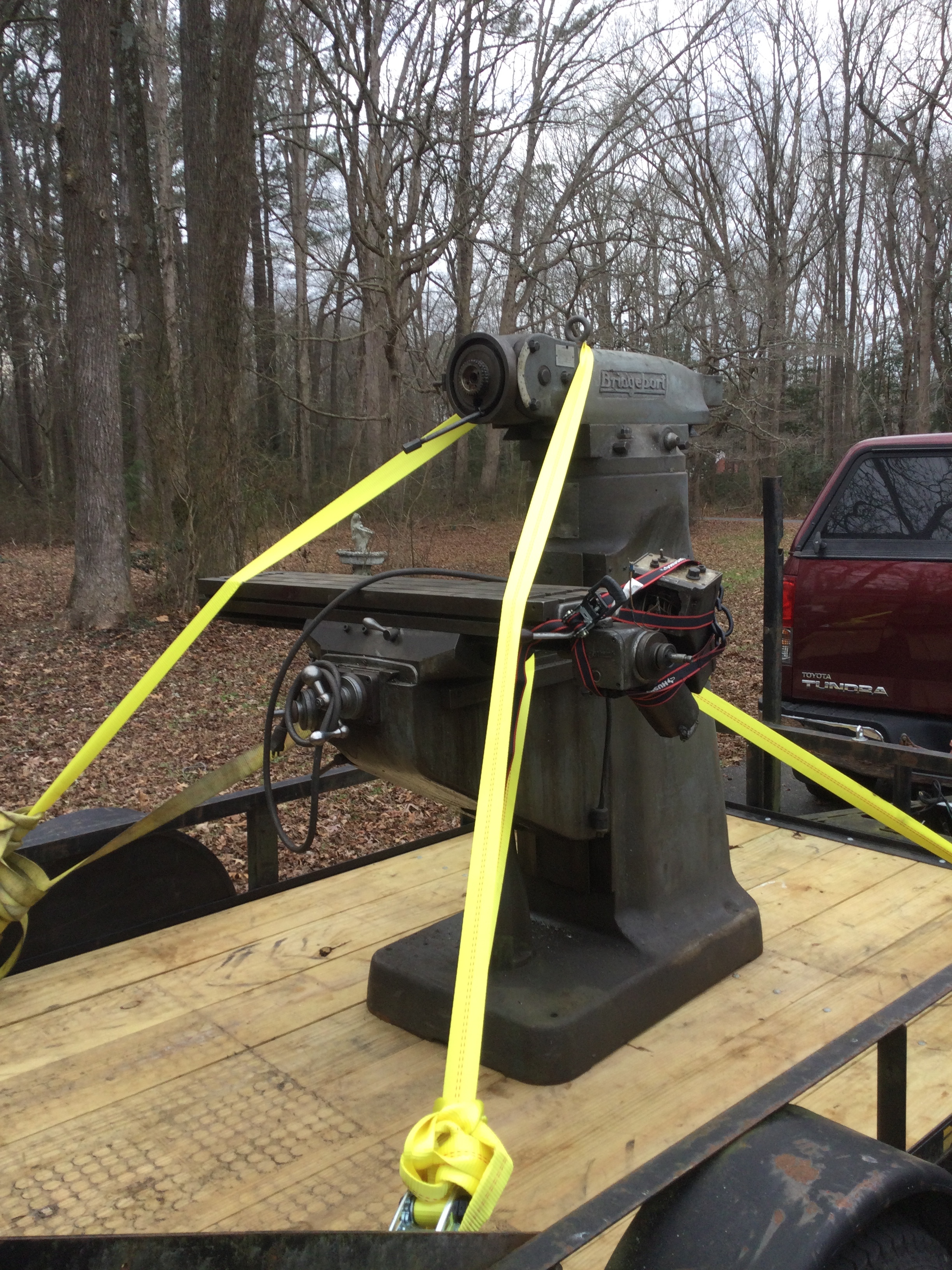

      I a have a new project to work on now. Step one is get it off the trailer. Most of the missing pieces are in the back of the truck. Will need to source a few things to get her up and running but excited about this new project, a special thanks to one of our members here who get me involved with this deal.
      Click image for larger version  Name:	E384D66E-51AC-4A08-A3D3-251E5FE41684.jpeg Views:	0 Size:	2.92 MB ID:	76986
        XEMON
        commented
        Nice piece 👍
        That will make lots of chips

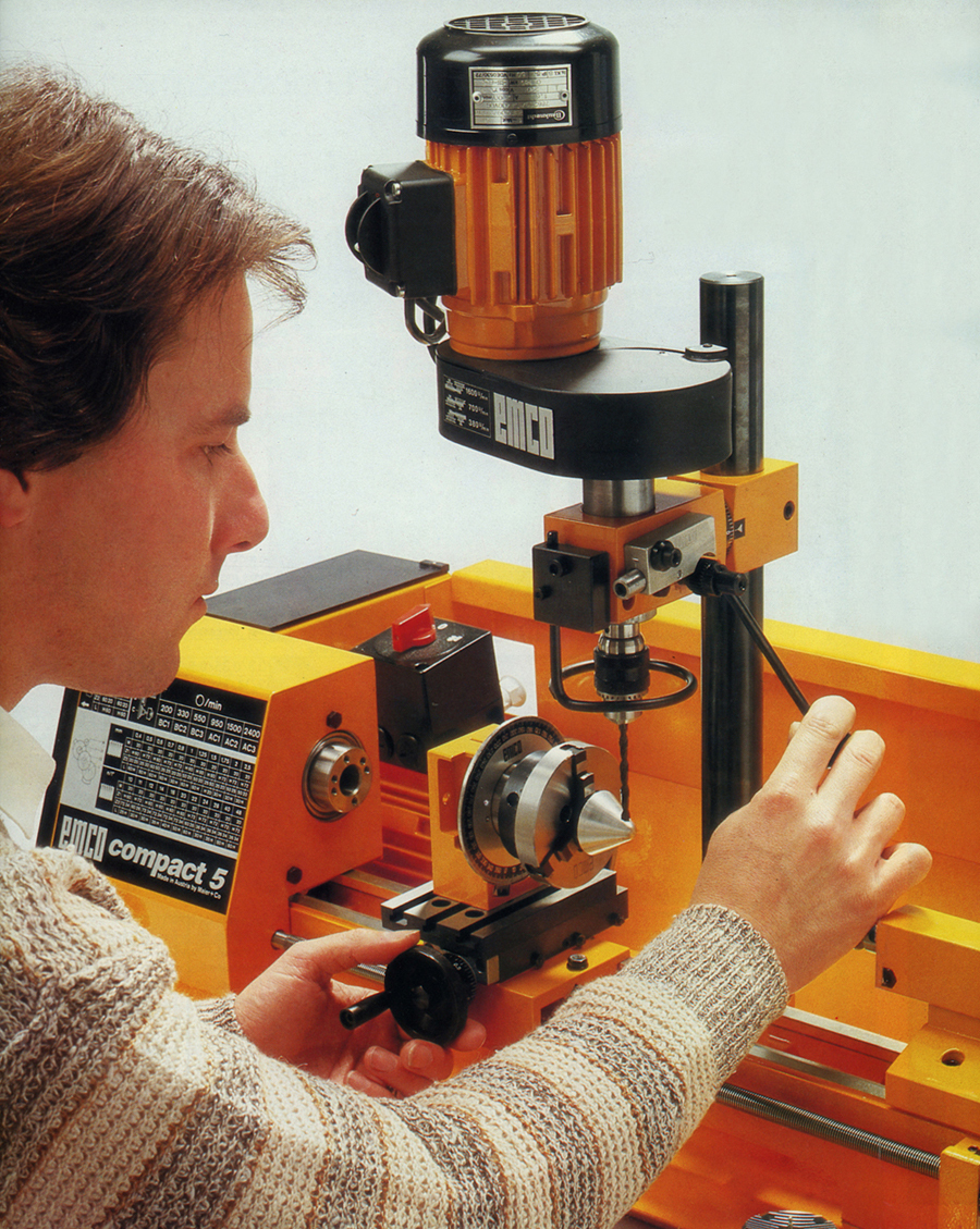

          Hoping to get some advice for my compact 5 ...
          Id like to get a 4 jaw chuck (independent) for it, but the mounting on the spindle isn't quite standard:

          Now, most "standard" small chuck have screw from the back ...
          I don't really have the equipment to make adapter and I seam to have trouble finding chuck that mouth on my spindle.
          Any advice/help/source for affordable chuck?
          Also, anyone able to make me a plate if I supply the prints?

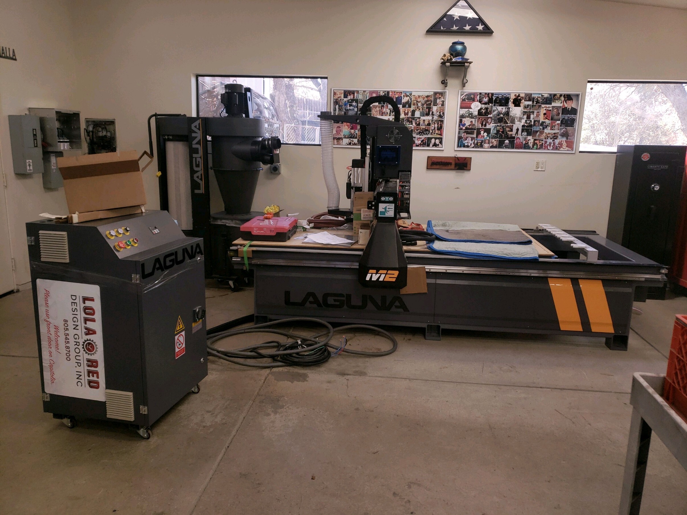

ID:	111190 It's new to my shop, but my wife has had it up and running in her business for almost a year before we shut it down due to Covid crap.
            Moved all of her large format printers into the house and i cleared out a space for her to put the CNC Router in my shop. It's up and running now, (picture is from last month) so look for some cool aluminum products from me in the near future...

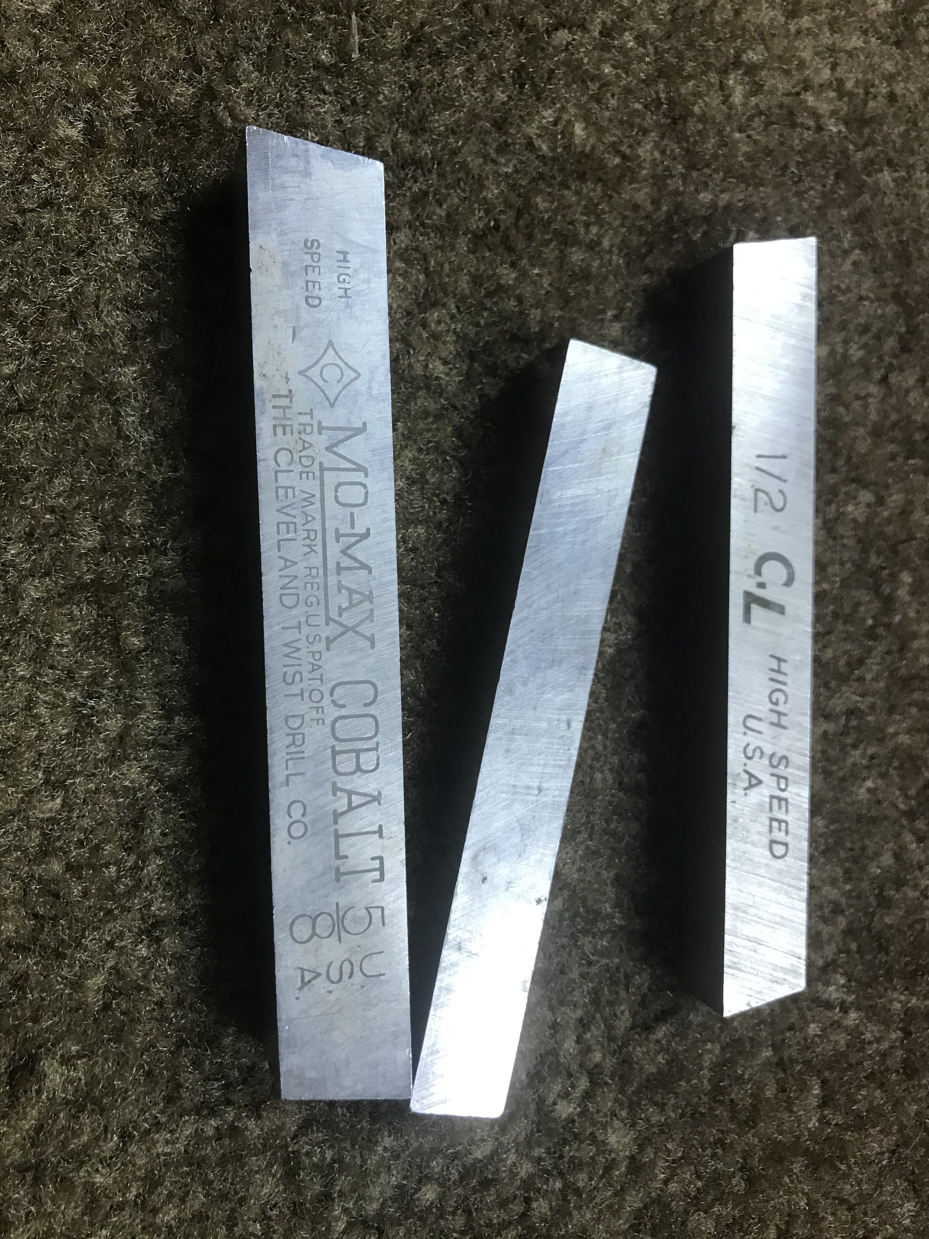

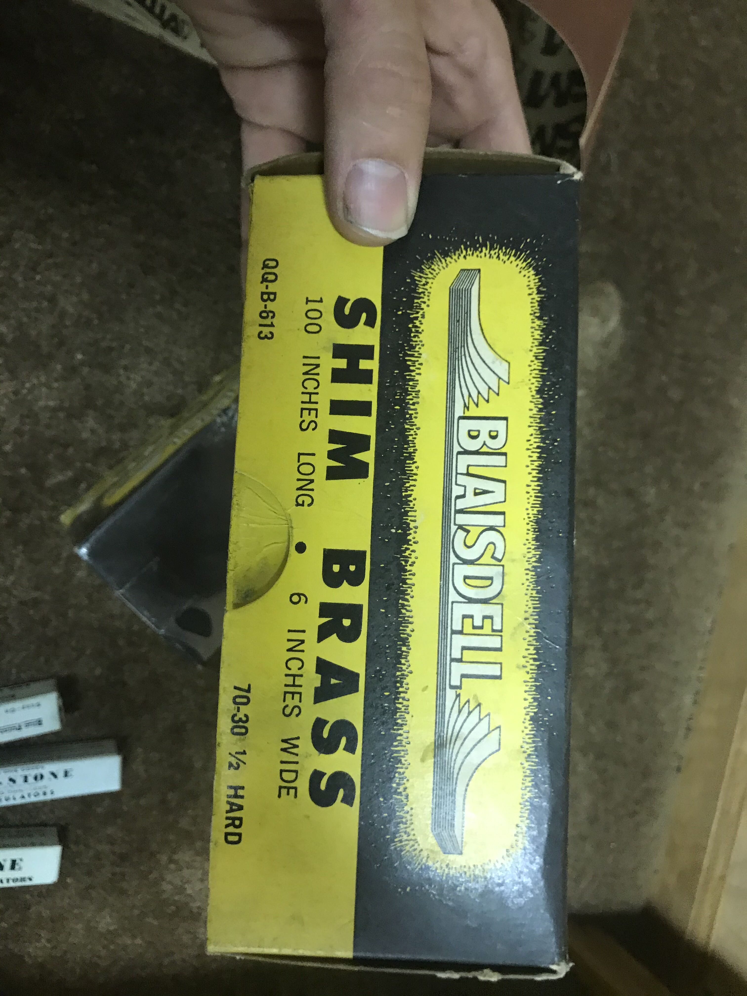

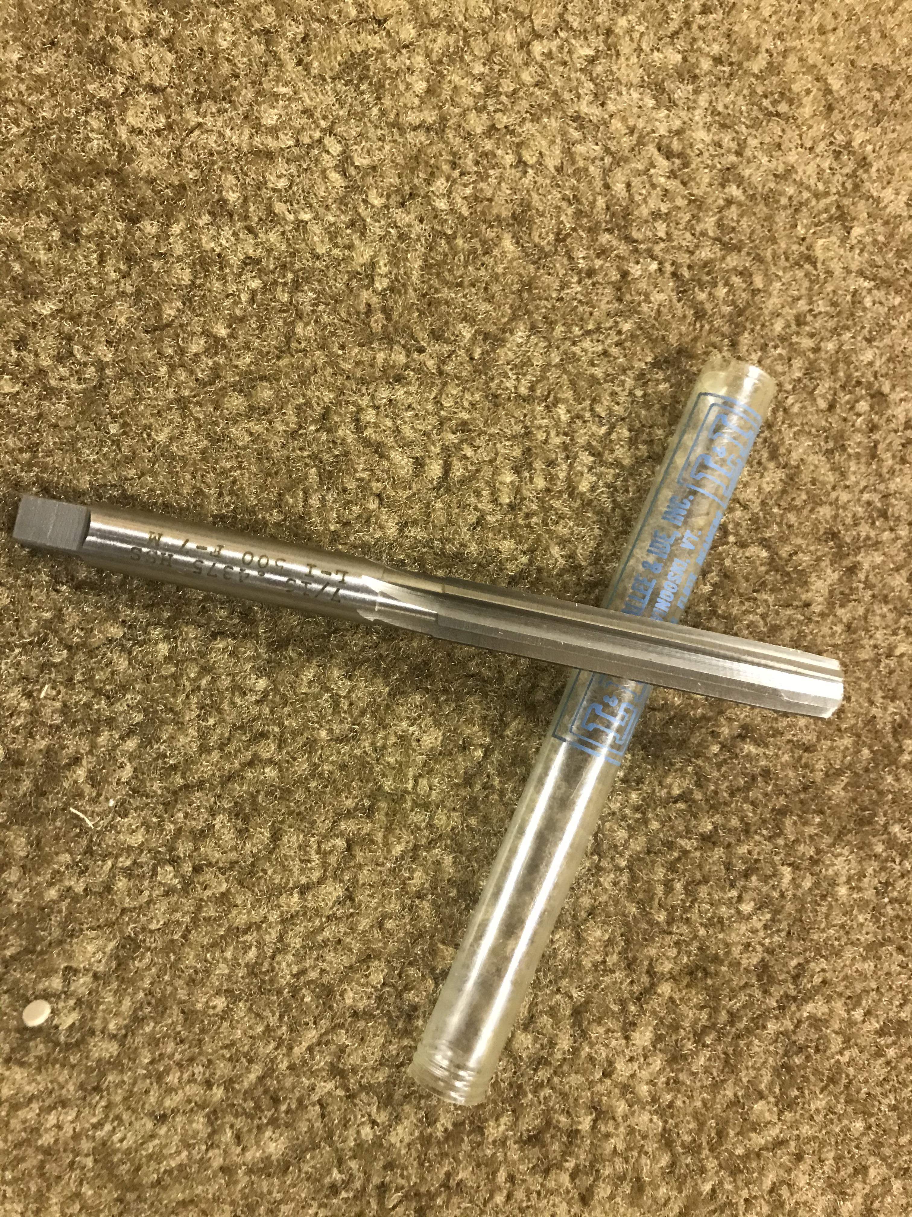

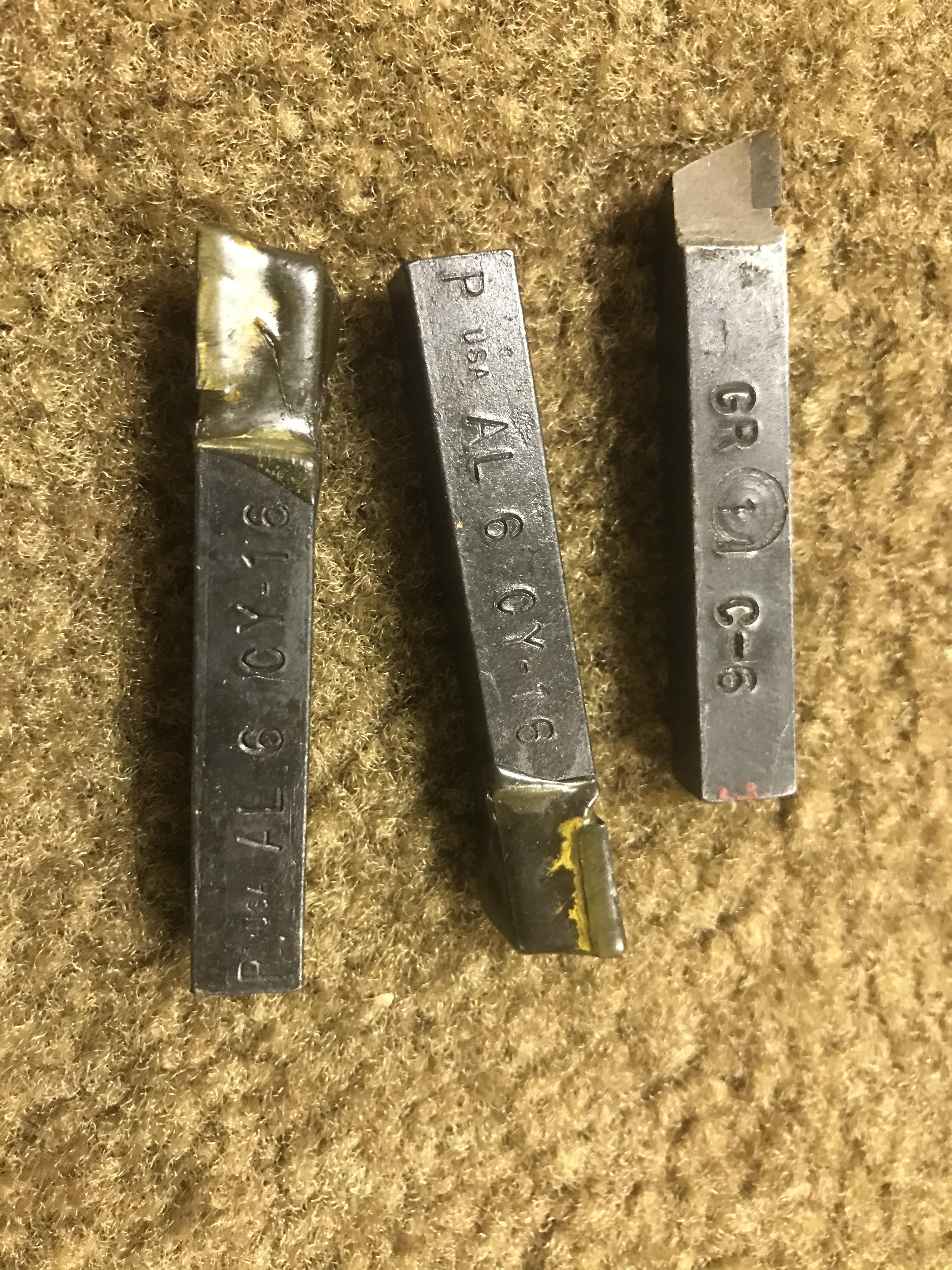

            Jellytoast: The first pic is Just What It Says On The Tin. It's shim stock, just thin brass sheet, used to, well, shim things. Machinists will often use it to shim lathe tools to proper height, if they don't have an easily-adjustable toolpost, but it can be used for a lot of things. It's worth maybe a couple bucks to somebody.
            The second pic shows unground chunks of HSS, or High Speed Steel. Those are classically ground into lathe tools. The two with shown labels are good American-made pieces, and maybe worth a bit more to a discerning sort. But "a bit more" might mean a couple bucks for the 1/2" and maybe a couple more for the 5/8".
            Third pic down are cemented carbide lathe tools. Those are at least US-made, but they're almost worthless. I have a drawerful I never use, as do most machinists. Offer all six pieces to somebody for maybe $10, shipped.

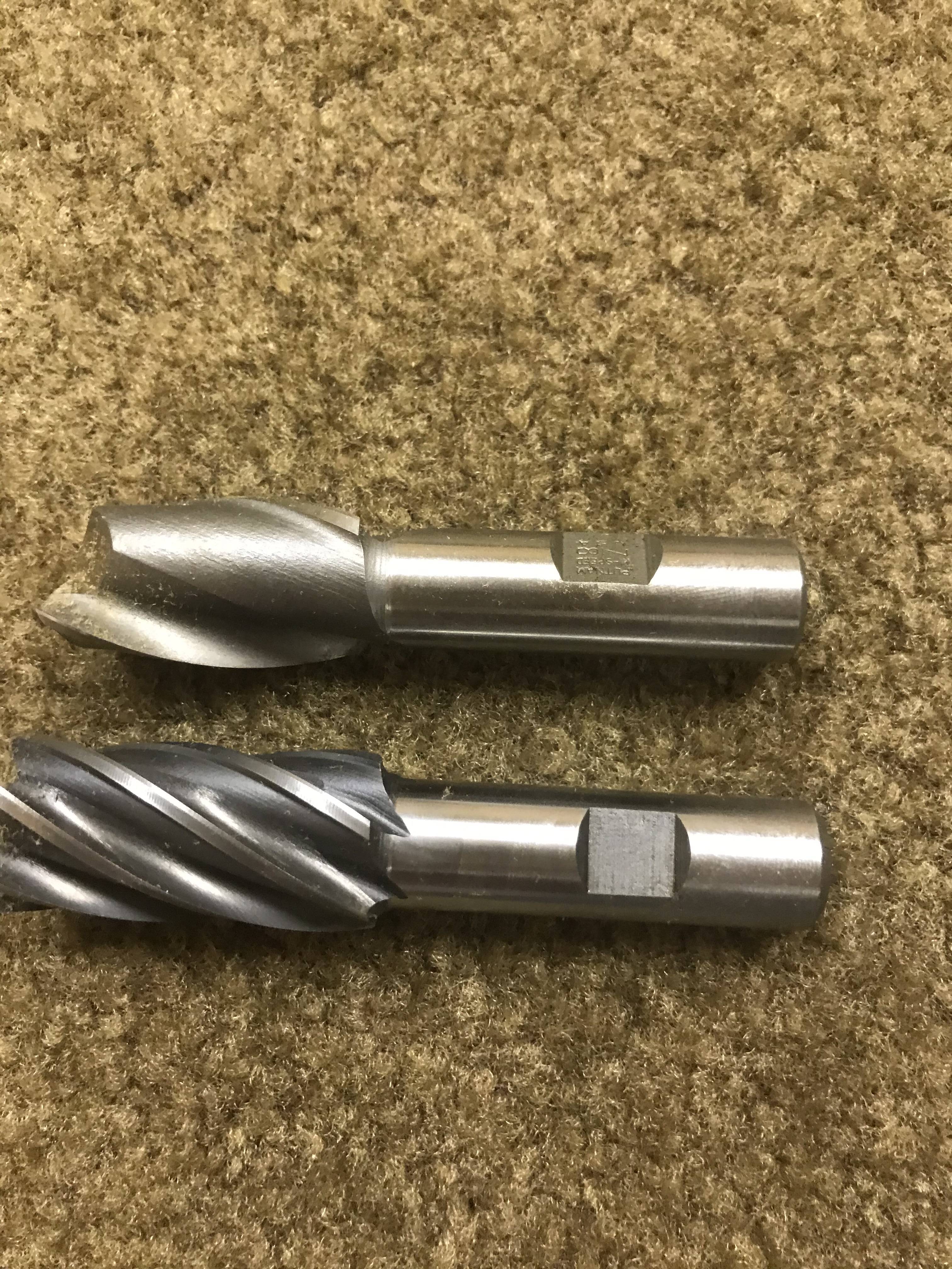

            Fourth are a pair of endmills, 3/4" shank, I think that one says 7/8". Both look reasonably sharp and unabused- protect the cutting edges, if those get chipped or dull, they rapidly lose their value. Those can be worth $10-$20 each, and I'll take 'em if you're selling.
            And last is a 7/16" hand reamer, also looks sharp and unabused. Also worth about $20-ish.

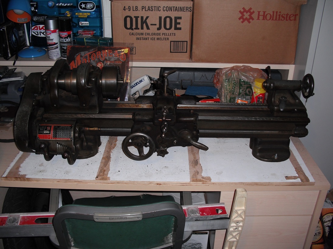

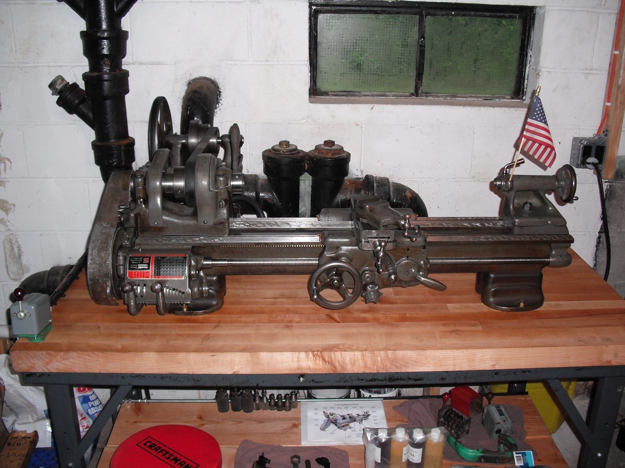

            figured Doc would appreciate this. 1947 9A, finally got it running
            before-
            after-
              -Noice!
              For half a second there I was wondering what kind of motor you had powering it in the second picture.
              You might think about finding something that can put between it and the table as a drip tray. Old machine like that, especially with plain-bearing spindles, as I said earlier in the thread, live in oil. You can't over-oil them, at least not until your socks start to squish.
              I know those 'butcher block' tops are fairly fluid-resistant, but a "lip of a tray or something helps keep the mess contained.
              You might find an HVAC shop to just 'brake' you a tray slightly larger than the overall dimensions of the machine, with a 3/4" or 1" lip, just out of galvanized 20 ga or something.
              Doc.
              Paintball in the Movies!
                yeah i need some kind of tray for it. i was surprised how quiet and smooth this thing runs, man i miss American made. she's been starting to leak a bit on me (like an old Harley), i researched these lathes quiet a bit and was aware of that, but most of the things i have leak oil haha. i treated the block with mineral oil, really soaked it in. still gota clean the chucks and tooling for it and start making stuff
