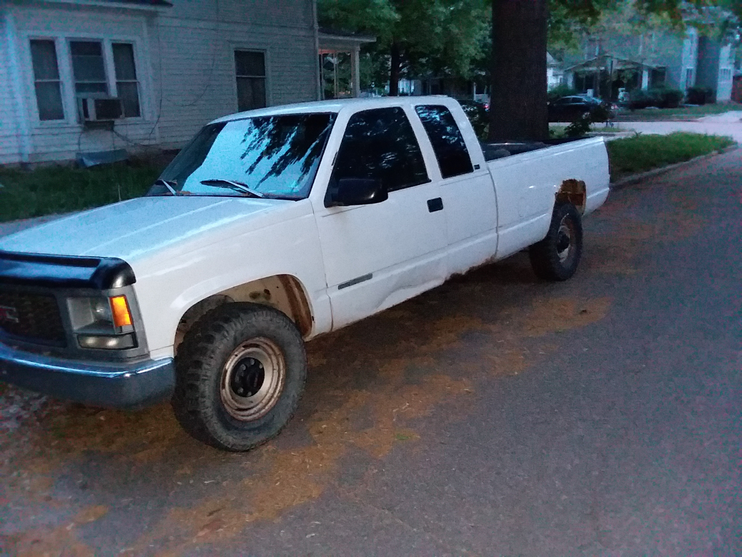

          A photo was requested: https://www.mcarterbrown.com/forum/m...tte#post402303
          Click image for larger version  Name:	20230507_203229.jpg Views:	0 Size:	1.66 MB ID:	402351

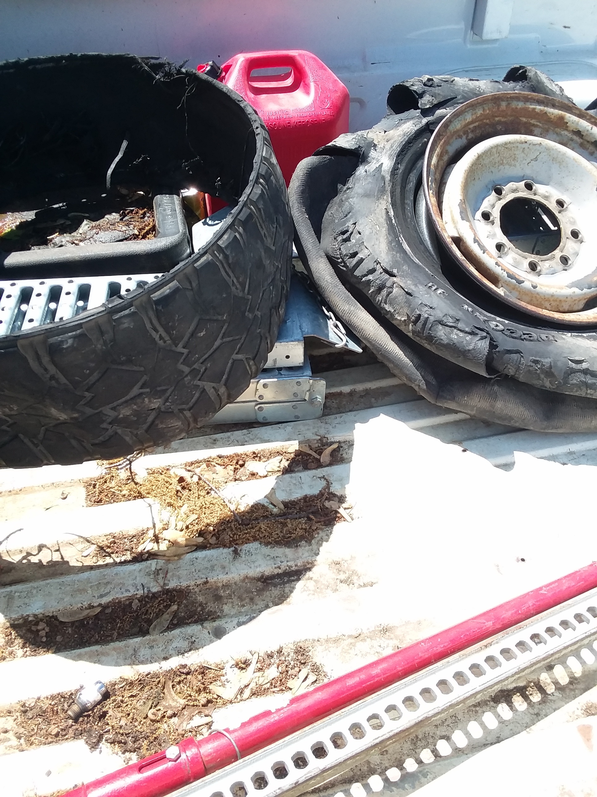

          Karma was balancing yesterday with today. I found a set of five tires mounted on Dodge rims cheap on Marketplace today. I need one more 8 bolt GMC 16" wheel to swap them over. Only the spare has seen the ground... basically five year old new tires. (I shredded a front tire at 75mph on interstate yesterday. Going to swap them all out so I know what I have.)
