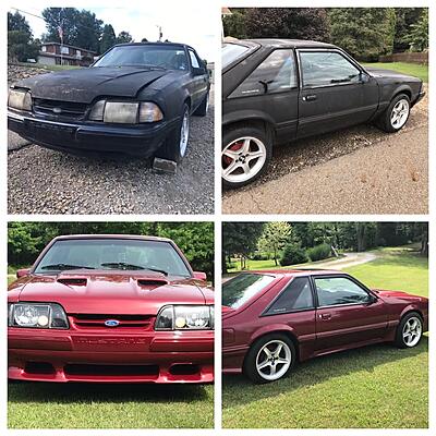

    A few years ago my girlfriend bought me a project fox body mustang for my 37th birthday. It had been sitting in a field and was beyond badly neglected. Interior was mostly gutted/trashed, engine was in pieces, etc... I kept telling myself I wanted to be driving this before I turned 40... TONS of learning, lots of blood/sweat/tears, and a small fortune later I made it with 2 weeks to spare!
    This was far more involved than any other car I've had in the past but was an awesome learning experience and I got to spend some great time and create memories with my dad and brother who both helped me along the way.

          Thanks! It's actually a Kia color called Remington Red that they put on the Optima for several years. Has a lot of flake in it and looks almost like a dark cherry in the shade but the edges glow like a candy apple in sunlight.

              Thanks! I certainly did put a bit of money into it, but doing the majority of the labor and the paint myself saved a TON. I did all the engine/body/brake/interior/electrical work myself. I did have to shell out for the rebuild of the transmission and installation of the 4.10 gears - I just didn't have the tools for the gears and the transmission was out of my wheelhouse.
              You're 100% right on the fast part. Mine sounds fast (no cats with Flowmaster 40s), but it's not going to beat most modern sports cars. I mean, maybe next year after it gets a turbo, but right now it's just a mean sounding cruiser - and I'm totally ok with that
