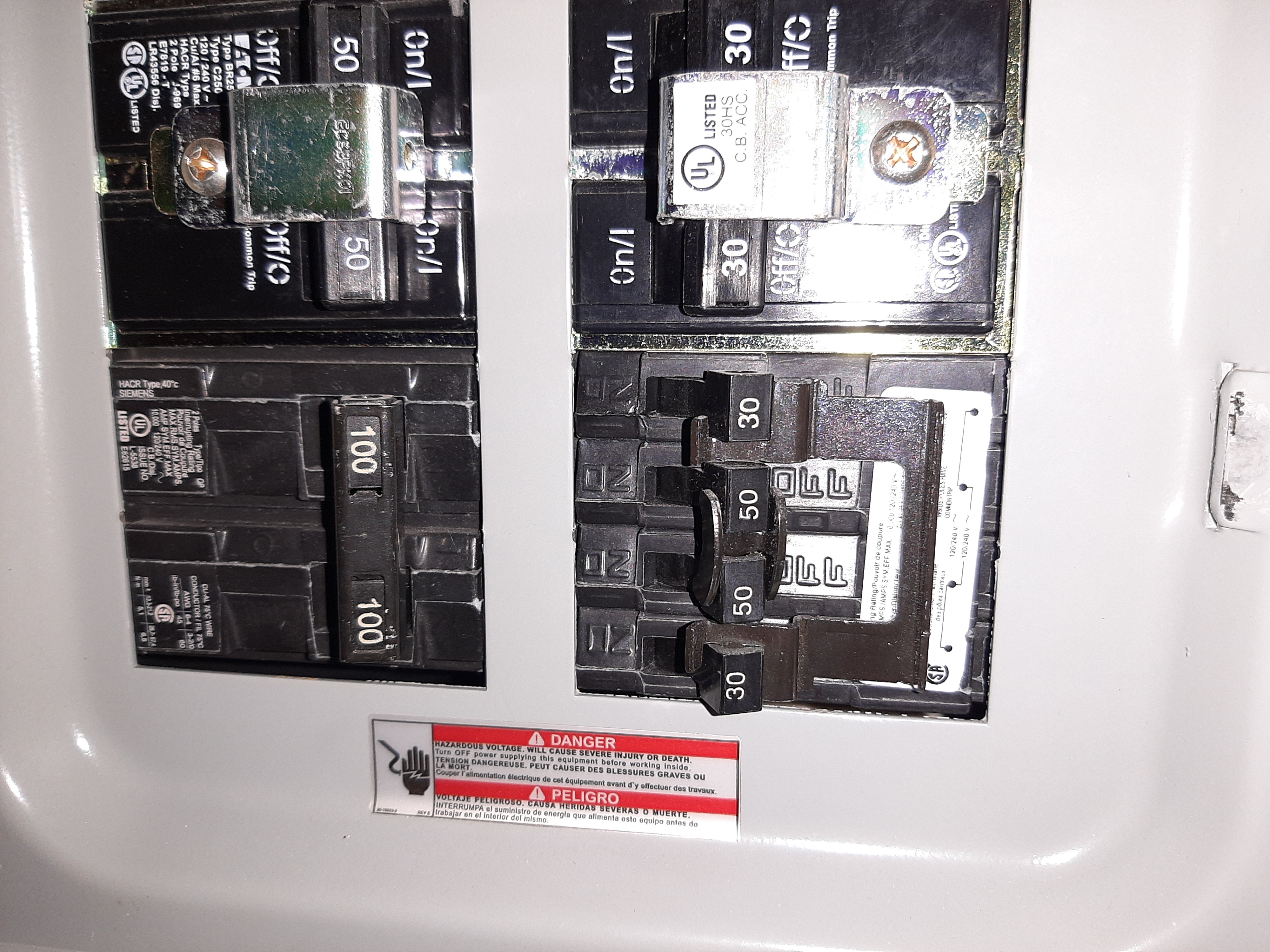

                  • 6381
                  #23
                  Hmmmm, here's what I'm working with. Unless I'm wrong, those already look like doubles

                    #24
                    if you get a compressor thats got any real power you will need to pull from a breaker similar to the 40 and 60 amp breakers on the left.
                    first thing to check - are those really all being used? and for what - feeding sub-panels? or appliances. bigger shop type compressors often show a huge amp draw on the specs - this is for the start up, then it draws far less while running. so i t might be possible to share one of the big breakers with another appliance or something depending on what its being used for. is the breaker marked for whats what? pull the cover off. sometimes those big ones might not even be used.
                    I did not see that this was the second page of the post - I can't believe your old compressor was running sanders etc! and yes - look for a used larger compressor - and one that requires oil!!
                    check the specs! it may be that one dedicated 20amp/ 115 breaker will work for a mid size compressor.

                      • Levi
                        • Feb 2023
                        • 613
                        #26
                        They make 2-pole (240V) versions of the slim breakers too. So you could potentially gain a couple spaces that way if you don't have an unused breaker already.
                        In the lower right corner here... notice how the handles are tied together (30A & 50A). This puts 2 240v circuits in only two "slots"

                        • Levi
                          • Feb 2023
                          • 613
                          #27
                          I'm sure there's a limit to how many circuits you can shoehorn into a panel & stay code compliant. May be worth asking a bona-fide electrician since you already have a bunch of tandems in there.

                          • martix_agent

                            #28
                            If you have wiring for a hot tub and an old kiln, those are nearly guaranteed to be 230v wiring. .. but i don't see that written on the breaker panel anywhere.
                            What is your main service breaker rated at?

                              #29
                              That's because the hot tub and "kiln" plug are on the panel in the rec room. It's a separate panel then the one I have photoed above. The "kiln" plug is a 50amp plug and I have plans to turn that into RV power in tbe future so I would rather not use that one. No way I'm taking away the hot tub power
                              Also, if I can avoid it I would rather not use the rec room panel. Because of where it's located I suspect there will be lots of holes in walls that would need to be patched after. The main house panel i don't think any holes will be needed and I'm fine with conduit on the wall in the garage
