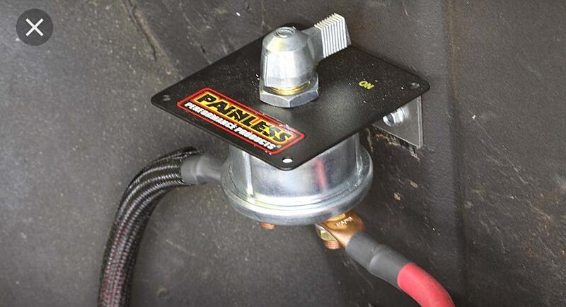

    The charger I am pretty set on the on-off switch my biggest concern is how to mount it and protect it from the elements. It's kind of strange because in all my searching around there are a lot of unoff switches out there but how to mount them is basically a big question mark. So my biggest question I suppose is if I figure out a place to mount that switch will having the leads exposed on the bottom be a concern?

        That disconnect switch is a "panel mount" style. It mounts through a hole in a piece of sheet metal. Like this..
        Click image for larger version  Name:	Screenshot_20240131_113736_Firefox.jpg Views:	0 Size:	149.9 KB ID:	504253
        There's other styles of disconnects if you don't have a good way to mount this one. Here's one example:
              Yeah, I have some stainless steel sheet I can use if I must, it's pretty thick though and a huge pita to cut and work with. Wondering if there's a bracket out there I can buy though. Would save me about 6 Dremel cut off wheels and an hours work
              https://www.amazon.com/Disconnect-Se.../dp/B0CBTKFM21
              The problem I've found with this style is those holes are not for mounting but just holding the bottom plate on. I'm not sure how these are mounted because there certainly doesn't seem to be a way that's described

                The first switch I linked is $37. The second one mounts and conceals the battery wires nicer. Grote is one of the brands Big Rigs use, there is another we sold alot of, but I cannot remember for the life of me. Most Big Rig switches are 200-300 amp rating based on how much draw and charging they get. The 180 amp one is still overkill, you can go less in your camper.
                  Yeah my idea there is a lot of the big rig equipment is actually cheaper than you would think so I want to check and see if that's the case or not
