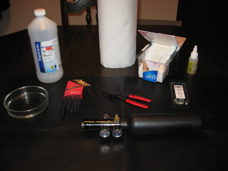

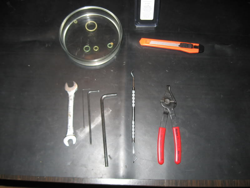

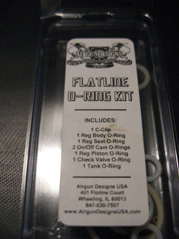

    2) Assemble your tools + parts: You WILL need the following tools...
    * 7/32 Allen wrench
    * 1/8 Allen wrench
    * .050 Allen wrench (the tiny one)
    * 7/16 wrench
    * Dental pick or probe
    * Teflon tape or Loctite thread locker
    * AGD Flatline rebuild kit
    * Q ­ Tips
    * Paper towels
    * Bin for parts
    * Gold Cup (BE VERY CAREFUL USING THIS, I will explain later)
    Click image for larger version  Name:	IMG_0658.JPG Views:	0 Size:	42.7 KB ID:	1093`
    Item(s) that would be handy to have...
    * C­clip ring tool
    * Razor knife
    * Tom Kaye
    Click image for larger version  Name:	IMG_0639.JPG Views:	0 Size:	36.0 KB ID:	1094

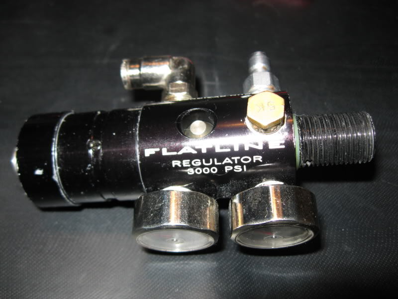

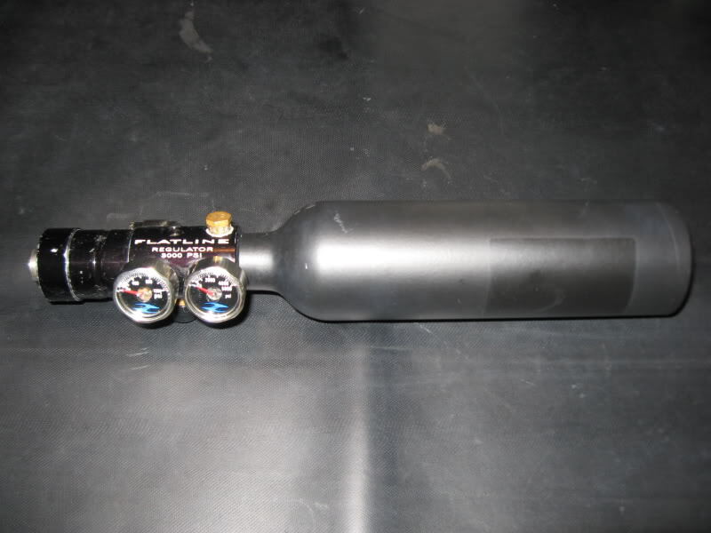

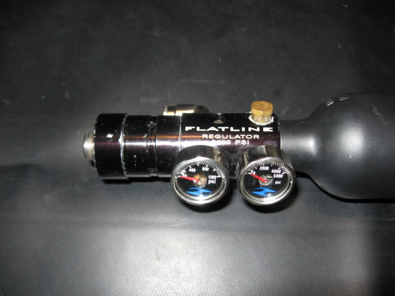

    3) Let's Begin: OK, now that you have all of your tools and a clean space to work, let us begin the disassembly. Take

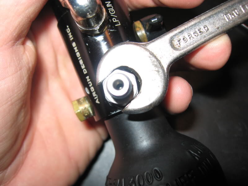

    your tank + reg and separate them. PLEASE ENSURE THAT THE TANK IS EMPTY!
    Click image for larger version  Name:	IMG_0636.JPG Views:	0 Size:	39.7 KB ID:	1095
    Click image for larger version  Name:	IMG_0637.JPG Views:	0 Size:	47.0 KB ID:	1096
    (See how the tank is empty :­p)
    Click image for larger version  Name:	IMG_0640.JPG Views:	0 Size:	53.7 KB ID:	1097

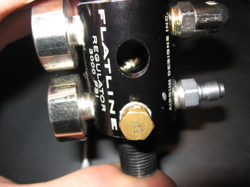

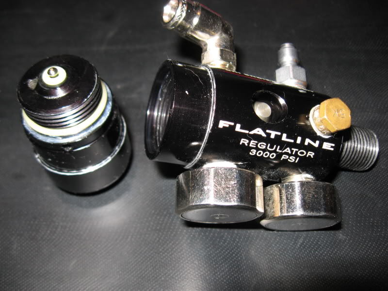

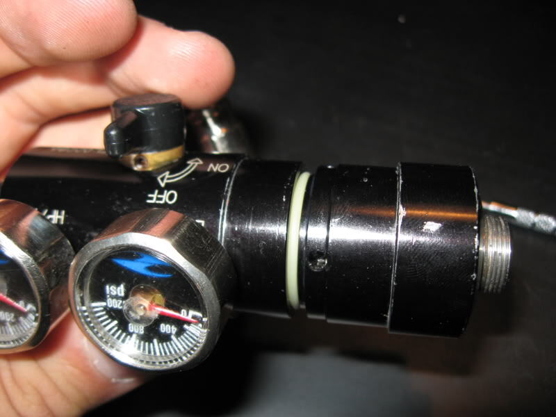

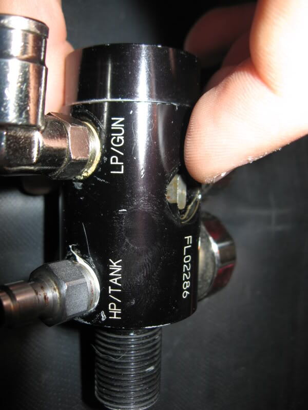

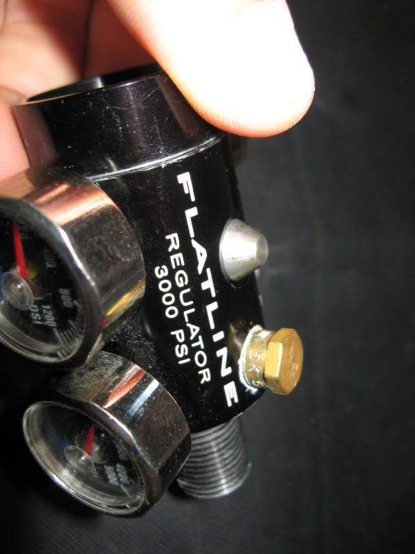

    Now, separate the front pressure regulator. It should just come off with a twist.
    Click image for larger version  Name:	IMG_0644.JPG Views:	0 Size:	67.8 KB ID:	1105
    Take the pressure regulator and set it aside in your bin for now. Now, see that is not such a bad start!

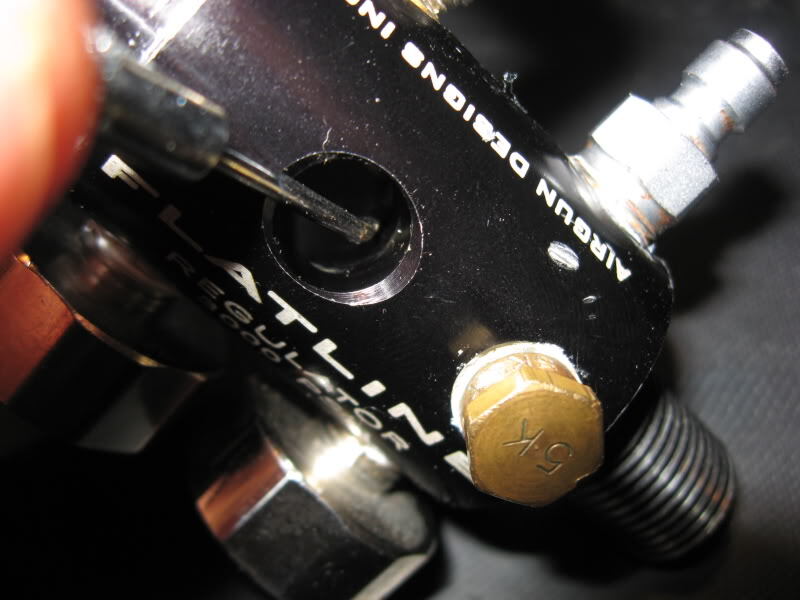

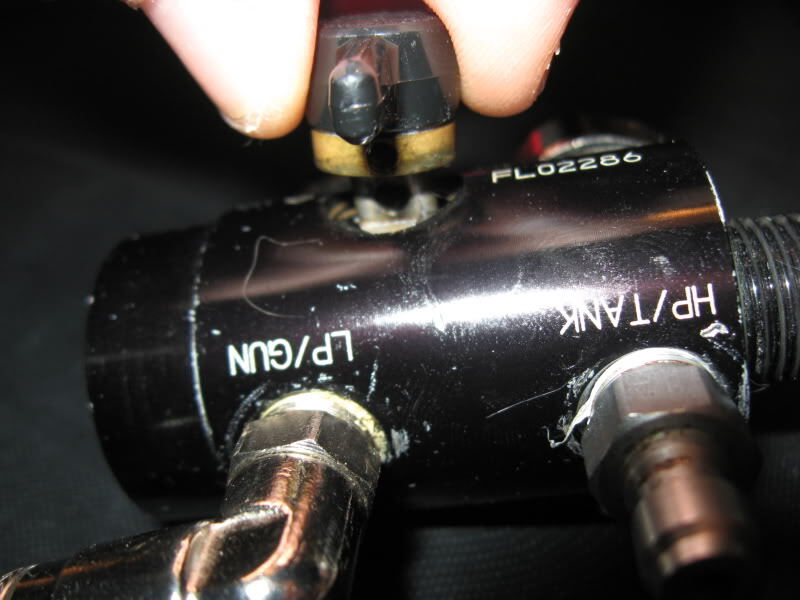

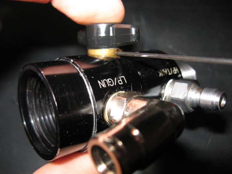

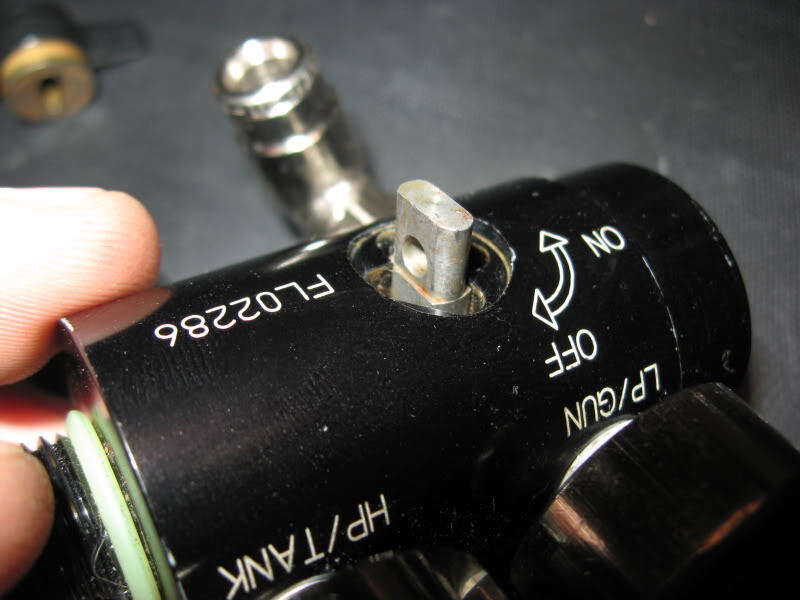

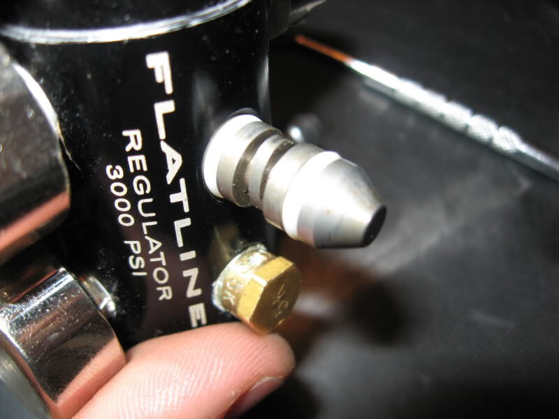

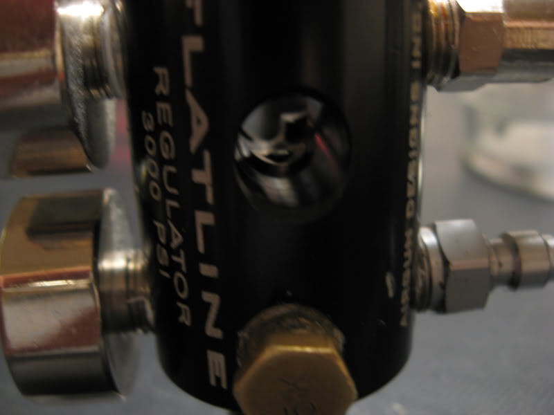

    4) Disassembling the On/Off: Grab your .050 Allen wrench and remove the On/Off knob screw.
    Click image for larger version  Name:	IMG_0647.JPG Views:	0 Size:	42.9 KB ID:	1106

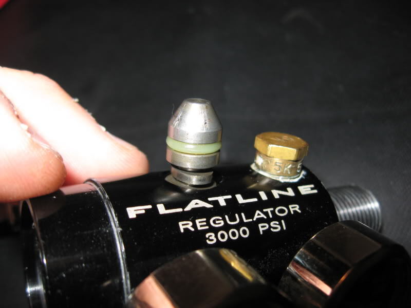

    Pop the On/Off... off (haha)
    Click image for larger version  Name:	IMG_0648.JPG Views:	0 Size:	51.6 KB ID:	1107
    Examine what you have so far...
    Click image for larger version  Name:	IMG_0649.JPG Views:	0 Size:	54.2 KB ID:	1108

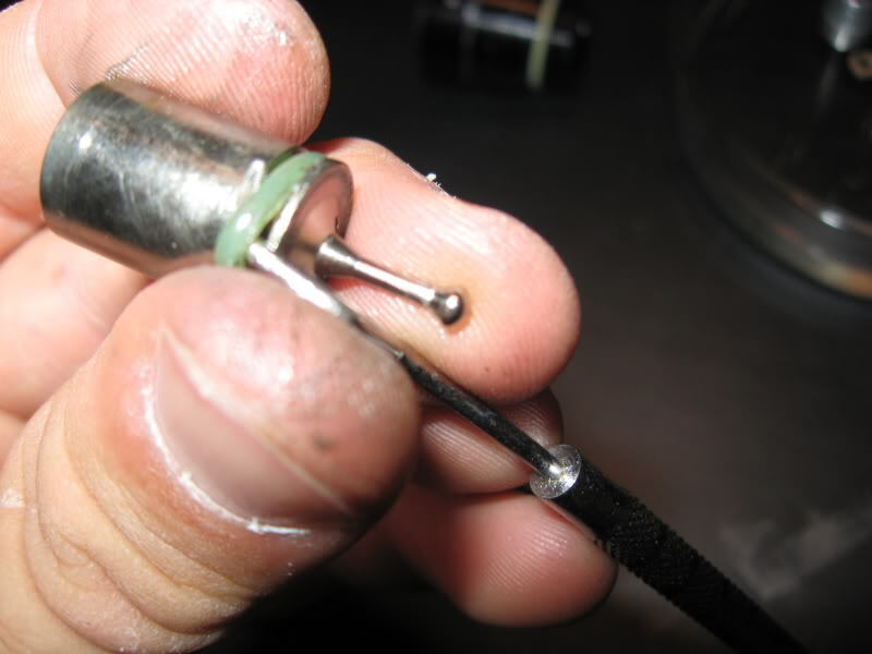

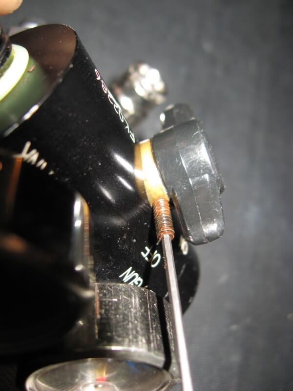

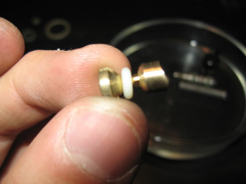

    Now, with your finger and with a tool, push down on the On/Off until it comes out the other side.
    Click image for larger version  Name:	IMG_0650.JPG Views:	0 Size:	54.8 KB ID:	1109
    • CaptainNeeda
      • 39
      Click image for larger version  Name:	IMG_0651.JPG Views:	0 Size:	50.4 KB ID:	1113
      Keep Pushing until you can remove it with your fingers.
      Click image for larger version  Name:	IMG_0652.JPG Views:	0 Size:	38.8 KB ID:	1114

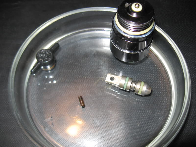

      And put it into your parts bin...
      Click image for larger version  Name:	IMG_0653.JPG Views:	0 Size:	68.6 KB ID:	1115

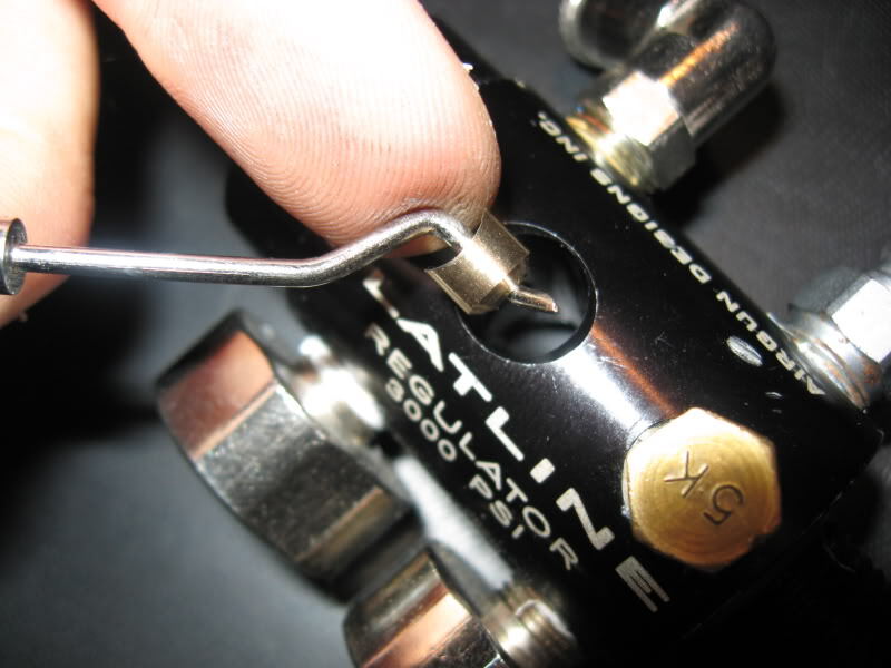

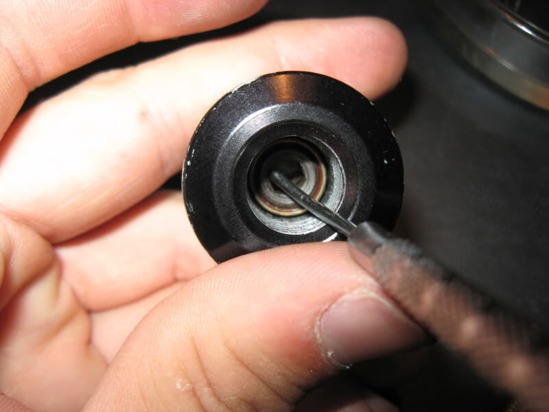

      Now, with your pick, remove the On/Off spacer.
      Click image for larger version  Name:	IMG_0670.JPG Views:	0 Size:	51.1 KB ID:	1116
      Click image for larger version  Name:	IMG_0661.JPG Views:	0 Size:	65.6 KB ID:	1117
      You may or may not be able to see it inside of the On/Off port. If you can't... Give the reg a love tap on your hand (A
      La, bang in on your palm). It should work it self out. But, if you still cannot get it out... Do not be worried. It will come
      out at some point further along in the disassembly, just be ready if it falls out and rolls away.

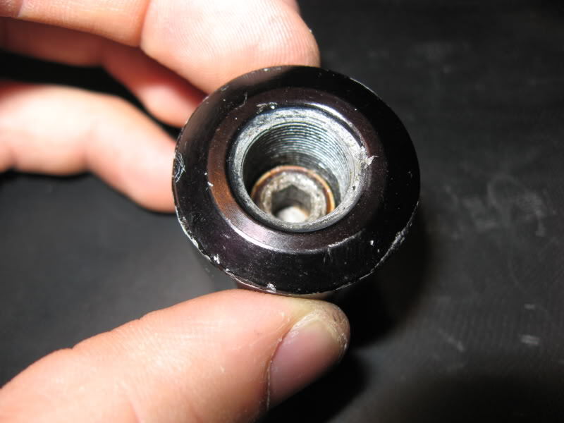

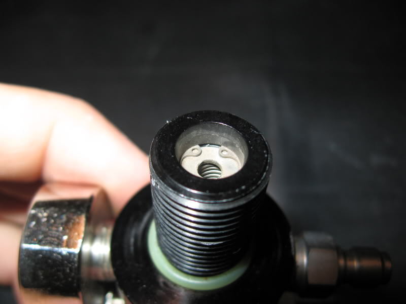

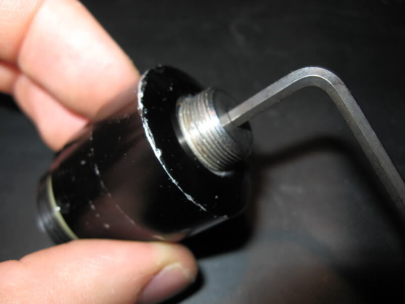

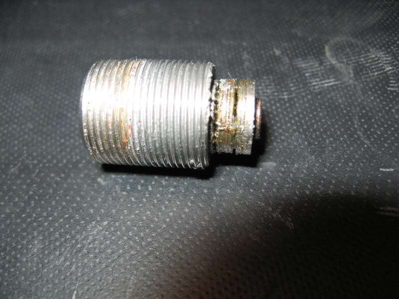

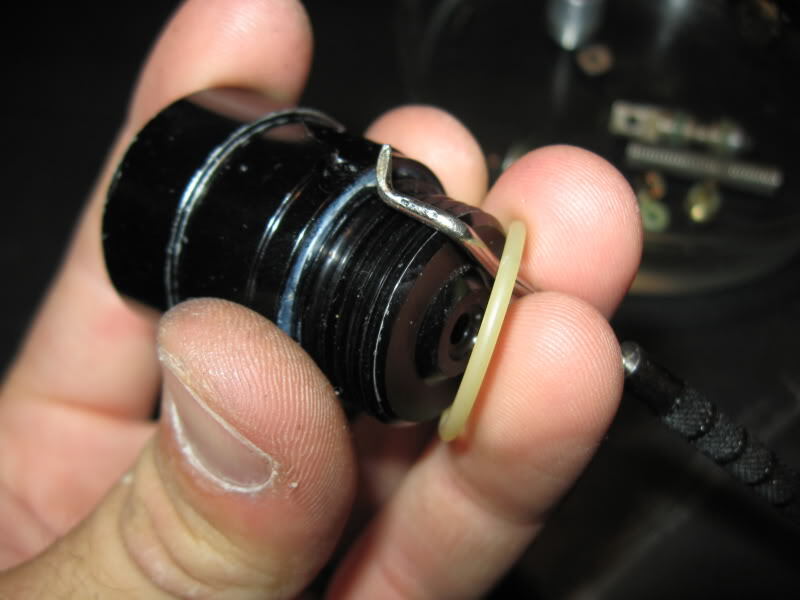

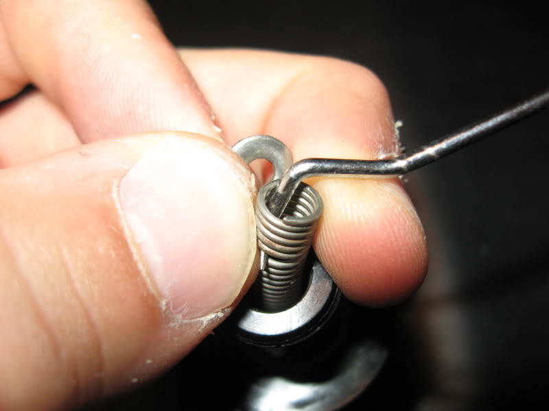

        5) Disassembling the tank portion: Turn the reg over and examine the portion that screws into the tank:
        Click image for larger version  Name:	IMG_0654.JPG Views:	0 Size:	32.2 KB ID:	1131
        Remove the C­clip by using a C­clip tool or being VERY carful and using for dental tools...
        Click image for larger version  Name:	IMG_0659.JPG Views:	0 Size:	28.5 KB ID:	1132
        Once the c­clip is loose, remove it.
        Click image for larger version  Name:	IMG_0662.JPG Views:	0 Size:	34.8 KB ID:	1133

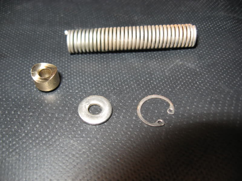

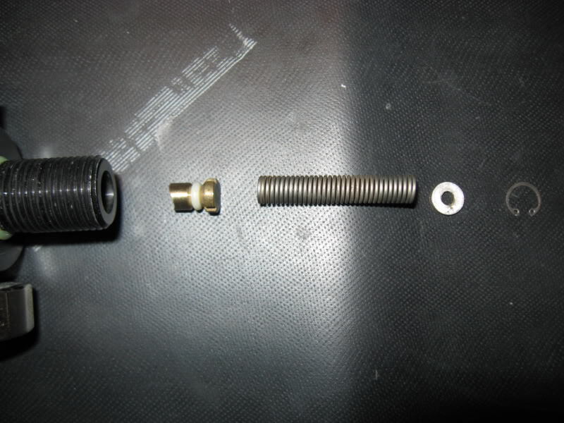

        Pull out the spacer and reg spring:
        Click image for larger version  Name:	IMG_0660.JPG Views:	0 Size:	32.0 KB ID:	1134
        Click image for larger version  Name:	IMG_0663.JPG Views:	0 Size:	35.6 KB ID:	1135
        • CaptainNeeda
          • 39
          And inspect what you have pulled out for that area thus far...
          Click image for larger version  Name:	IMG_0664.JPG Views:	0 Size:	68.9 KB ID:	1148

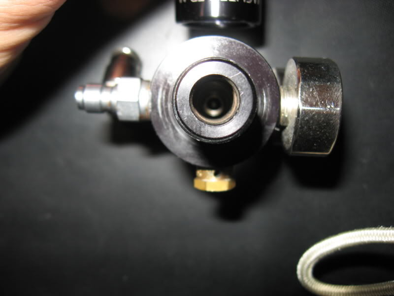

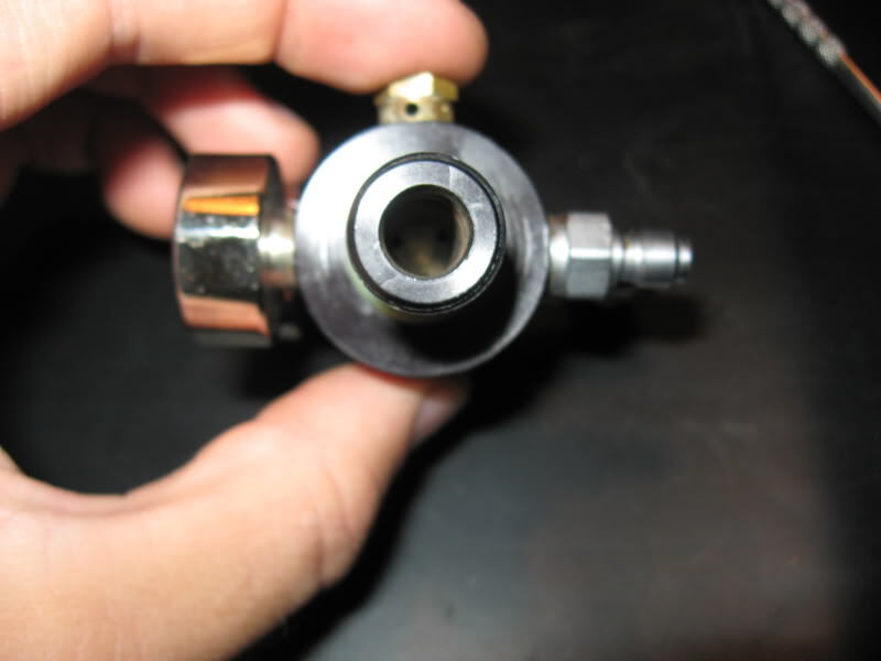

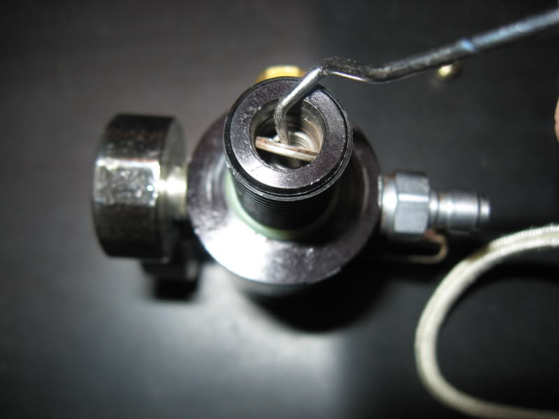

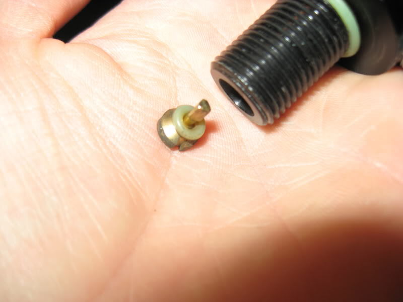

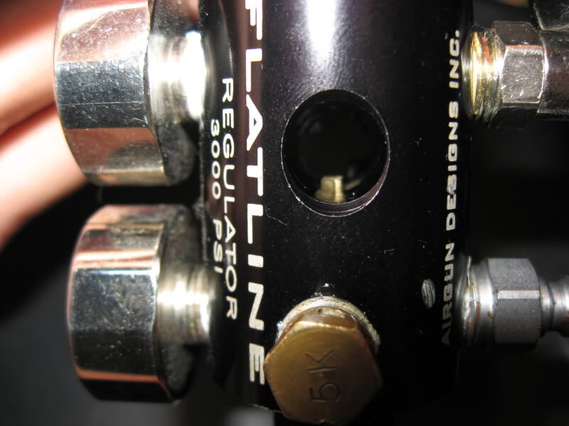

          Next take a look down the reg and look for the on/ off valve.
          Click image for larger version  Name:	IMG_0665.JPG Views:	0 Size:	28.8 KB ID:	1149
          (sorry bad pic)
          Click image for larger version  Name:	IMG_0670.JPG Views:	0 Size:	51.1 KB ID:	1150

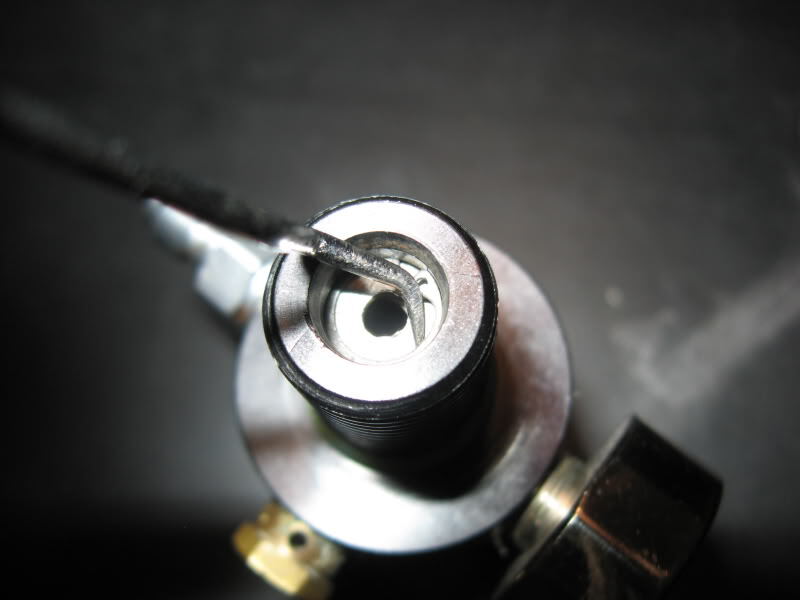

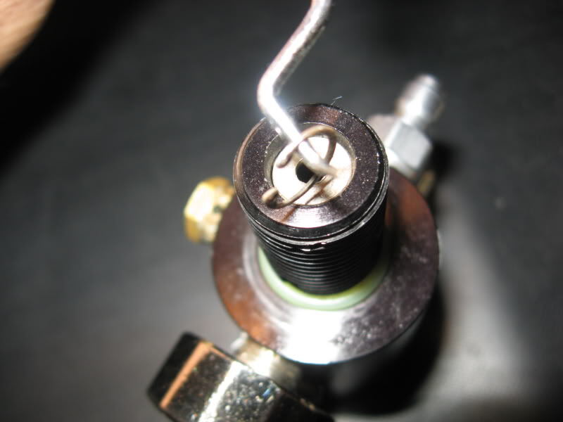

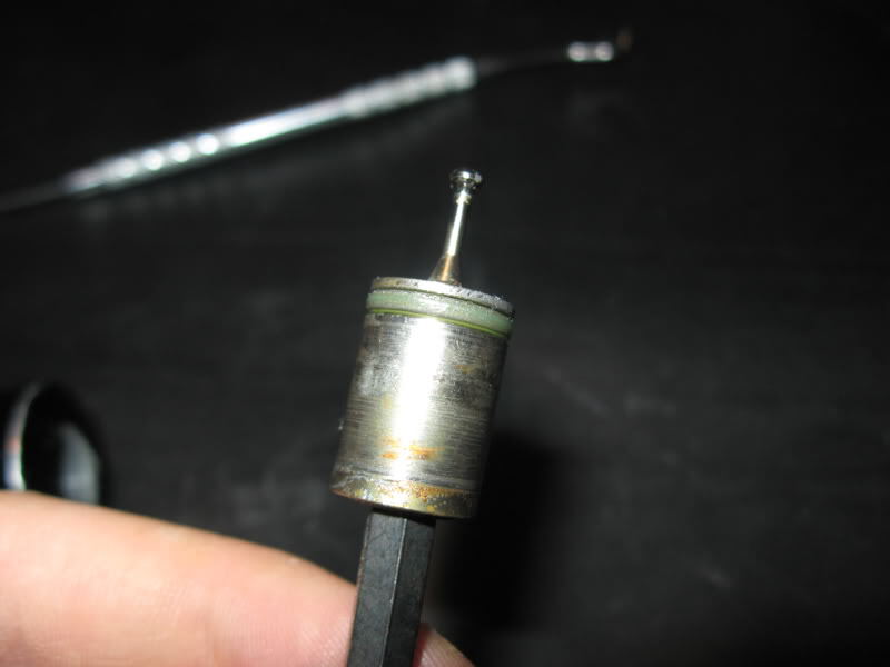

          Using your dental tool again, push down on that valve and give the reg a few whacks against your palm to remove the
          it.
          Click image for larger version  Name:	IMG_0671.JPG Views:	0 Size:	34.8 KB ID:	1151
          Click image for larger version  Name:	IMG_0673.JPG Views:	0 Size:	65.8 KB ID:	1152

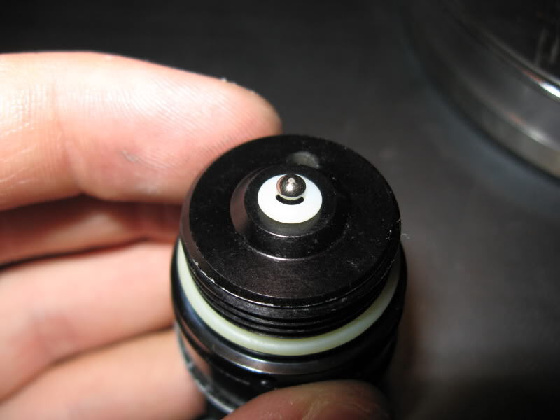

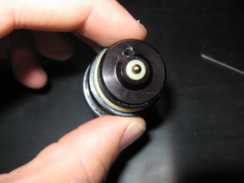

            Sweet! We are now cooking with gas! Take one last look down the reg, if you see the ball bearing, you are in good
            shape!
            Click image for larger version  Name:	IMG_0676.JPG Views:	0 Size:	33.5 KB ID:	1169

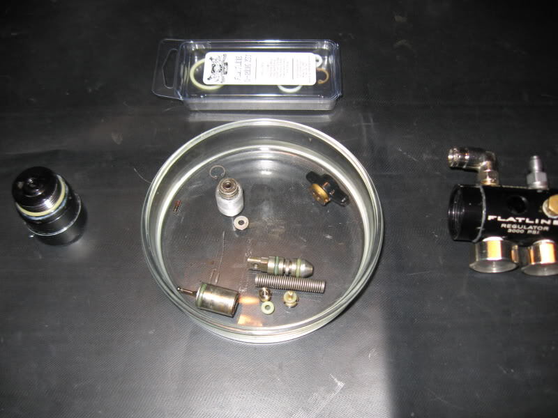

            6) The pressure regulator: Set all of those parts you were just working with aside and grab the pressure regulator
            from earlier. And pop that tiny o ring on the top off.
            Click image for larger version  Name:	IMG_0677.JPG Views:	0 Size:	36.4 KB ID:	1170
            Next back out the pressure adjustment all the way (just like on a mag).
            Click image for larger version  Name:	IMG_0678.JPG Views:	0 Size:	28.3 KB ID:	1171
            Haha, if you have been through a mag before, this should look familiar. Note: Be careful with the spring pack in there.
            It is packed with grease that NEEDS to stay on there!
            Click image for larger version  Name:	IMG_0679.JPG Views:	0 Size:	60.3 KB ID:	1172

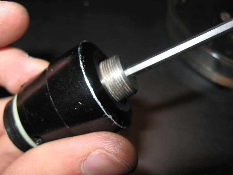

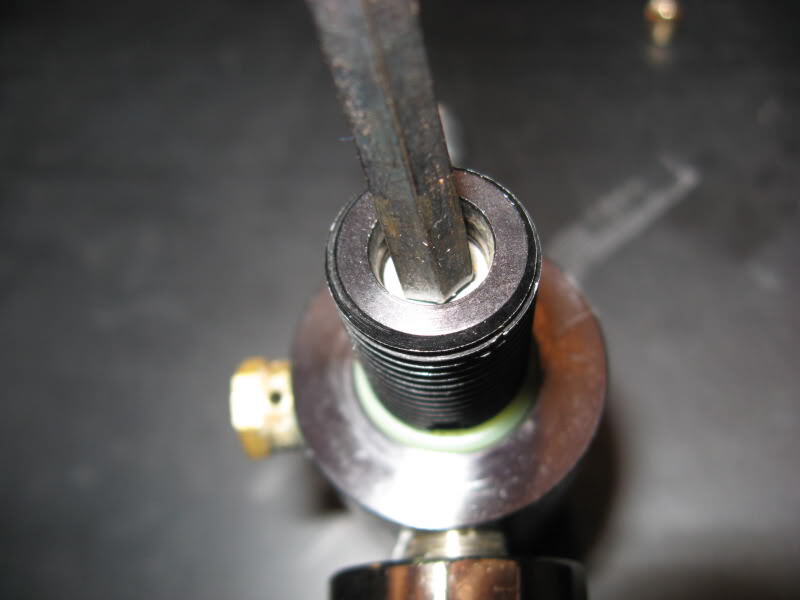

            Now look down the pressure regulator and using your 7/32 allen, back the piston out of there.
            Click image for larger version  Name:	IMG_0680.JPG Views:	0 Size:	41.3 KB ID:	1173

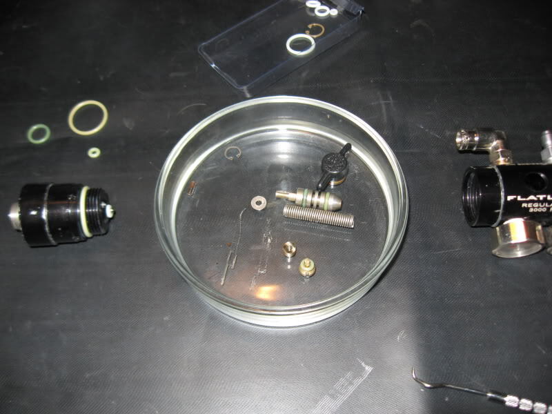

            And, now you have a disassembled reg!
            • CaptainNeeda
              • 39
              Click image for larger version  Name:	IMG_0681.JPG Views:	0 Size:	22.1 KB ID:	1180
              Click image for larger version  Name:	IMG_0682.JPG Views:	0 Size:	54.2 KB ID:	1181

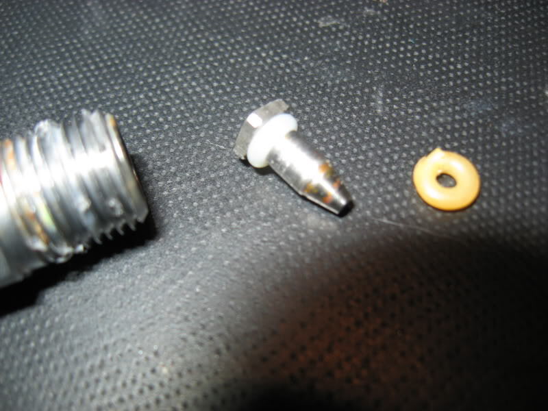

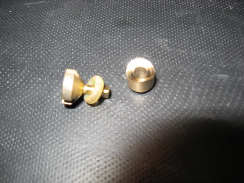

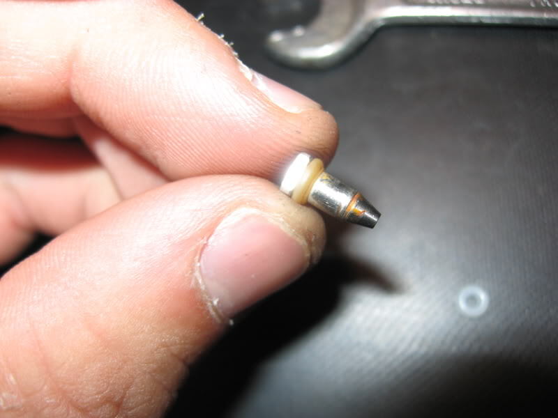

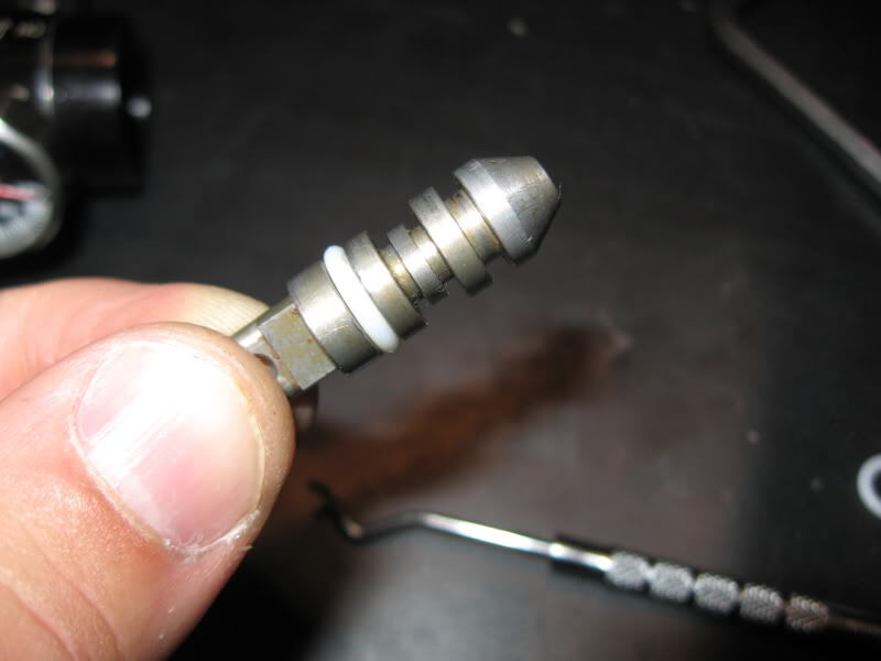

                8) Redoing the back portion: Slap a new o ring onto the on/off valve.
                Click image for larger version  Name:	IMG_0689.JPG Views:	0 Size:	29.0 KB ID:	1194
                Reassemble the rear tank portion.

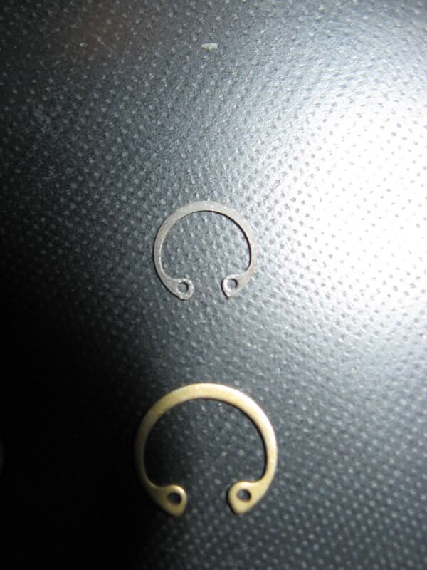

                  SIDE NOTE: For some reason, the c­clip in my kit DOES NOT FIT!!!! BE WARNED. The clip that came out of my reg is on the left, the one from the kit is on the right. I a going to call AGD about this tomorrow morning!

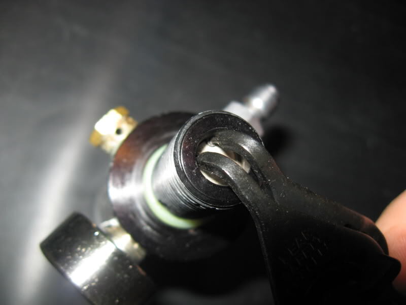

                  Push it all back in EXEPCT the spacer and c­clip. Put the valve, spring, and spacer in, in that order. Then seat the
                  whole thing with your wrench.

                  Next push in the c­clip and seat it with your c­clip tool or a dental tool

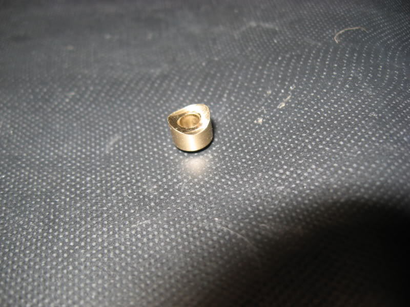

                    MAKE SURE THE CONCAVITY OF THE SPACER MATCHES THE
                    CONCAVITY OF THE ON/OFF WALL!
                    Then, using your dental tool, push it down so that the spacer is flush with the rest of the surface. If it does not go in flush, reassemble the on­-off switch FIRST.

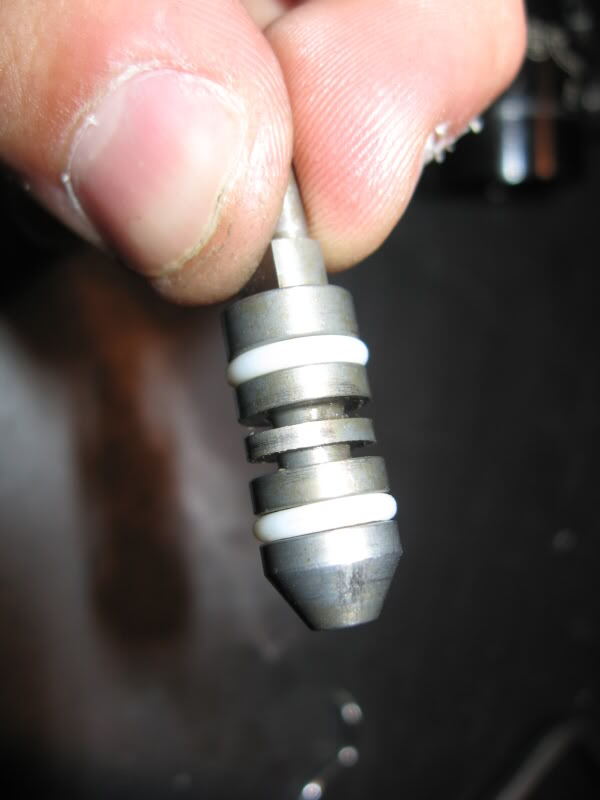

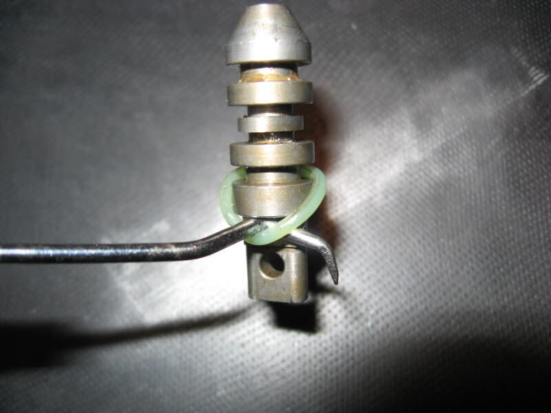

                    Next, get those old o rings off of the On/Off, and put the new ones on...

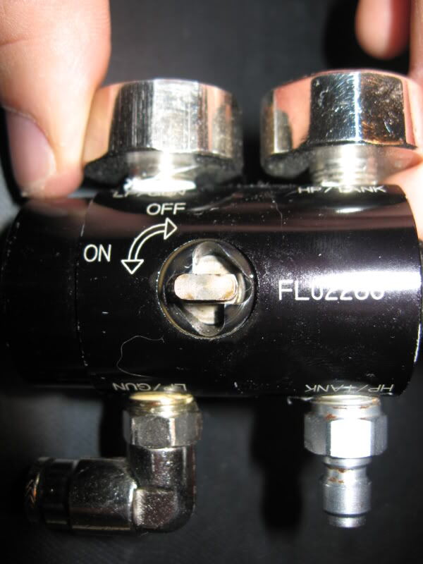

                      Then push the on/off back into the reg, ENSURING that the cam in the center of the on/off in vertical, or in the 'up
                      and down' position!

                        9) Fill Nipple and Check Valve... Using your 7/16 wrench, Take the fill nipple off.
                        Take out the check valve.
                        By any means necessary (knife in my case), remove the old o ring. Then slap the new one in. It should be the
                        smallest o ring in the pack.
                        Then, use some thread locker or teflon tape and screw the fill nipple and valve back in...
                        And one last picture of all the tools I used...
                        IMPORTANT NOTE: I used a small amount of of gold cup to clean crap out of my reg while I was disassembling it. I would ADVISE AGAINST using it unless you know what you are doing!!!!!!
                        For instance, if you accidentally used gold cup oil ANYWHERE near your fill nipple, you run the risk of
                        turning your reg and bottle into a diesel engine....
                        Think of it this way... OIL + HEAT + COMPRESSION + 0^2 = MASSIVE BOOM!
                        And no... the danger in not just localized to your fill nipple... if you don't know where it is safe to use. DO
                        NOT USE IT! Basically is you are forced to use it, only use it FORWARD of the on/off, and make sure to wipe up ANY excess...
                        And you have a new reg! Hope you guys enjoyed the read!
