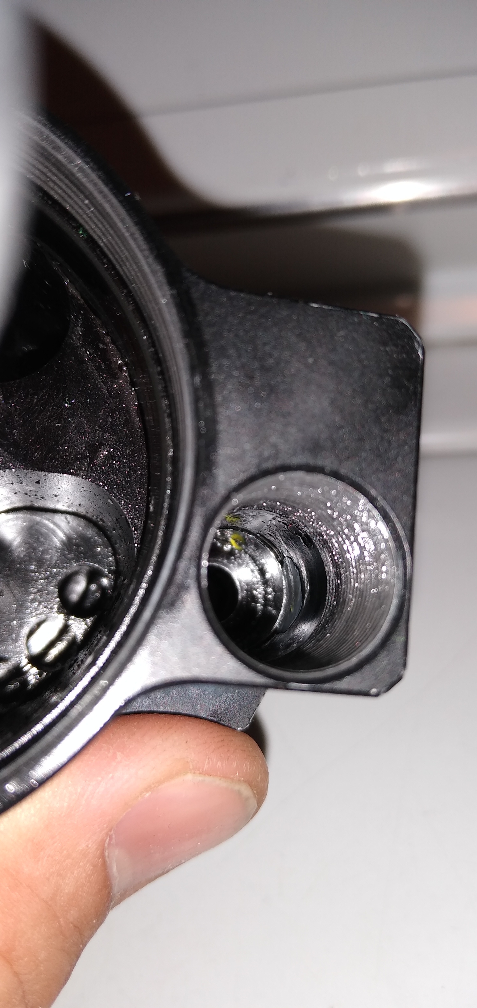

    Looking for help with a working/non-working launcher.
    running air there seems to be a leak in the trigger frame and the velocity adjuster screw.
    Fires one shot, then refuses to cycle/load the next air charge. This is the time it really likes to leak air. Pull the trigger a second time, you get some air and pft sounds but nothing through the breech.
    Could it be that the vaseline oil is to thick and humming up the works? Or the o-rings to soft on the velocity adjuster piston?

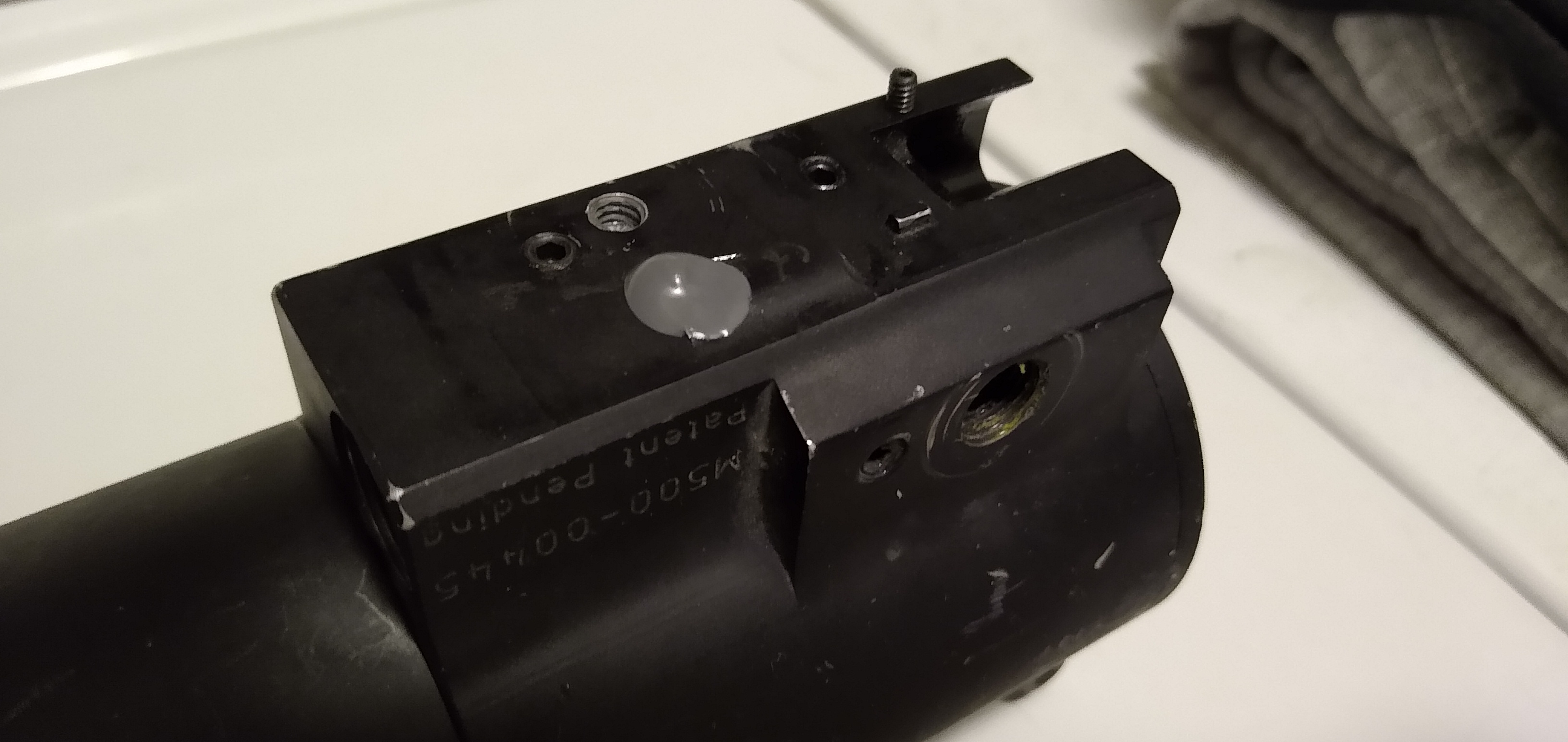

    *Has a patched hole in trigger frame area just behind piston/spring area of velocity adjuster regulator. And has a vent hole through the Allen key hole of the velocity adj screw.
    Any thoughts?
    Sorry I don't have pics yet

      Not a whole lot to these things, so shouldn't be too bad to fix assume something isn't totally borked. Pictures would be really helpful, is the "patched" area a threaded hole that was filled in?

        Perhaps someone 'fixed' a leak by jb-welding what is supposed to be a plug..

            Thank you all for the insights. It seems my problem was two fold.
            1)The JB welded pressure relief hole needed sanding down for the 012 o-ring on the regulator piston to function smoother.
            2) The 012 o-ring on the regulator piston was getting cut/marred by either a burr in the regulator housing when the piston moved or the JB welded hole intruding into the regulator housing too far.
            I will be swapping to 90 buna o-rings to see if they can hold up better.
            Again thank you all for the help.

              The person before me who owned the havoc patched in the hole. Im assuming that it was chopping o-rings frequently enough to warrent this. Also the patch before the JB weld was a leak point for the air in the regulator piston when it moved. So I ended up repatching the hole. I did drill a relief hole into the velocity screw to compensate should anything happen, this is done on the newer versions as well.

                UPDATE- So after more Issues with the havok not cycling properly, I dove back into the regulator piston problem.
                After a long debate with my-self, since I am not a machinist; I smoothed out the internal piston and body housing of the piston area.
                Since I was worried about doing irreversible damage to the main body, I only used Flitzs Metal polish and a lot of time and patience polishing both.
                I can say that, before I polished the internal piston area of the body and the piston; I found plenty of nicked areas and rough spots around the large o-ring on the piston and in the body in the same place the original relief hole was drilled.
                This was to the point where i kept finding a small chunked piece of o-ring on the larger side of the piston; and moving the piston back and forth by hand felt rough, forced, and like i was hitting something past a certain point each time.
                After a few days polishing everything and using 3000 grit on a few spots on the piston that I could get my finger nail stuck into; the movement is smoother and more gliding than before.
                Now it cycles properly and I get more than one shot.
                I will keep an eye on it but thought I should update being someone else may have the same issue in the future.
