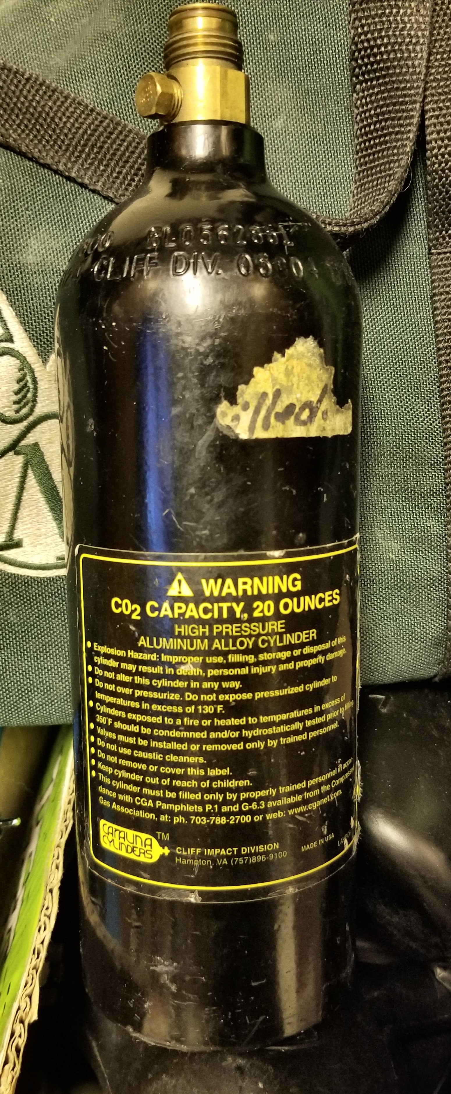

          I started digging through the pile of expired Co2 tanks in my basement and quickly found a good valve and slapped this together....almost too easily. I might disassemble it and fill the hardline with smaller tubing as Chappy recommended if I'm not happy with the efficiency I'm getting, but this should get me up and running for now.
          1/4" OD copper tubing with a 1/4"C X 1/8 NPT fitting incase anyone wants to know.
