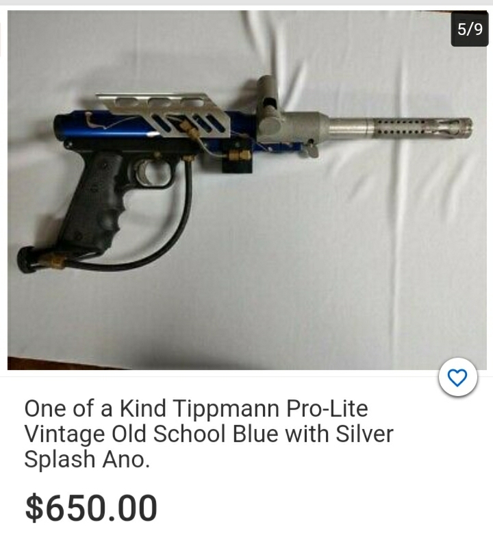

          • Myrkul
            Myrkul commented
            I shall completely shift all blame for this on to this guy: https://www.ebay.com/itm/23394728461...IAAOSwsspgYjc0
            It just looks SO good. Not about to cough up that kind of money for Ben's old gun though. Now if that was Dennis's old Pro-Lite....
          MCB member
          • 3511
          • Montreal, Qc, Canada
          This is not a Pro-lite... its a 68 Carbine
          Pro-lite have air trough grip frame and the trigger guard is an air line
          Expensive but nice marker
          And funny powerfeed conversion piece
          • Myrkul
            Myrkul commented
            You could be right....I can confirm that Pro-Lite's can accept carbine grip frames no problem, so they might have just been swapped out. Additionally the VASA looks more like a Mini-Lite then a Carbine's. Honestly only way to tell for sure is to check under that sight rail. Carbines had a plastic sight that retained the linkage arm, Pro-Lite's had an aluminum one. Pro-Lite's had a cut out on the right side of the body exposing the valve, carbines do NOT and I don't see the cut out on the right side (could just be picture quality though), despite seeing plumbing being run into there. Obviously whatever this is has been extensively modified and has that old school cool factor. The seller has confirmed that he has been in contact with Ben who remembers making it, so I doubt he forgot what gun it was....
            Edit: Name Plate. Carbines had the name right on the body. Pro-Lites had a name plate. You can see the plate under the sight rail.

          • Chappy
            Chappy commented
            That is definitely a .45 framed prolite/ mini lite
