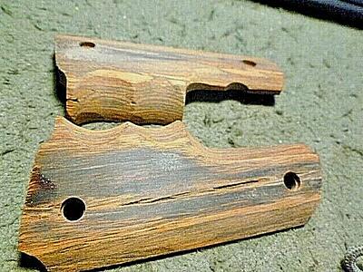

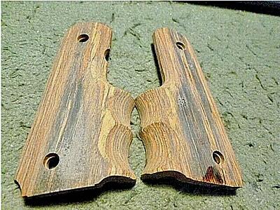

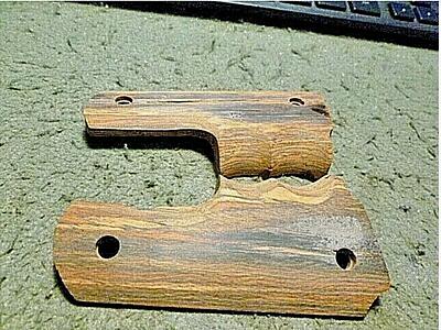

    I picked up these unfinished rosewood .45 wraps for my mac-1 build. Figured they would make beaufiful grips for a brass with a little work.
    Than as always, I started to research "the best way to finish rosewood" and went into a tail spin of answers via various forums. Then I changed my search to "finishing rosewood grips" and got a pleothra of different opinions.
    Now Im not really sure what to do. So Im asking the great brains of MCB, how would you suggest finishing these babies?
    First, not that Id want to, but it sounds like staining isnt an option thanks to the naturally occuring oils. Though I wouldnt mind something to accent the reds a little more.

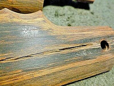

    Im figuring I'll wanna fill the crack just to strengthen them up a bit. I was hoping to get away with a clear epoxy in there to make it catch light but im open to suggestions. Id even leave it for the texture

        I'd fill the crack with epoxy, but you can mix it with a dye. I would not epoxy the whole grip, you lose the wood feel.

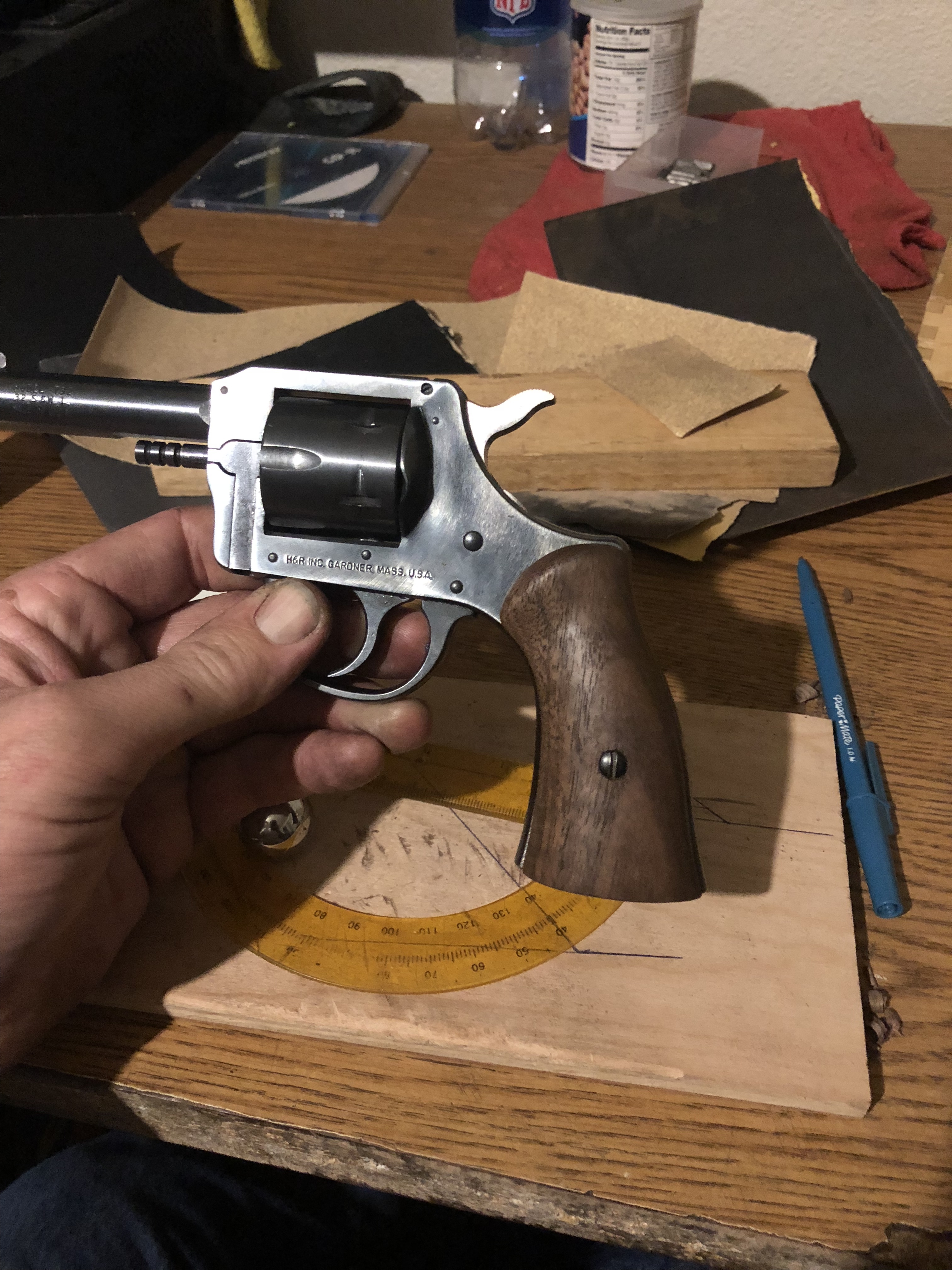

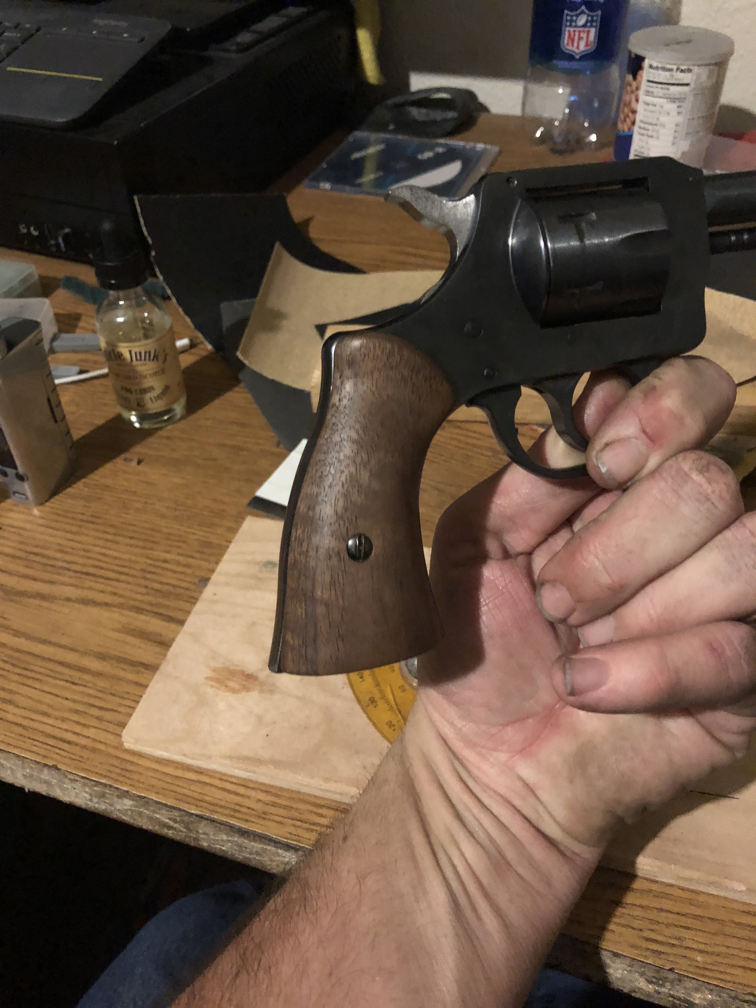

          I always use tung oil and mineral spirits for the first couple applications to penetrate and prevent further drying. Then pure tung oil for the last, really burnish it in so the oil polymerizes. Here’s a set of grips I made from walnut for my dads revolver. Did those a couple years ago, tung oil finish and still look and feel good.
