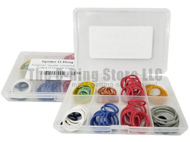

        This looks interesting...
        [LINK]
        OSK™ O-Ring Kit for Kingman Spyder Universal Color-Select Kit Includes:
        • 5pc -009 Tan
        • 10pc -010 Purple
        • 10pc -011 Pink
        • 5pc -012 Green
        • 10pc -014 Blue
        • 25pc -015 Red
        • 5pc -016 White
        • 5pc -017 Orange
        • 5pc -018 Yellow
        • 5pc -019 Gray
        These guys have a similar kit, but in a baggie

          I was looking at those the other day. I've got a big kit of plain black o-rings, but I'll pick up one of these when I deplete it. I still don't know what the original red o-rings in a spyder are, but advice in this forum suggests they were junk anyway. I'll probably go with urethane
