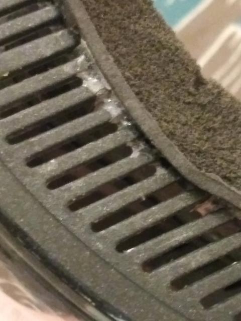

      I haven't tried to remove it yet and I probably could have done a little better job of it. But, I'm good with the result of this stuff, for a backup/loaner mask.

        The epoxy should be fine for the foam to plastic. Shouldn't have issues taking foam off in future, no different than superglue or other glues anyways.
        I just had to glue the soft foam back to the firmer foam on several masks and for that, I used 3M High Strength 90 spray adhesive. It doesn't soak into the foam as much as regular glue would.
