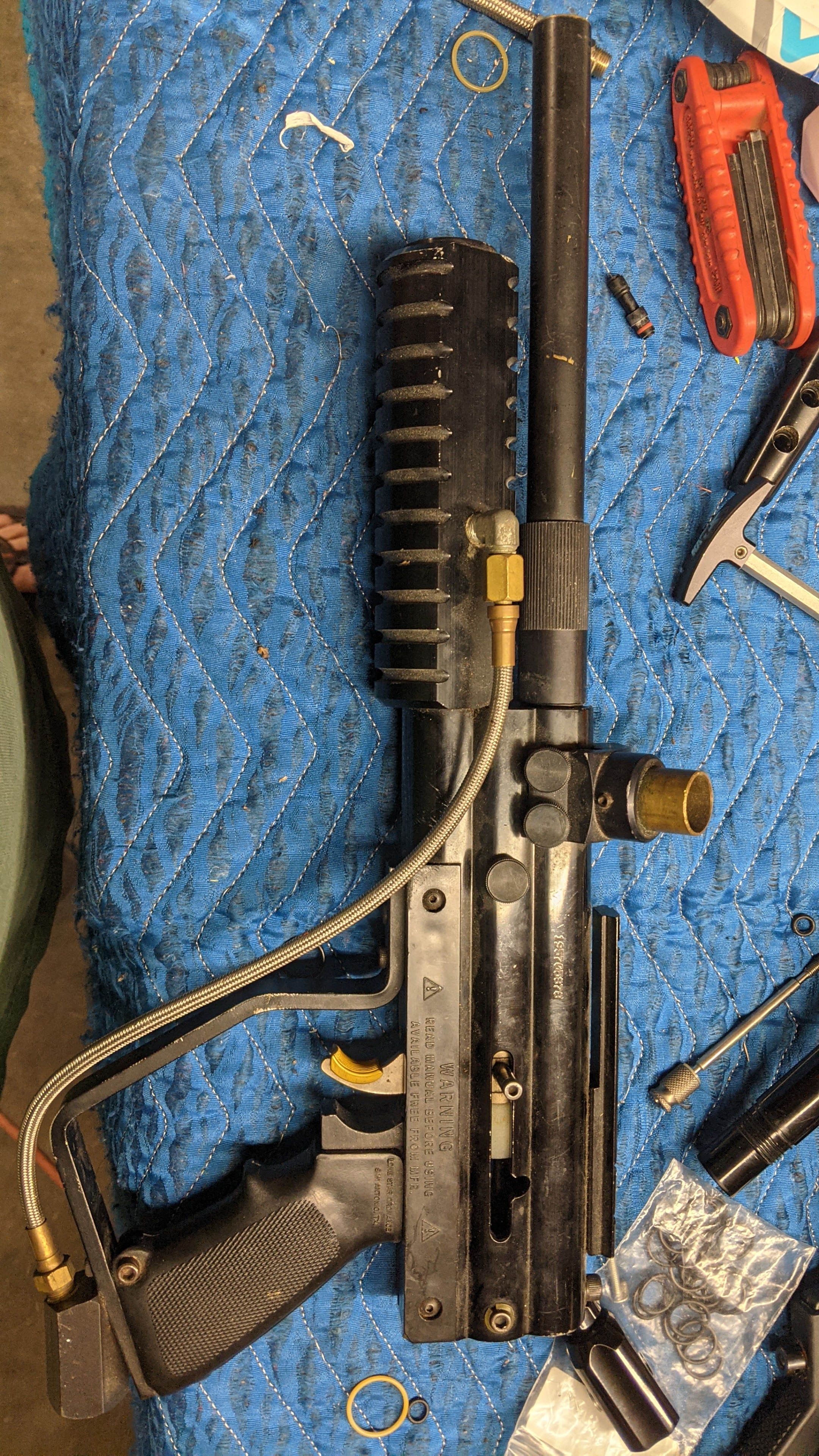

    I currently have a couple of paintball guns and think i can gain access to more from you nice people. With that in mind i currently run a T2 marker for my pump paintball gun. My friend has used my gun once or twice and likes the limited amount of paint that it uses versus his electro Axe if that matters. He would like to get a pump paintball marker i am thinking of building one for him. I have a trilogy body, a couple piranhas 1 electro trigger and 1 mech, a ICD puma or 2, maybe a sheridian (see pic below), an X valve automag, a 2K+ autococker body and a pre 2k body. There is even a pump ion that i saw on BST.

        my personal favorite is a sheridan. With a 45 frame especially. The pump stroke is a bit harder, and it is 2 staged so you have a free stroke where you are only moving the bolt. Then you engage the hammer mid stroke causing a change in tension as you load the hammer. Its not for everyone. But imo sheridans point extremely well, its one of the few markers I can get good first shot accuracy at long range.
