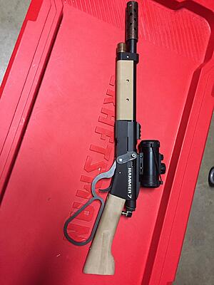

                  Magfed has really taken off, and people have learned that they can very easily modify Hammer 7s into various rifle stocks. One of my favorite YouTubers is Hidden Hedgehog. He fitted his into a Mauser stock, and has a mechanism that allows him to recock it by pulling back at the rear of the marker. It's pretty cool.
                  Layer Lab has come up with a lever-action system for it. With the .50 cal revolver options we have now, you can go full wild west on the field. People are doing awesome things with these.
                  But, that's driven up the cost substantially, and increased their scarcity. A few years ago, they were $60 all day. Now they're closer to $150-180, if you can find one.
