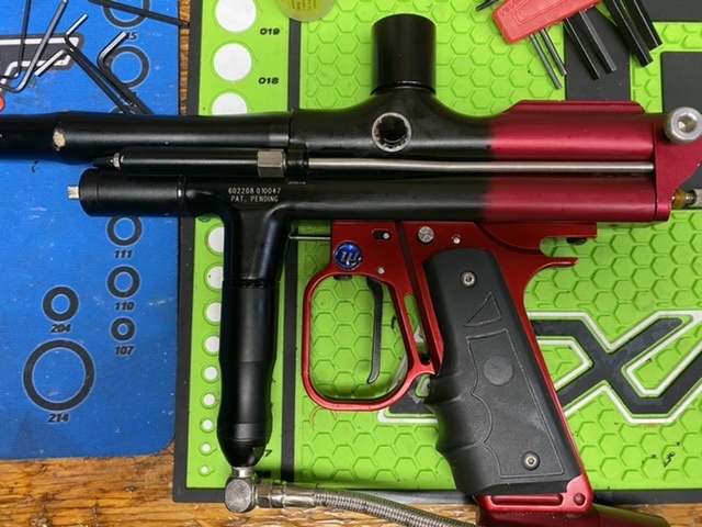

    Picked up a Trilogy Competition that has a standard WGP Autococker trigger frame (as opposed to a Trilogy frame) and having issues with timing. I’ll eat played with adjusting the hammer, but can’t see to get it to recock after firing.
    Could this be a cocking rod issue? It needs adjusting? Any advice would be appreciated.

      It could be the cocking rod but it's very unlikely. More likely is you LPR is too low or your lug isn't low enough. Could also be that the sear or lug is worn, or that the sear spring is too light.

          WGP frames drop right onto Trilogies without adjustments needed, so likely something's been fiddled with.
          Hammer lug is certainly possible. WGP swing frame is also very adjustable, so it may just have the trigger limiter set too short. LPR possible.

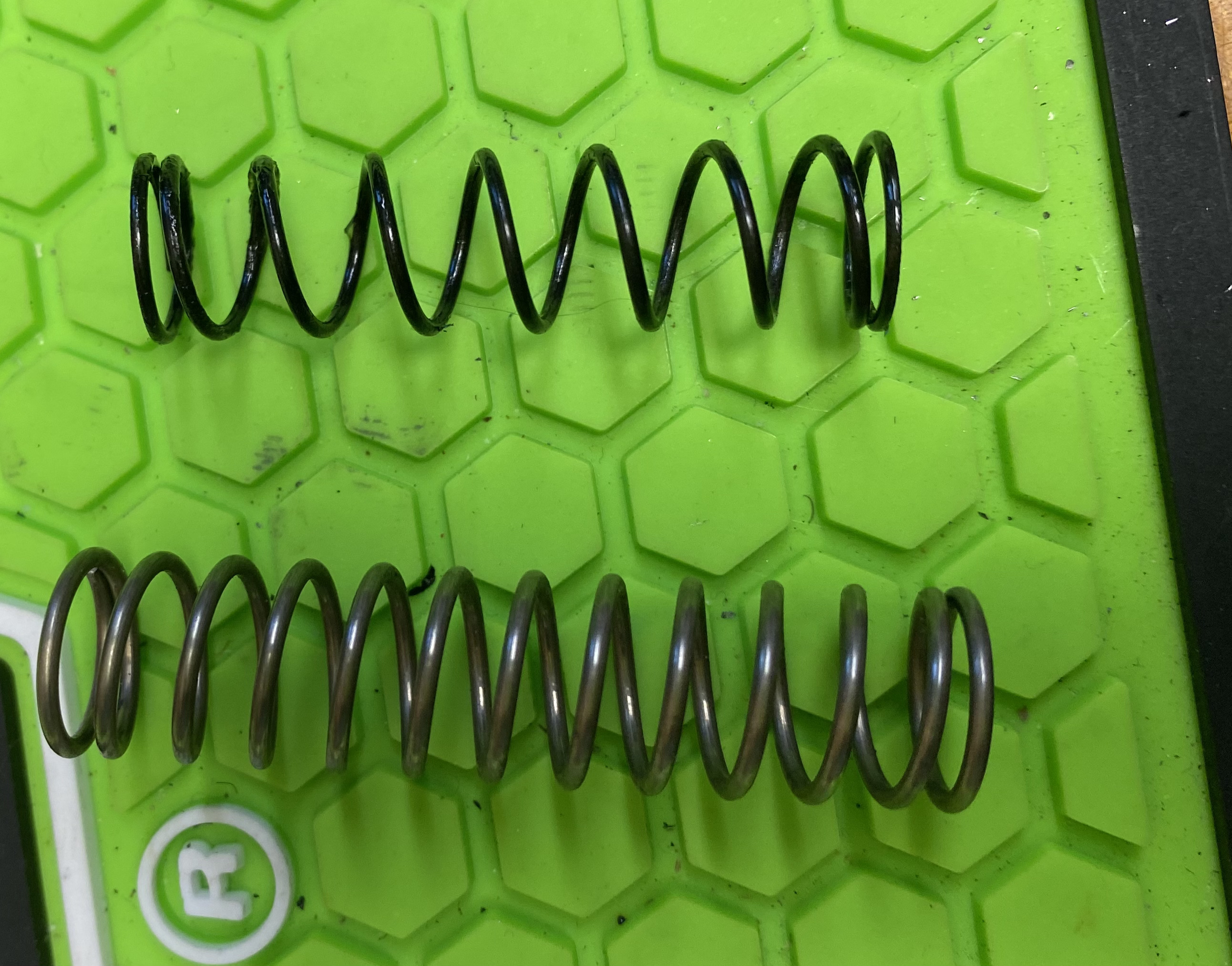

                  Looks to be a spring issue. The main spring is the wrong spring, so it barely even touches the IVG unless it’s bottomed out. I’ve got a pile o’cocker main springs thankfully.

                    I'm 90% positive that top one is the stock spring. Trilogy springs are usually that thinner gauge stuff. Even if that doesn't fix the issue, and I'm not convinced it will, swapping it out is a good idea as they wear out really fast.
