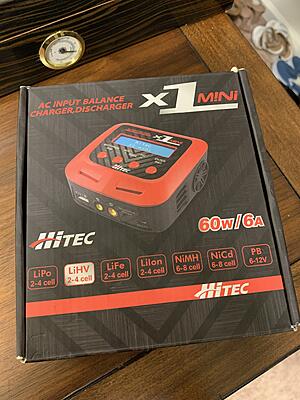

          A charger like this would be more than capable of charging a quality 1s battery in 20 minutes…..again given it’s a quality battery.

            I don't really care about the time it takes to charge, but definitely don't want to cause a fire by over charging.
            So let's say I get a single charger to do one battery at a time, is it possible to still overcharge? Is that dependant on the battery or the charger?
            • VonBraun63
              VonBraun63 commented
              The possibility is greatly reduced if charging one battery at a time. As posted a few times above the charger has to be able to properly charge lipo batteries. Any lipo charger worth its salt will be able to detect a couple key things in the battery
              - when it’s completed charging
              - internal temperature of battery when charging
              - internal resistance of battery
              - improper polarity
              With that said I would recommend going to any of the big RC/Drone websites and buying a name brand usb 1s charger and a lipo charge bag.
