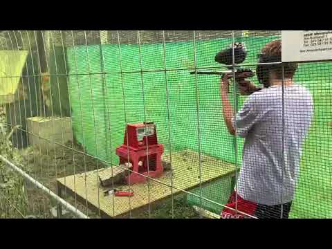

              rotor hands down is the way to go. I have several videos on youtube showing they keep up just fine.
