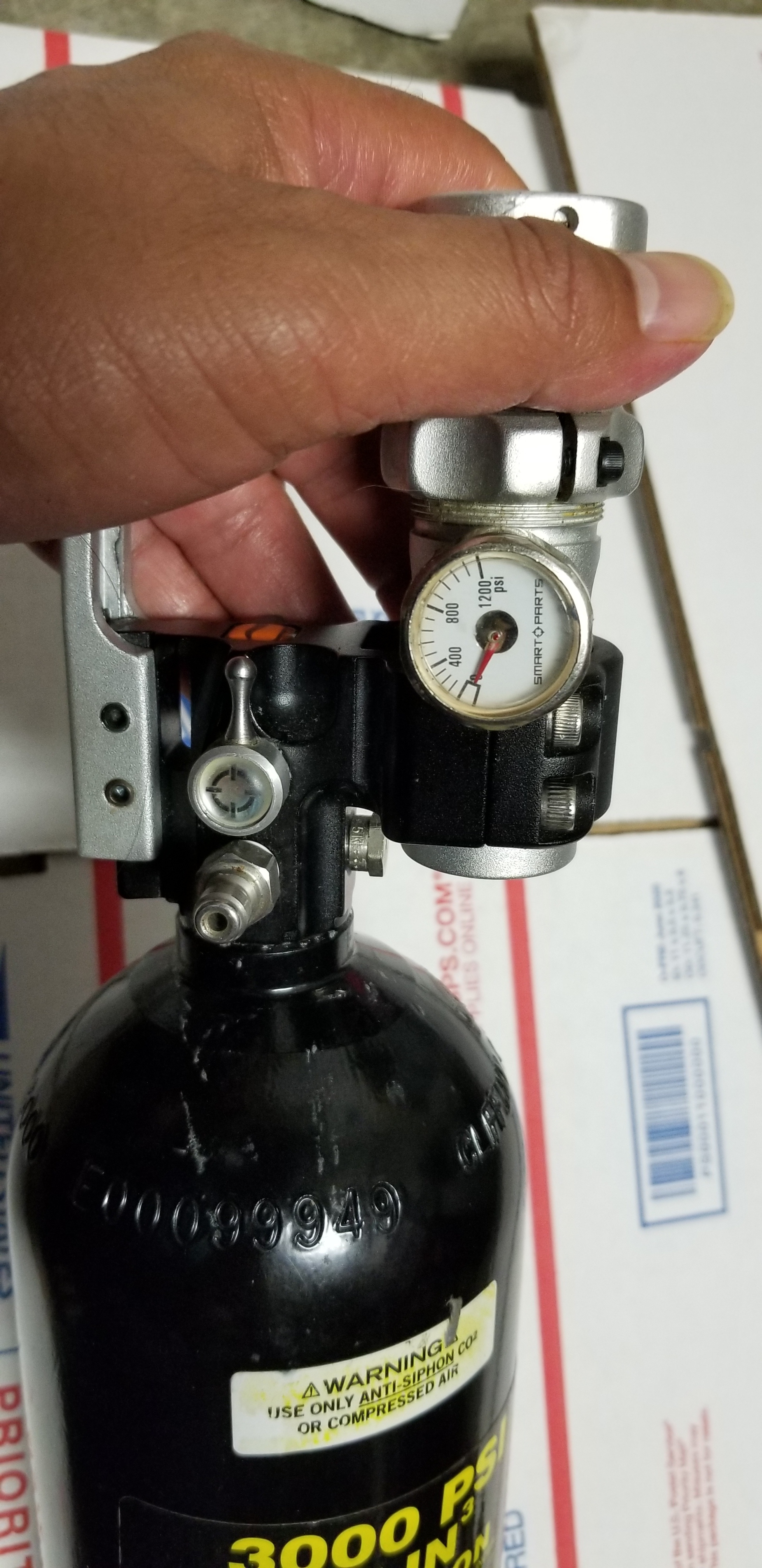

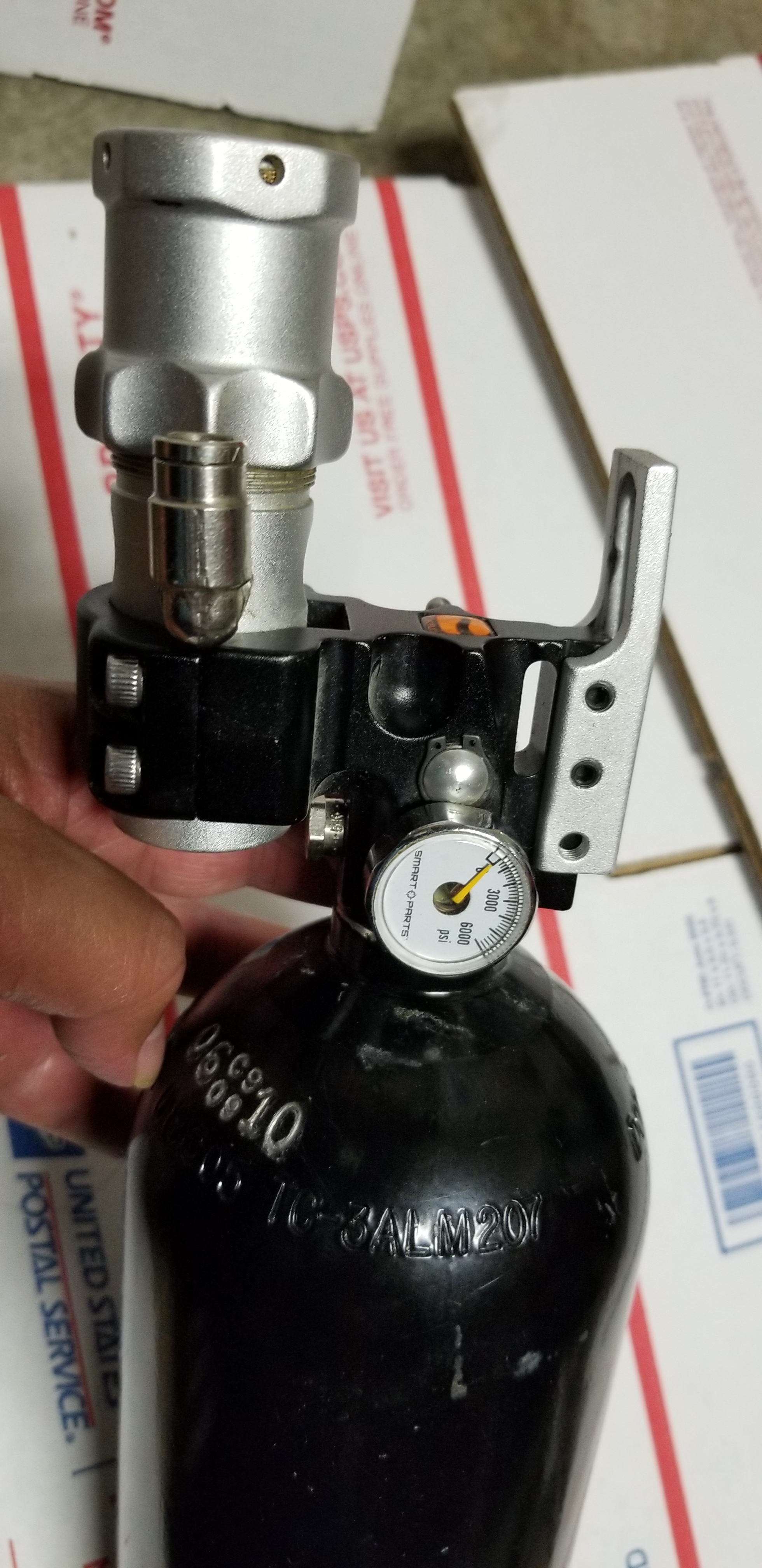

    Wanting to get the tank hydro tested, thought that it be easier for the shop if I remove the regulator and dont want it damaged. Maybe I will go with a different regulator.
    This is when having a table mount vice would be useful to use with the strap wrench. I cannot get this reg to budge from the tank.
    Anyone have any other ideas how to remove the reg.
