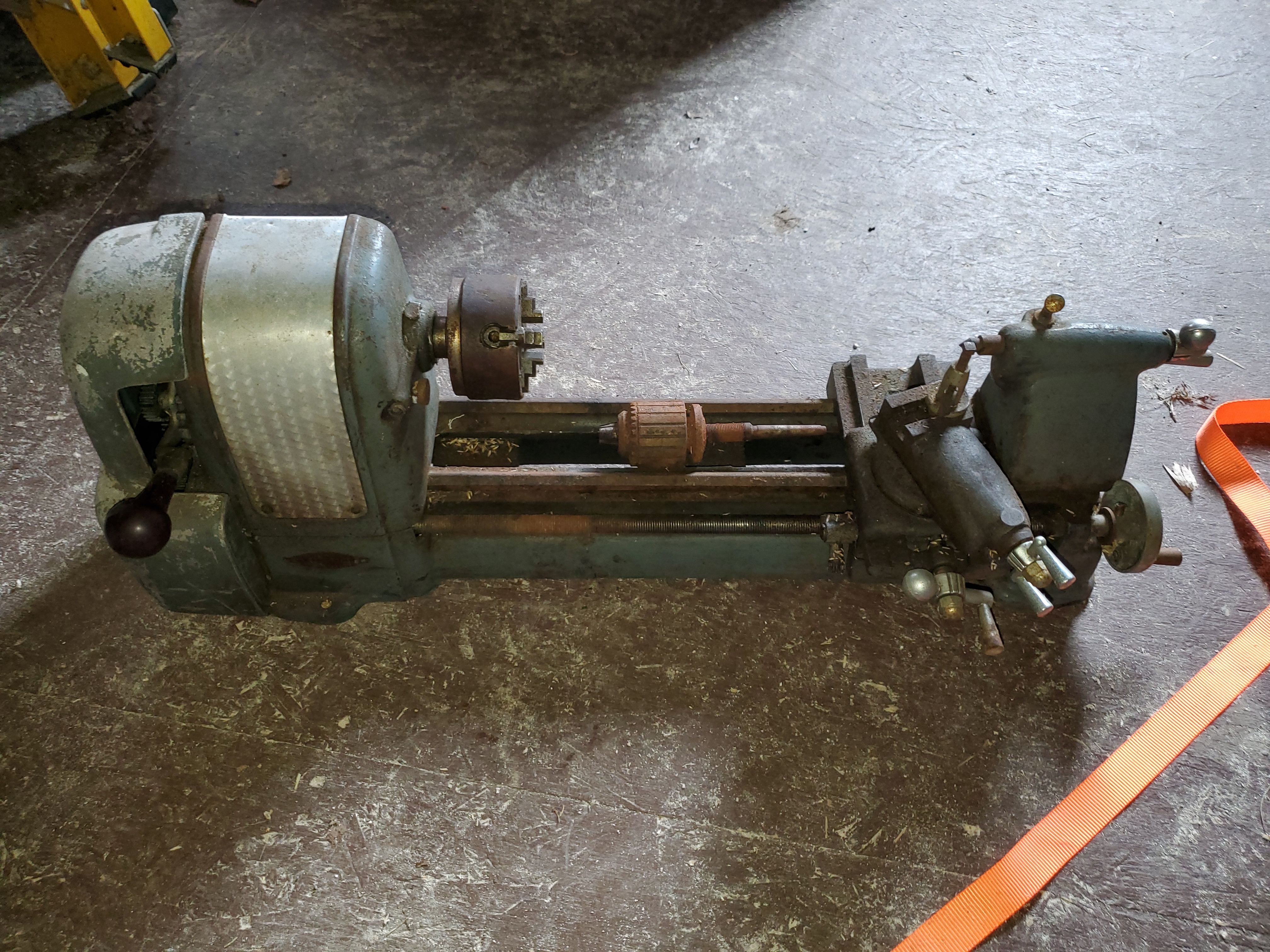

    curious what your thoughts are of this. 1940/50s vintage Craftsman 109.21270 Mini lathe.
    Everything seems to be free and moving. Ways need attention as they are rusted.not horribly. It sat in a garage for many many years. I do have a couple motors I could use. But not the original.
    Obviously part size is limited with it. Not sure about the max size it will hold.
    Is it worth restoring? Or atleast getting running.
