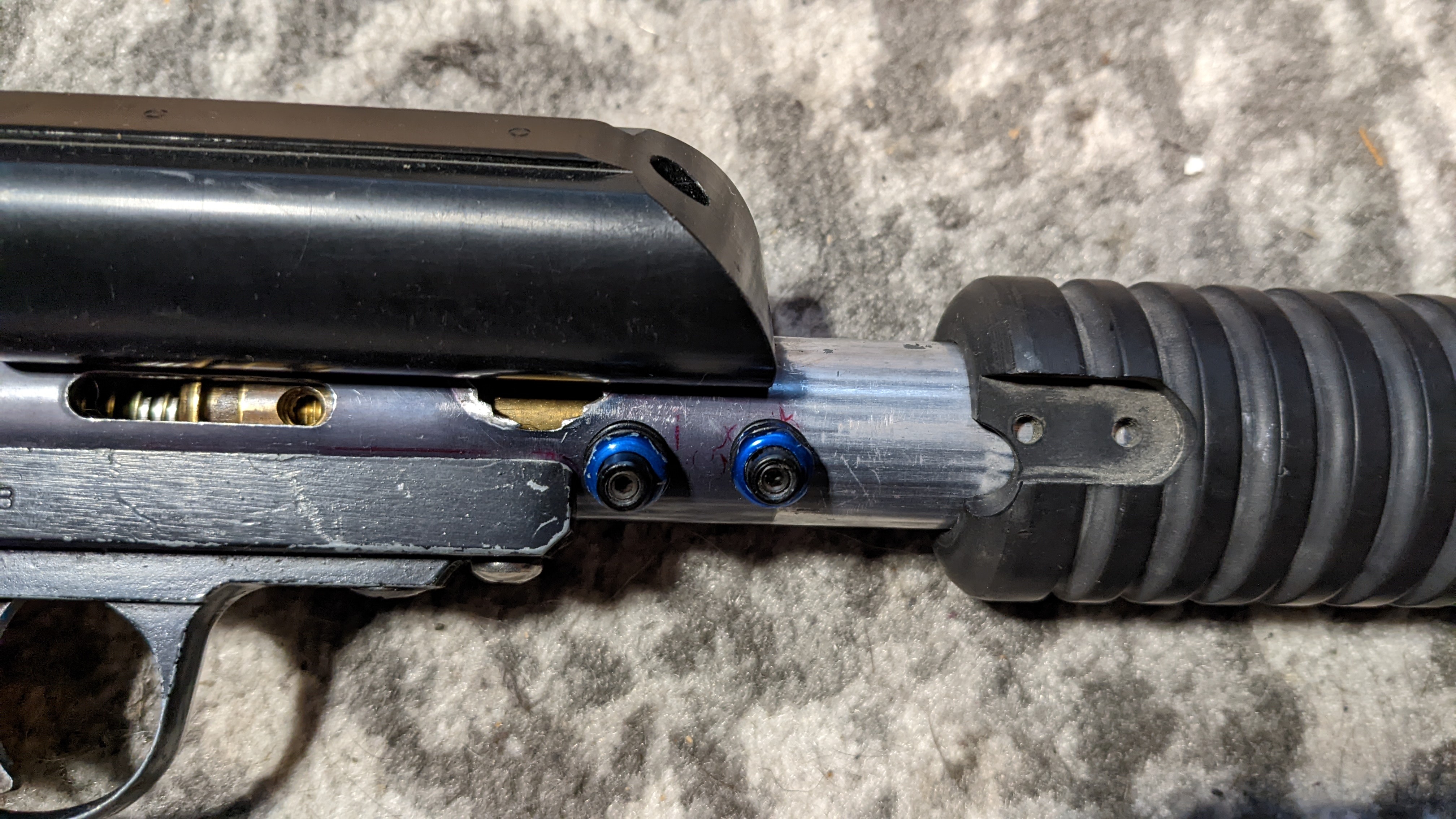

                Also, i did this to my bushmaster to prevent rollout:

                  I've done nail polish detents in Freak inserts - they worked - so I'm sure wedgits would too, just a matter of figuring out how to avoid destroying the insert.
                  XEMON commented
                  I was thinking about making an insert (machined or 3d printed) to "hold" the insert and preventing it from collapsing ...

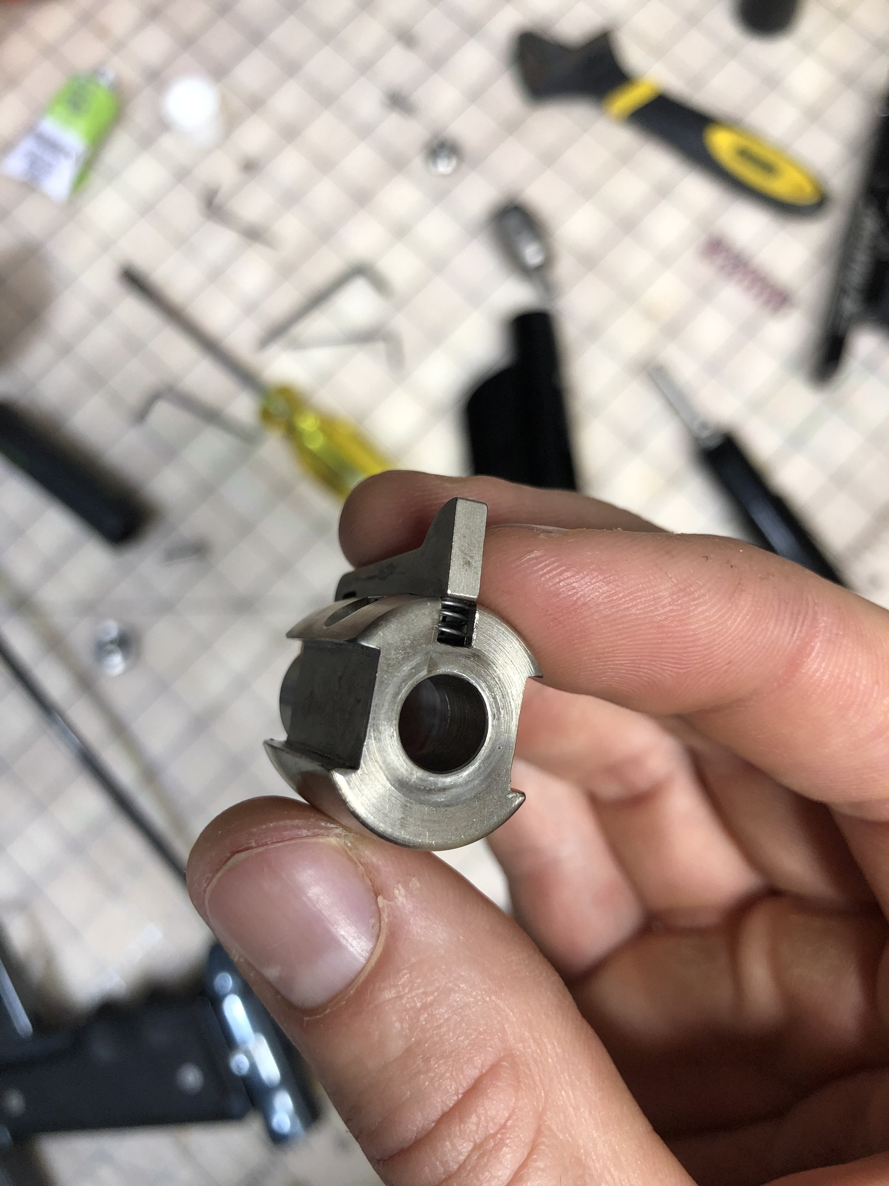

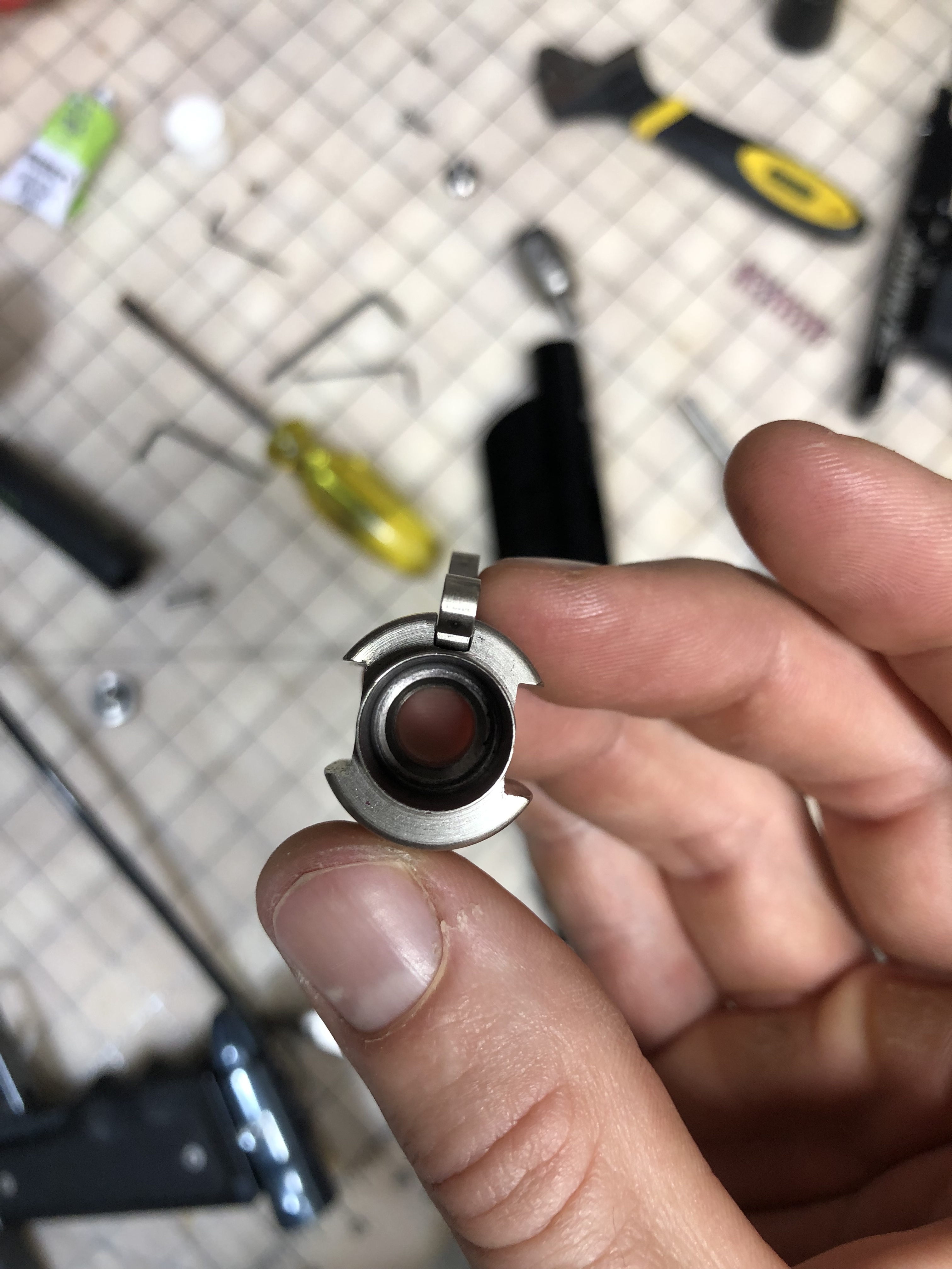

                          #360
                          DocsMachine
                          Any idea why this phantom I just bought has a milled hammer? If it's an upgrade mod, how can I utilize the lighter hammer best?
                          Thanks!
                          I already read the manual, the stickies, and all related posts.
