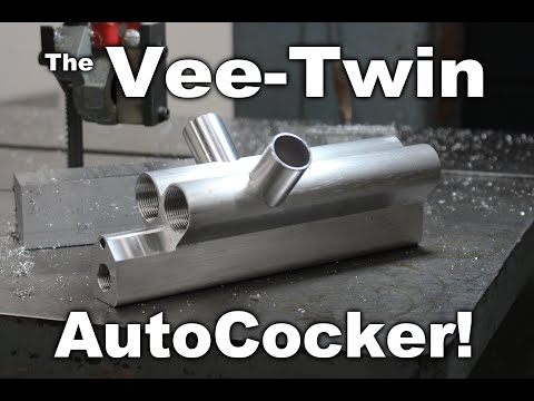

                  [/As a machinist, how often do you do an operation by hand?
                  I don't mean break the corner with a file on the lathe, I mean, clamp the part in a vice and file/cut something by hand (like squaring a hole ...)
                  -Pretty much constantly?
                  I'm an old-fashioned machinist, both in how I learned/was trained, and in the equipment I have. Save for the feed necks, which I made on my new-to-me CNC lathe, every bit of those Vee-Twin bodies has been done on manual machines. The only "automated" part is the power feed on the X axis. Hundreds of manual tool changes, thousands of turns of the cranks, constantly keeping track of dimensions and spacing and sizes, trying to work out the order of operations 'on the fly'...
                  In the first Vee-Twin video...
                  You see pretty much exactly how I make a part. That's not staged or mocked up- I was recording the actual work. As I said, the only "automatic" action was the power feed for the table- everything else was 100% manual and pure brainpower.
                  Doc.
