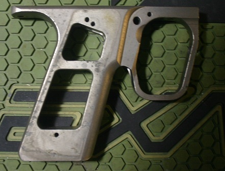

    Hiya Doc,
    What causes this type of damage to nickel(?) finish? Is it recoverable, or does the finish need to be removed somehow?
    Looks worse in person, and it was every nickel finished piece on the gun.
    Walker
    (sorry for the poor pix. My camera skills are ok, it's the lighting that gets me)

      It's just tarnish. Nickel is mostly resistant to oxidation, but not not entirely. Ever heard the old term "triple chrome"? That meant the platers put three layers on a part: a layer of copper, which 'fills in' slight scratches and tiny pits, the layer of nickel which gives the bright silver color and the main protection to the part, and then a layer of chromium, which gives the part it's brilliance, as well as "sealing" the nickel from oxidation.
      It's basically like painting a car- the copper is the primer, the nickel is the color coat, and the chromium is the 'clear coat'.
      In most cases, nickel by itself is suitably durable even for all-weather use. IE, Palmer's Typhoons and the like.
      But, in some cases- and in my experience especially over aluminum- if not applied well, and not cared for properly (stored in high humidity, paint or other gunks left on it for protracted periods, etc.) it can easily tarnish.
      It's also possible that the nickel was applied much too thin (poor plater or just as an attempt to save money) and the aluminum is tarnishing under the nickel.
      The only restoration is maybe trying some metal polish. Flitz or Brasso or Mother's, etc. Scrub a small spot and see if you can buff off the tarnish- if you're careful, you might try light power tools, like those little felt polishing discs and cones that come with Dremels.
      If you're just making the tarnish shiny, it's the aluminum, and there's no way to save it except by deplating and replating, or deplating and then anodizing.
      If the tarnish does go away, keep in mind you've actually removed some of the nickel, which was probably very thin to start with, and the aluminum may oxidize under it.

        Thanks Doc... I've already replaced all the "tarnished" parts, so I'll try a bit of light polish, and see what happens.

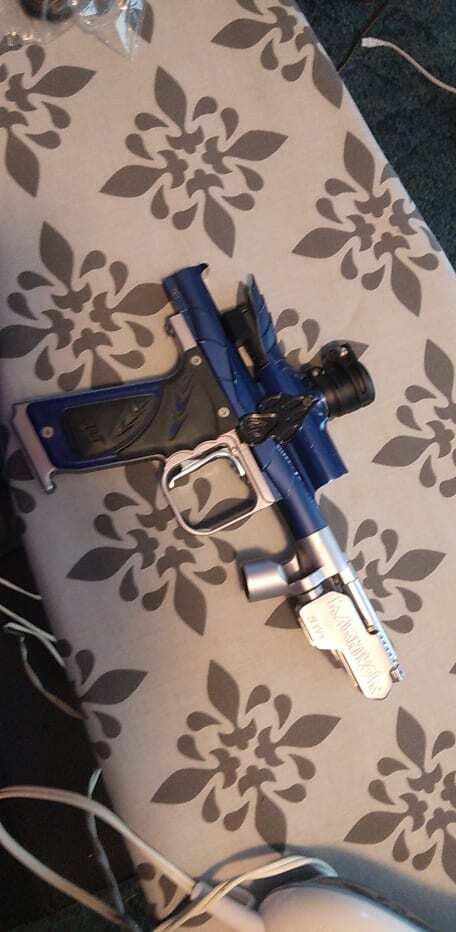

      • DocsMachine
        • 2822
        #379
        I don't recognize any of it, no.
        I assume you mean specifically the hack-job midblocking? No, definitely not mine.

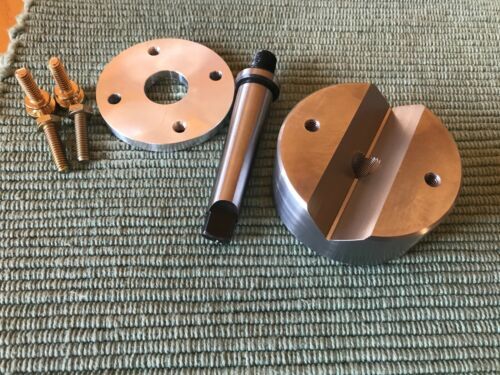

            it seam like an easy/good way to drill tubing on center (which I always struggle) on the lathe.
            Anyone have or used one?

              -I've never used one, but I've seen them used. They get the job done.
              Keeping in mind my first machine tool was a mill-drill, and it was a while before I got a lathe. Drilling the center of something is easy on a mill, of course.
